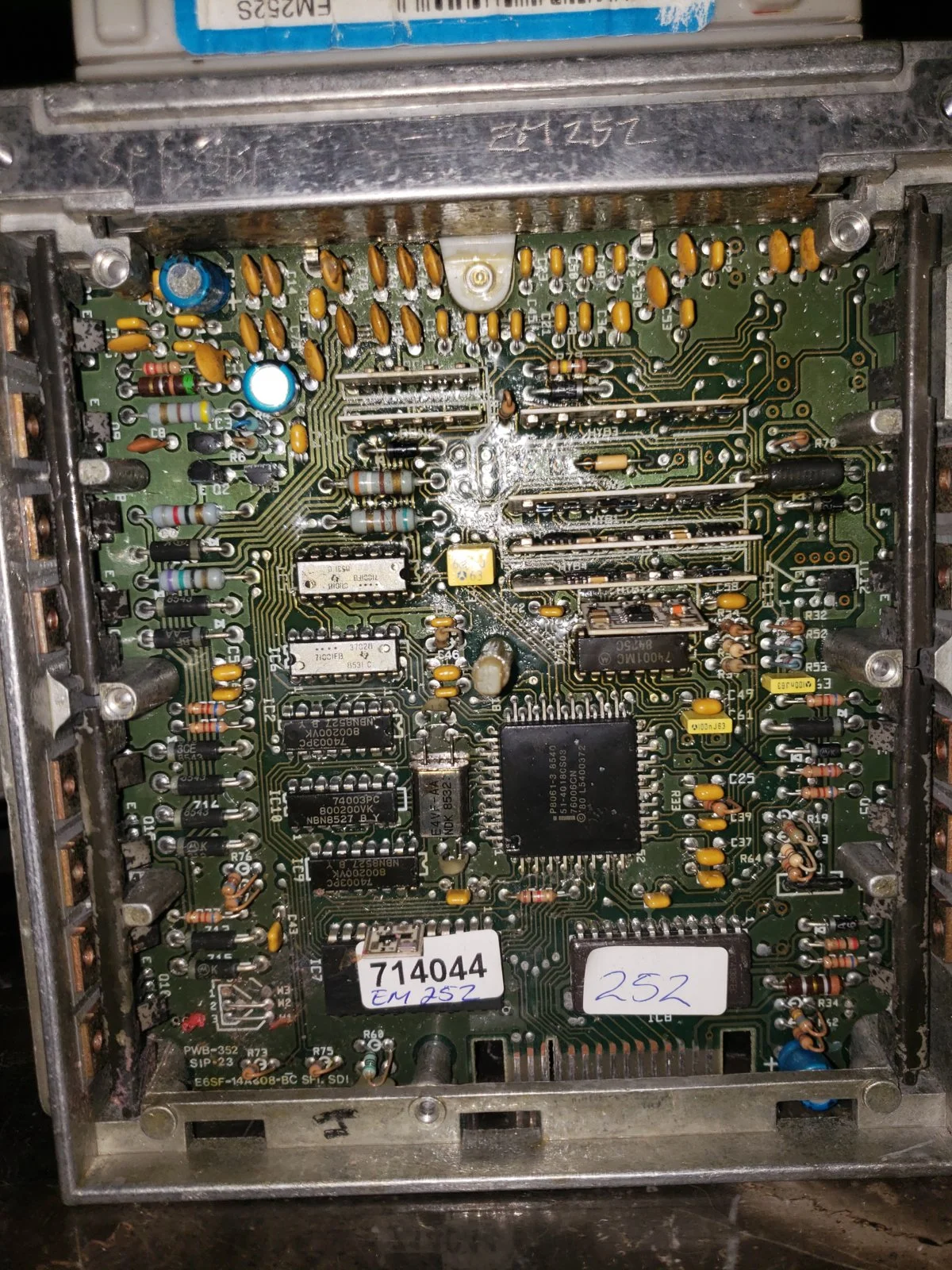

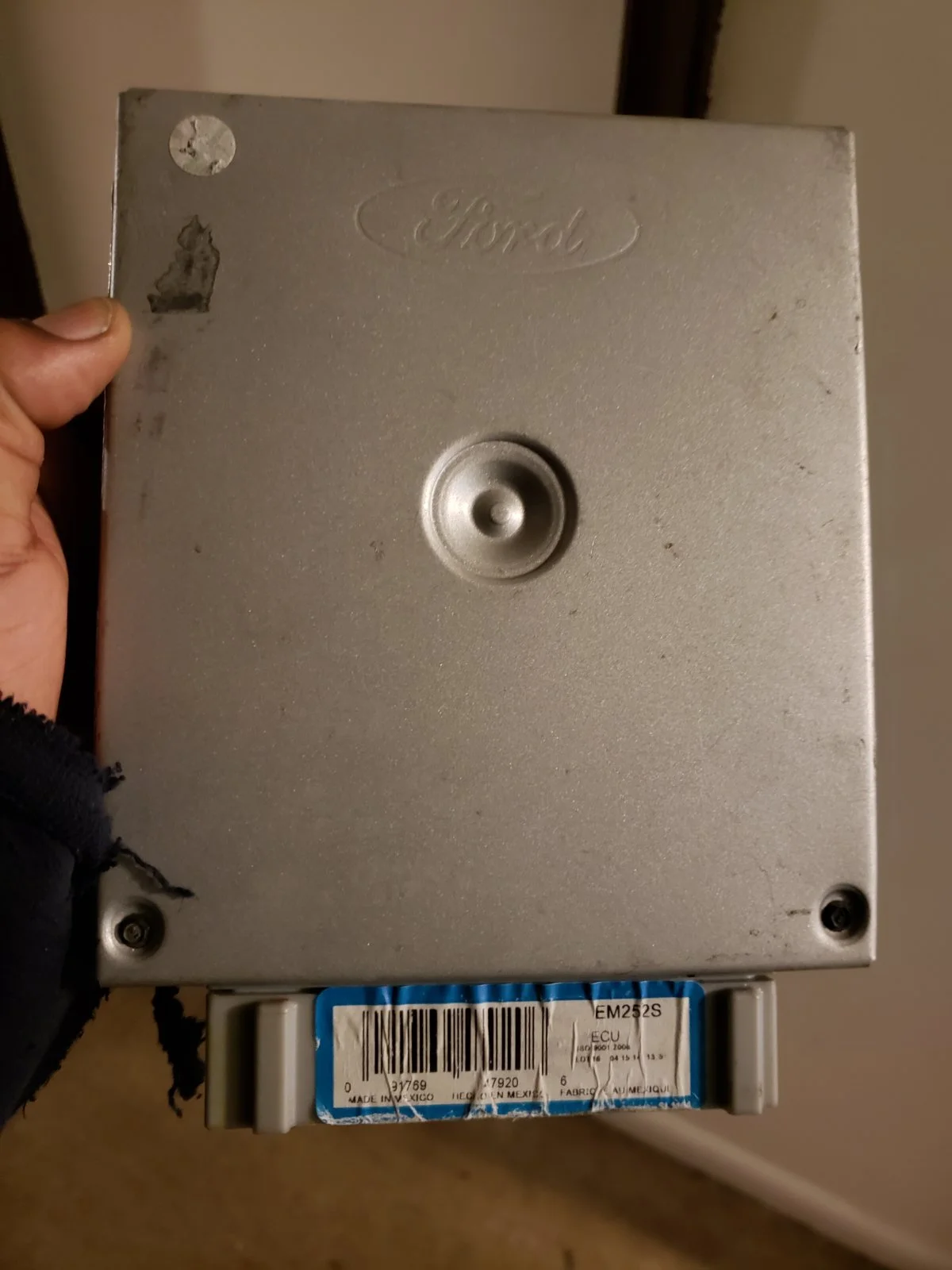

I'm not sure this is the right computer if I'm being real. The torx bits arent what they are suppose to be more does it look like the other ones I've seen and it doesnt have the tight designation I believe.

I've found one ECU that might match this one but it doesnt look the same. Anyone heard of an EM252S? Theres only an EM252 that ive found sold by standard motor products but it doesnt have the same look at the connector part.

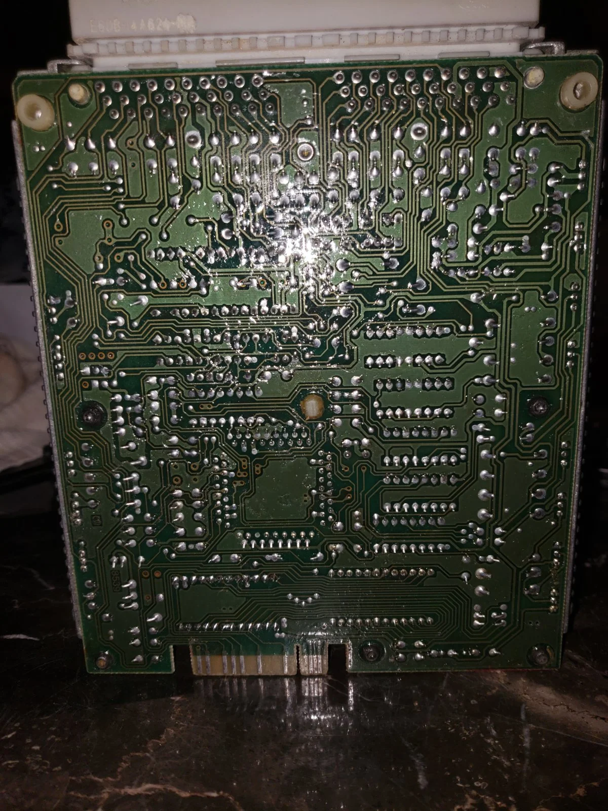

I'm not seeing any burnt up connectors on this either but I figured I'd get that second opinion before I send it out to sea and get a new one.
