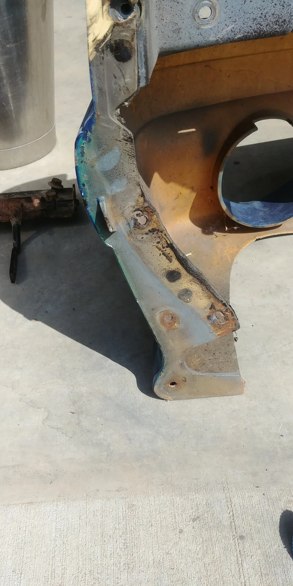

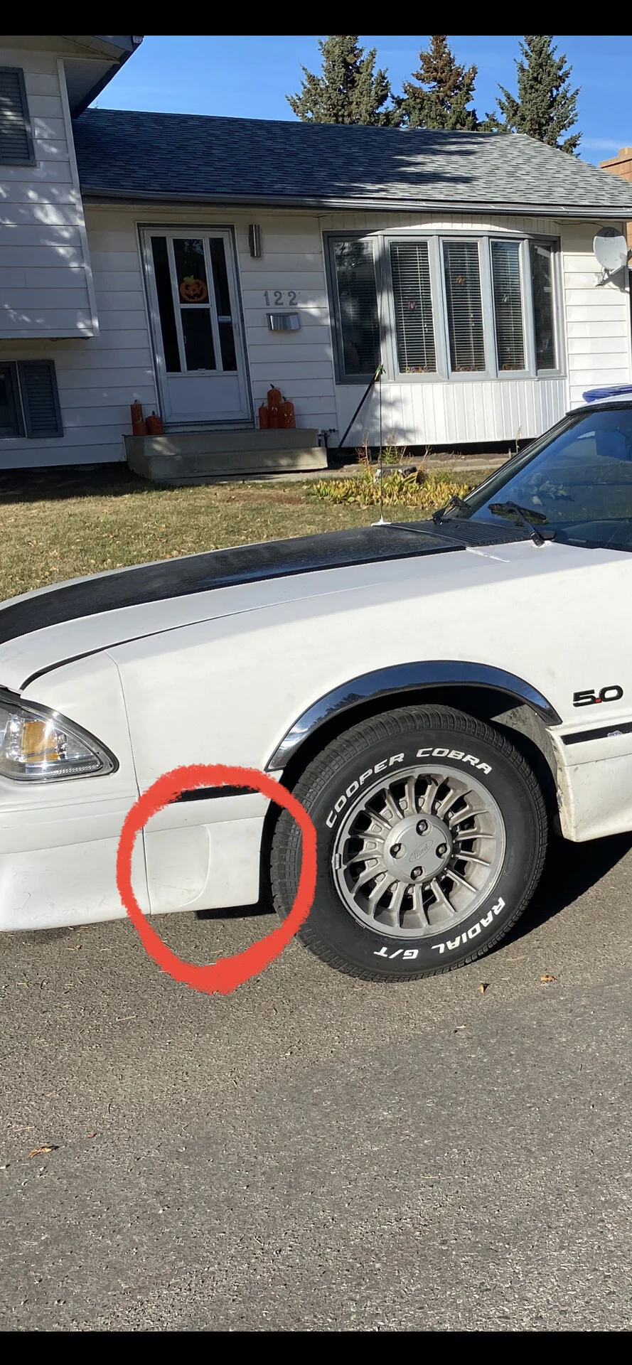

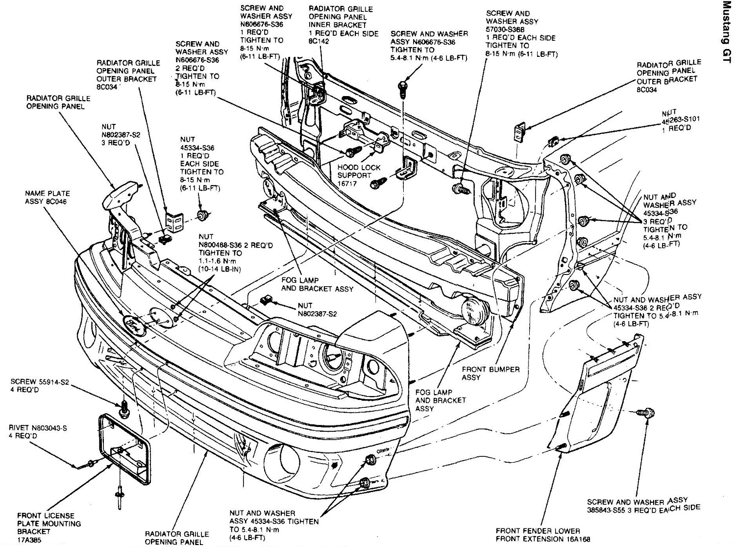

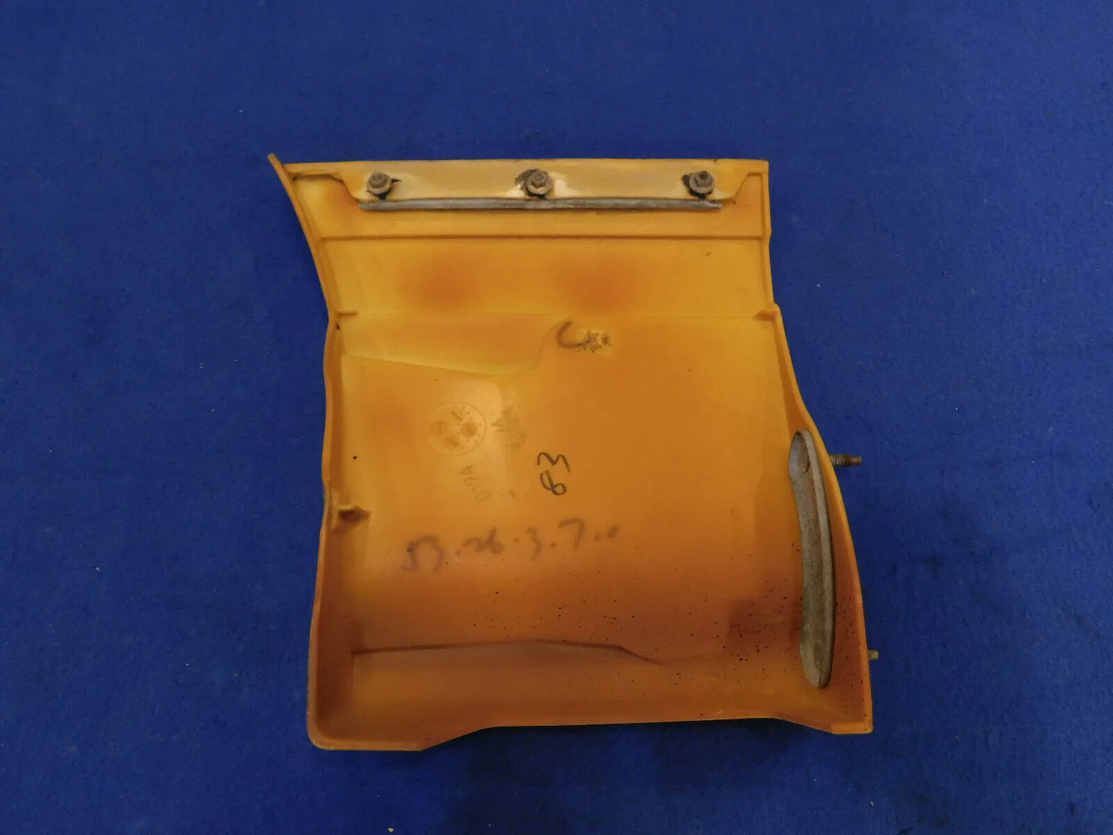

My boy called and said that this extension piece is about to fall off. He hasn’t sent me a pic yet and I have been searching on how they attach to the fender and I can’t find anything. So how is this piece attached to the fender.
front tires are 235/60/15 and they do rub.
Thanks. I still haven’t seen what my boy is talking about so hard to describe exactly what’s happening. From everything I’ve seen I don’t know how it can come off unless there broken bolts.
