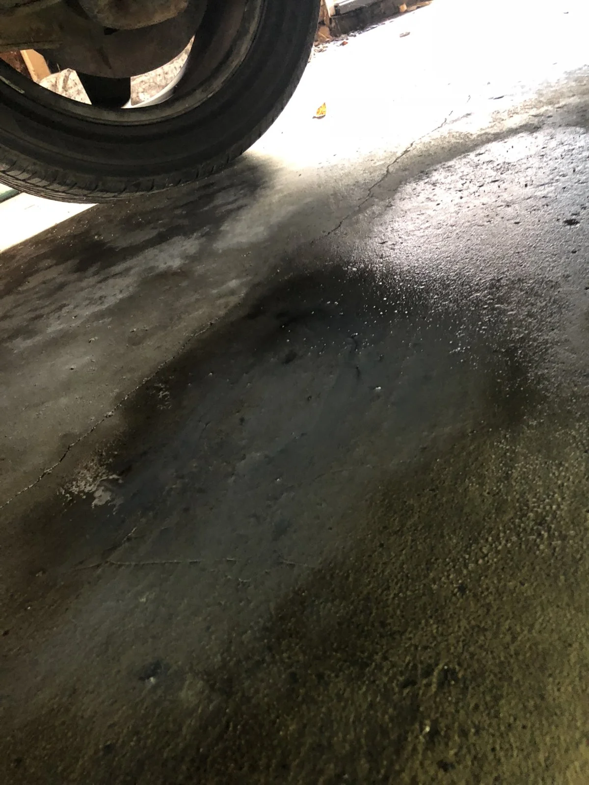

Got under it for first time today. New leak I haven’t seen on the car before. Almost milky white translucent fluid.
No idea what it is. I’m about to drain and change the trans fluid. I’ll follow up after.
That milky look can indicate water or moisture. Check for coolant leaks too. Maybe do a pressure check on the coolant system. Just asking but did that car ever live in a flood prone area.

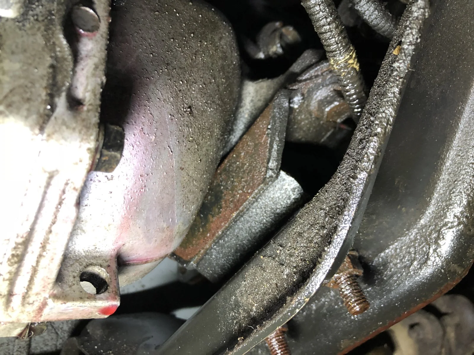

Refilled trans with 3 quarts of Castrol mercon v. That didn’t top it off. I will add more tomorrow. After filling I left the car lifted for a bit to inspect for leaks. There is a decent leak, about one drip every minute or so. I can’t tell exactly where it is coming from. It looks to be from the far tail end of the trans. Here is a pic of where the drips are forming:

That looks like it might be dripping down from the driveshaft yoke seal. Not too difficult to fix if that's it. Pull the driveshaft, pull the old seal and tap a new one in, reinstall driveshaft. Good time to check the ujoints out too. Might even be worth replacing them. If you want you can take the shaft to a shop and have them put the joints in, then you put shaft back in car. If you've never done ujoints before and dont have a decent good sized vice, they can be a little tricky to get just right. Also check where the speedo cable hooks up on the tail passenger side. It's another common place for a leak.

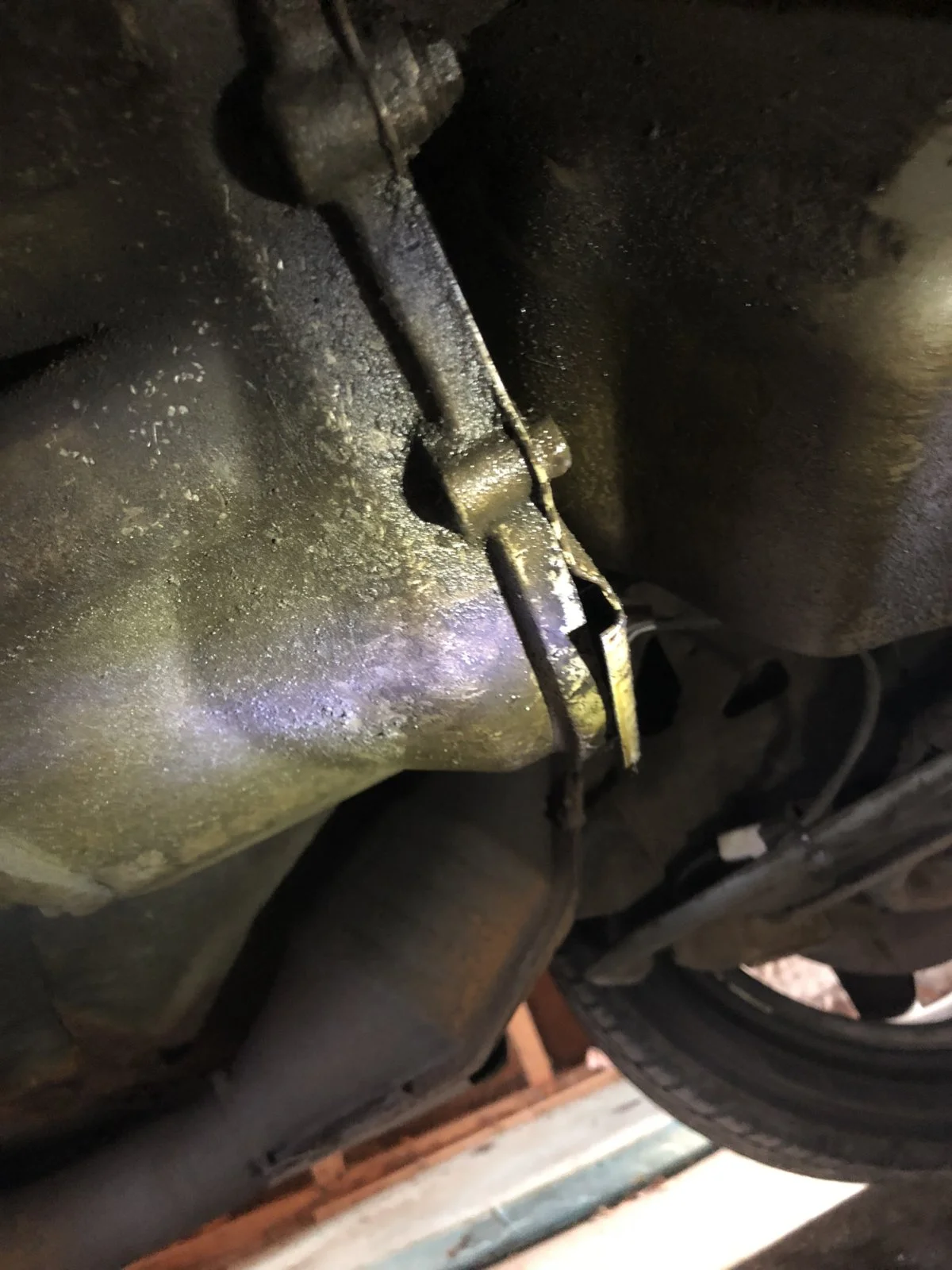

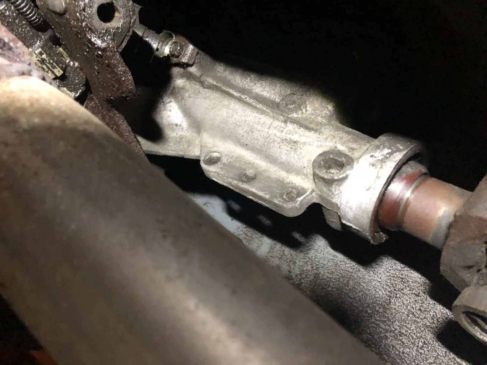

Well, I topped it off today and cleaned up the tail end. I gave the driveshaft a firm shake and it doesn’t move at all without the trans moving with it.

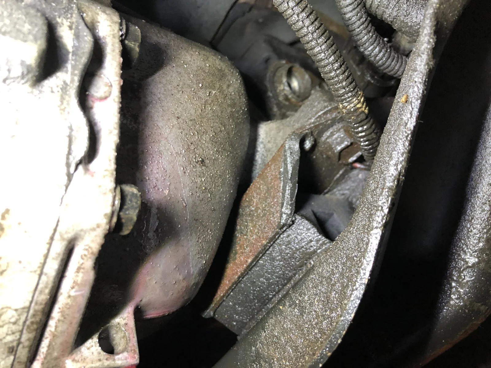

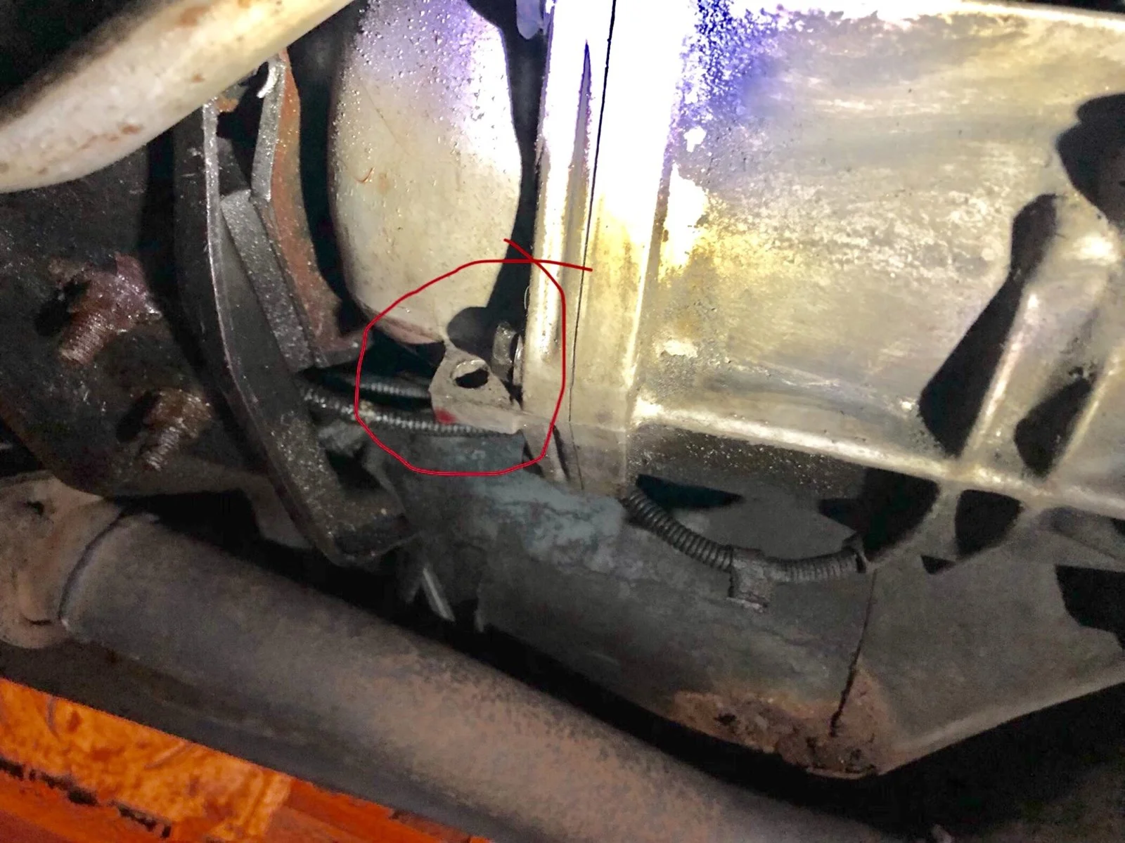

There doesn’t seem to be any leaking from the yoke seal. The speedo cable is currently disconnected, but there doesn’t appear to be any leak from where it connects to the trans either. The fluid seems to be coming from the top side closer to the engine than the speedo connection. I couldn’t get a pic as I had to wrap up pretty quickly and leave.
Let me know if any of this helps, if not I will try to get some pics later tonight or in the morning.
There’s a seal where the shifter assembly bolts up on top. But that wouldn’t leak just sitting there. You’d have to drive it and churn the fluid up top to get it to leak
The front end is lifted a good 20” over the rear as it’s currently on jack stands in the front only. I don’t know if that would make a difference. But I think it is still leaking off of the stands as well. Anything else up there it could be leaking from?
Correct. And I believe you have to pull the trans to fix it. I had to change my speedo gear on the output shaft which required the tail housing be removed. I pulled the trans to do it. Clear all the old sealer away and clean surfaces. Put back together with new sealer. I think I waited at least 24hrs for the sealer to cure before I put fluid back in. Has not leaked a drop.

Can I just remove the driveshaft and pull the tail housing off the back to reseal it, or do I have to remove the entire transmission?
