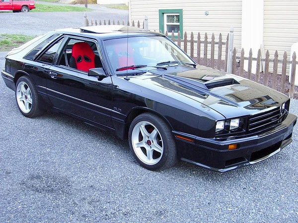

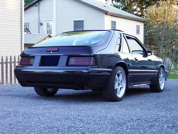

I bought some 17x9 Cobra R replicas with 235-45-17 tires and when I tried to put them on my '86 Capri the rears fit fine, but the inside lip of the wheel on the fronts hit the strut. The only way I could make them work was by getting longer studs and used a 1/4 spacer plate at all four corners. I ran this set up for 10 years... I kept an eye on the lug nuts to make sure they didn't come loose, but they never did. They never rubbed either, even when I had the steering wheel turned all way left or right and this car was lowered also. Because I used the spacer plates, I didn't even have to remove the quad shocks either. It gave the car a wide, mean looking stance... see for yourself.

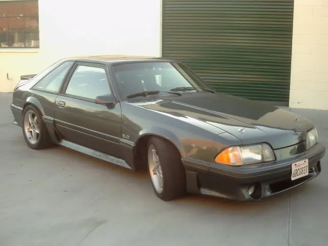

thanks for all the responses..here are some pictures of my fox
