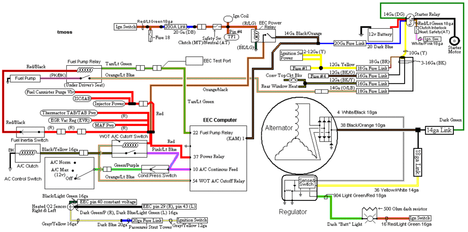

See the following website for some help from Tmoss (diagram designer) & Stang&2Birds (website host) for help on 88-95
wiring http://www.veryuseful.com/mustang/tech/engine/ Everyone should bookmark this site.
Ignition switch wiring
Vacuum diagram 89-93 Mustangs
HVAC vacuum diagram
TFI module differences & pinout
