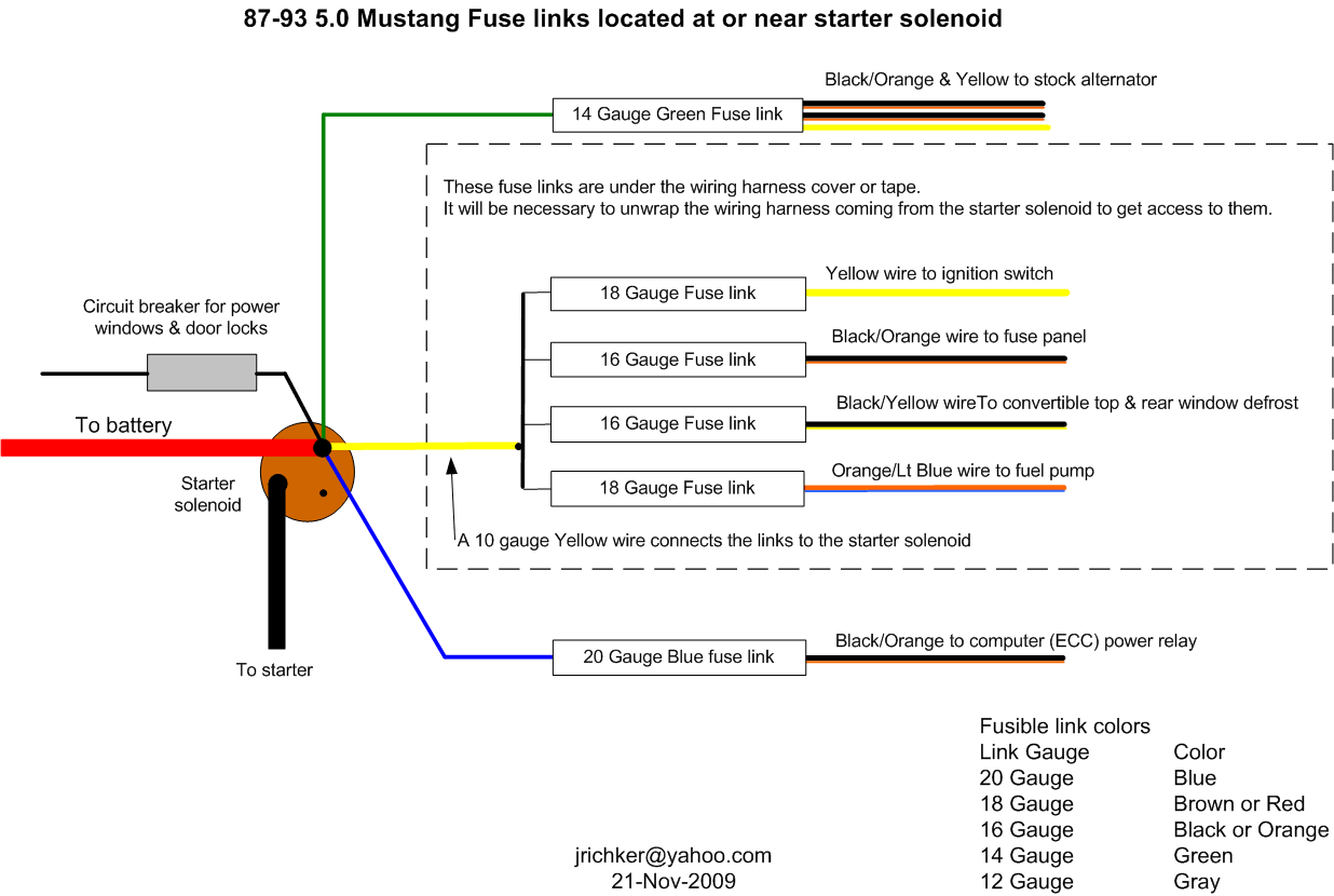

Was wondering if anyone has a pic of one of these.windows and locks not working so I pulled the circuit breaker, when I did 2 small pieces of metal hit the floor.i purchased new one but it won't go in.i trimmed off the tabs to get it to fit but very loose.held it in place with the key on and got some movement from windows but not much. Not sure if it's even the right one.
