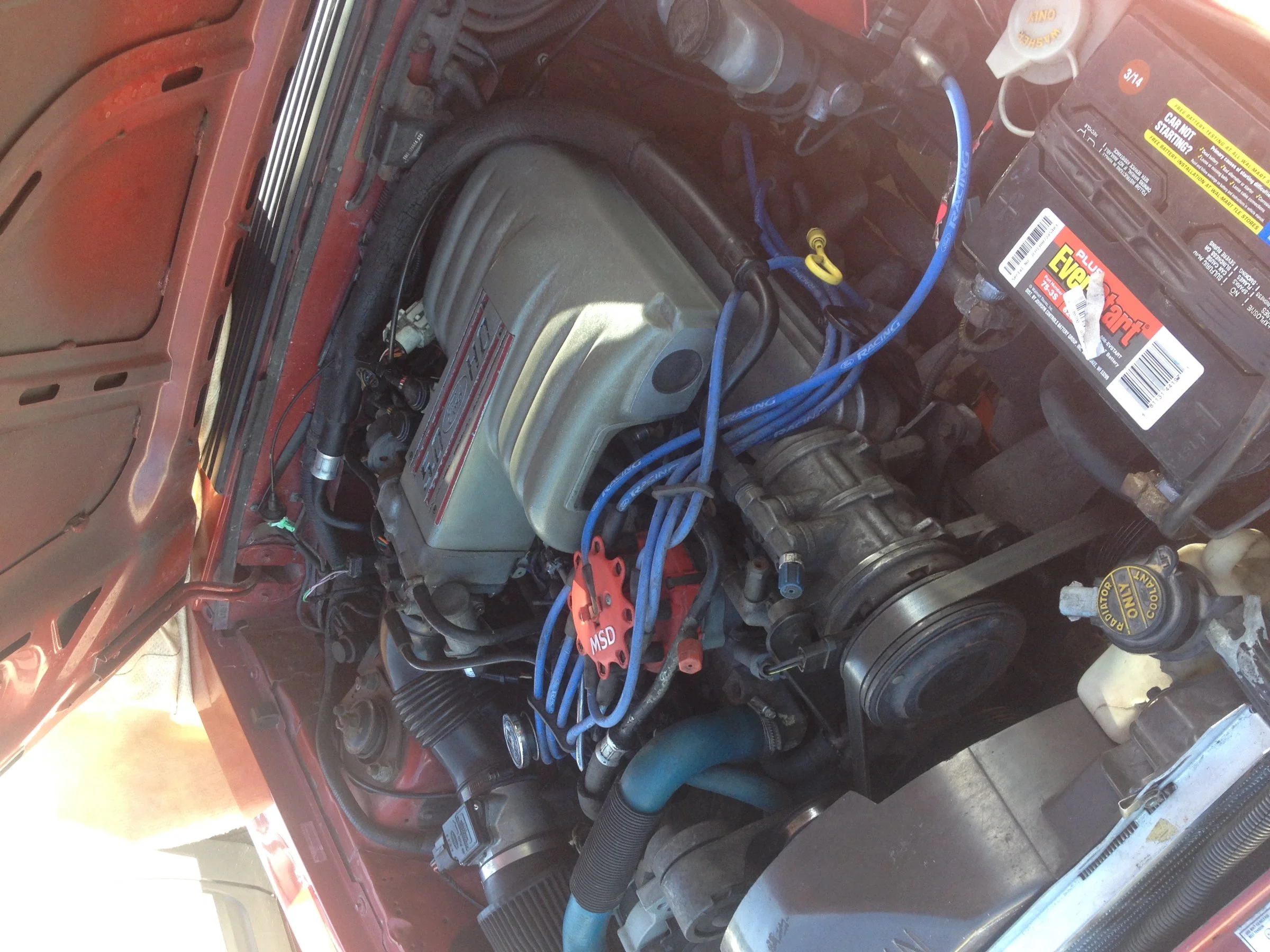

So I just bought my first car not to long ago it is a 89 mustang GT. Right away i have bin modifying it with plans of restoring and upgrading in the future. I put a 70 mm TB on and it still has the stock EGR Spacer i will be getting a 70mm spacer when i have the money. After that i started hearing a popping sound when i first get on the throttle then it goes away. do you guys have any idea what that may be? My friend has a 91 mustang gt and said it should go away ones you get the right sized egr spacer or just drive for a bit. And can any one give me an idea of the amount of horsepower i have now? it would be greatly appreciated.
Stuff that have been done so for:
*76mm MAF
*70mm TB
*K&N CAI
*MSD Distributor
*Ford Racing spark plugs
*aftermarket radiator i don't know what kind
*130 AMP alternator
*off road H-PIPE
*Flow master dual cat back exhaust

Welcome and congrats on the mustang. Take some advice from my 35 years of working on these cars, and don't take it as bashing,
What is the 70MM MAF off of? Is it Ford or aftermaket? The 70MM TB is a waste of money with your stock setup. You are probaby losing low end power. MSD distributors are junk and known to cause problems- best to put back a stock Ford distributor. Why are you running race plugs with a shorter electrode on stock iron heads? What heat range are they? Put a set of 3925's back in. You removed the catalytic converter- is the smog pump, thermactor tubes, and other emissions still on? What is your timing set at.
You are + or - 20 hp from stock of 225 flyweel hp
First thing to do is run the key on engine off and key on engine running codes.

yes I just hopped back on to change that I said 70mm I meant 76mm and I compleity understand you are not bashing me you are just giving me a answer to my question. so you said the MSDs are trash would there be a better alternative then the stock distributer? and the spark plugs came with the car. The cat has bin removed, smog is still on but I plan for a delete, I have no knowledge what thermactor tubes are I am still pretty new to the car community that's why I joined this forum if you could fill me in it would be much appreciated. timing is stock to my knowledge.
ok so you have the following- not trying to get you to spend money, just letting you know whatto expect. In general, your motor is stock and the intake, heads and exhaust manifolds are all choke points. Adding a larger MAF and TB are not needed and probably arent doing anything at this point for you.
  • C&L 76 MAF- garbage for the most part. If it's working leave it though
  • 70MM TB- way too much for your stock motor and that you have the stock 58MM EGR plate is causing undo turbulence of air right before the injectors. The TB and EGR plate need to match.
  • distributor- there is no need for you to have an aftermarket distributor. The stock Ford distributor and coil are good for at least 400hp and are better than most aftermarket. If the MSD is working now keep it but now that one day it will leave you stranded.
  • If you removed the cats, there is no reason to still have the smog pump and hoses. Run a short belt and remove them. A smog deleted is a waste of money and not needed.
  • Spark plugs- put a set of autolite 3925 copper plugs back in
  • Timing- stock is 10 BTDC but most cars like 12-16.
Again, before you do anythin, run the codes. Sounds like the prior owner was either a kid or some nutswinger wannabe racer. Before you start throwing parts at it, know what it does, what the actual benefit is. Guys here have done whatever you can dream of already dozens of times and can help you avoing wasting time and money.
There are stickies on top of the forums and archives on how to set timing, check coded, set base idle and such.
Again, before you do anything, run the codes. Sounds like the prior owner was either a kid or some nutswinger wannabe racer. Before you start throwing parts at it, know what it does, what the actual benefit is. Guys here have done whatever you can dream of already dozens of times and can help you avoing wasting time and money.

Just adding what others have stated that 70mm is too big for a stock car. Prob not hurting anything, but certainly not adding much power. 65mm would be adequate even for most modded cars.
