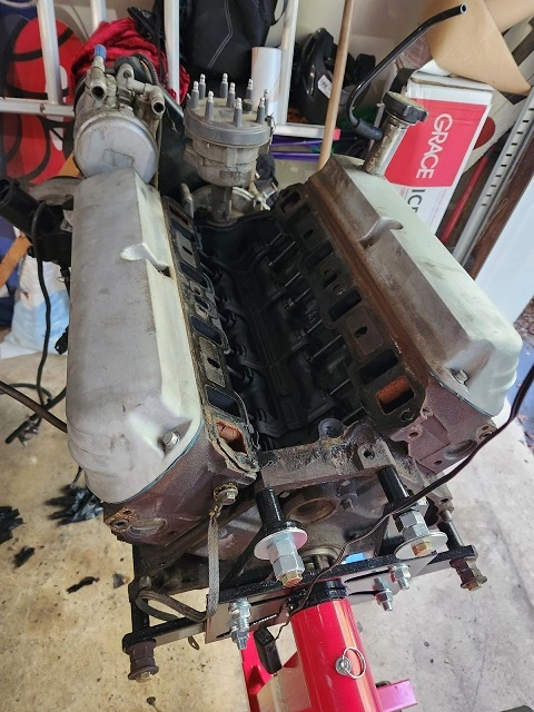

Hey everyone. New guy from NJ here. I picked this up 1989 coupe roller in Feb '21. Its a Florida car so almost no rust. The plan is to restore/restomod it with a 302 for a fun sunday cruiser and hopefully get my two young boys into foxes. I picked up the motor thats shown, a t5, A9L, 89 engine harness rather quickly.

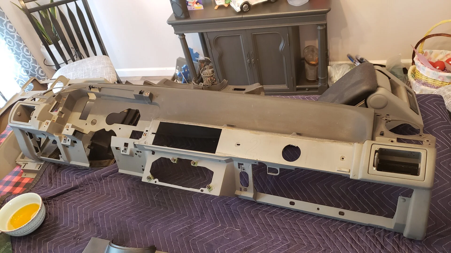

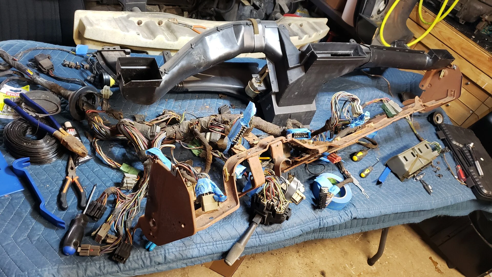

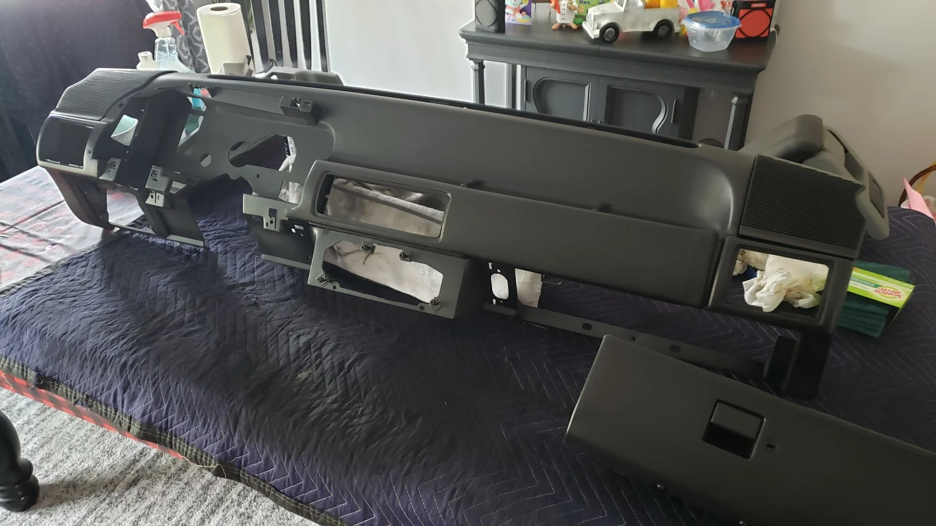

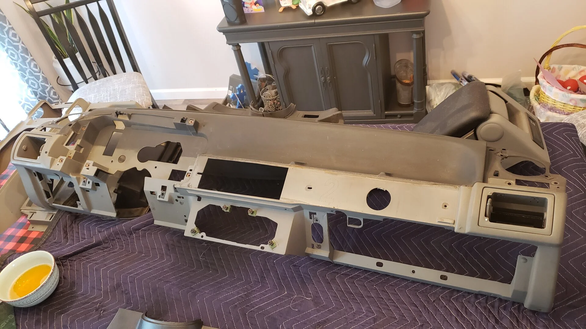

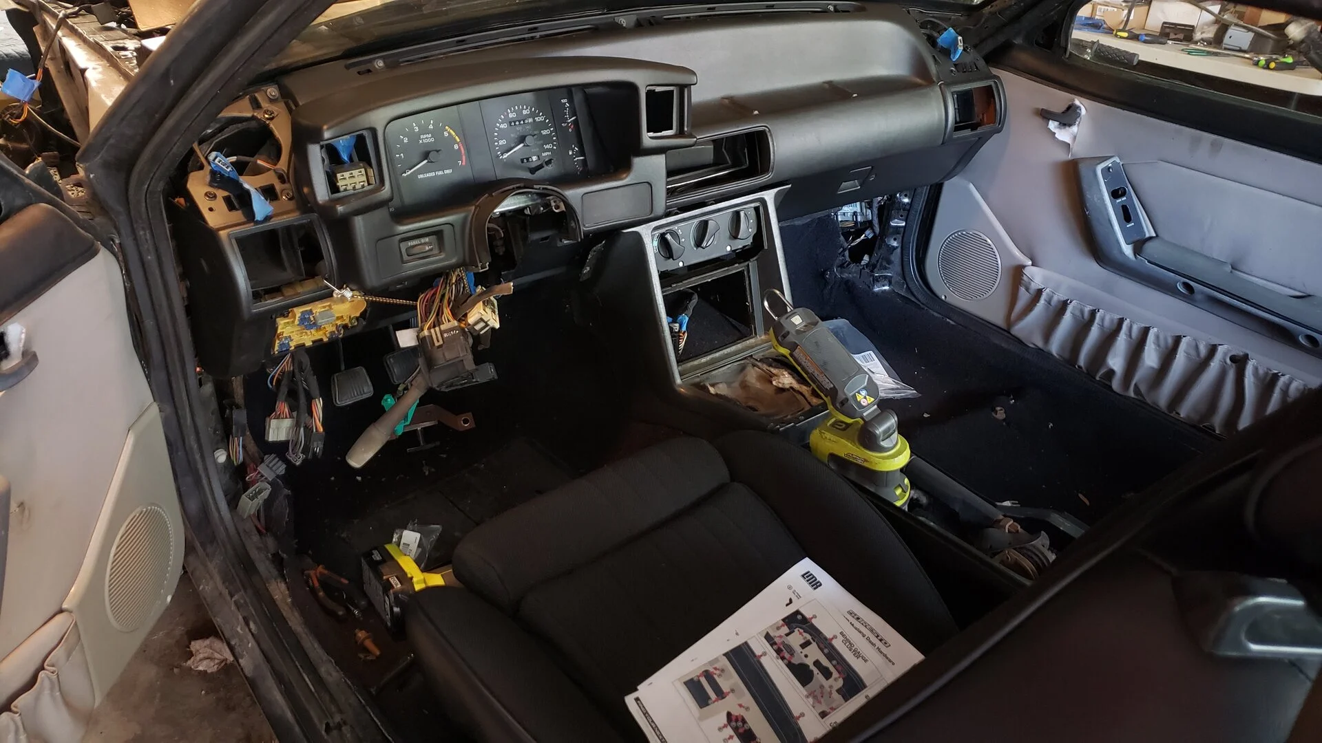

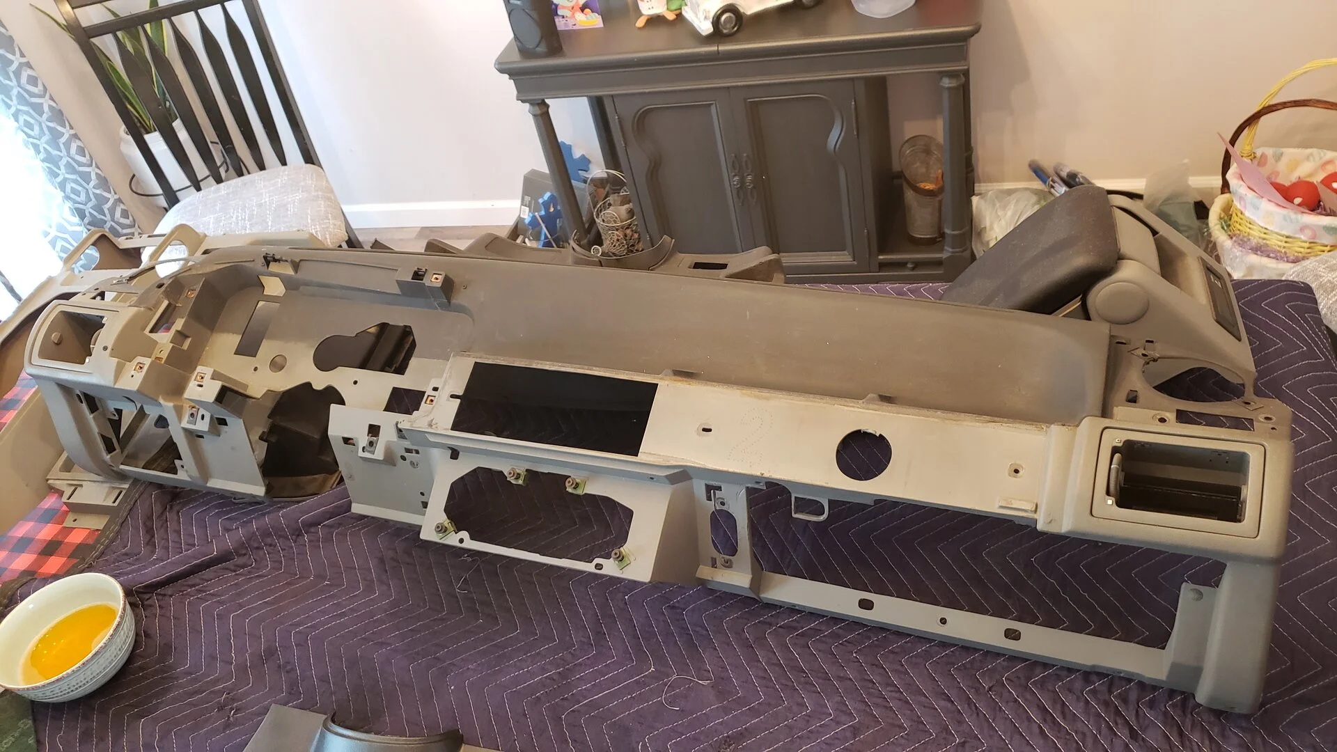

I removed the dash in order to dye it black. While it was gutted, I put in a new heater core and AC evap and replaced the blower motor for extra insurance. I never want to have to go in there again.
Used a degreaser, scotch pad and clean it with alcohol
Picked up a replacement dash pad from LMR. The fitment was a little off so I had to elongated 2 of the holes in the rear to get it a best I could.

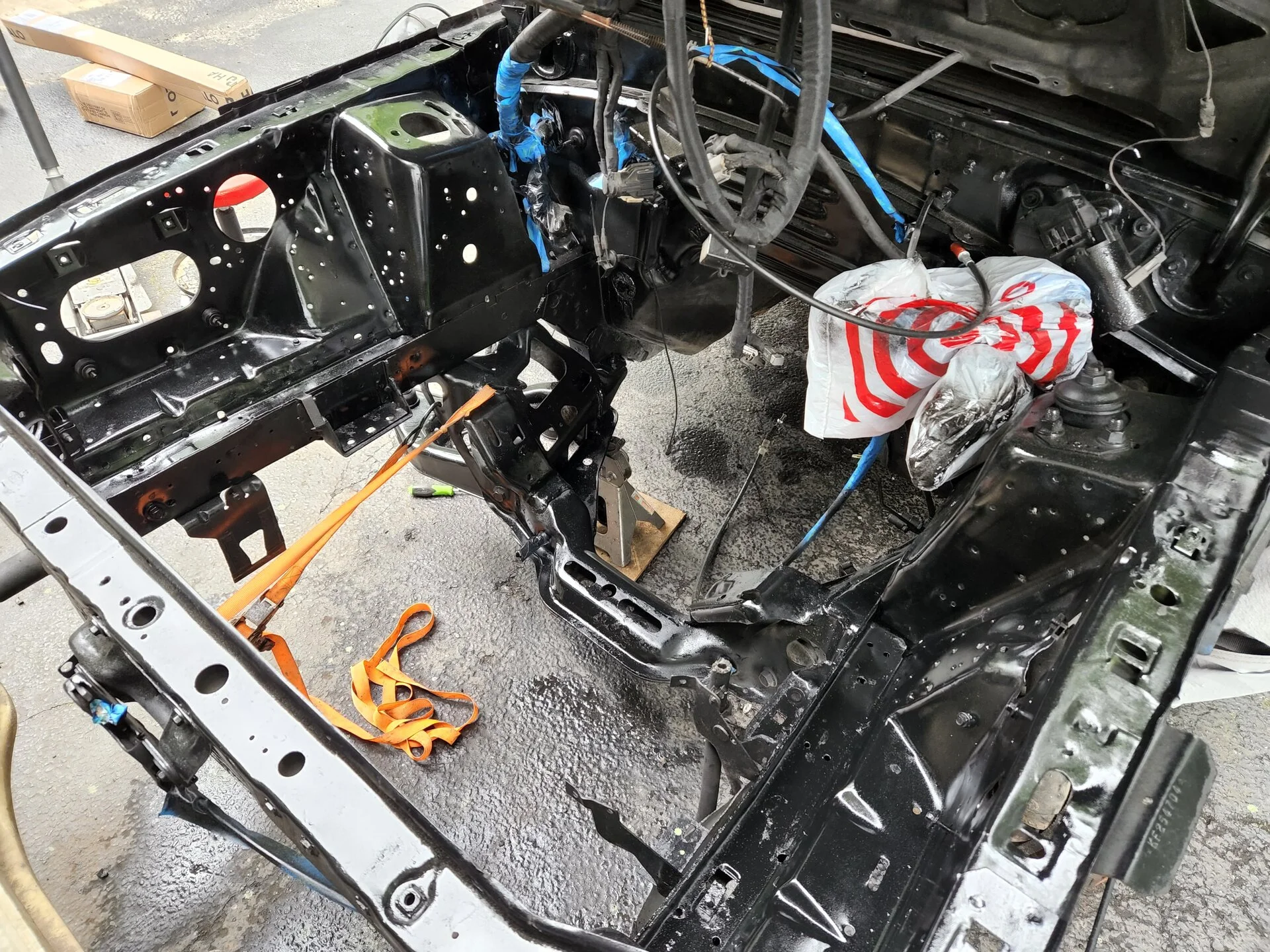

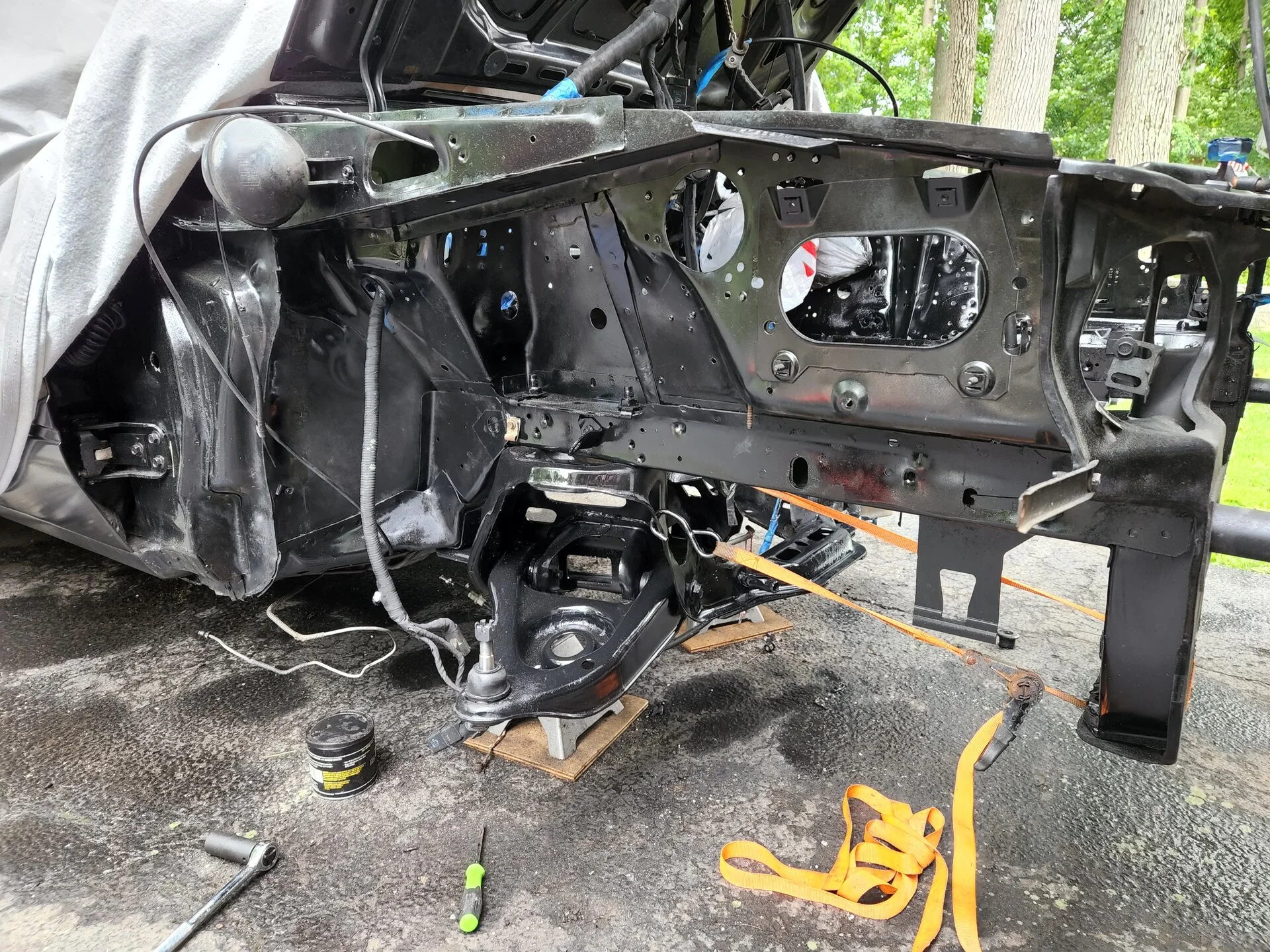

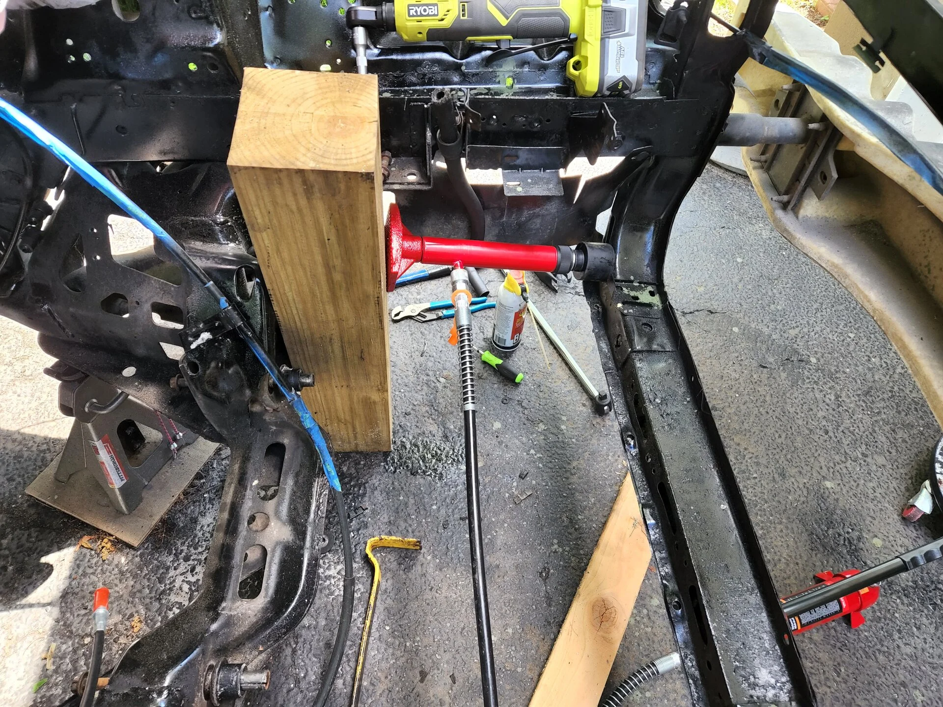

Somebody was a bad boy and smacked a curb. I had to bend back the lower core support.

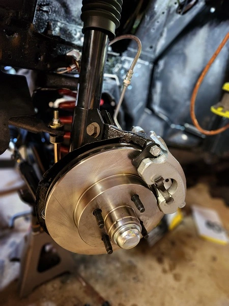

got the new ball joint pressed in.

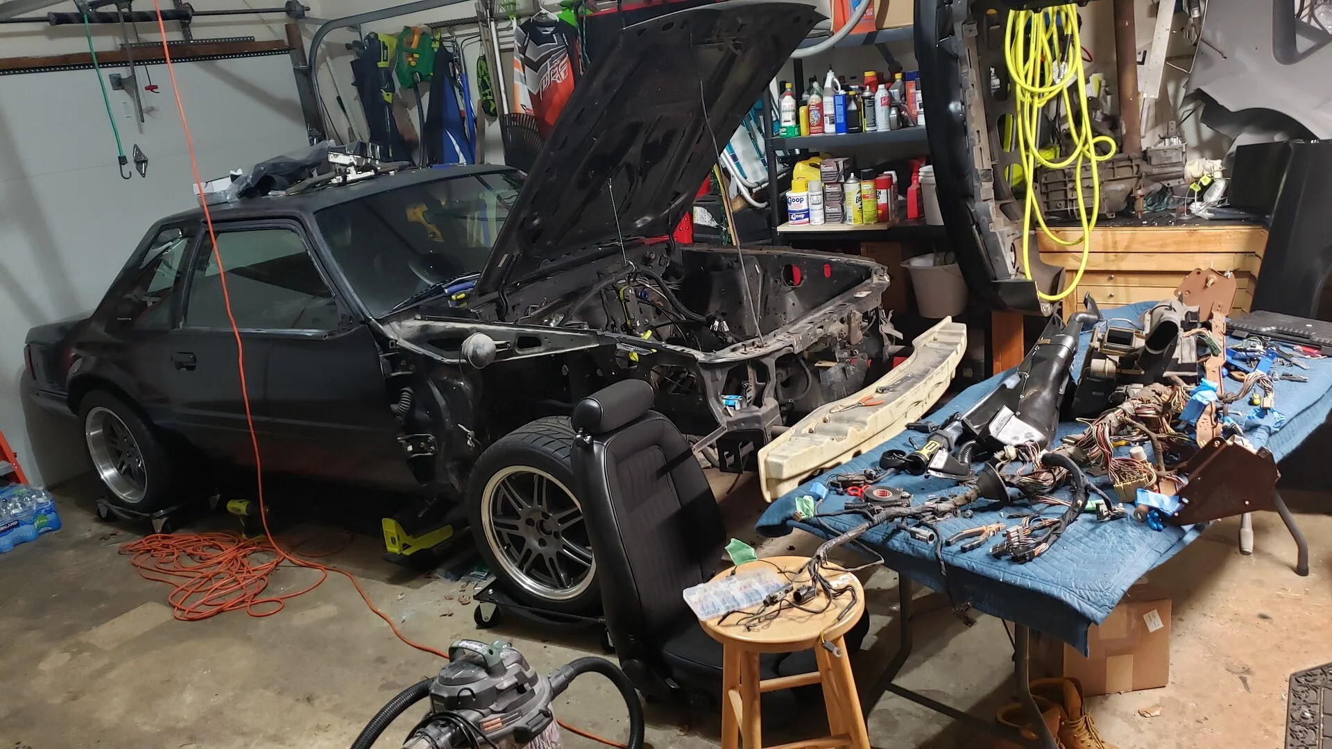

I cleaned up the bay a little. Removed the 4cyl steering rack, and am getting ready to drop in the new one. Swapped out the 4-cyl brake booster/master cyl to the regular v8 one (Not Cobra). New clutch and speedo cable.
I threw a quick coat of Rustoleum Turbo black on it just for a little protection. Paint and body is on the back burner until I get this fired up and on the road.

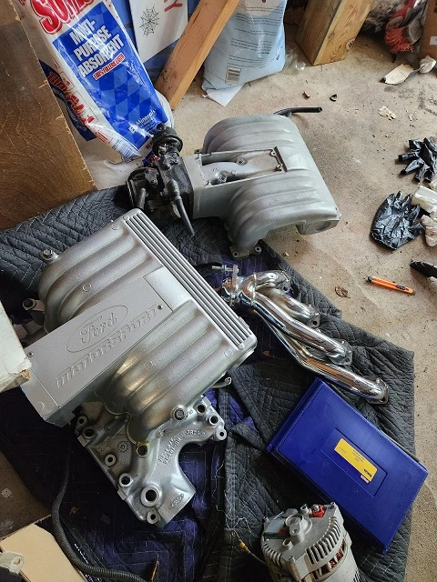

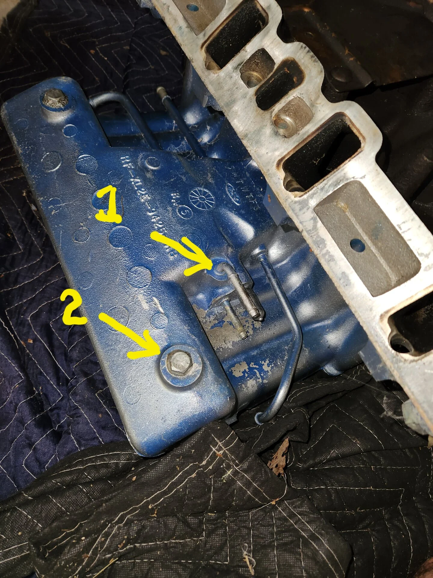

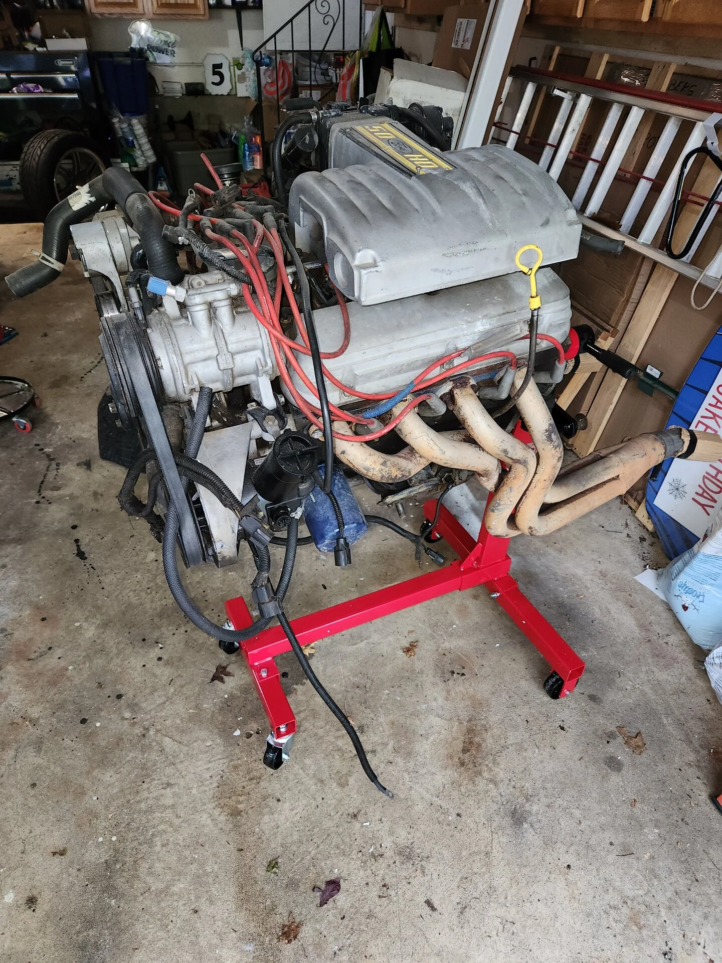

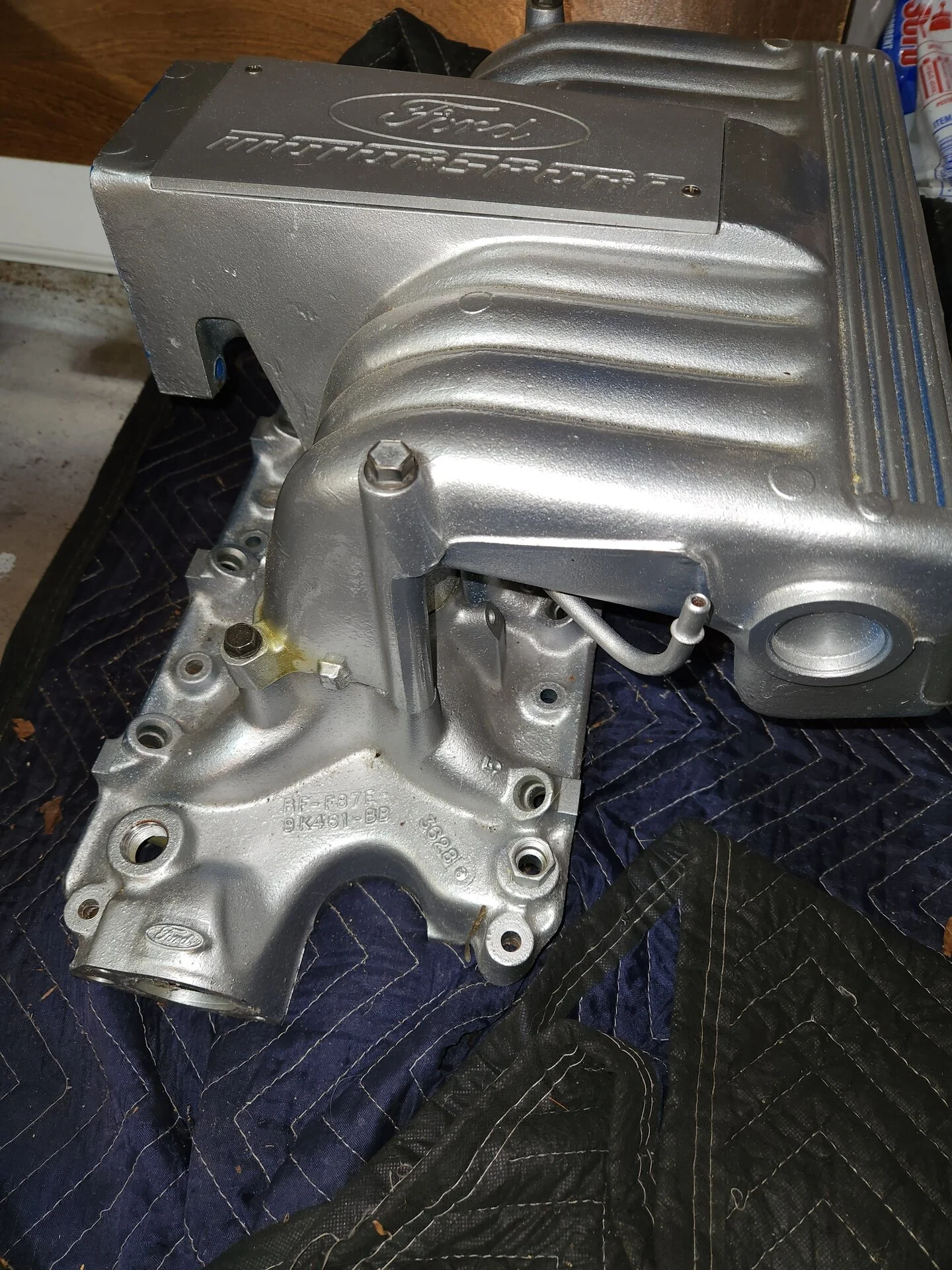

So I'm in the process of cleaning up my motor. I'm gonna swap out the stock upper/lower for an explorer. My question is since I have no ACT boss on the lower, what would be a good place to tap under the explorer upper? I highlighted where I'm thinking. What do you guys think?
1 is a coolant port. Coolant circulates in and out of the intake through there, so it’s not a vac line.
2 has the potential of oil puddling. 1 pcv connection should go there to prevent that.
For the ACT, best options are to carefully drill/tap the runner, which is difficult due to no boss being present, or just mount the act in the airbox and extend the wires.
