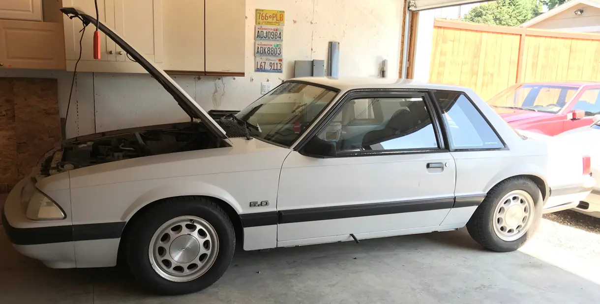

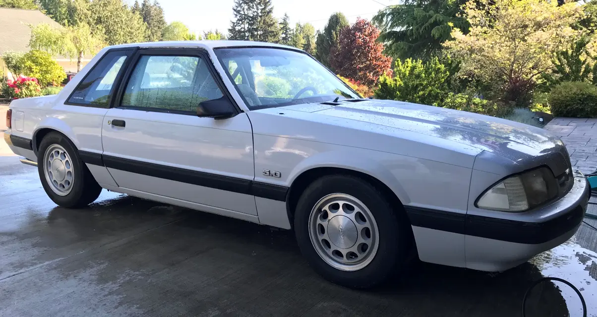

1989 Smoke Gray (1K) coupe with just under 75k original miles. 99% stock and totally unmolested, PO lost interest after tearing the interior out.....and getting rid of most of it :(
The day I bought it, July 8, 2019:

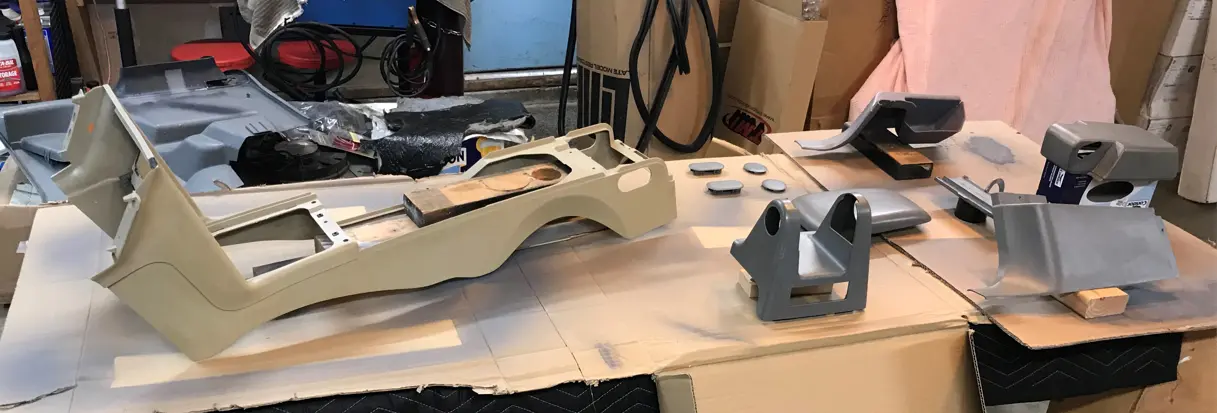

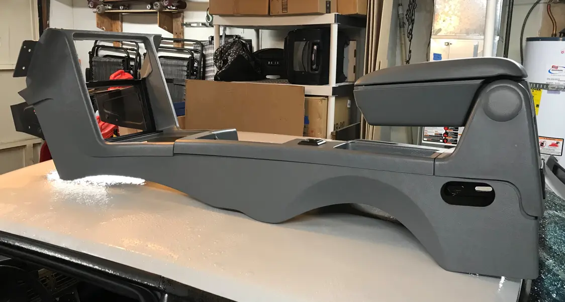

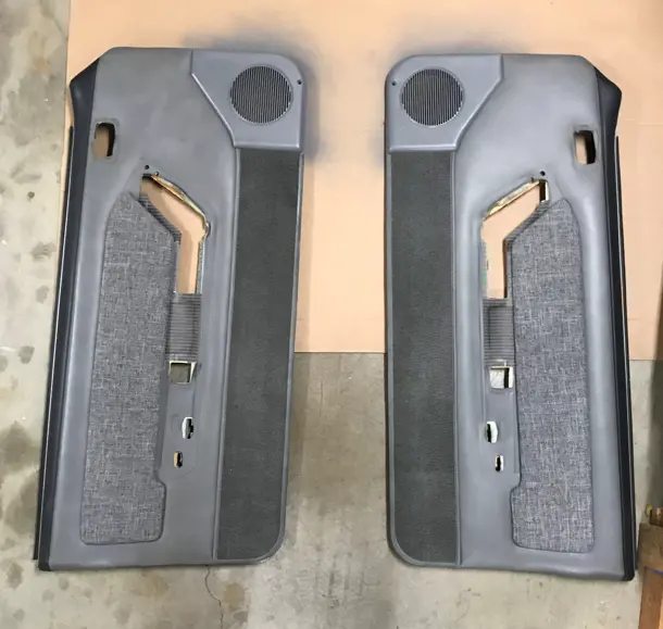

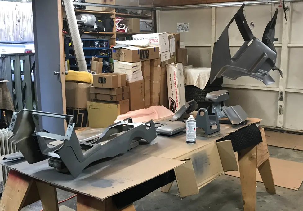

My plan was/is to get the everything inside refreshed first, then revive the paint/exterior as best as possible, upgrade suspension/brakes, and finally evaluate what I want to do with the drivetrain last.

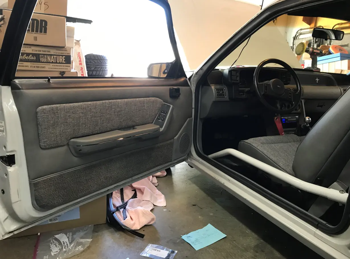

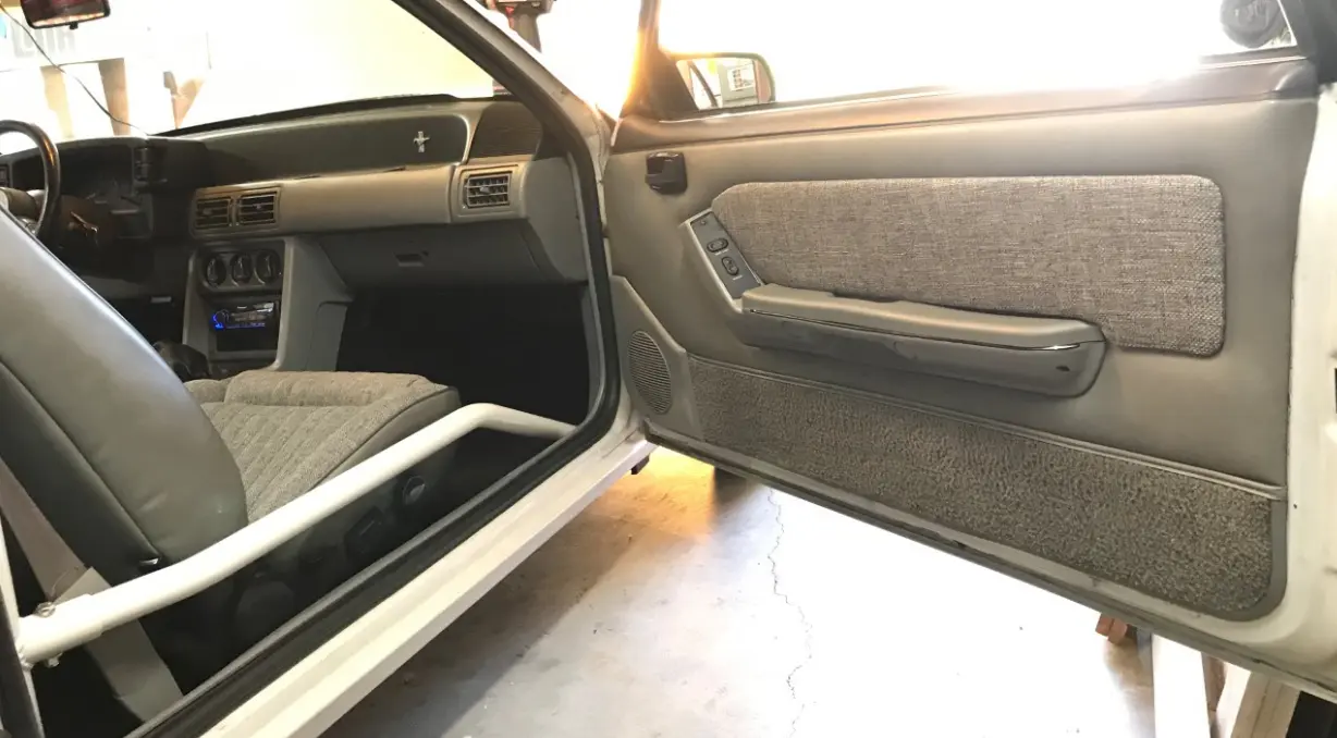

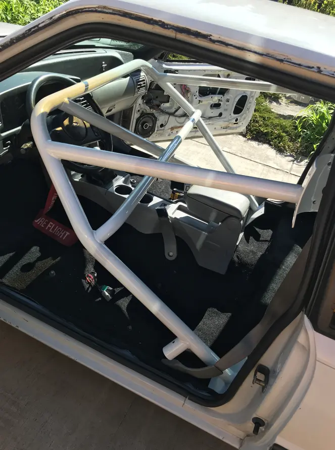

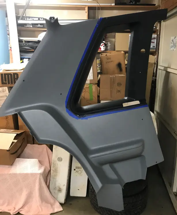

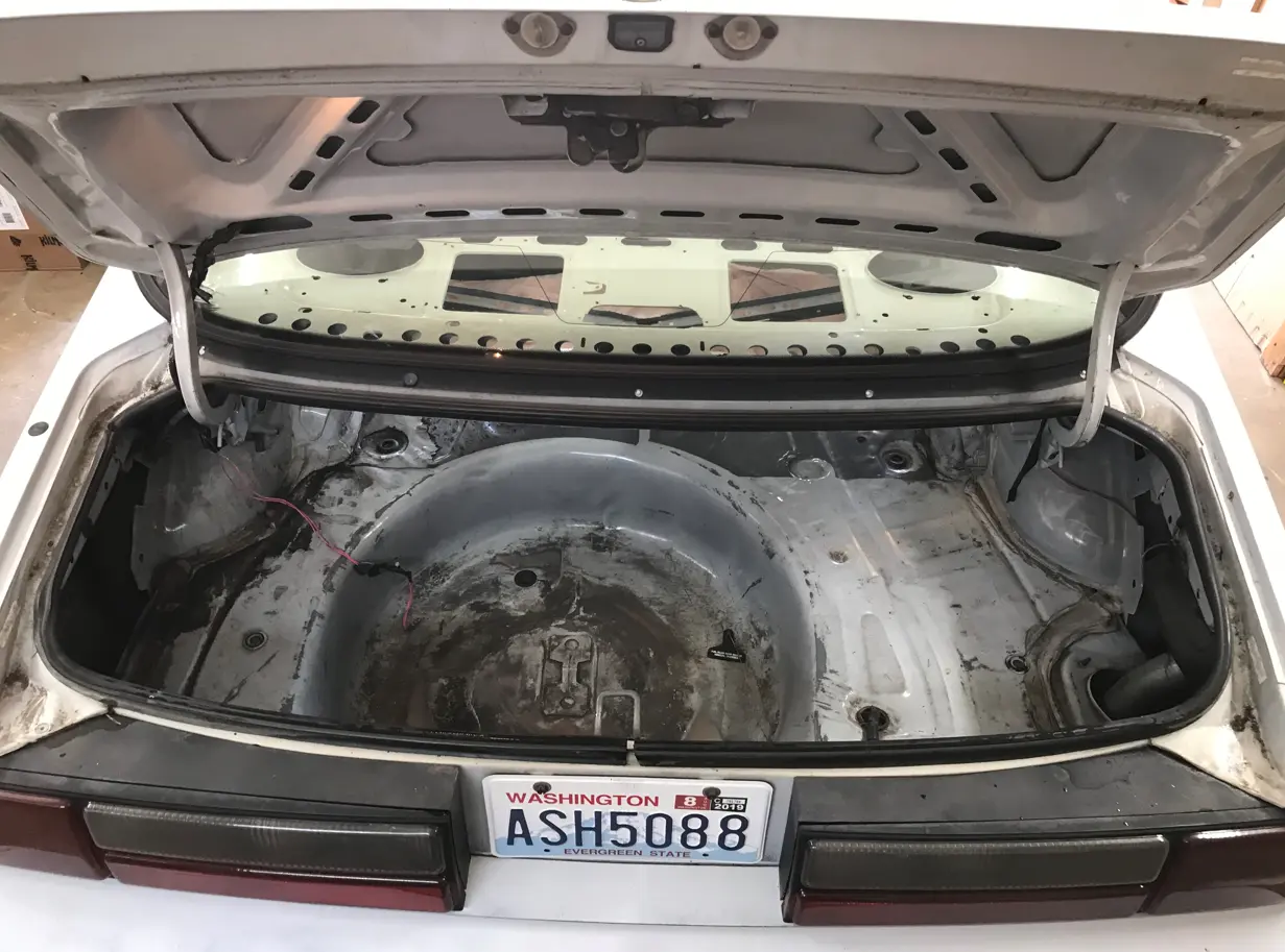

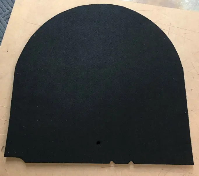

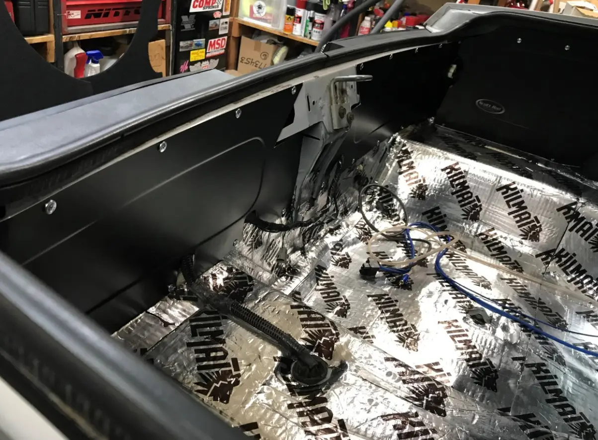

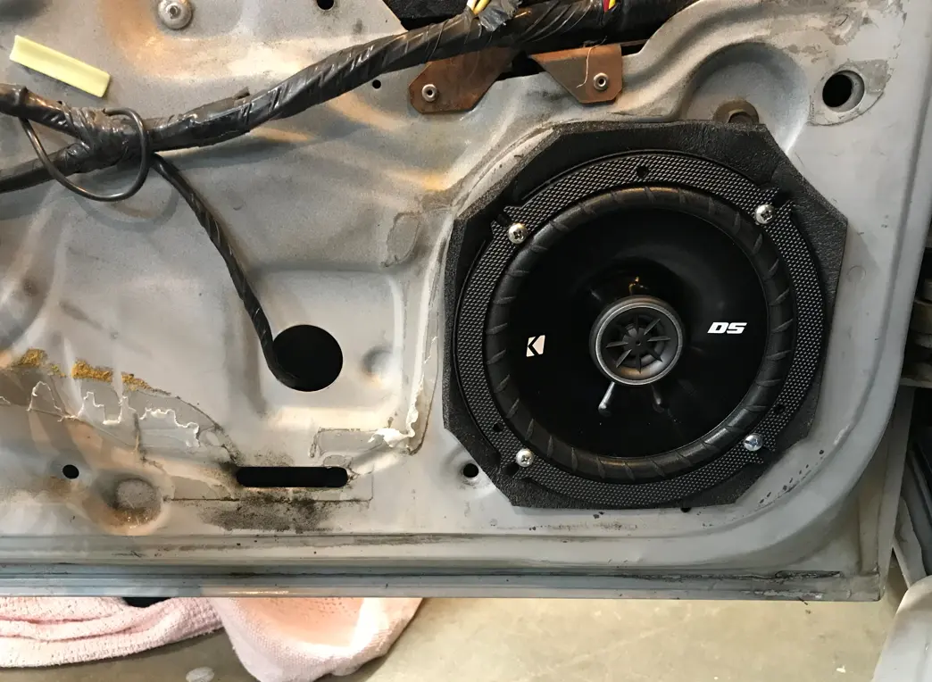

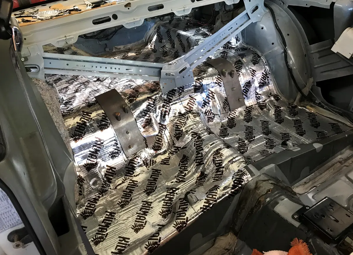

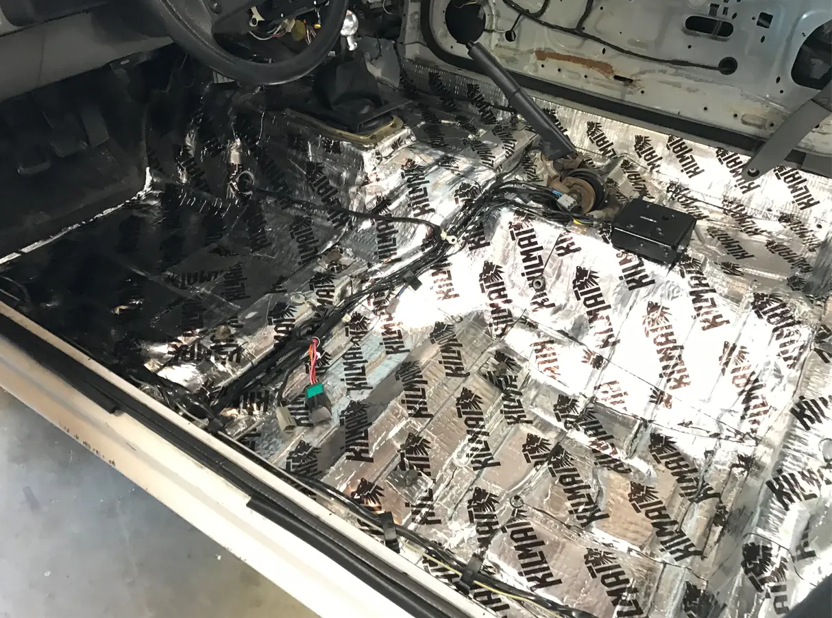

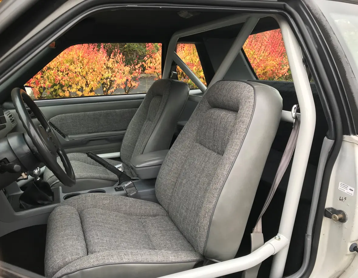

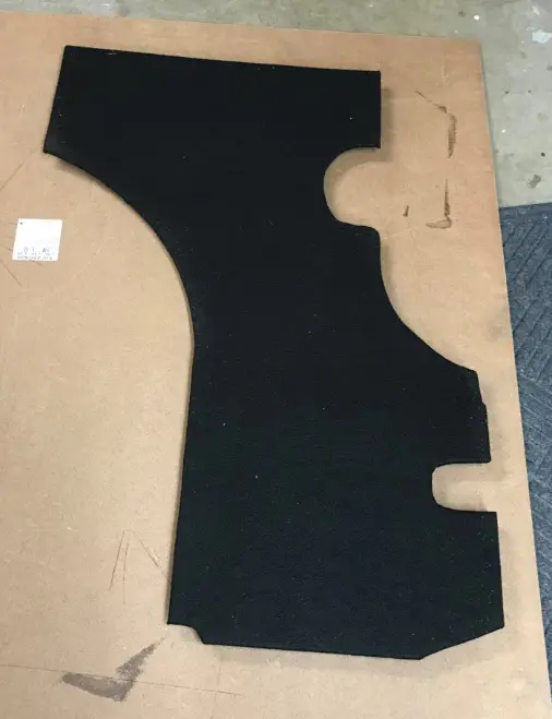

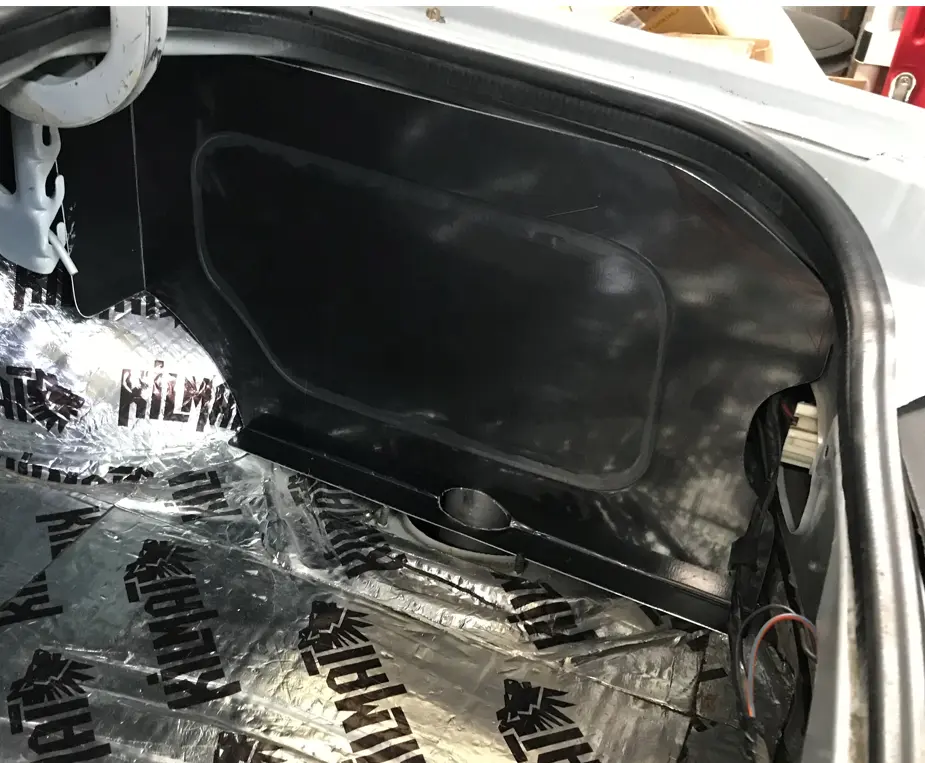

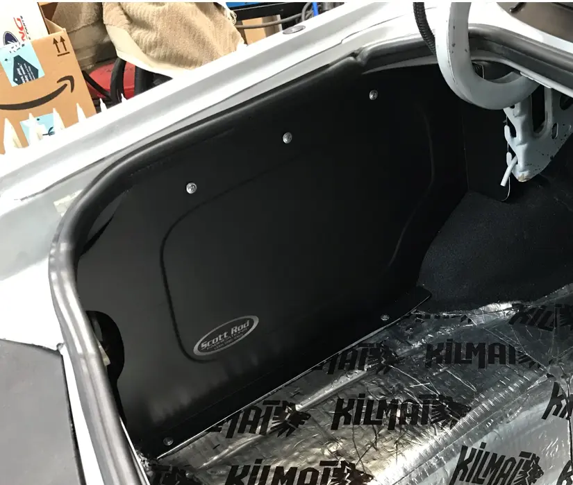

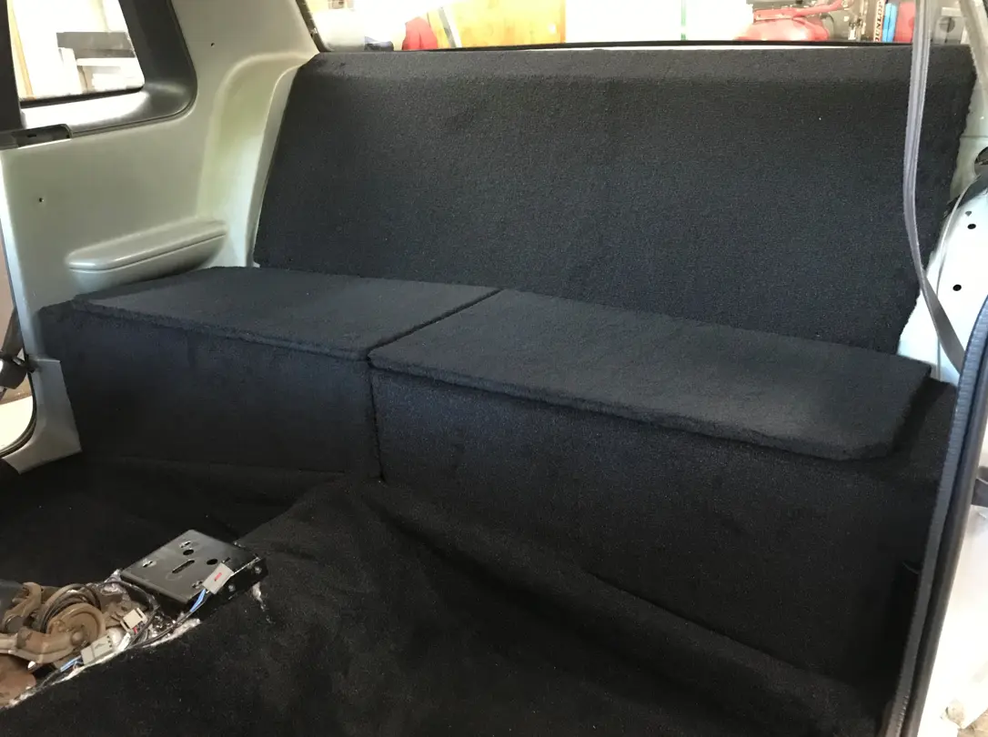

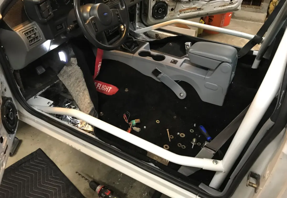

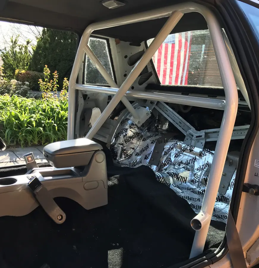

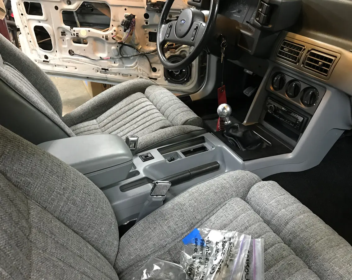

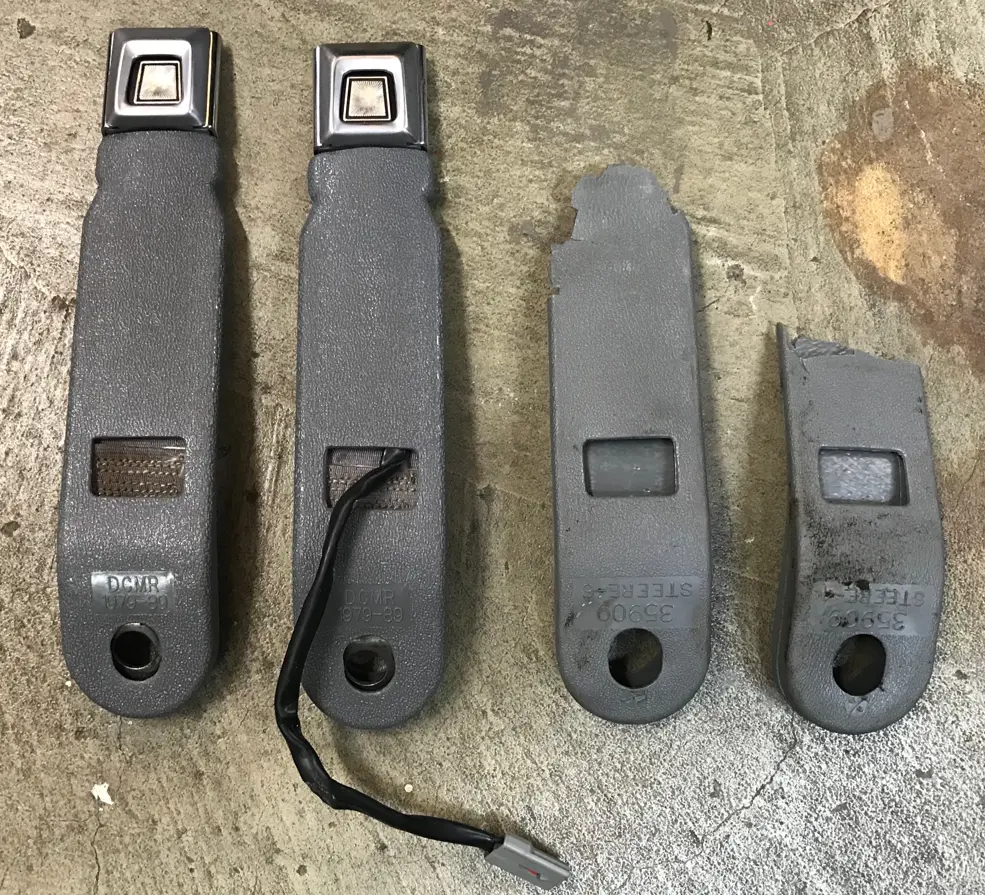

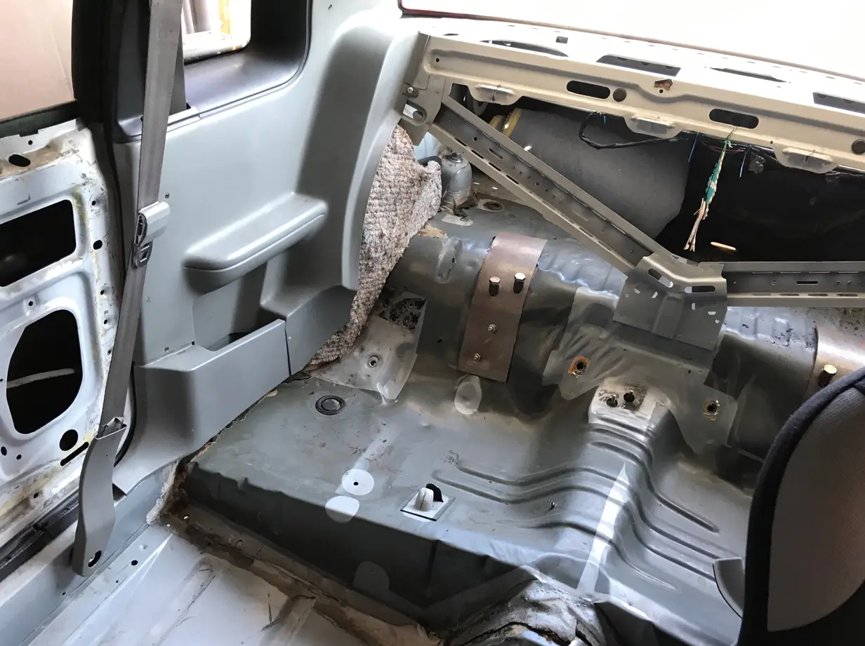

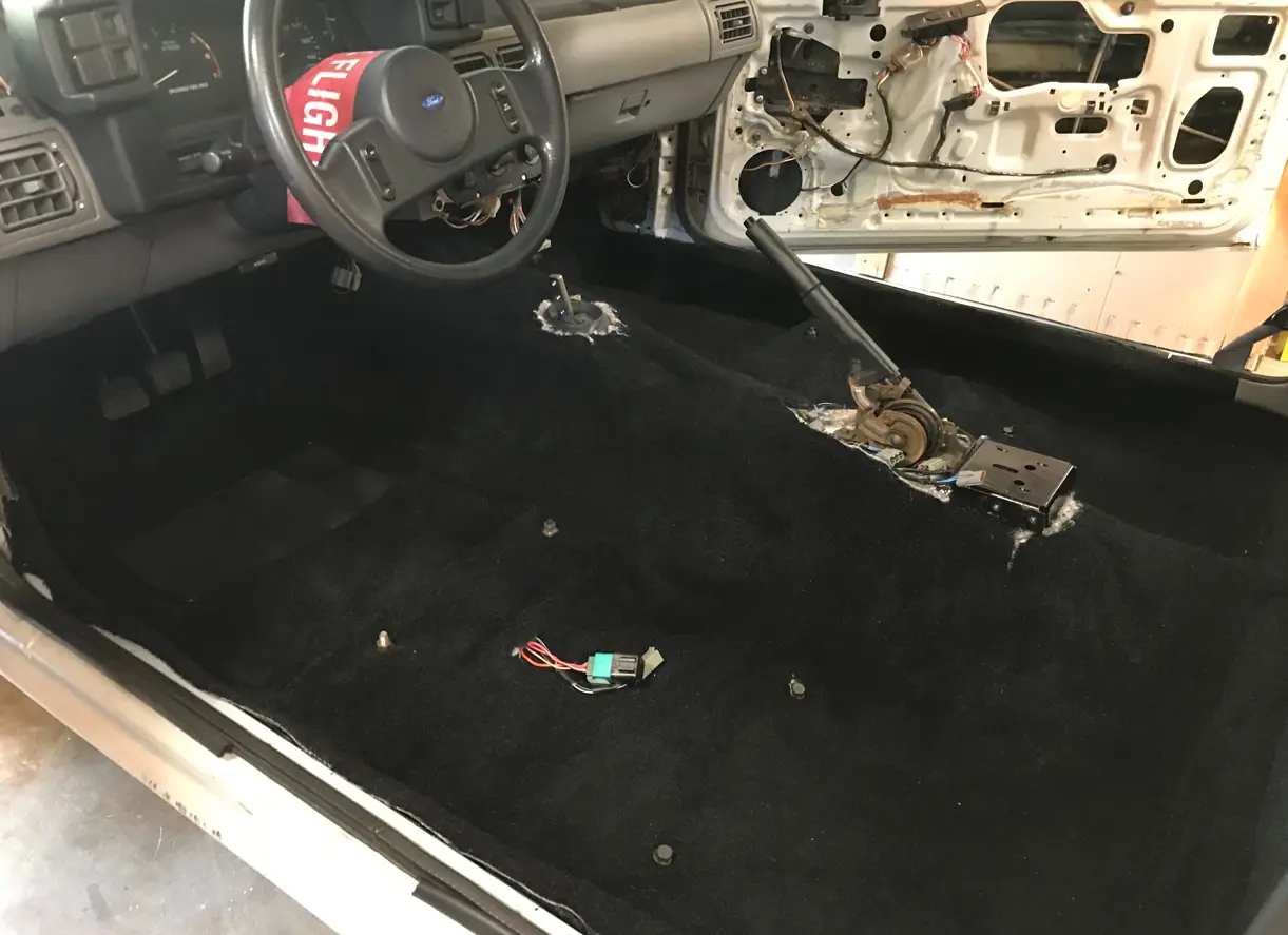

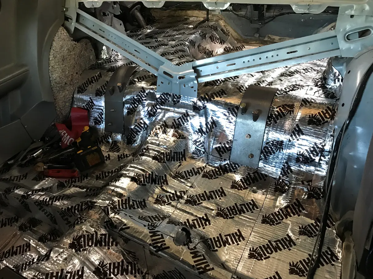

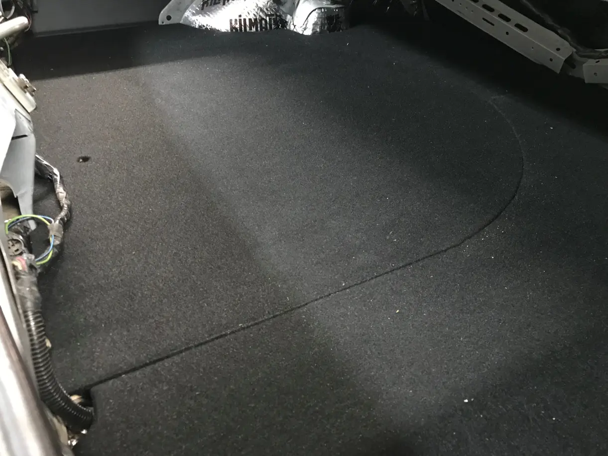

Sound deadening, carpet, & seats

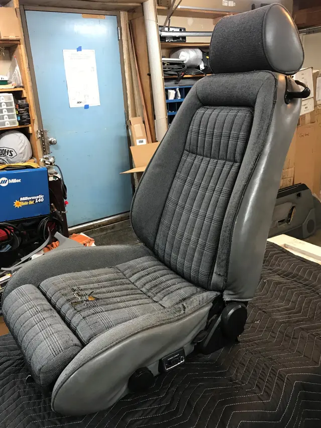

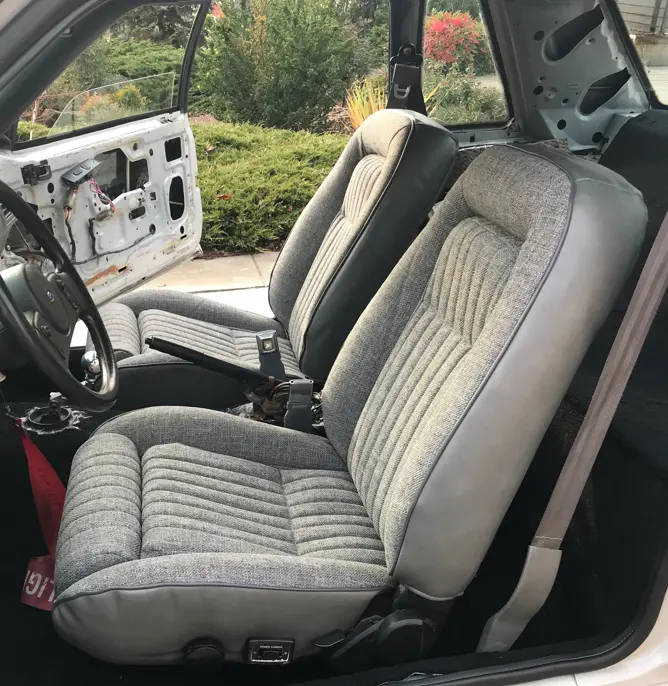

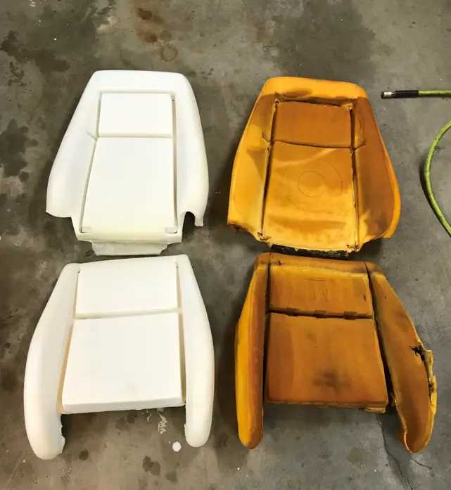

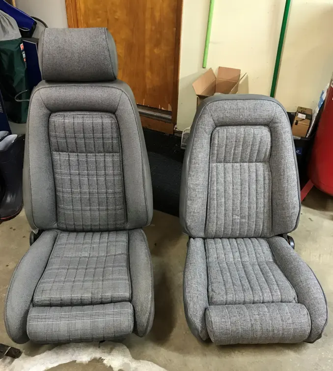

Scored some seat cores locally for $150
One seat down:

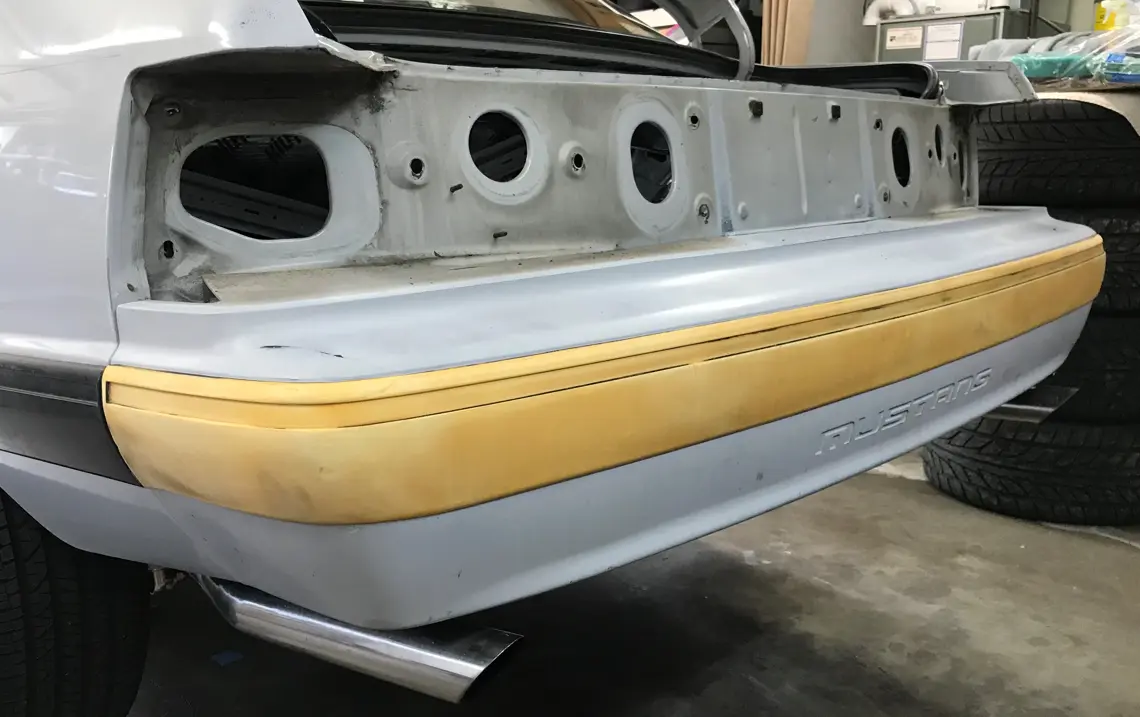

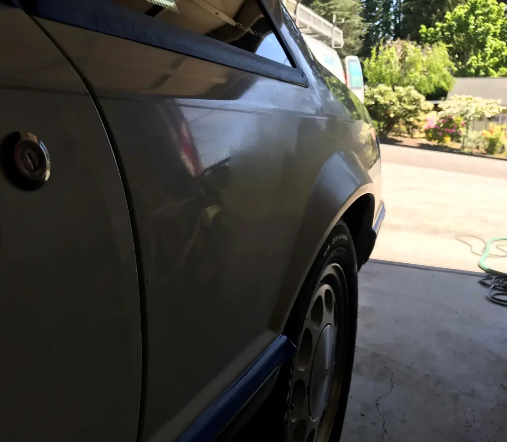

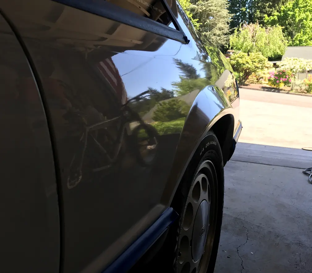

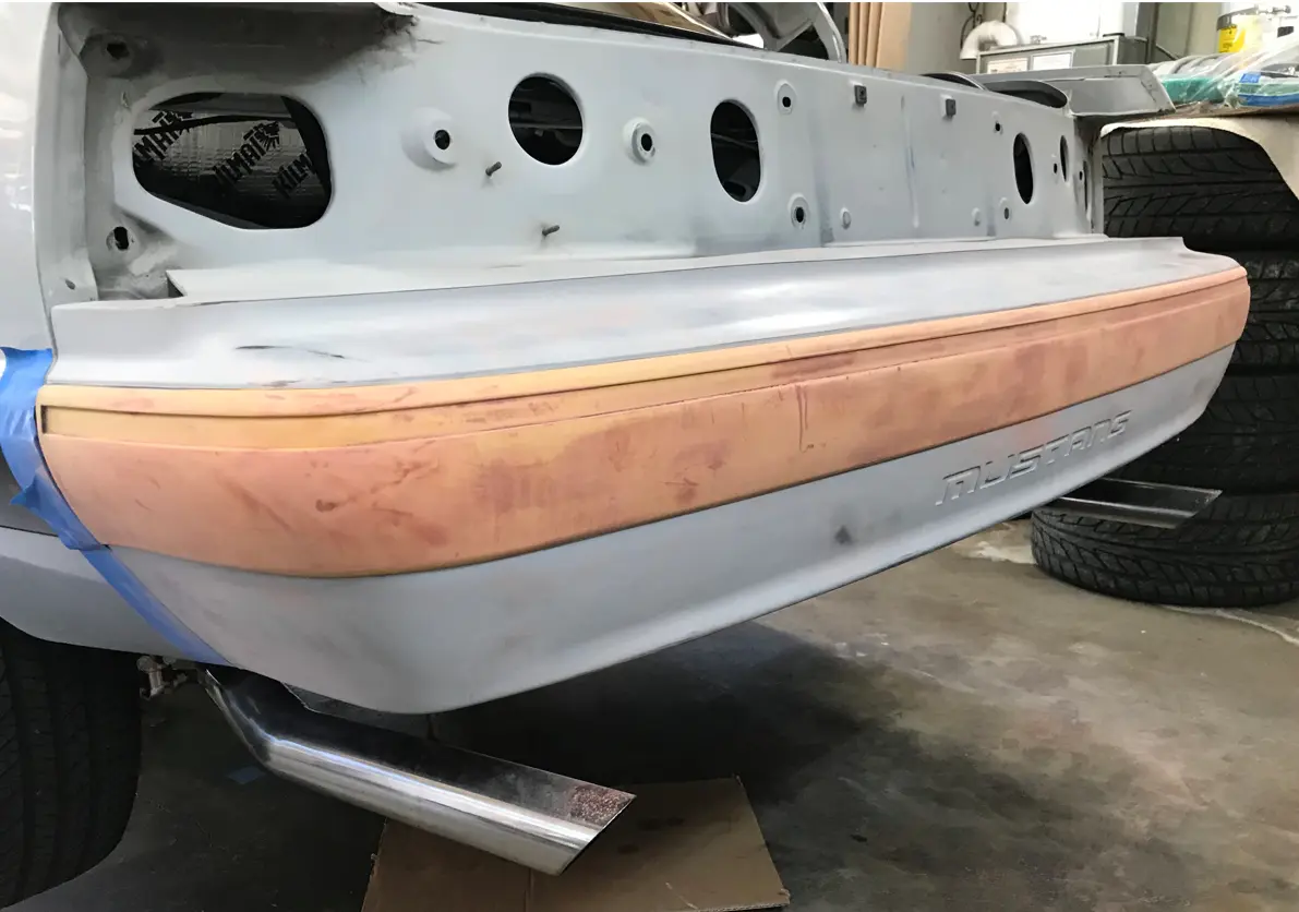

Reviving the original paint and respraying the rear bumper! Chemical Guys stuff worked pretty well for me.
It's kind of hard to tell in photos how faded/oxidized the paint was before, but this comparison pic should help:
Shined up enough to keep me happy for now!

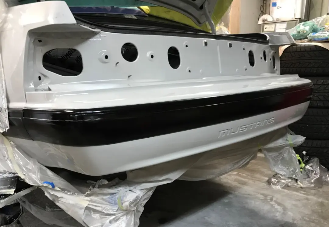

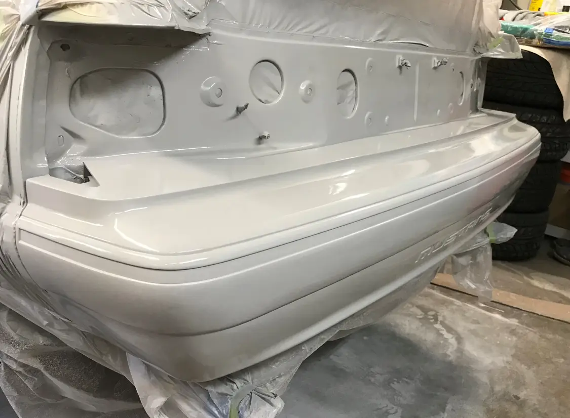

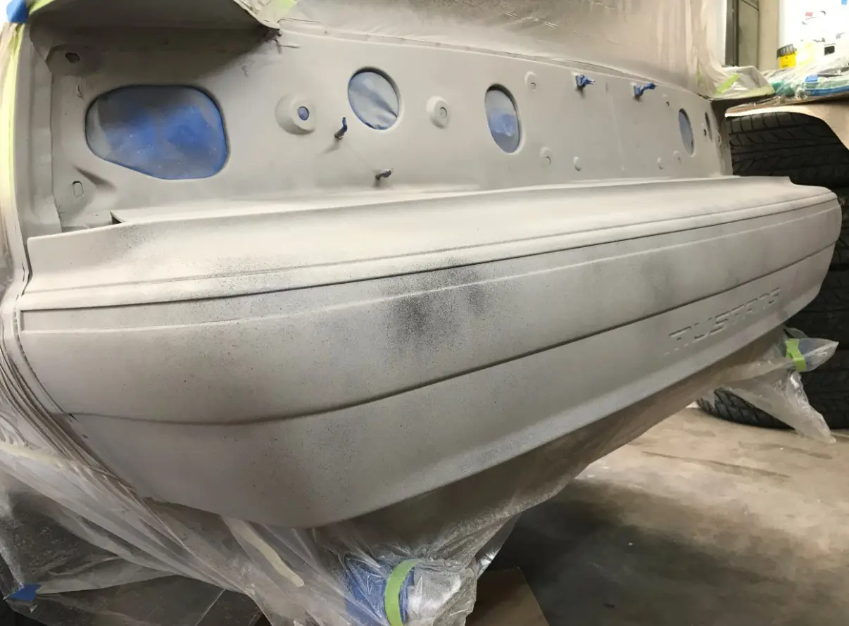

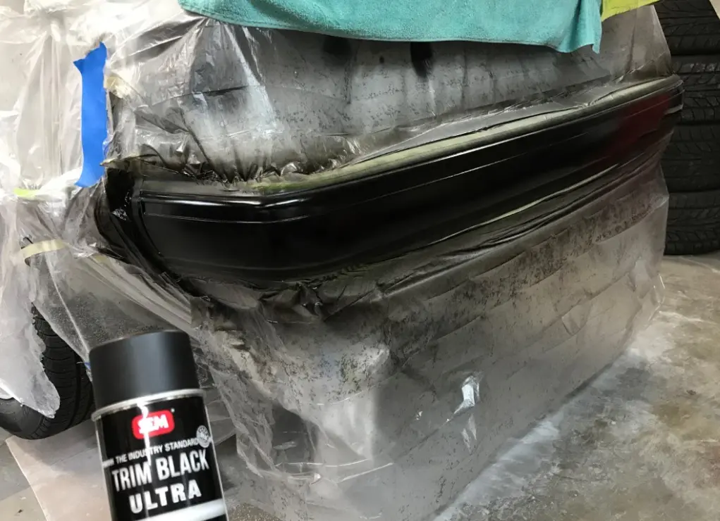

Now to address the rear bumper
filled and sanded
Primed
Basecoat/clearcoat

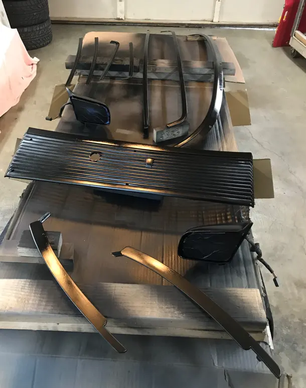

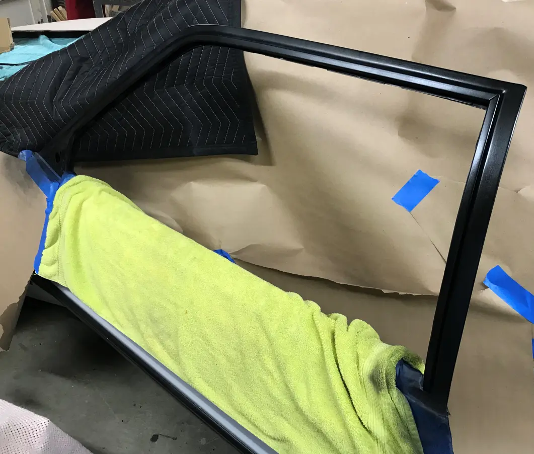

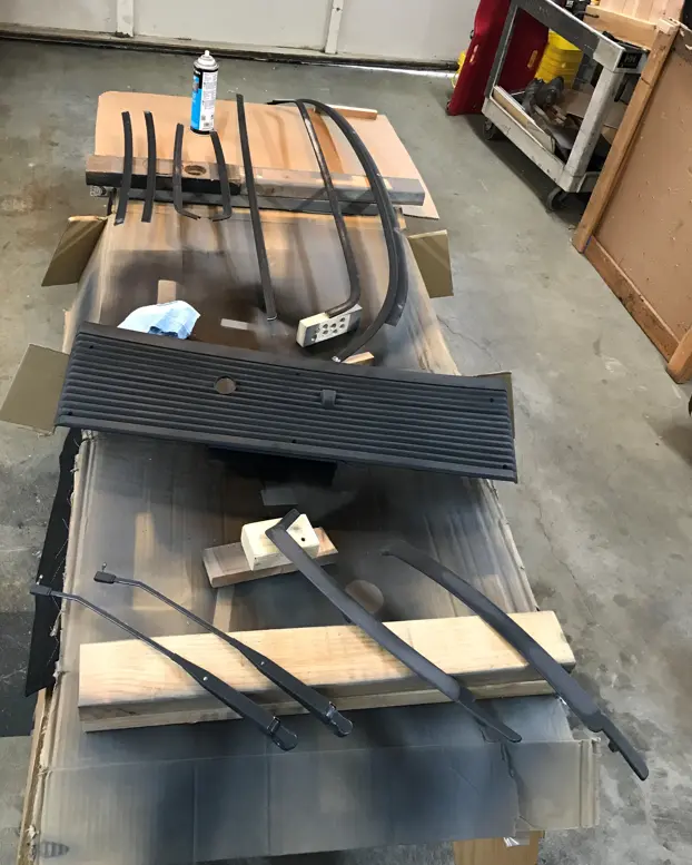

Trim! SEM trim black again. Can't say enough good things about it!
Done!

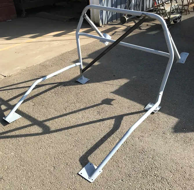

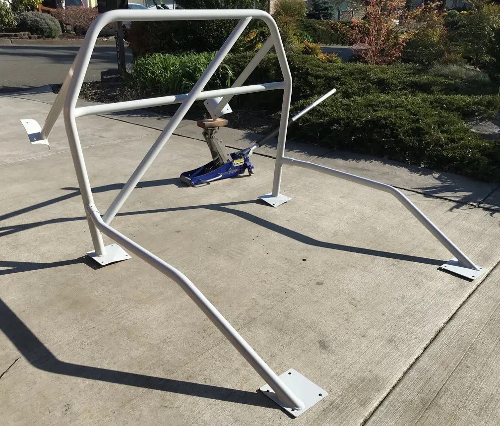

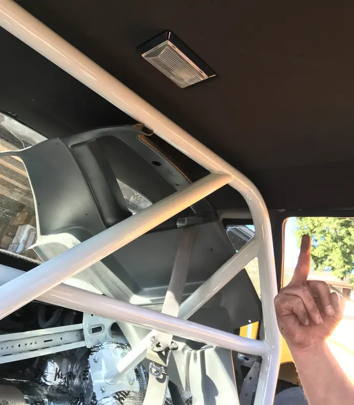

Nice! I love the roll cage, I want to do that one day. How did you paint the rear bumper? Is that spray can or a real gun and paint?

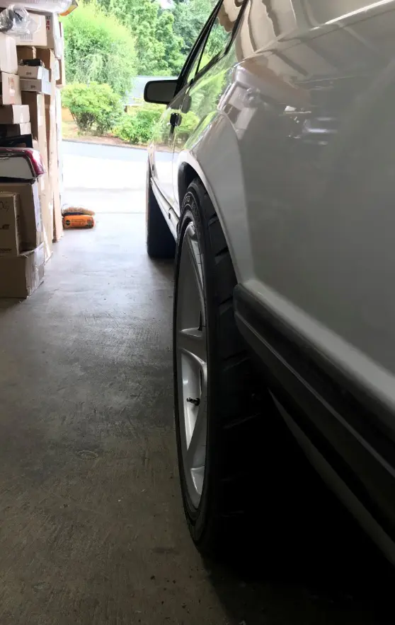

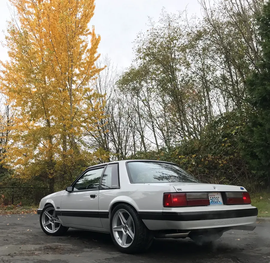

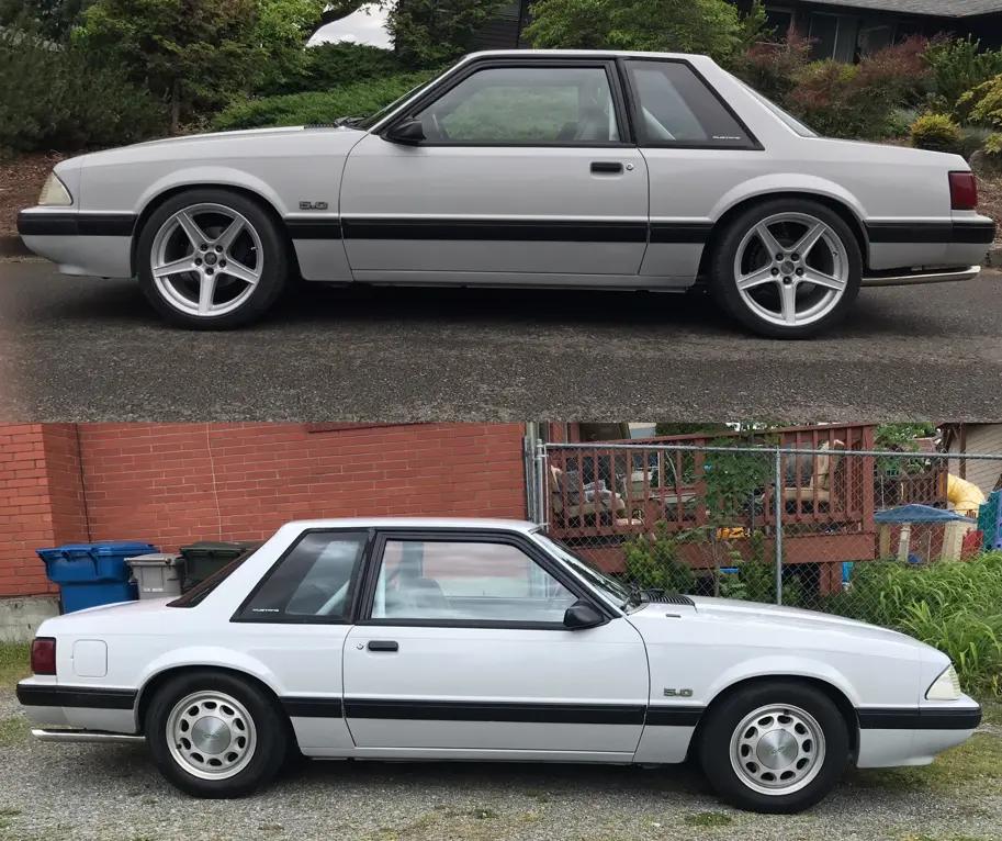

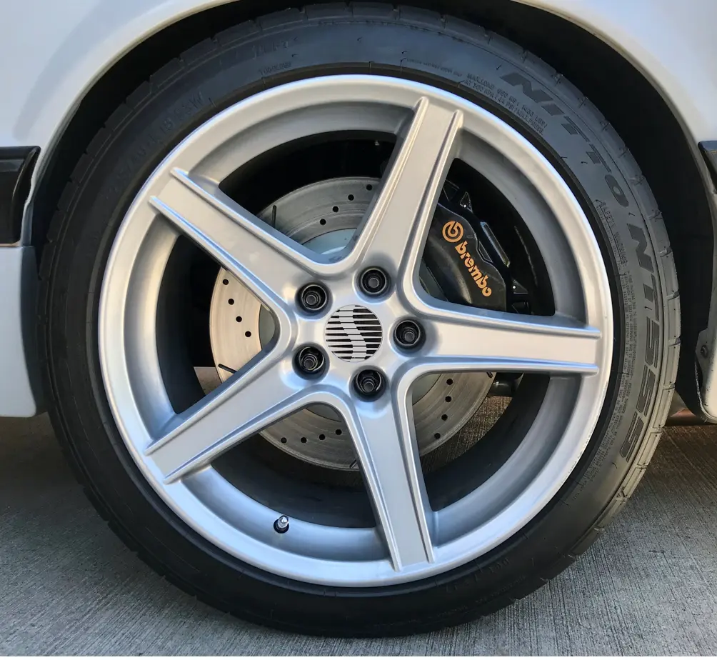

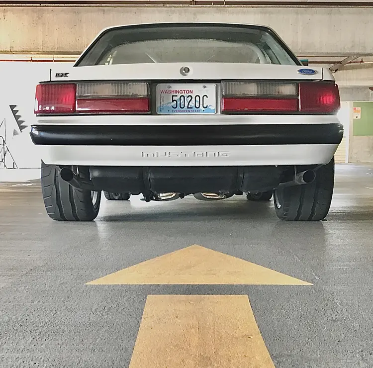

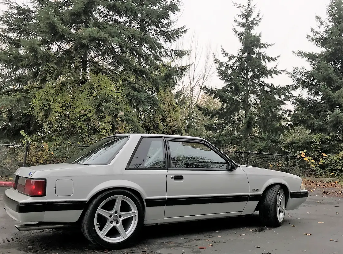

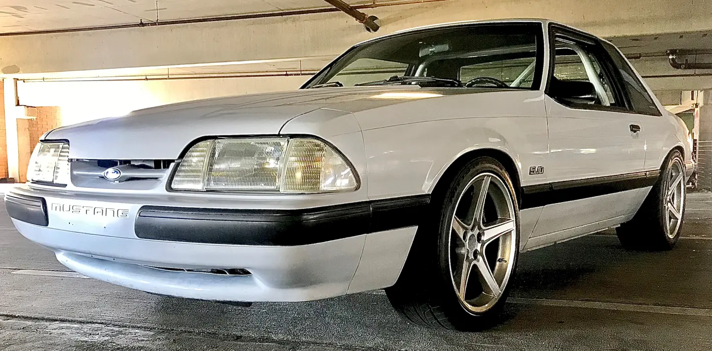

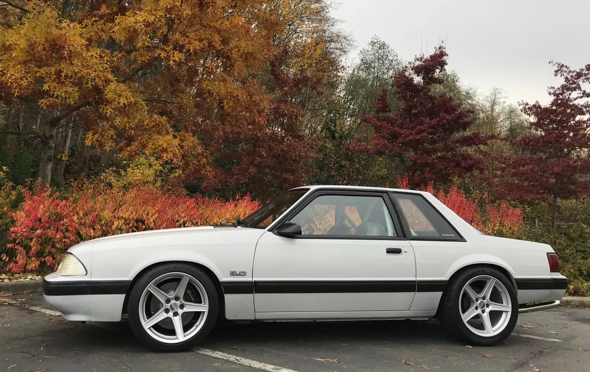

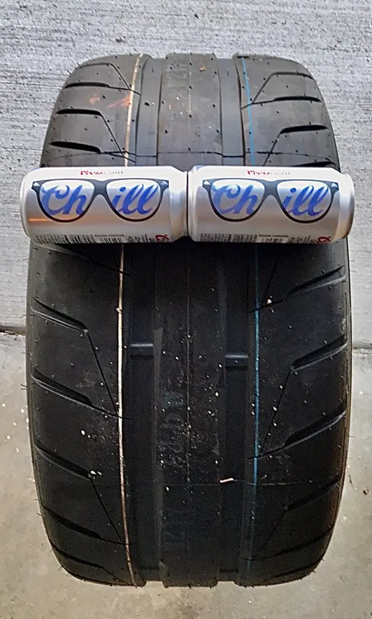

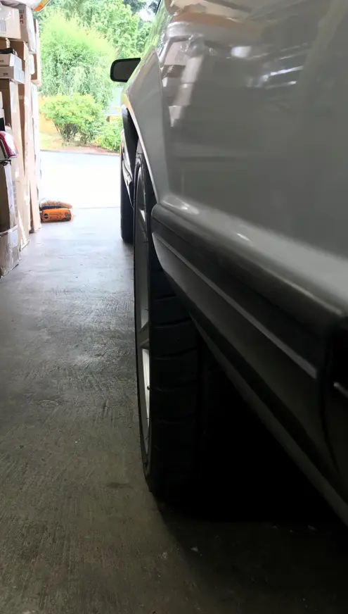

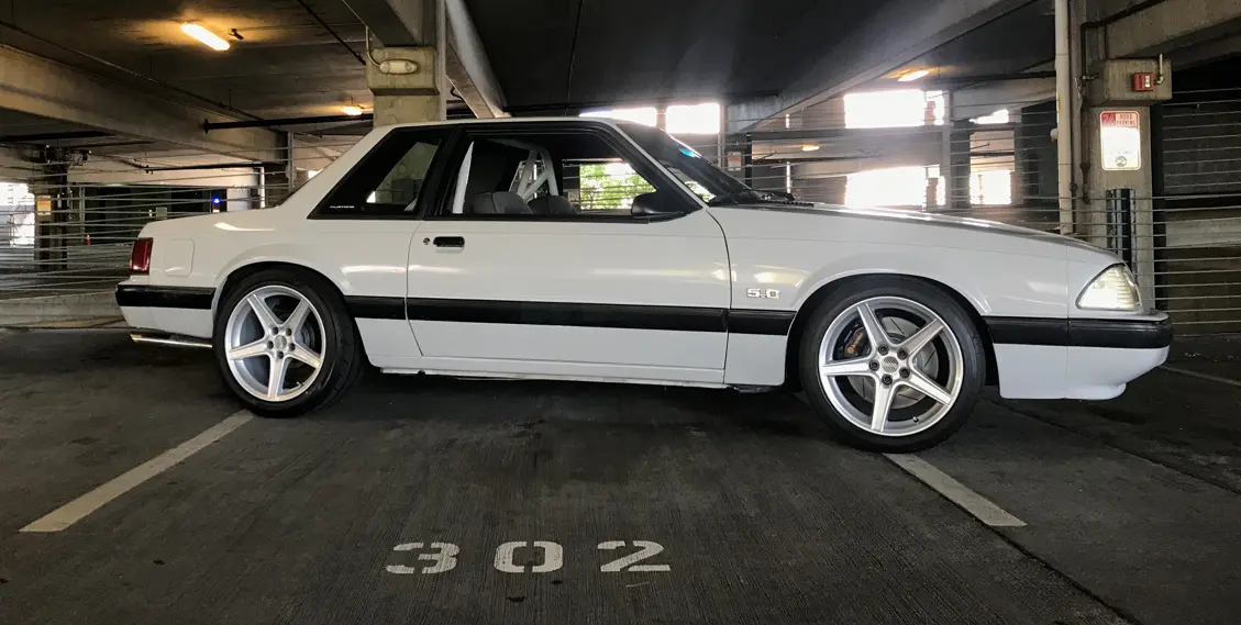

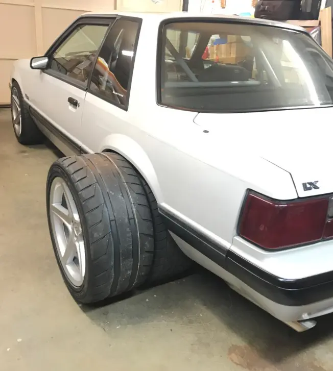

After a little drive time on the new coil overs, I decided it was time for more rear tire. I snagged a couple 18x10's saleen reps for the rear and some new 295/35 Nittos.
Before with an 18x9 and 265/35 Nitto
Aaaaand after:rock:

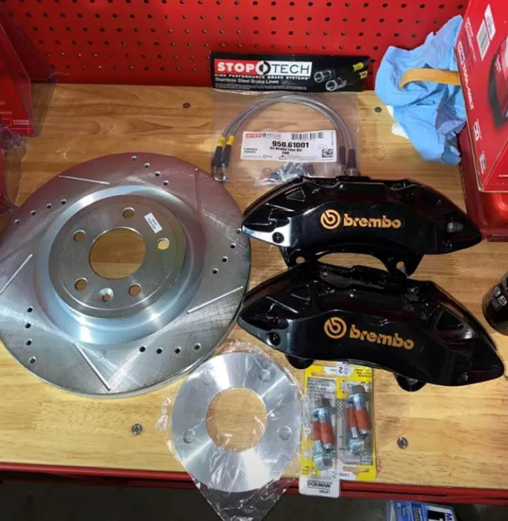

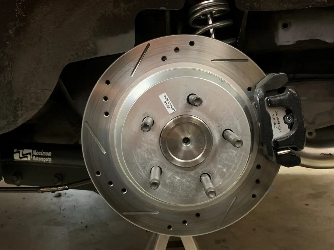

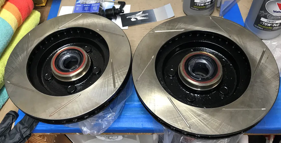

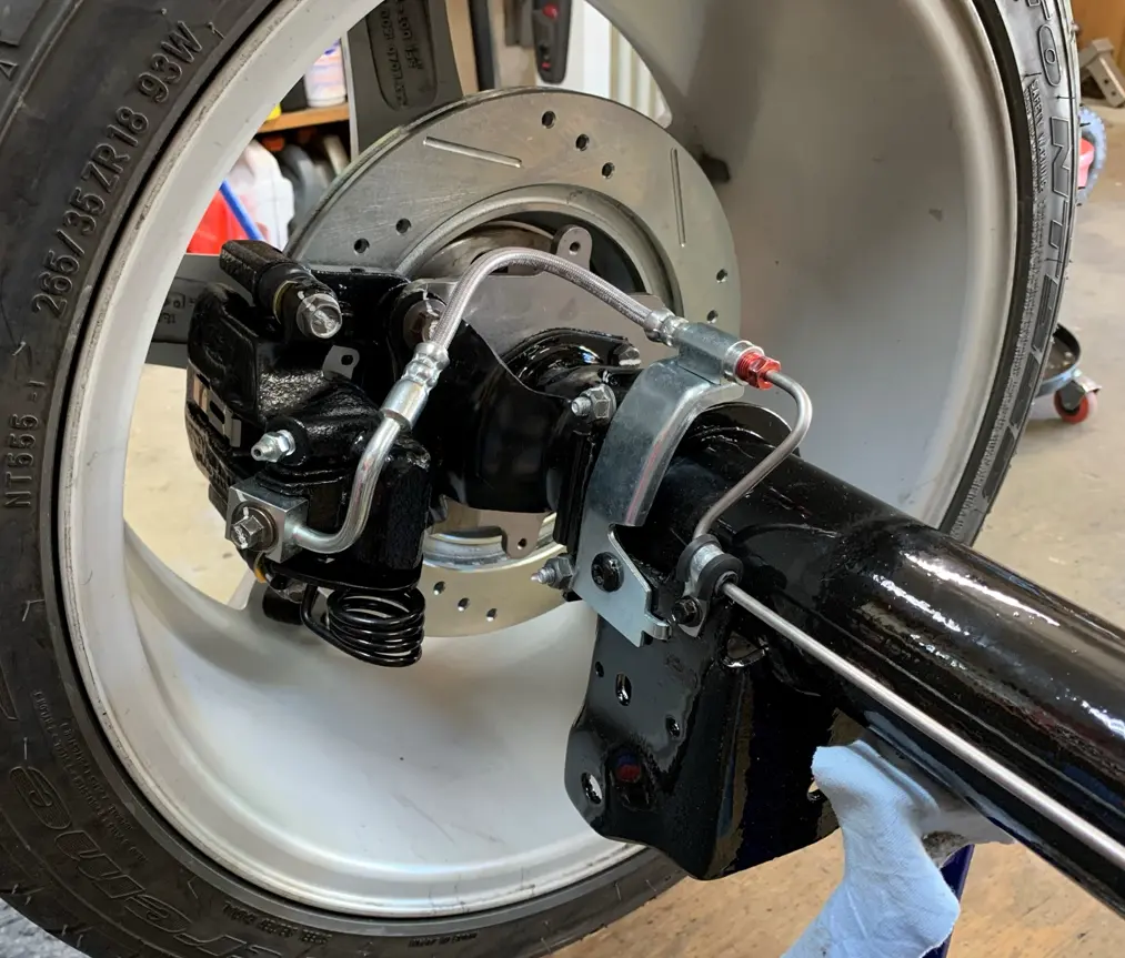

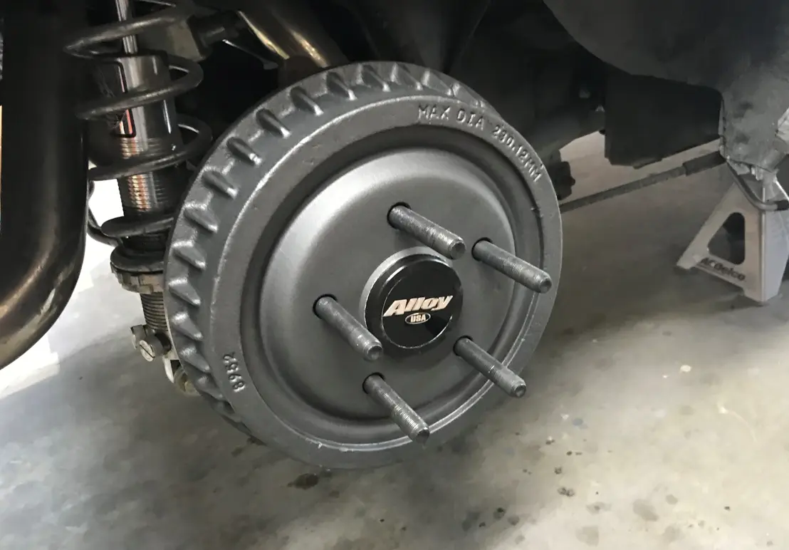

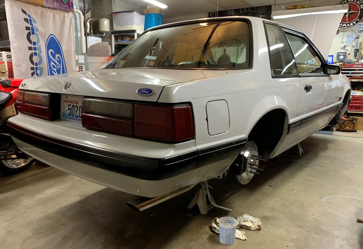

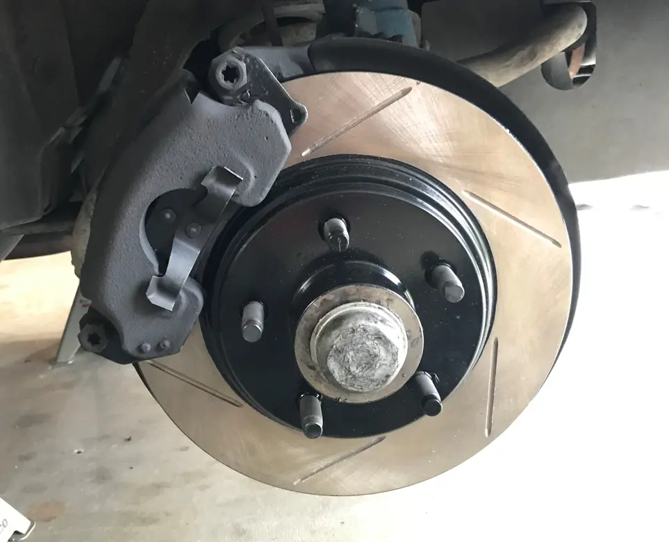

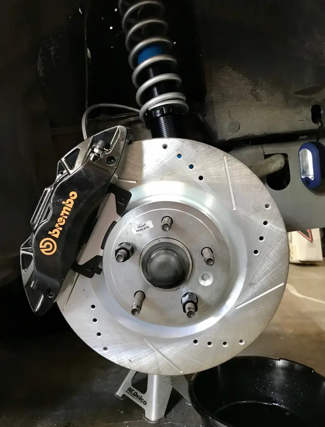

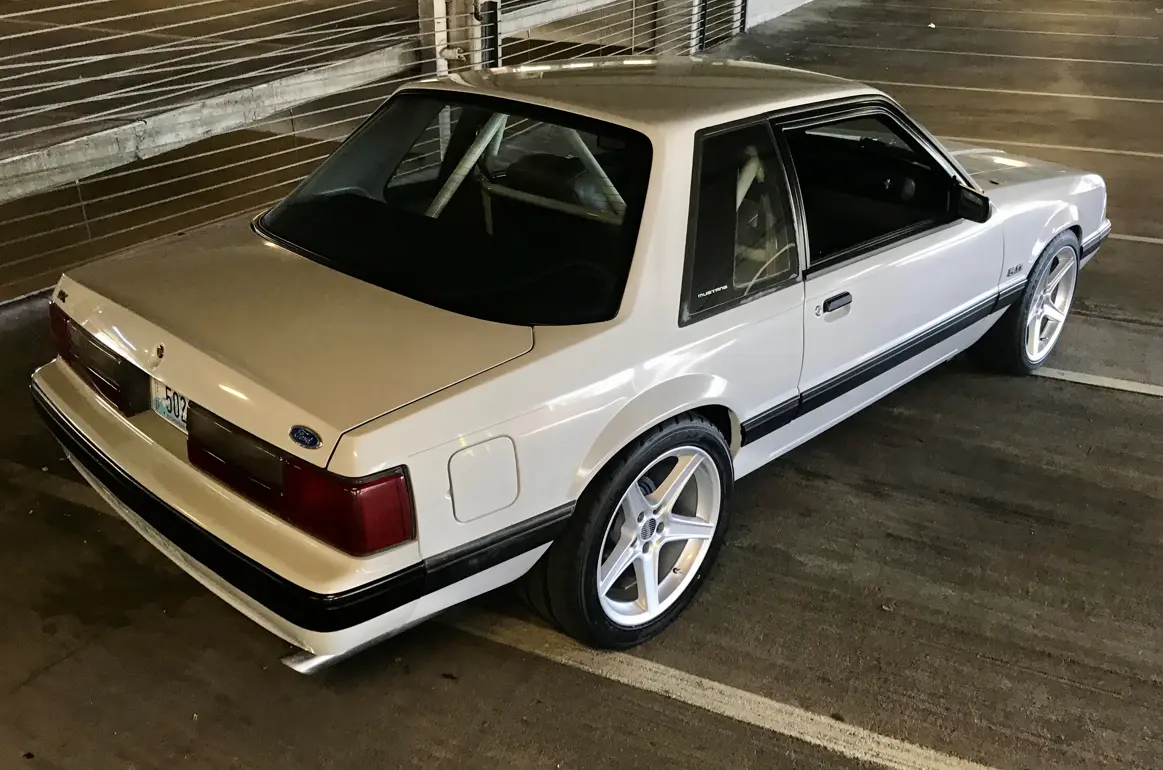

Empty parking garage cell phone photo shoot time! It quickly became evident that the new ATS Brebmo's and big, shiny 13" front rotors made the rear drums look absolutely PATHETIC.

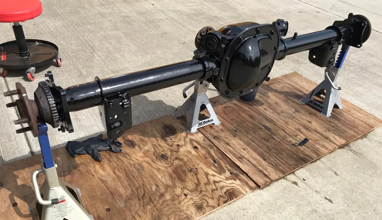

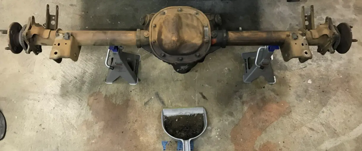

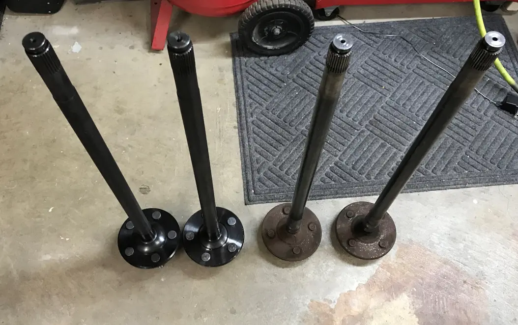

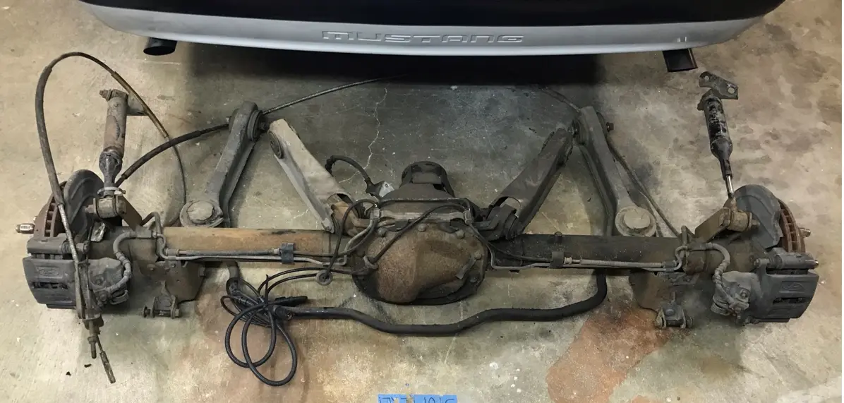

NOW....time to address those puny rear drums. I scored a factory 3.73 geared 8.8 from an 88 T-bird to start building.
Stripped and wire brushed
Pressure washed & POR15'd

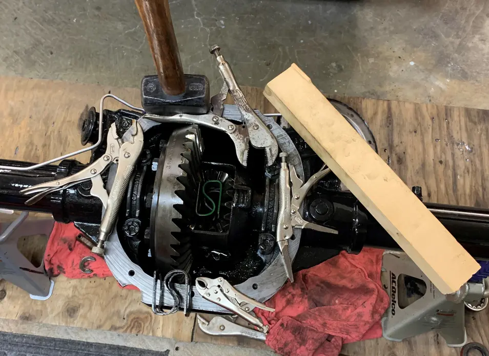

Trac Lok replaced with the M-4700-c carbon fiber disc kit.

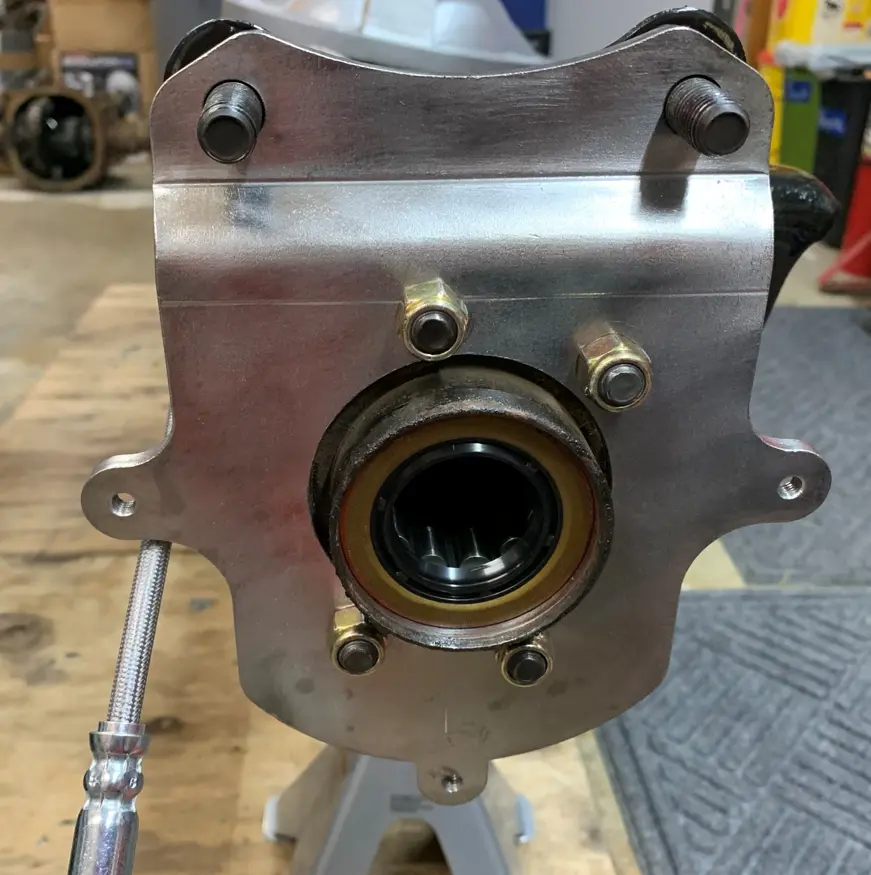

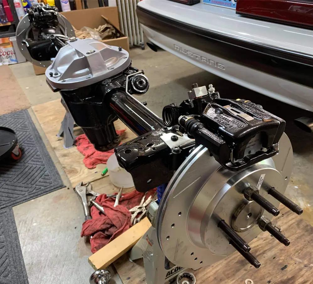

New axle bearings, seals, SS lines, and NRC cobra caliper brackets
Like a piece of jewelry!

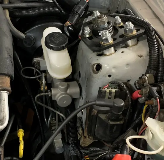

And the PITA 93 Cobra Booster/Master swap

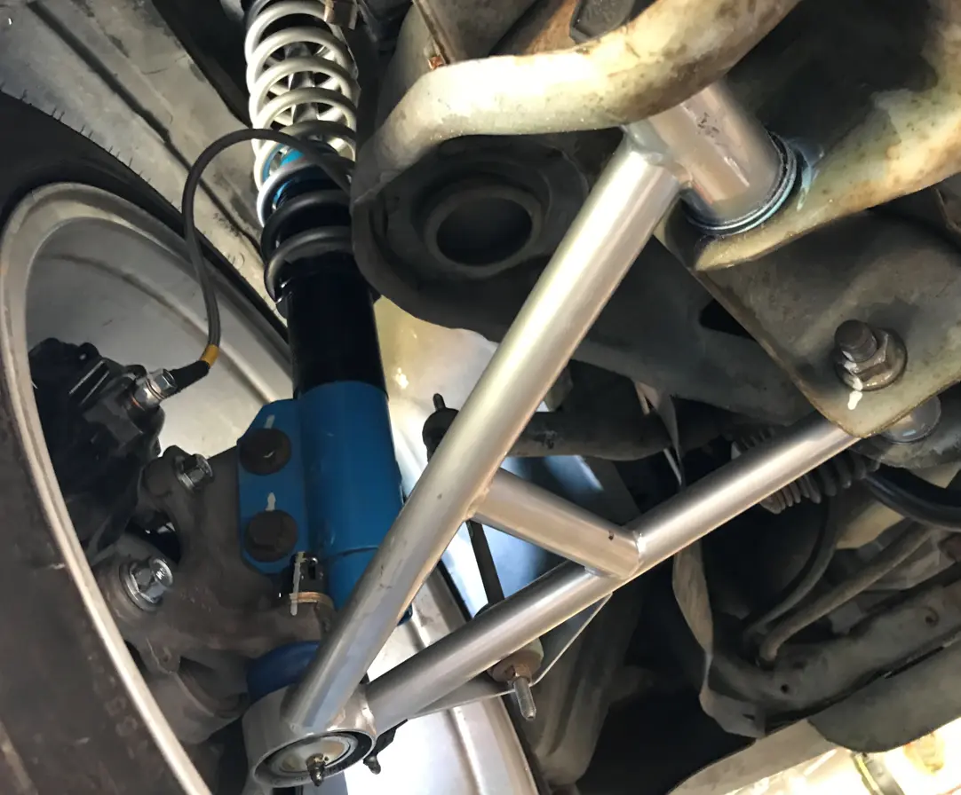

Done! New MM Extreme Duty control arms as well....more to come!:D
Thanks!
For the bumper, I used a spray can kit from Automotive Touchup. It matches pretty well, no complaints for $100 worth of material and a little bit of my time!
Damn! that looks good! I'm going to do the same on mine I think, I just want to color match my front bumper and not have a mismatched car
Love the seats too
