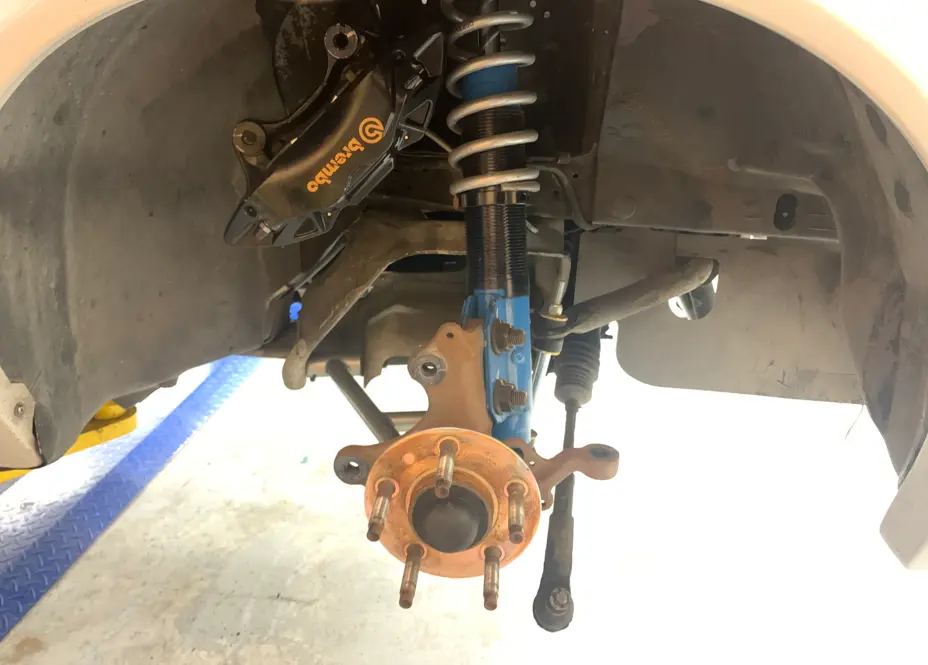

I spent a little time testing brake lockup as well. Right now the proportioning valve is all the way opened & I cannot get the rears to lock up. I somewhat think its my older 265 Nitto 555's up front compared to the fresh 295 NT05's out back. Anyone experienced anything like this before?
Which Brembos are those? The ATS Brembos?
While you do have a lot of rear grip, your brake bias is skewed more to the front. You can change out the rear calipers from the SN95 38mm units to the 93-97 Taurus 43mm units. Direct bolt on and uses the same parking brake hookup. That should get the bias closer to 70/30 and give you more rear brake, which you can take advantage of with the stickier/wider rear tire..
Downside is you might need to swap from the 93 cobra MC to the 94/95GT MC. Since you are upsizing your rear caliper volume, you need to go up a 1/16" on the MC bore size.
I know several folks running the above ATS/43mm combo with 94/95 GT MC and love that combination.

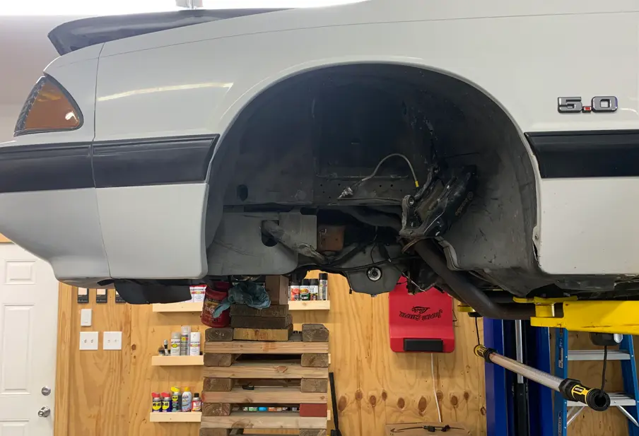

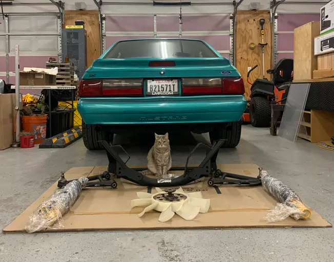

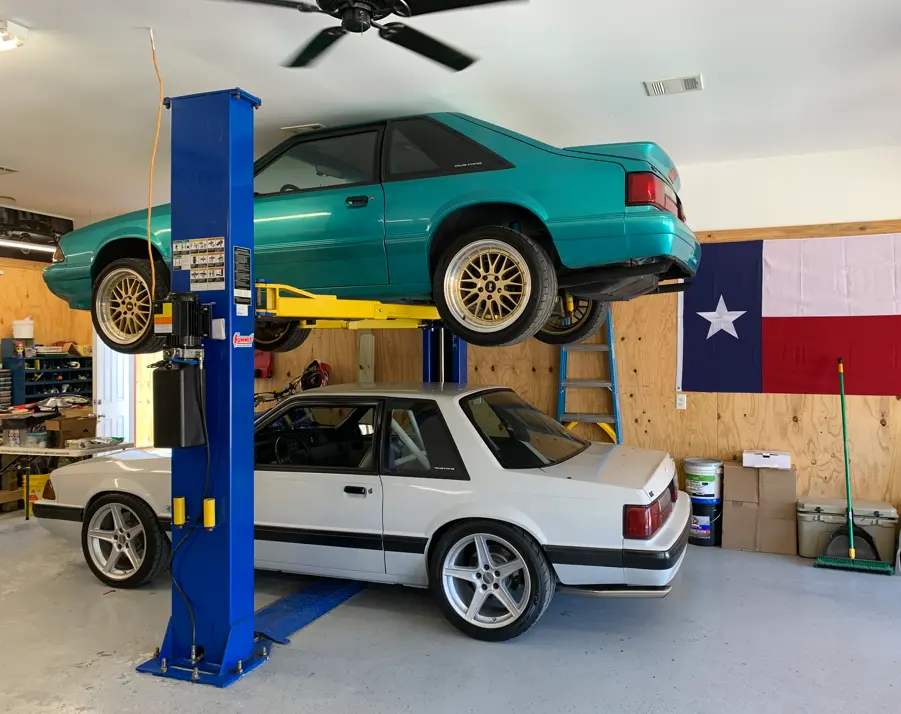

Dang, been a while since I've posted! I enjoyed cruising the coupe last summer in Washington, snagged a calypso hatch for a steal of a deal and spent some time working on it, and relocated from WA to TX at the end of last year. Got the new house/shop all dialed in and am finally getting back to work on the coupe!

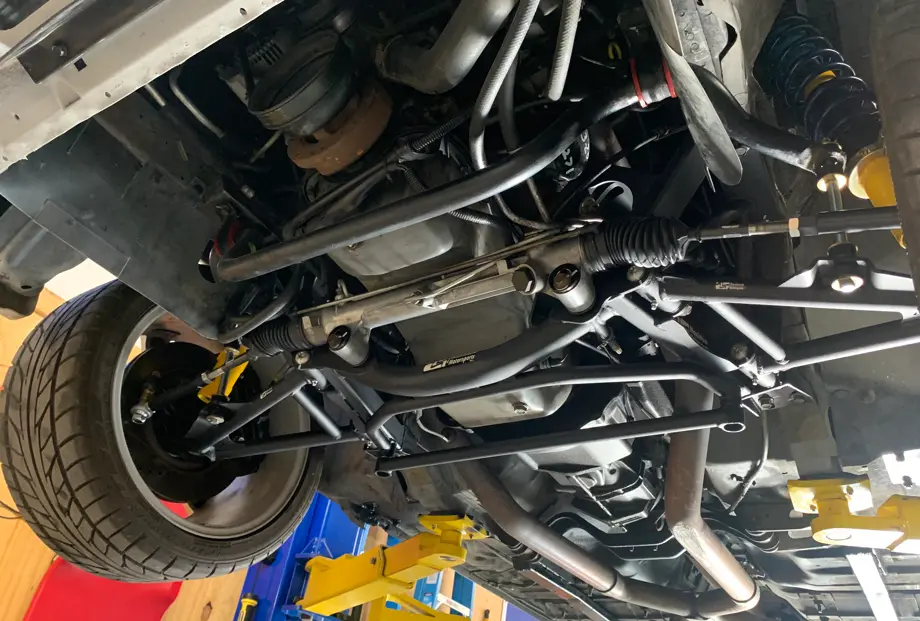

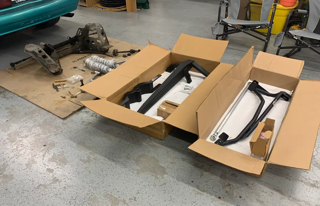

Up front: Got rid of the stock K Member, old Tokico blues, UPR A-arms, UPR coilovers, and leaky fox steering rack. Replaced with MM K Member, 0 offset A-arms, Bilstein/MM coilovers, and 04 Mach 1 ZK steering rack.

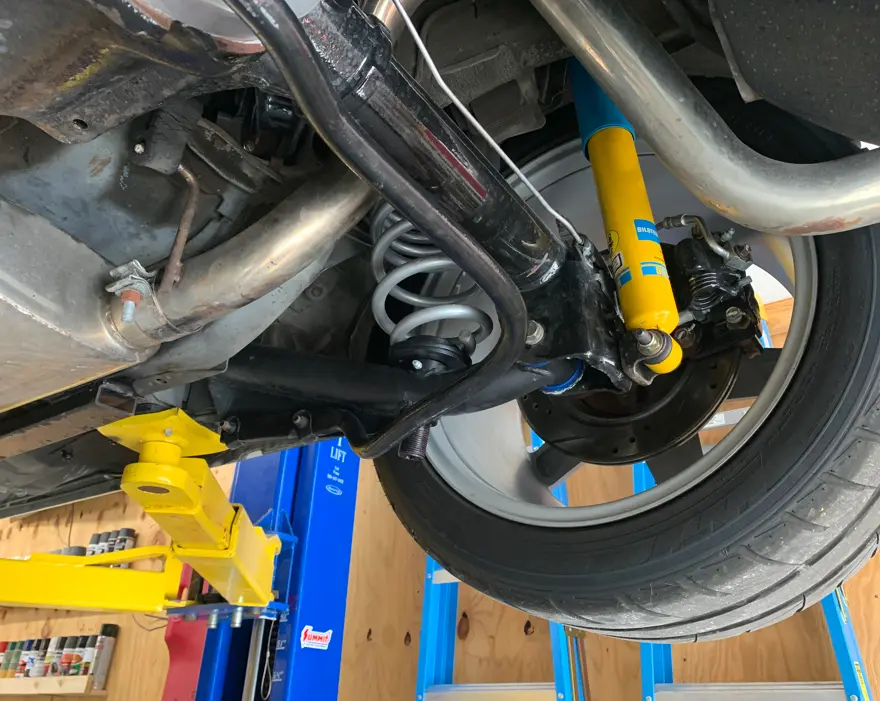

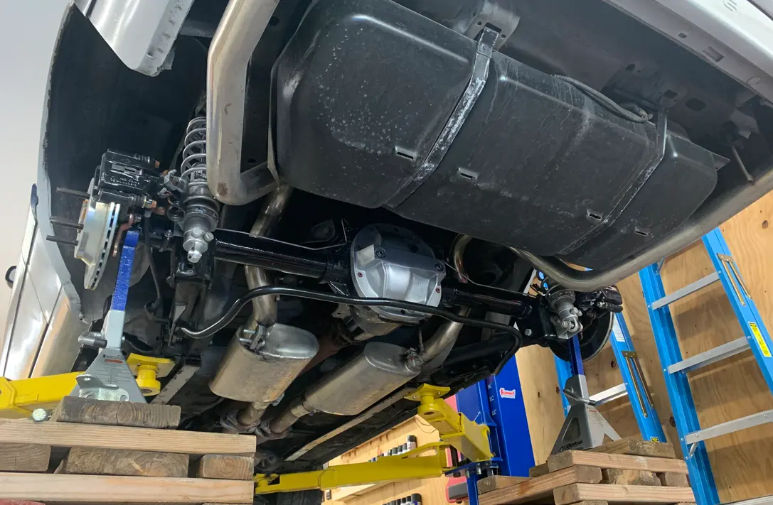

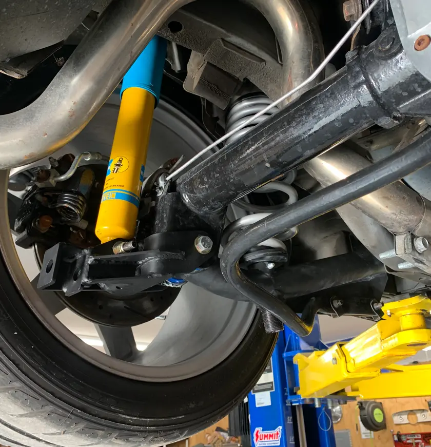

Out back: I swapped the NVH nightmare of the MM Extreme Duty LCA's & rough riding Viking coilovers. Replaced with MM Heavy Duty Adjustable LCA's, Torque Arm springs, & Bilstein shocks.
Next up is the MM panhard bar (once I pick up some tailpipes that clear...Pypes do NOT), MM rear sway bar, and the MM Torque Arm! :cheers:

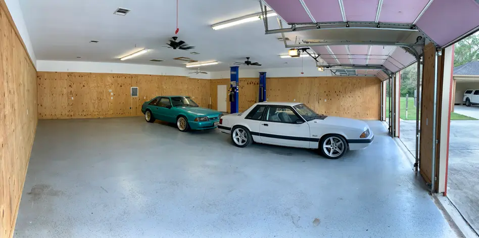

Wow! What a garage! Obviously I need something similar...
Bill
