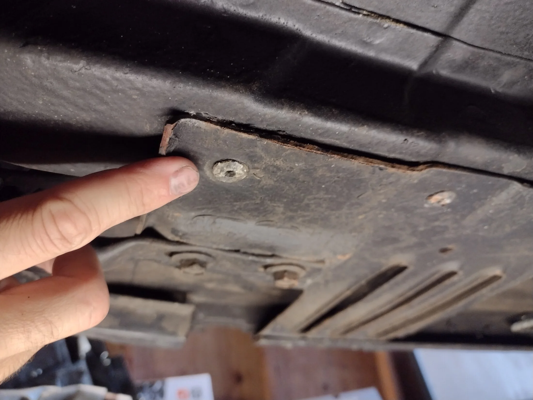

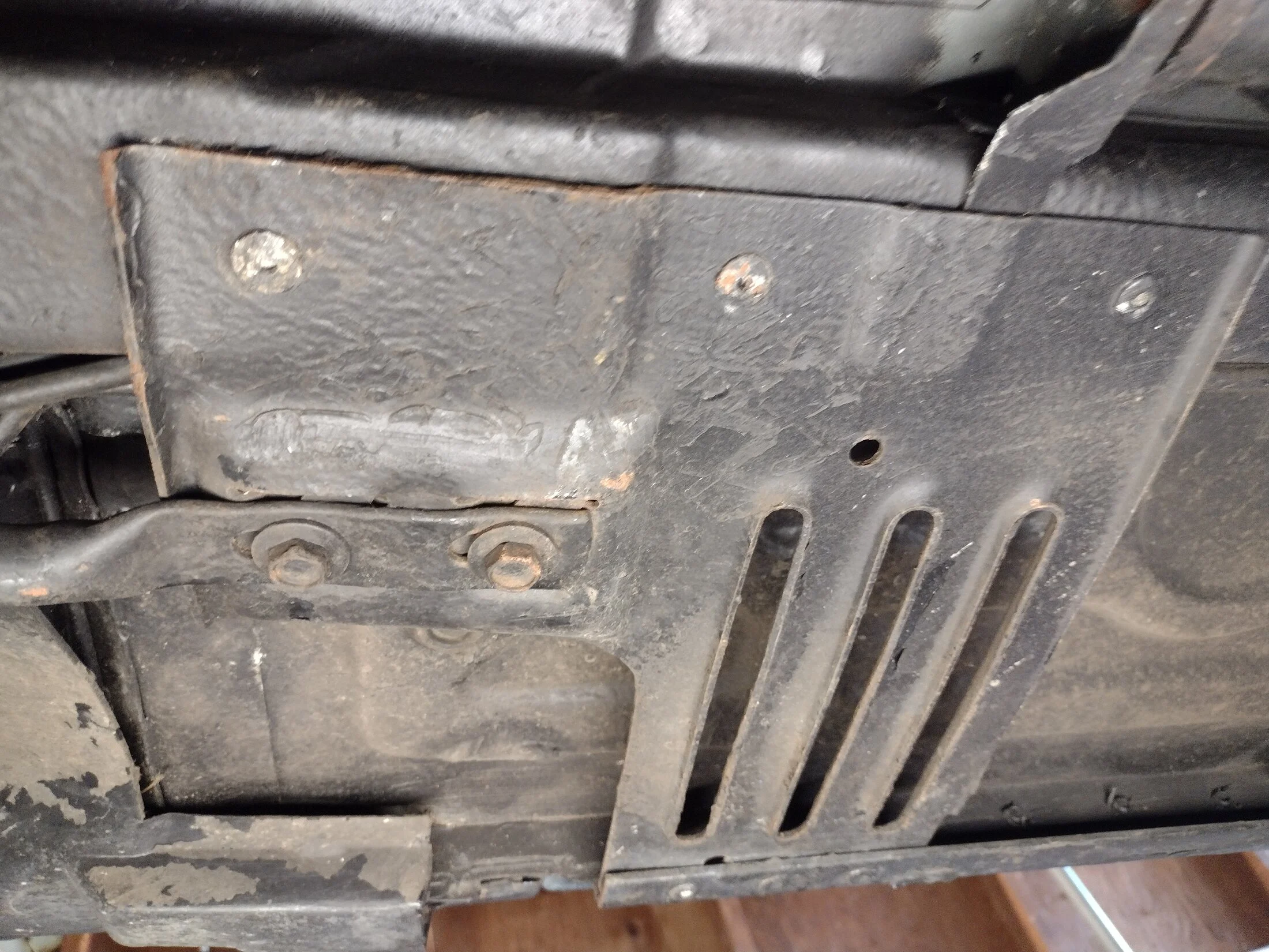

Hi everyone,
This is my first convertible, I've been trying to track down a front end clunk noise that gets really loud over bumps.
I haven't narrowed it down to this, but it's definitely loud if I push up on the tubular bar that attaches to this area where the rivet's are.
Can I replace this rivet? Is there a better option?
Thank you

All day long. Not sure what the size is but it could be one of those 1/4” ones like on the windows. Hopefully it’s a 3/16” or smaller and a standard River gun will work.
I got a rivet gun from Harbor Freight that does 1/4” and it’s run off an air compressor.

I don't have a rivet gun so I'll have to buy one. I just drill out the old one correct?
Correct. Typically you can use a drill bit that is larger than the hole and just drill the head off the rivet. Once that is down you use a punch and hammer to remove the body of the rivet.
I have found if you have the right size punch, its easier to hammer out the pin, then drill the head off....
