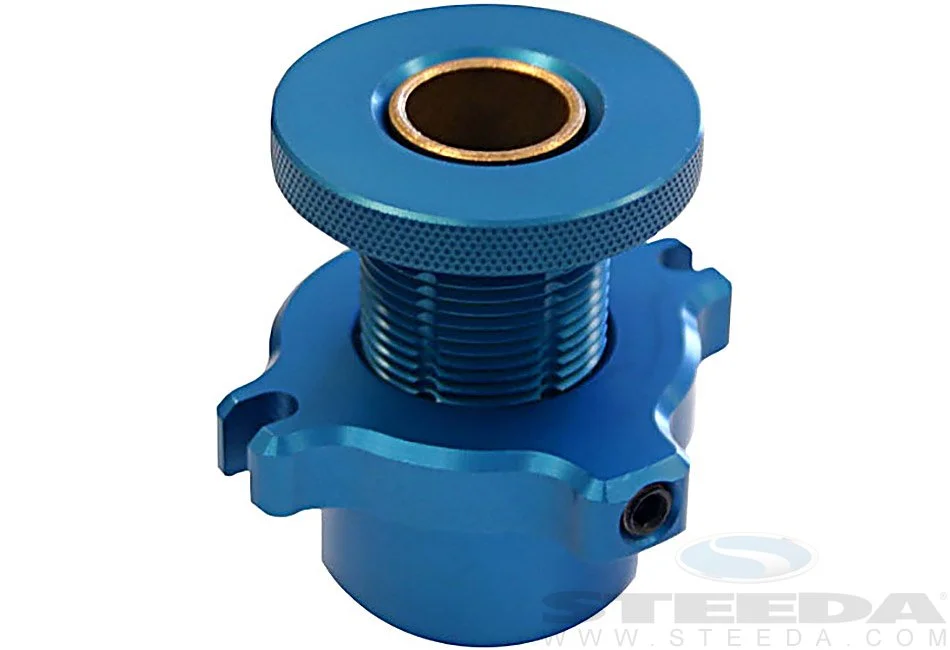

[url=http://www.summitracing.com/parts/SDA-555-7021/]Steeda Autosports 555-7021 - Steeda Autosports Firewall Cable Adjusters - Overview - SummitRacing.com
Steeda firewall adjuster. $40
