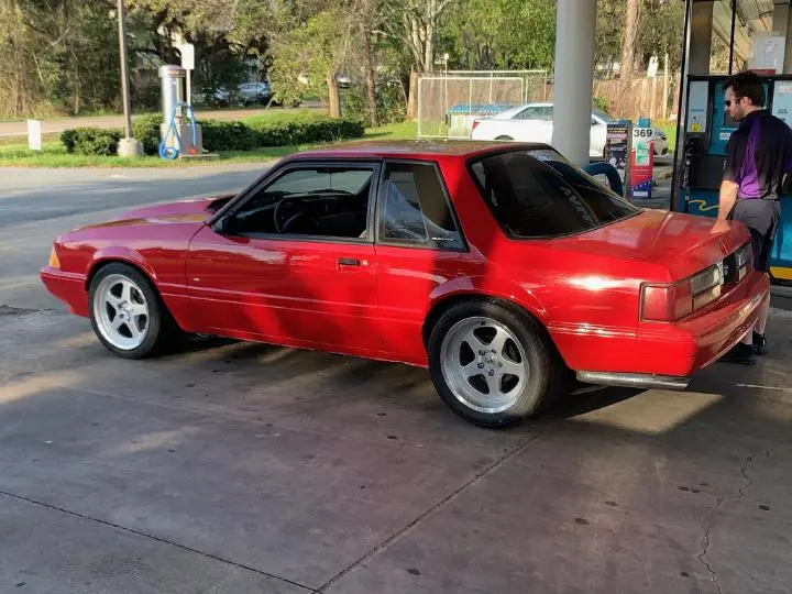

Under load the car will run all day. It sporadically dies while coming to a stop. Thanks in advance for all the help!!! Pic attached cuz we like pics
