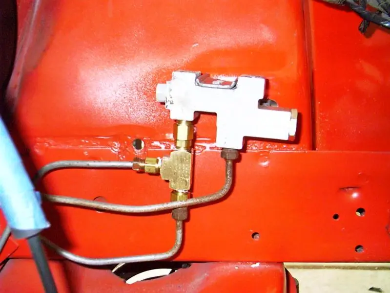

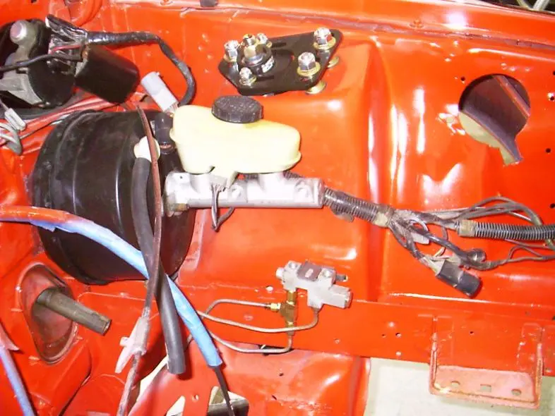

OK - I was able to locate all of the fittings described in Matt Bobbit's diagram and piece together the 3-2 conversion. I found everything at a pretty well stocked hardware (S&W Hardware in Plymouth MI) and short of it being in brass, it's exactly the same as the $30.00 kit sold through Maximum Motorsports for about $13.00. I scored the M-2450-A plug at Dallas Mustang (for $7.99 - $15.00 for shipping "You can pay me now or pay me later") so that should be arriving this week. Thanks again for all the input contributed to this conversion, I'm very greatful!!
Best Regards
Peter B
Be careful with the M-2450-A Plug as Ford Racing had a batch go out with the wrong thread pitch and will not work. The Good Ones are Brass Color and work perfect and the bad ones if I remember correct are Steel colored.
Thread sizes
The thread sizes are 1/8 in. Brass tee (#103-2) and 1/8 brass coupling (#902) - between those and two other miscellaneous metric to inch fittings, it all seemed to go together pretty easily. Hopefully, I won't need to amend that statement after its on the road & running. It doesn't look like art but I don't believe it will stand out after the engine bay is fully populated.
