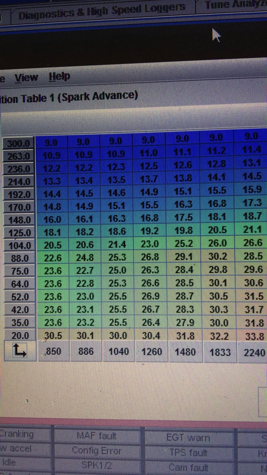

I have the timing synced and the car would start up and hold a decent idle. I know the WUE needs some work but I'm having some issues. I let it warm up to 180-185* and the fan will kick on. The motor seems to get harder to keep running and will die on me. I try to start it back up (in 85* temps) but is slugglish and hard to crank. I am assuming a setting is not pulling timing on my tune. Any help or direction will be appreciated..thank you!!
Ryan
**msq is below and a log of when it was heat soaked and didnt want to stay running (timing showed 30* seemed like a lot)

does the bouncing have to do with the timing too high?? i remember my old setup having high timing values in the first column example 19* then second column was 16*

Alright so the idle settings need some work along with the fuel table. If you look under 'Idle Advance settings' you can see that the ECU uses a separate timing curve just for idle, it is currently set at 20* [this is fine I may actually suggest we raise this later] this area of the tune also has the idle correction advance curve. this curve modifies the base timing to help control the idle.
I see that your car has a hard time obtaining a steady idle, i made a small change in the timing portion of the idle strategy.... when you load this tune make sure that you review the differences between your current tune and this one so you can see what i did to make these changes.
