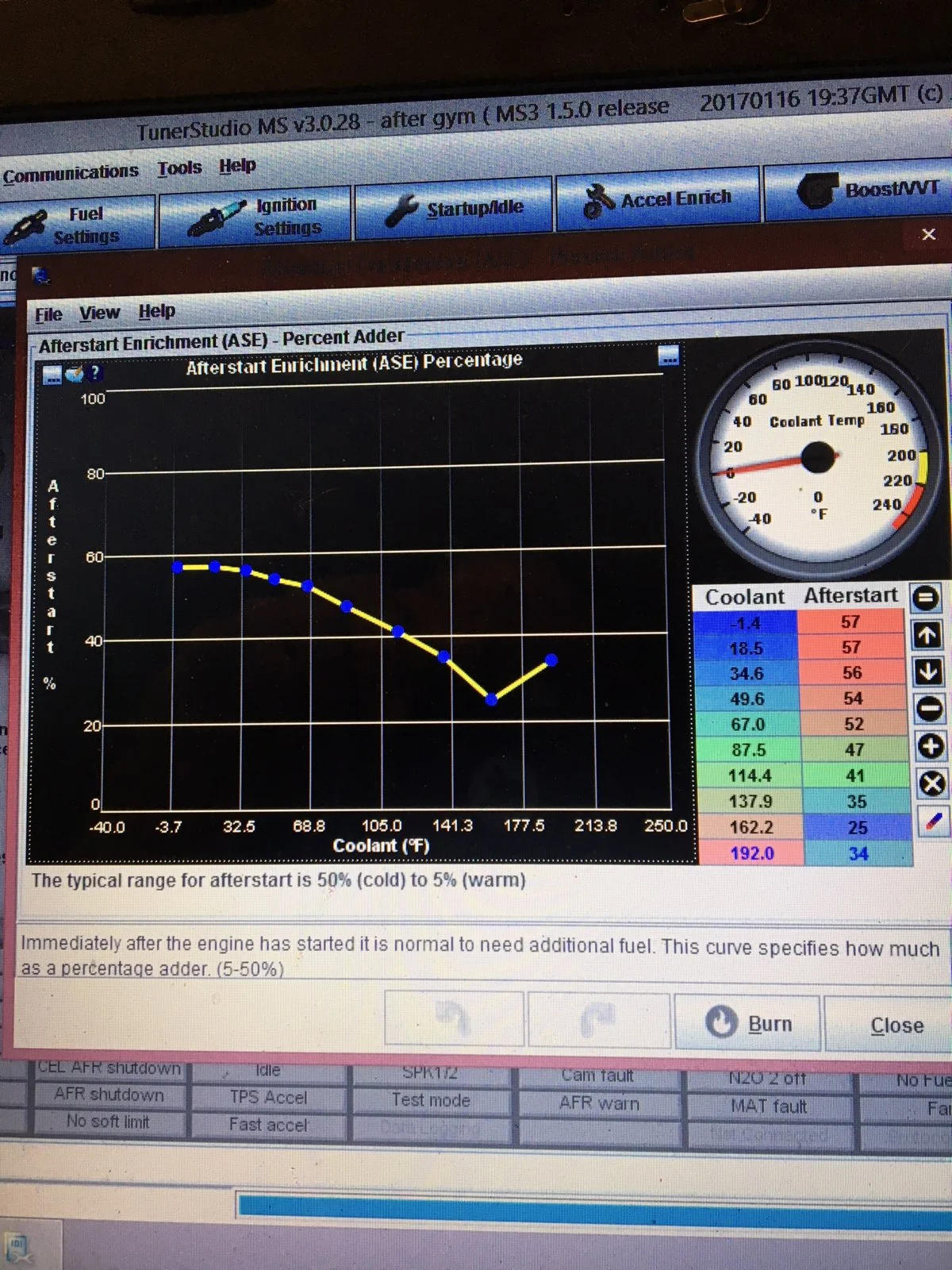

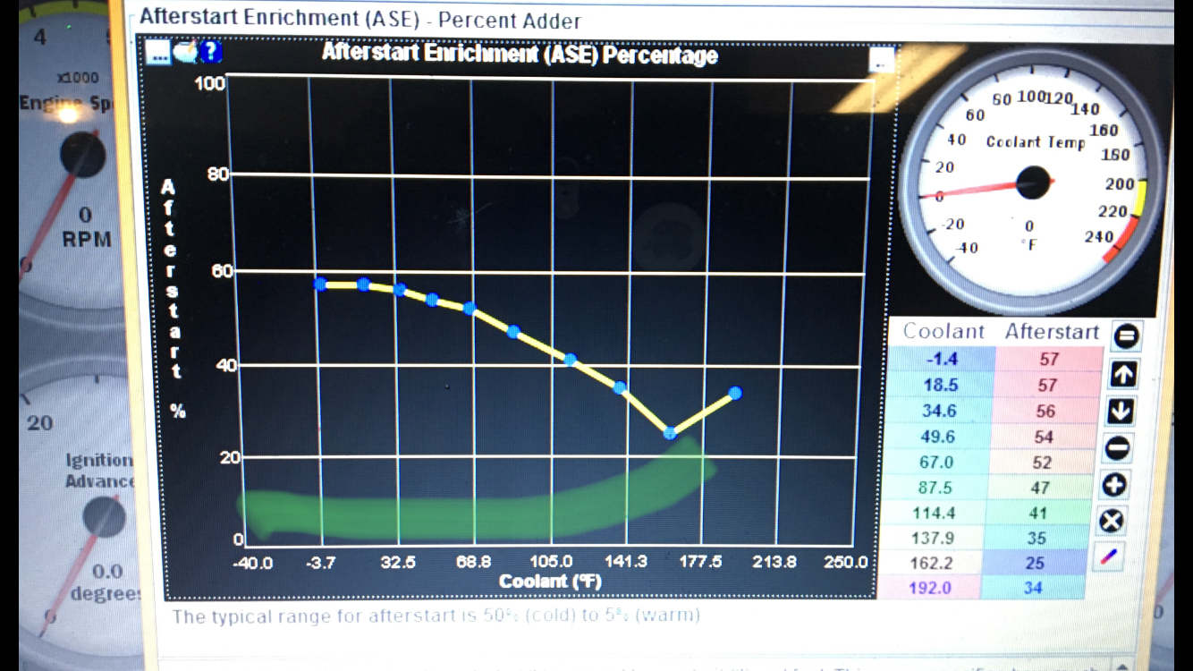

You need to increase the ASE enrichment at full warm... increase by 10%

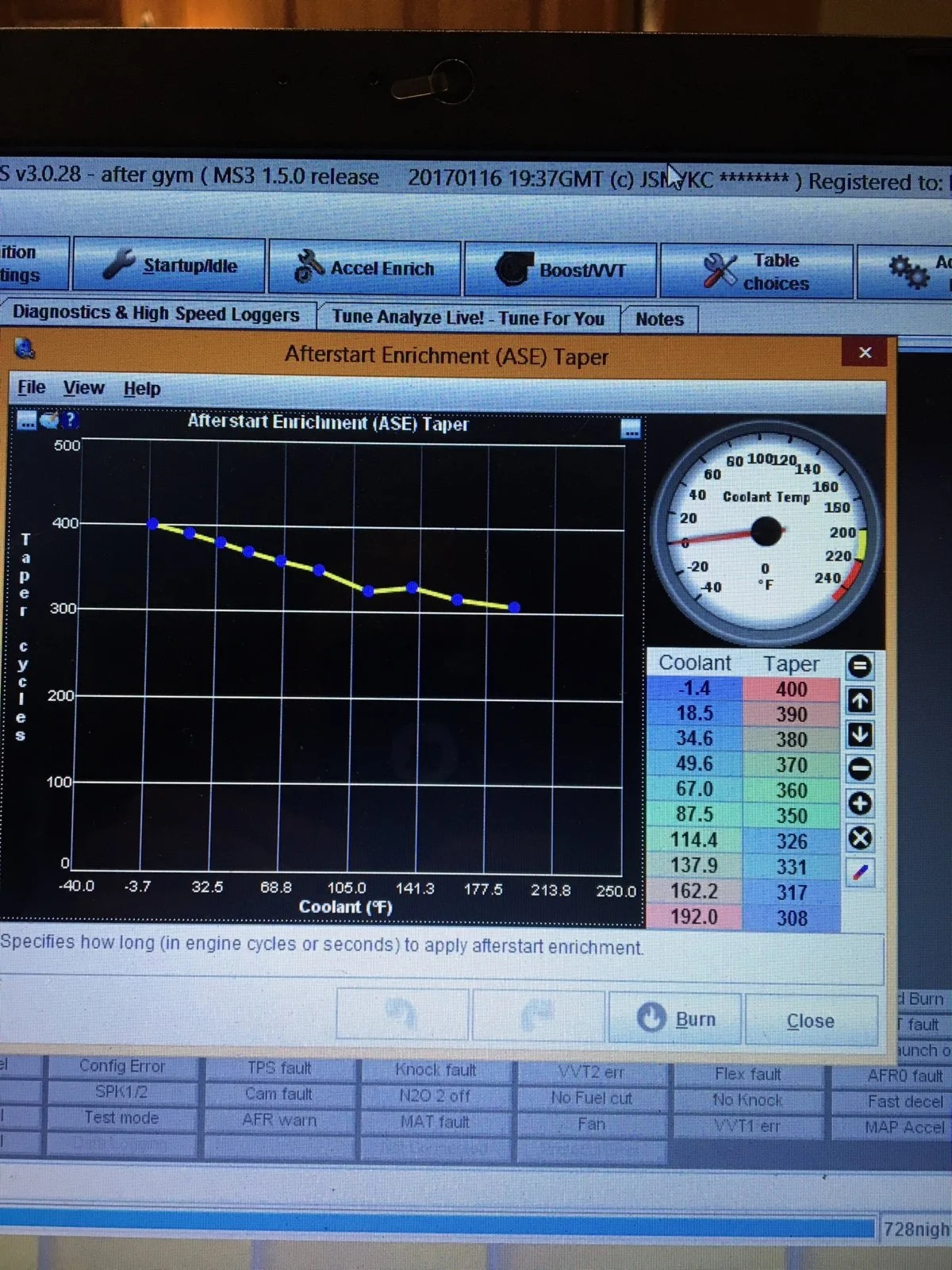

Then add to the ASE taper... increase full warm by 300.
Then blend them into the cold.
Let me know if you need screen shots.
if you have screen shots that would be great!!
I adjusted the ASE (it was at 24 now at 34), see screen shots. Thanks!

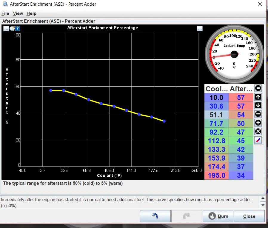

Ok now blend those numbers back into the cold region so things are smooth
I did not touch the taper, thats the stock tune. 162* is 317, 192* 308 (I noticed the chart goes up to 192* will this only allow this graph to operate up to 192*?

okay I'll make that adjustment. Should I clean up the -1.4 and super cold temps?
Leave the taper at 308?

I will leave that up to you... for now i would just blend it like i did that table.... that was a quick and dirty approach just to show you sorta how it would look...
i would add to the taper... make it 500 and blend it back some HOT starts need a bit of help with these 5.0
