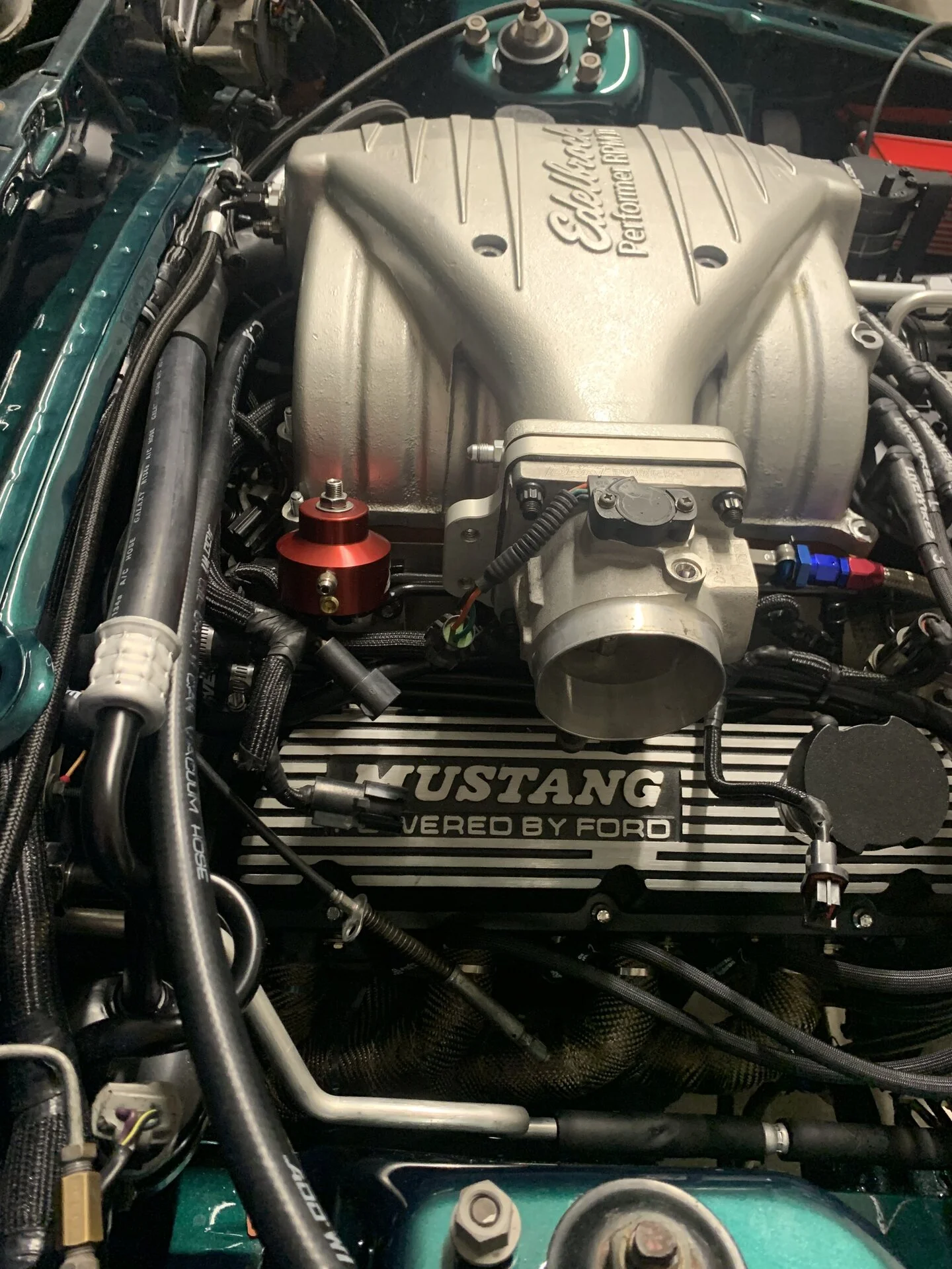

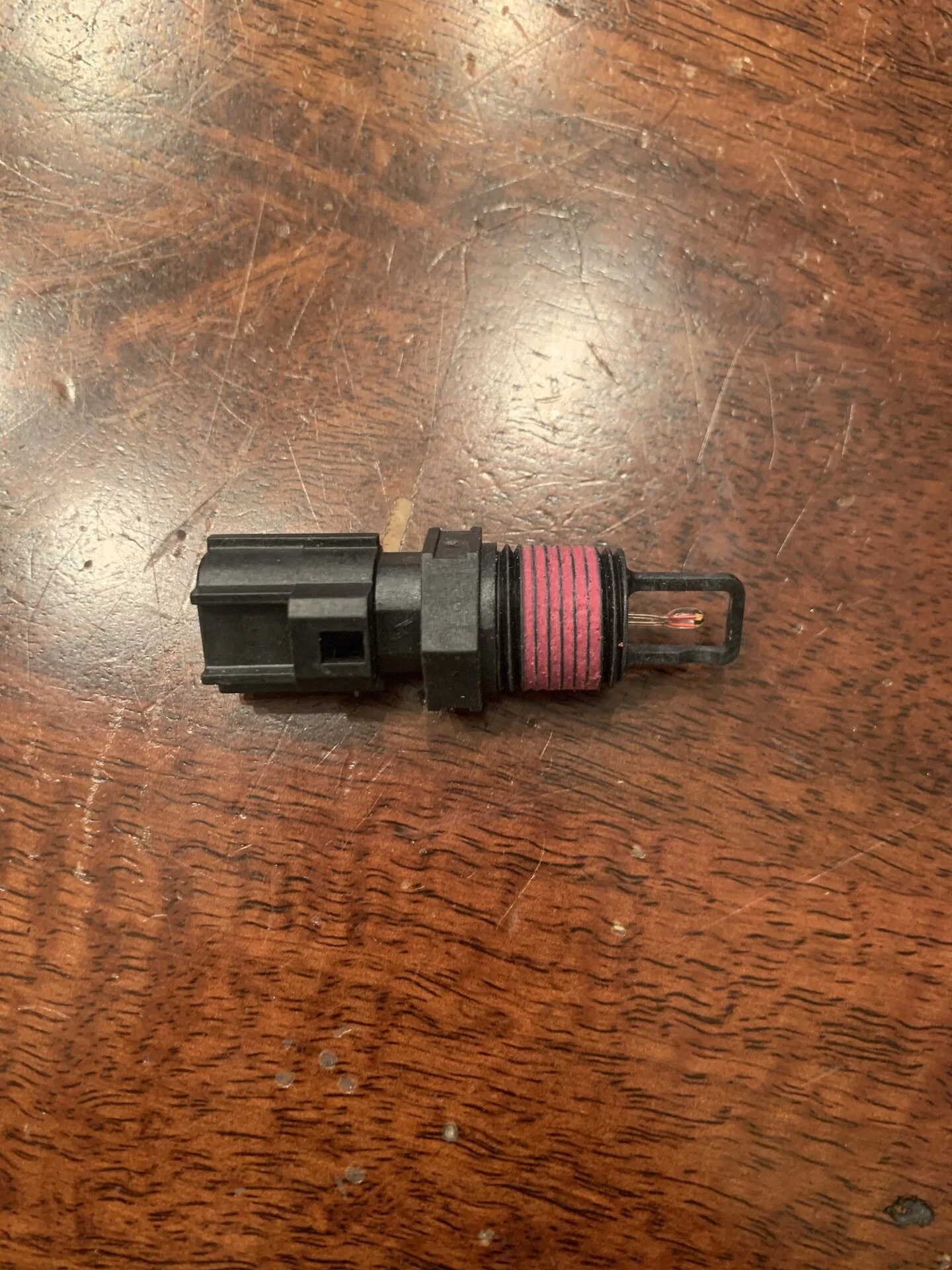

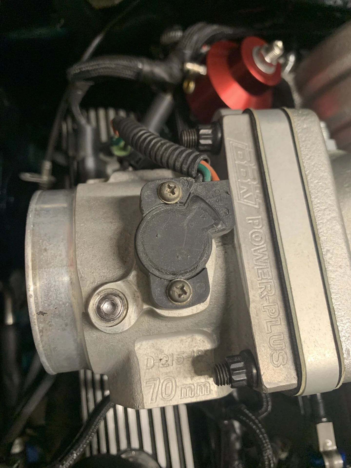

So after reading the entire thread… what was the consensus? The reason I ask is because my mechanic “advisor” has purchased me a 90mm MAF and I’m really curious what size TB I need and where to relocate the IAT sensor…

The size of your throttle body is completely dependent on your engine combination. My current setup is TF H/C/I and I run a Accufab 75mm which is perfect. I'm planning a Ford Racing Z2363 crate engine swap within the next year and will be going with a 90mm Accufab throttle body.

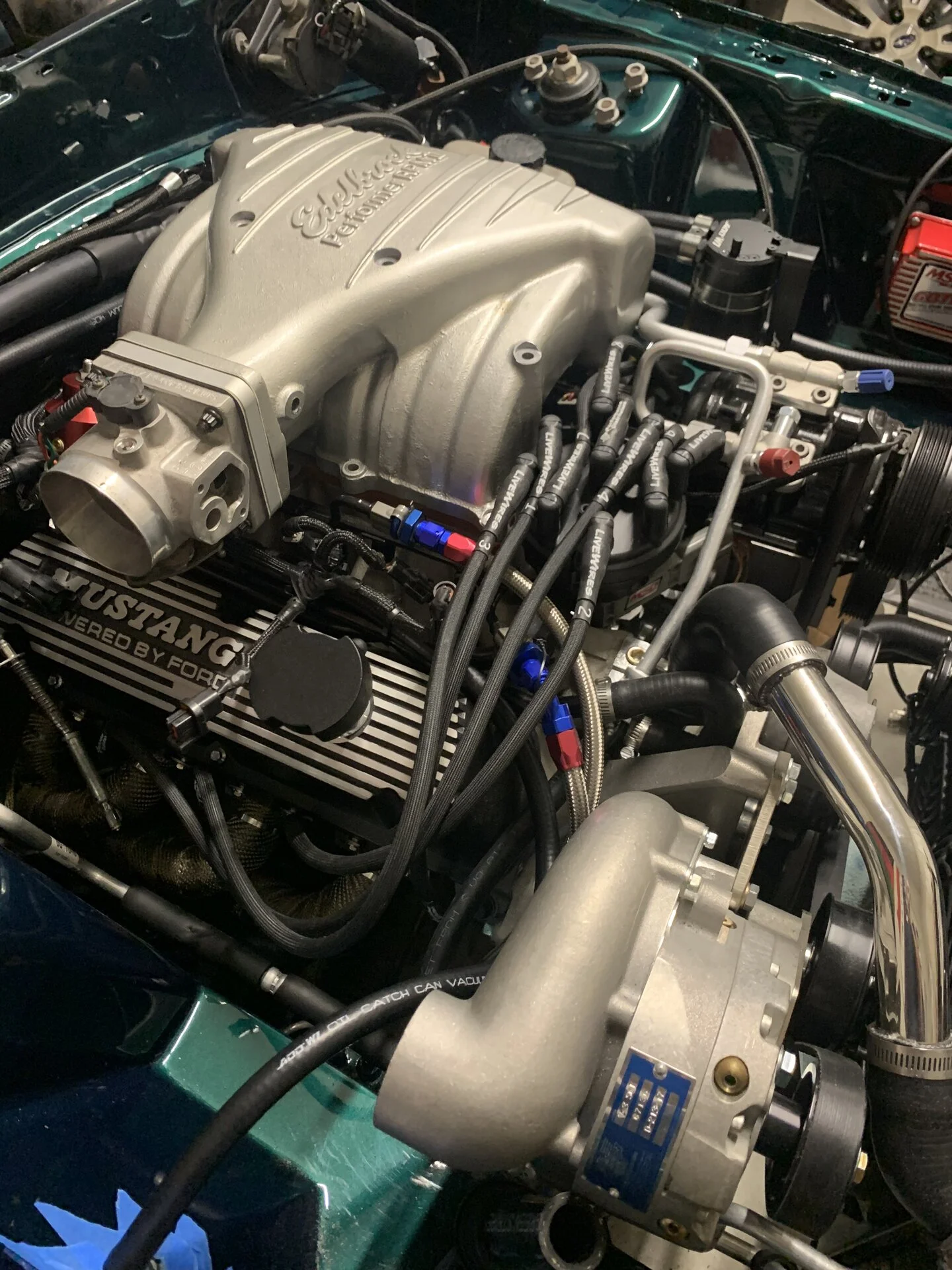

Rereading some of my responses from 3 years ago within this thread, I've since installed the Z2363 crate engine and went with a 90mm Accufab.

Here's my progress thread. I documented everything on here pretty thoroughly.
Progress Thread - 12th Owner: My '93 Notchback Restoration & Performance Build | Mustang Forums at StangNet https://share.google/EqAClBn8itQYsLRfk
Car currently makes 400/397. I'll be going with a Trick Flow Box R intake pretty soon. That should have been my first choice and is probably good for another 10 - 15 hp.
