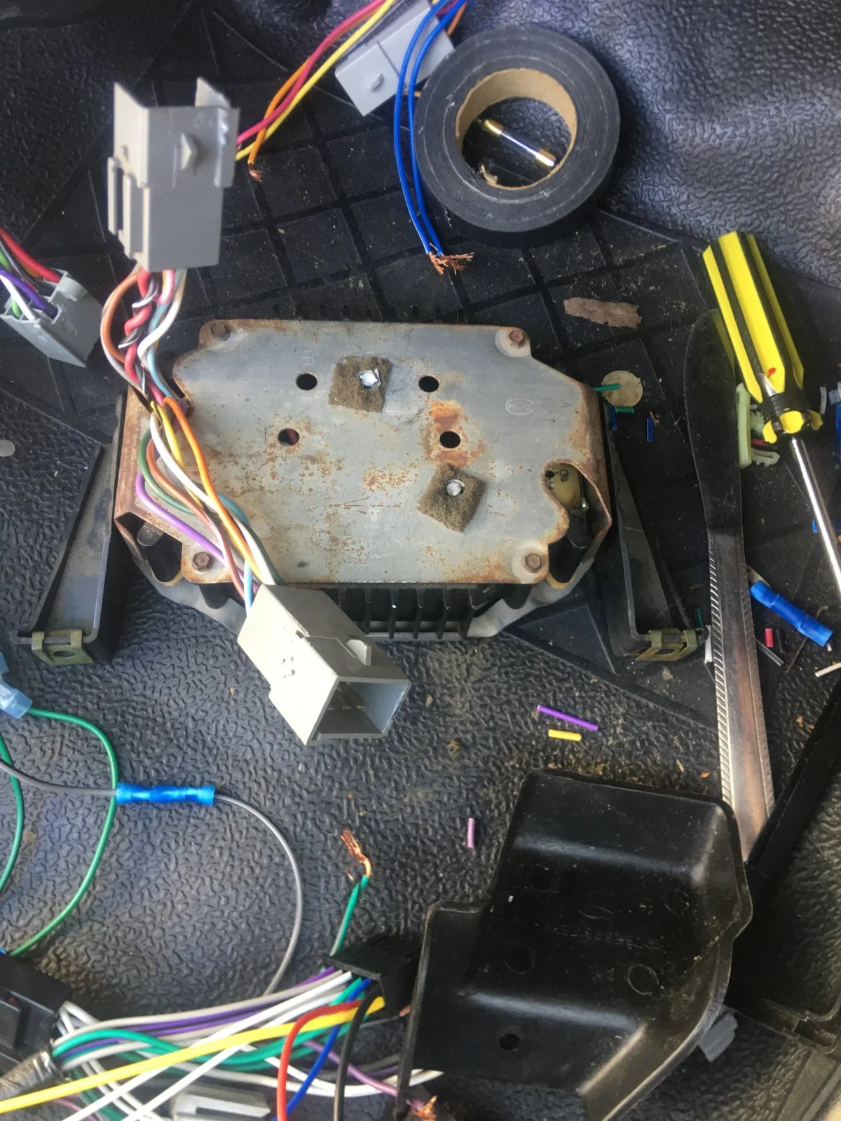

You made sure you could completely removed the old radio and amp? The plug behind the amp has the wires that go to the actual speakers

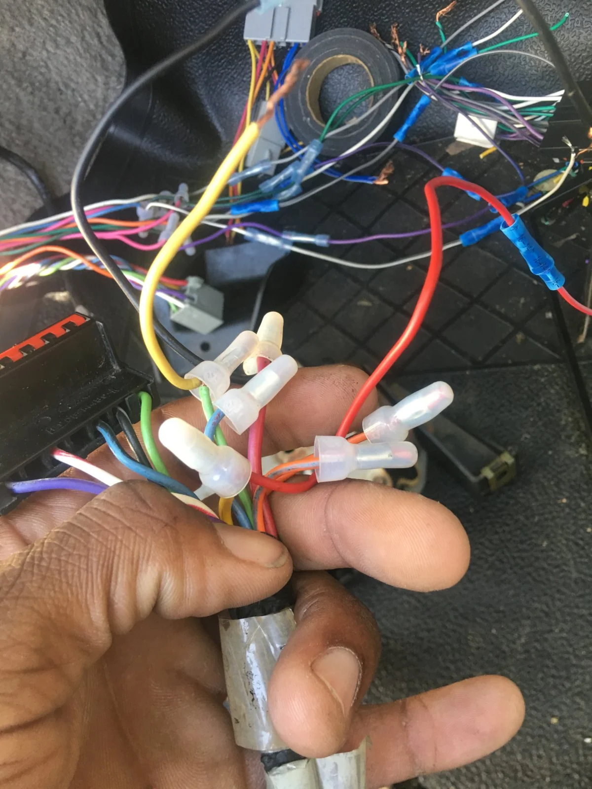

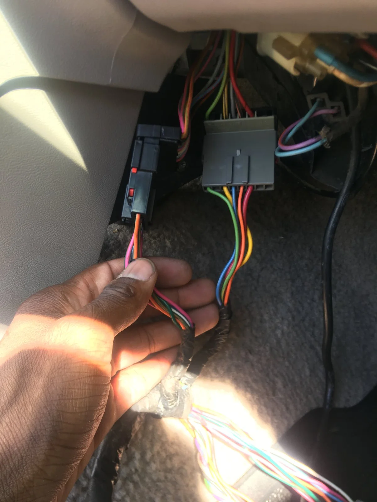

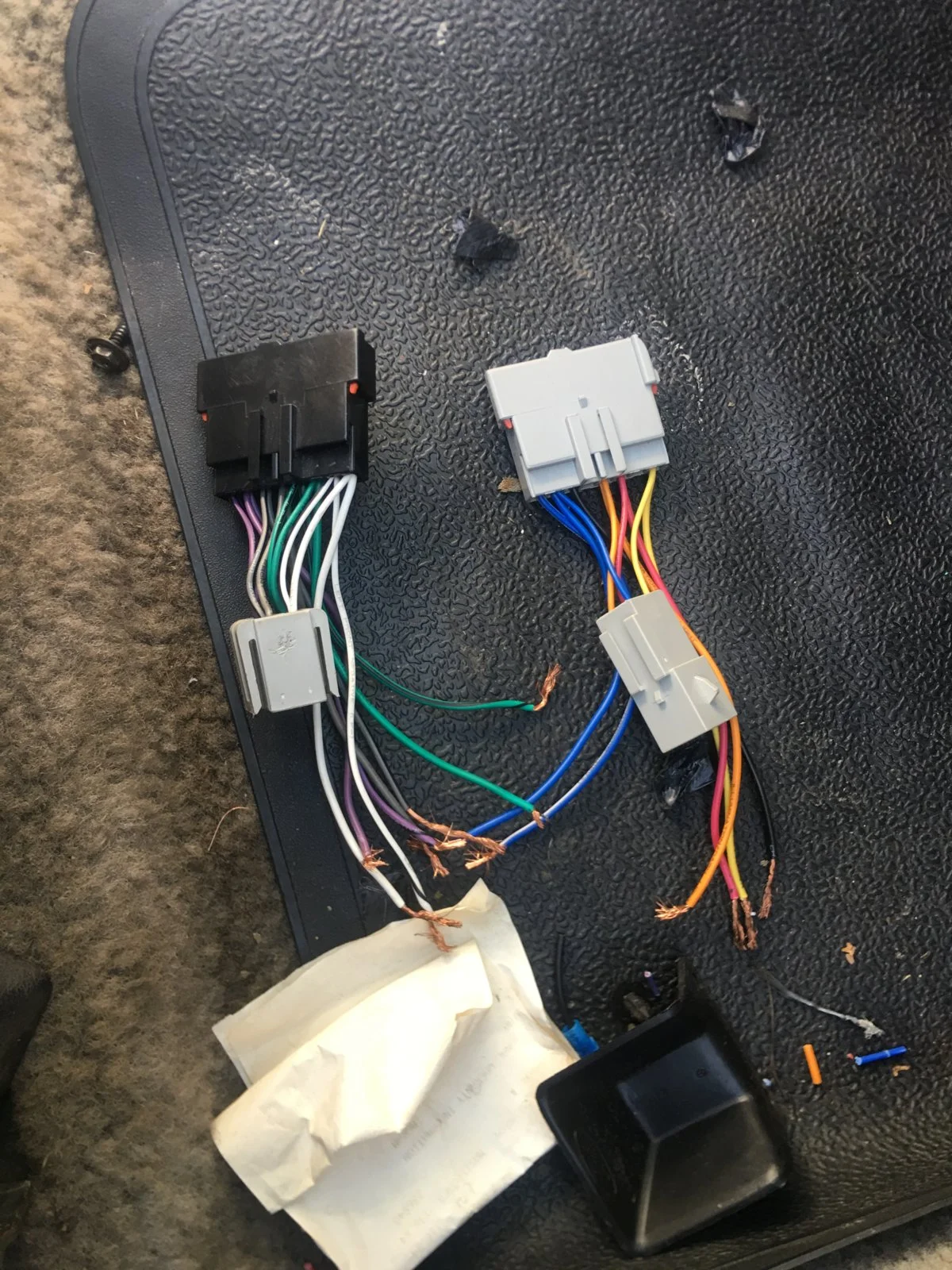

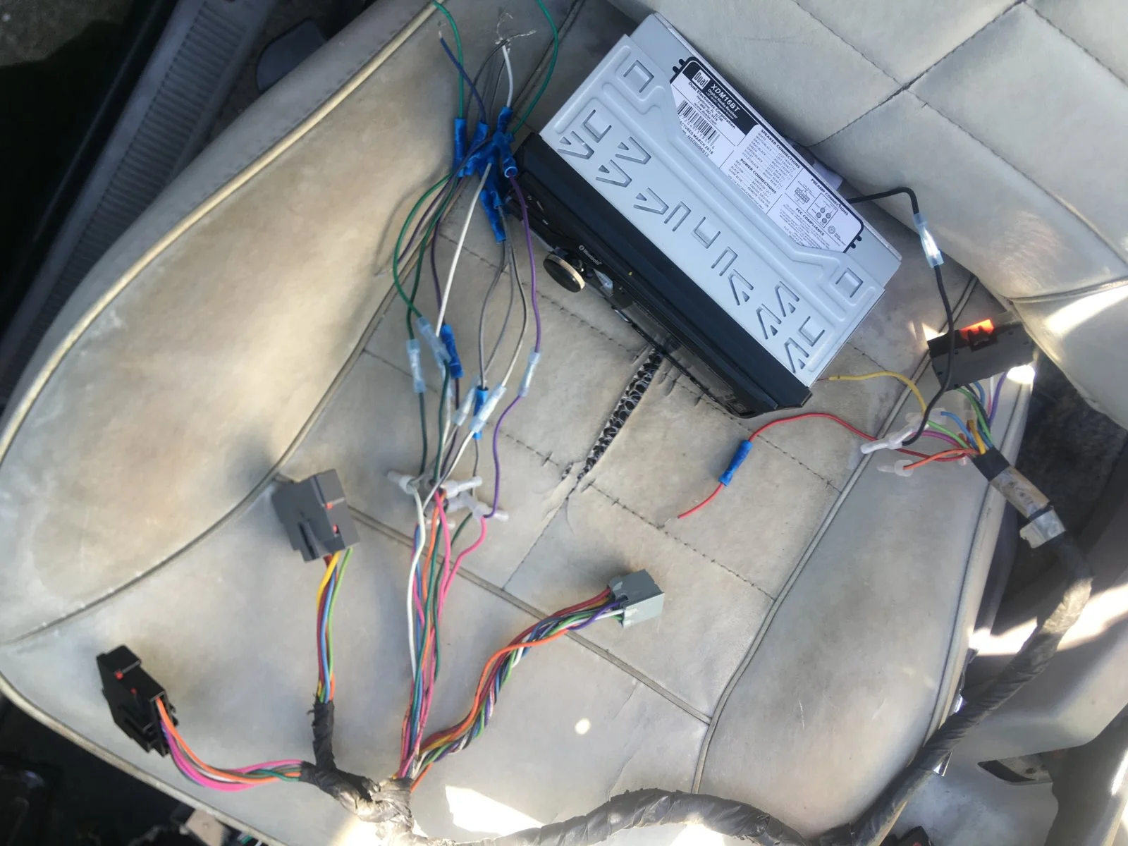

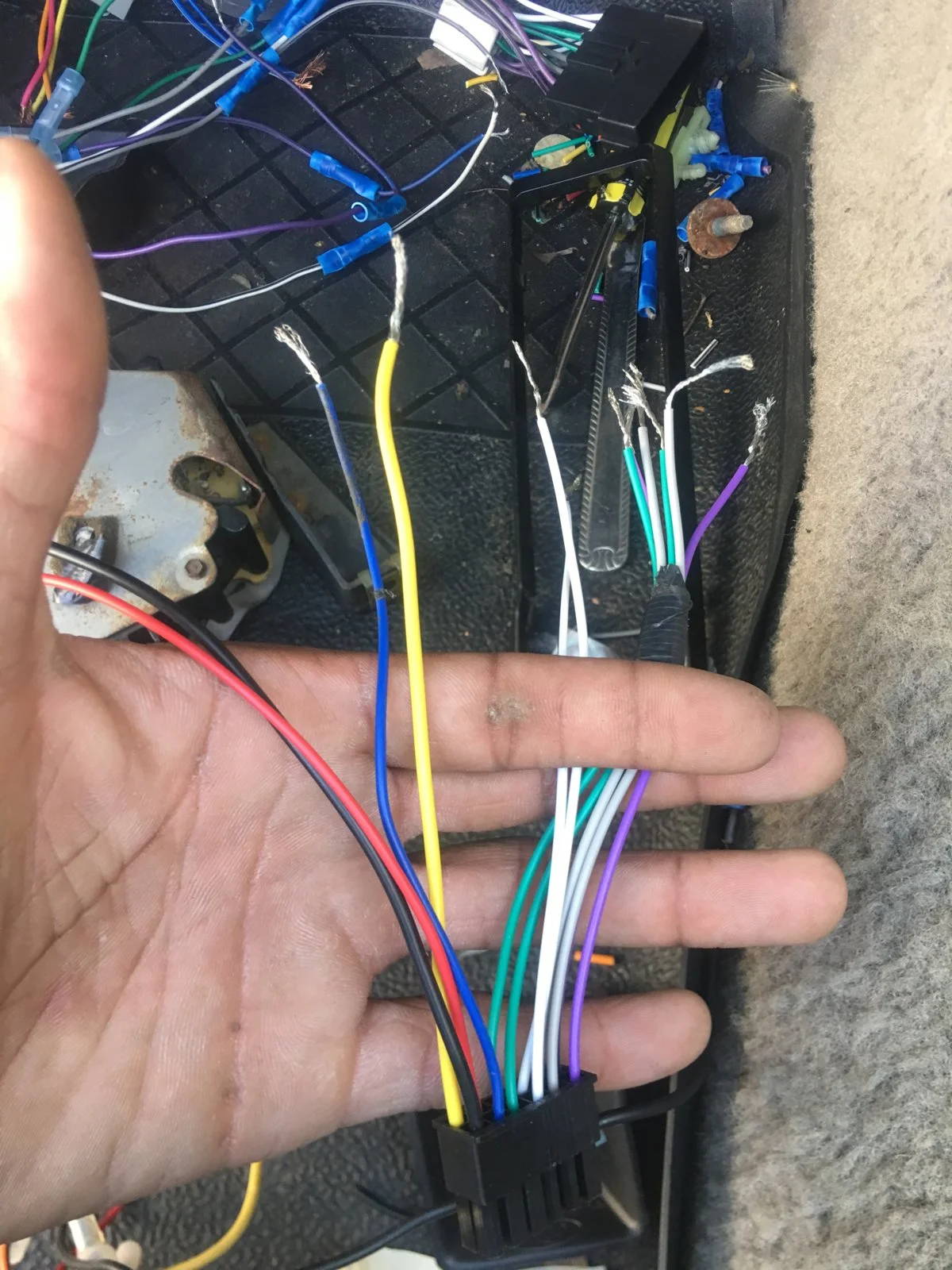

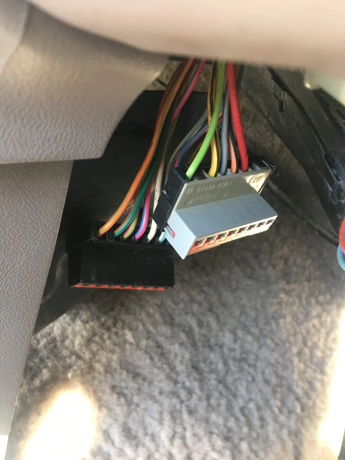

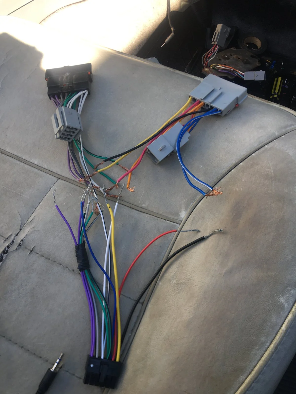

Sure here it is . The last two harnesses are some random ones that came wit the car idont know

This might help you out. The stock wires off the back of the head unit go to the amp. The amp then connects to the speakers. If you remove the amp, there is nothing connecting the speakers to your new headunit if you use the same connectors that connected to the back of the headunit. I've only helped one buddy do this before, and they had the third bypass cable, so hopefully someone can chime in with more direction.

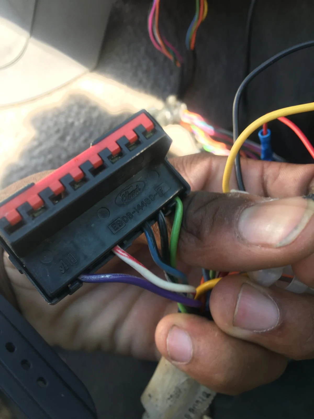

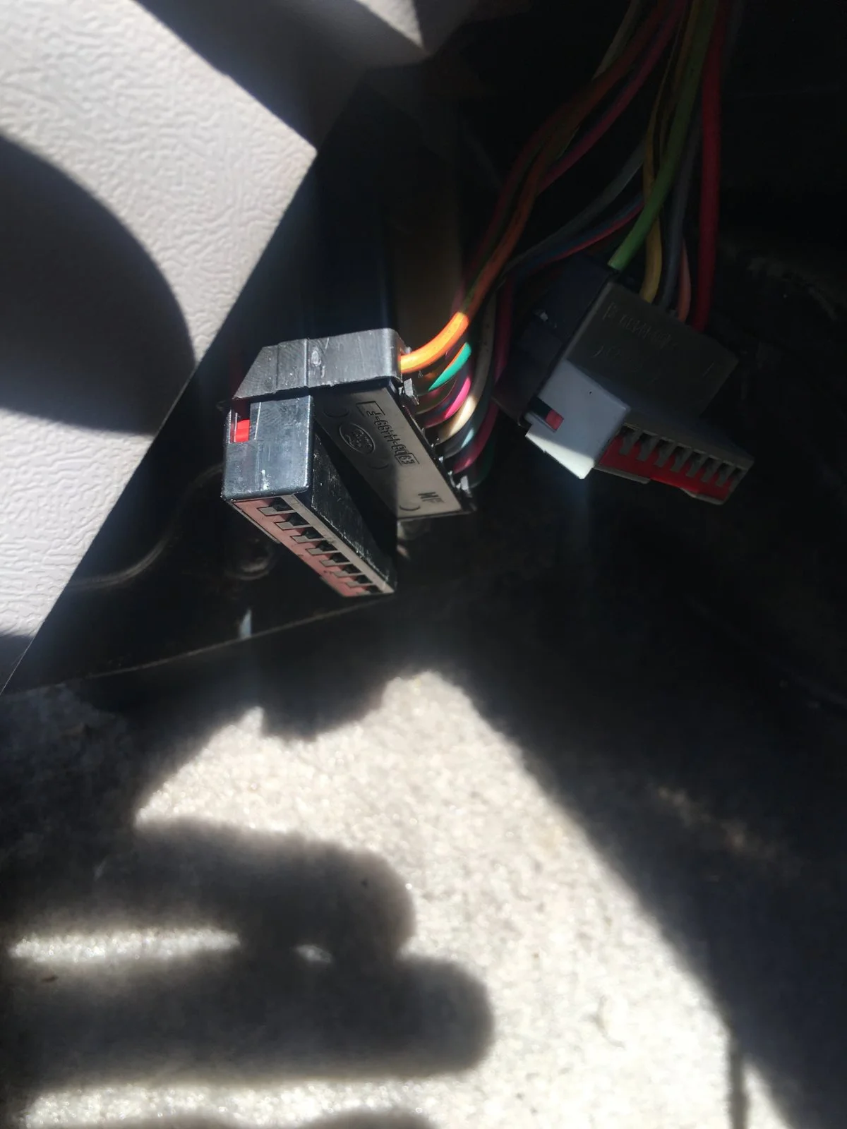

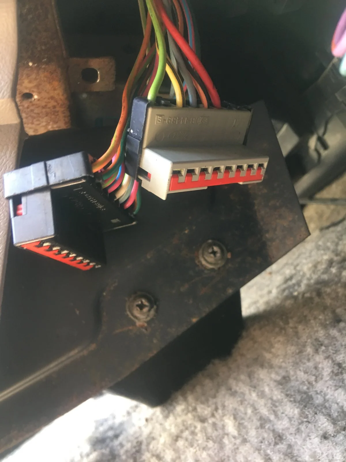

This is what i found out the message u just sent me
Do uper haps have picture regarding which harness u are referring to regarfing the factory unit
