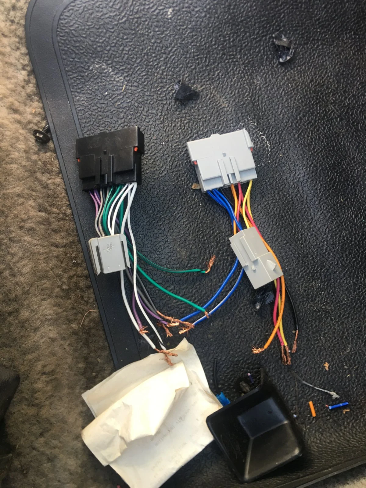

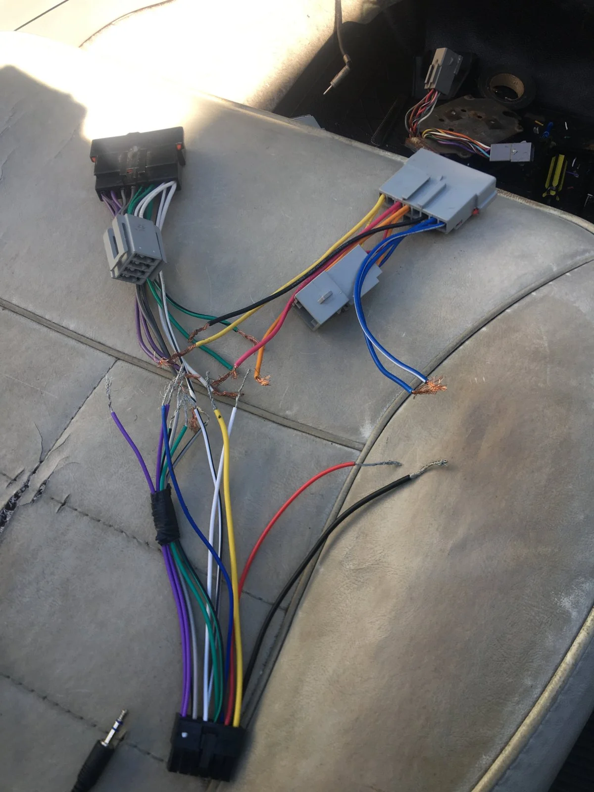

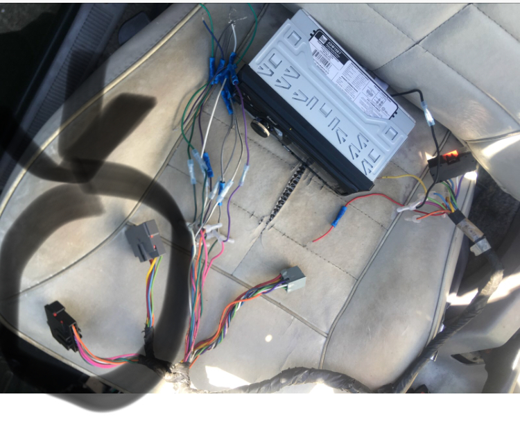

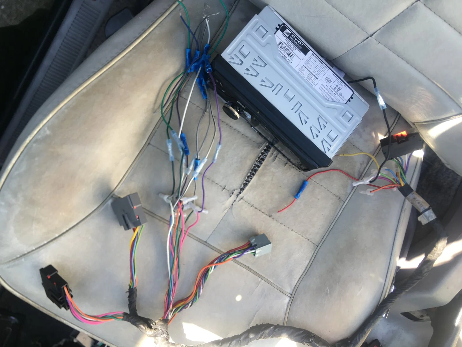

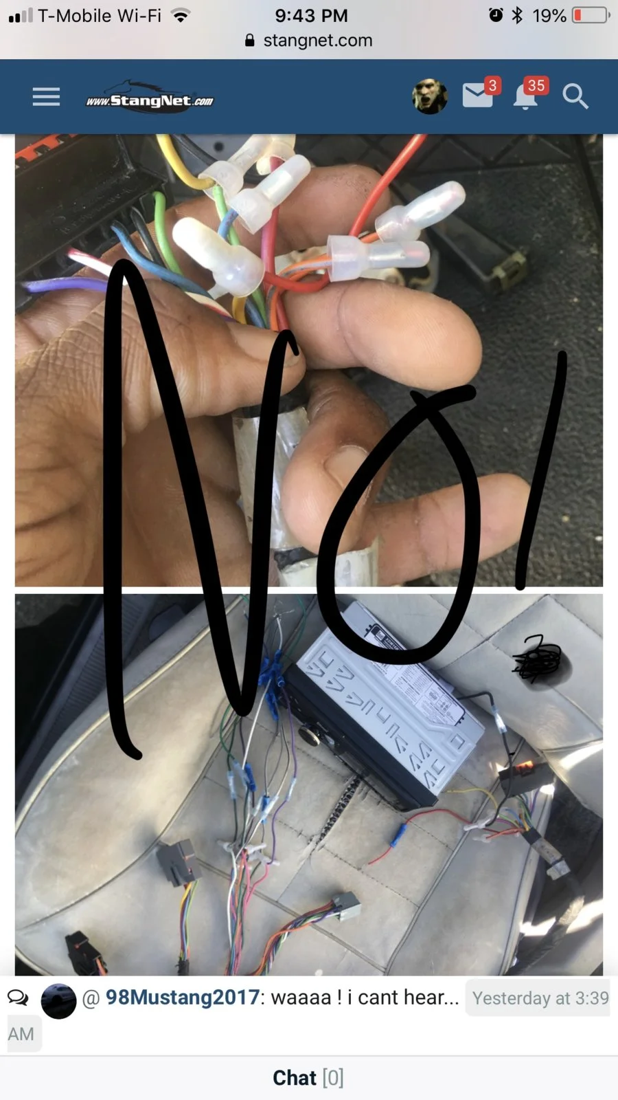

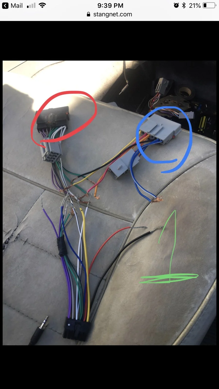

No... it’s your radio with its personal harness , wired into the adaptor harness ( each wire separated and covered with heat shrink or electrical tape) then you plug that into the car.

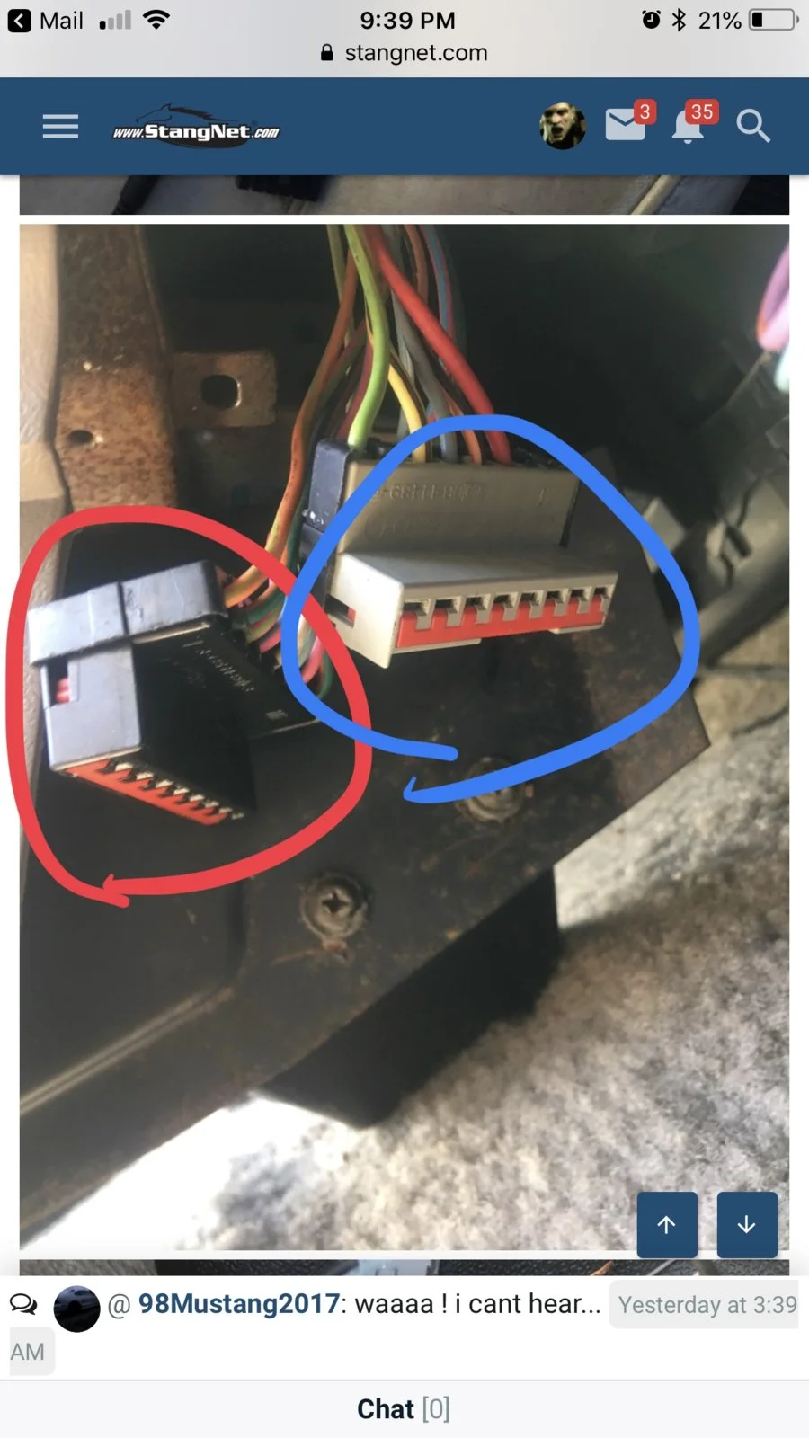

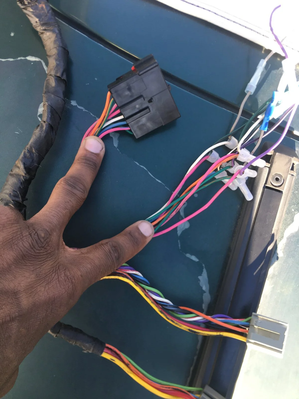

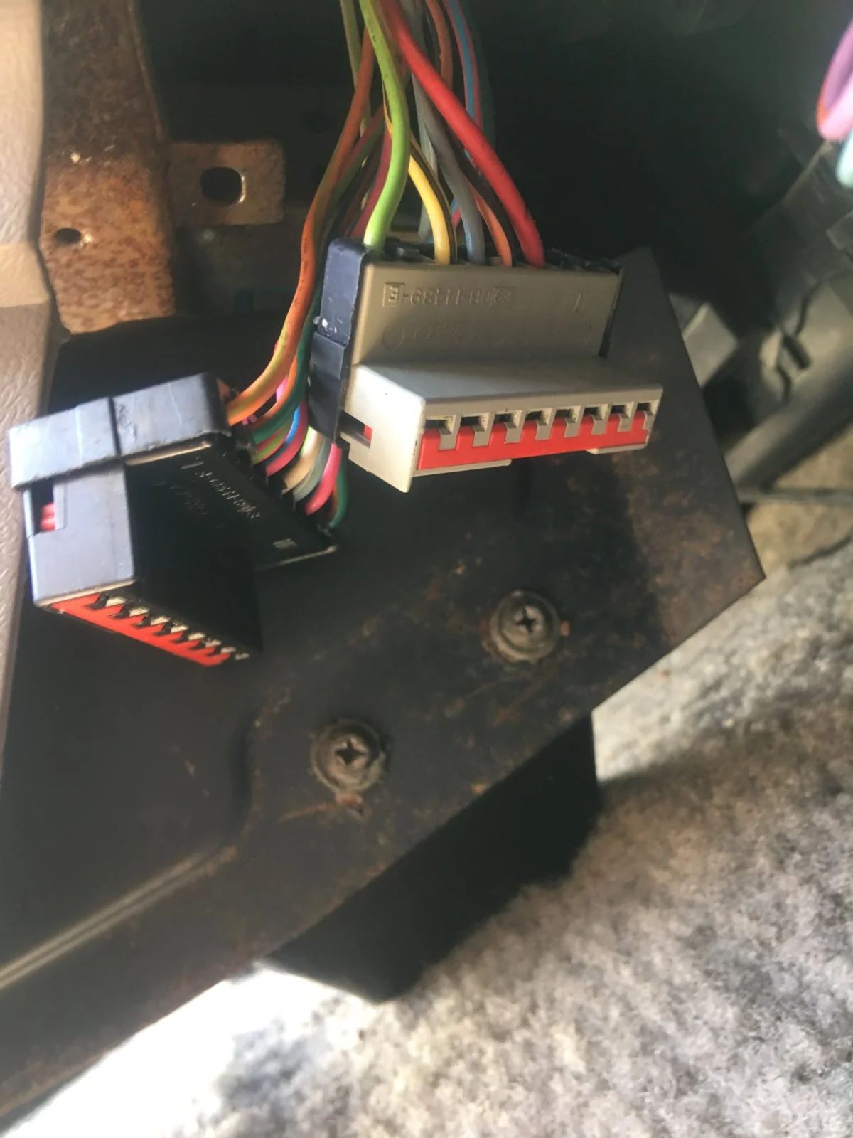

In the car there will be only one place the connector for the power wires will go, but there will be 2 for the speakers. You want the one that is before where the amp was.
That’s all there is... or you can completely eliminate the adapting harness by looking at a diagram or using a test light.

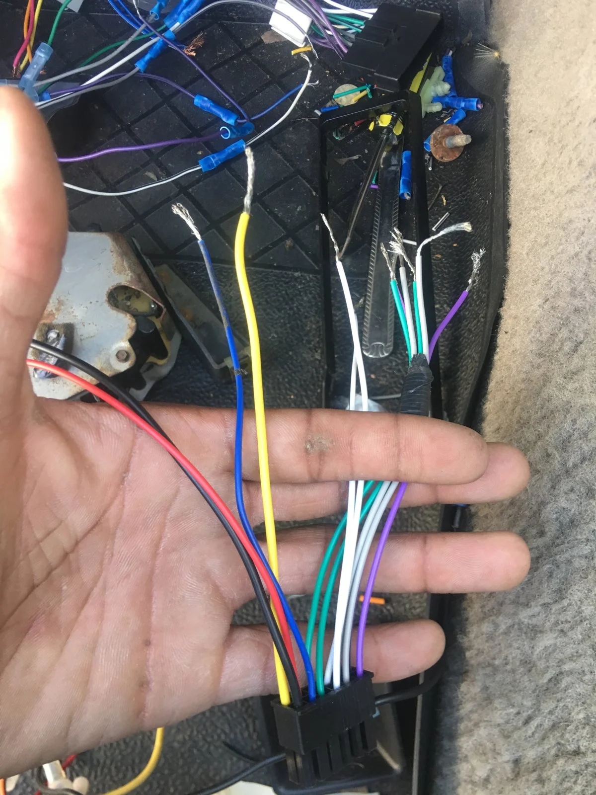

In case you need it, the wires coming out of your radio are
Red= switched power ( turns the radio on)
Black = ground
Yellow = constant yellow
Blue = signal for amp
Then the paired colors for each speaker.
