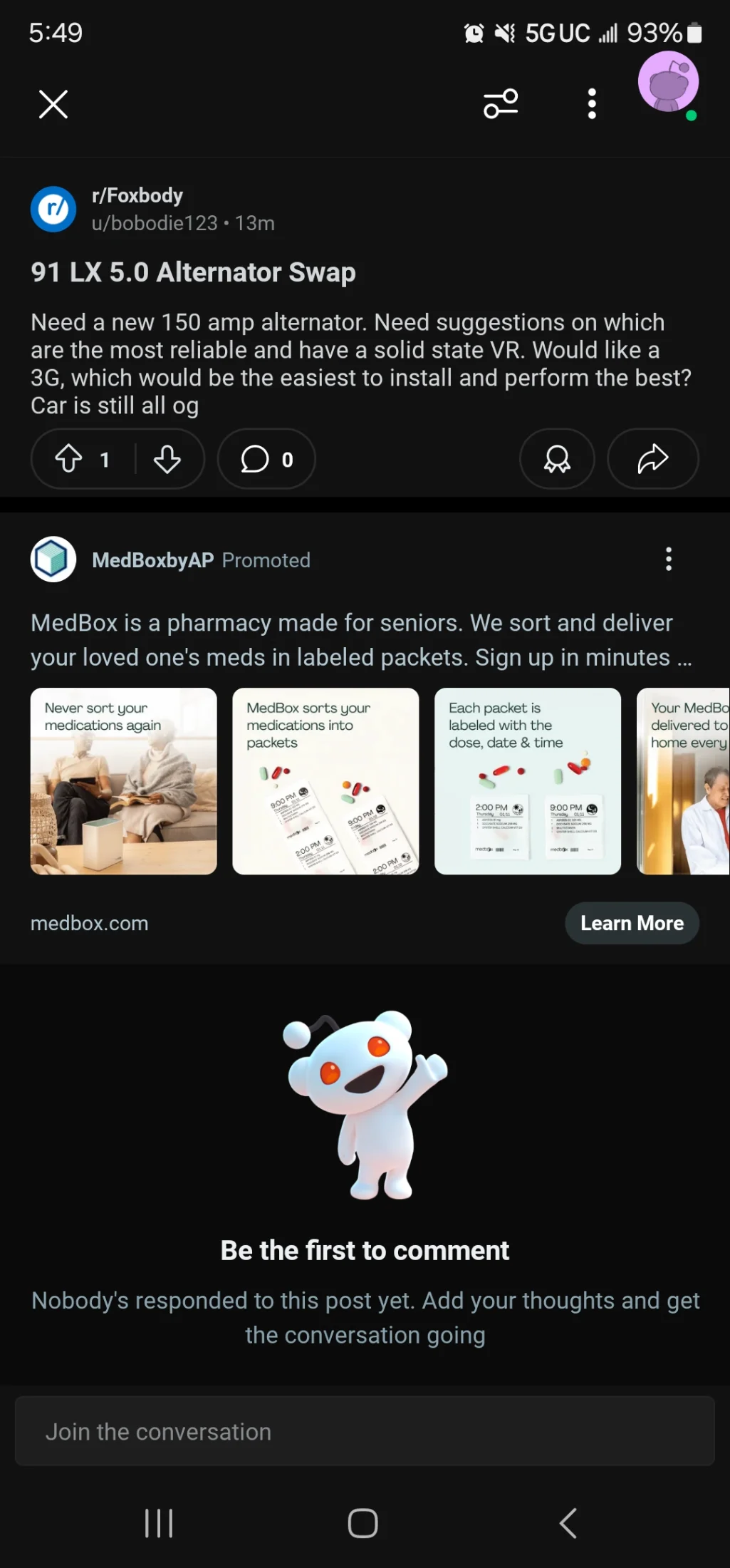

91 LX 5.0 Convertible needs an alternator upgrade
I’m wanting to upgrade my alternator to either a 150 or 200 amp alternator. I want to do a 3g with solid state voltage regulator. I dont want to break the bank, but i dont want cheap either, the is an og 70,000 mile beauty that I’m trying to keep as close to original as possible. Thanks for any suggestions
