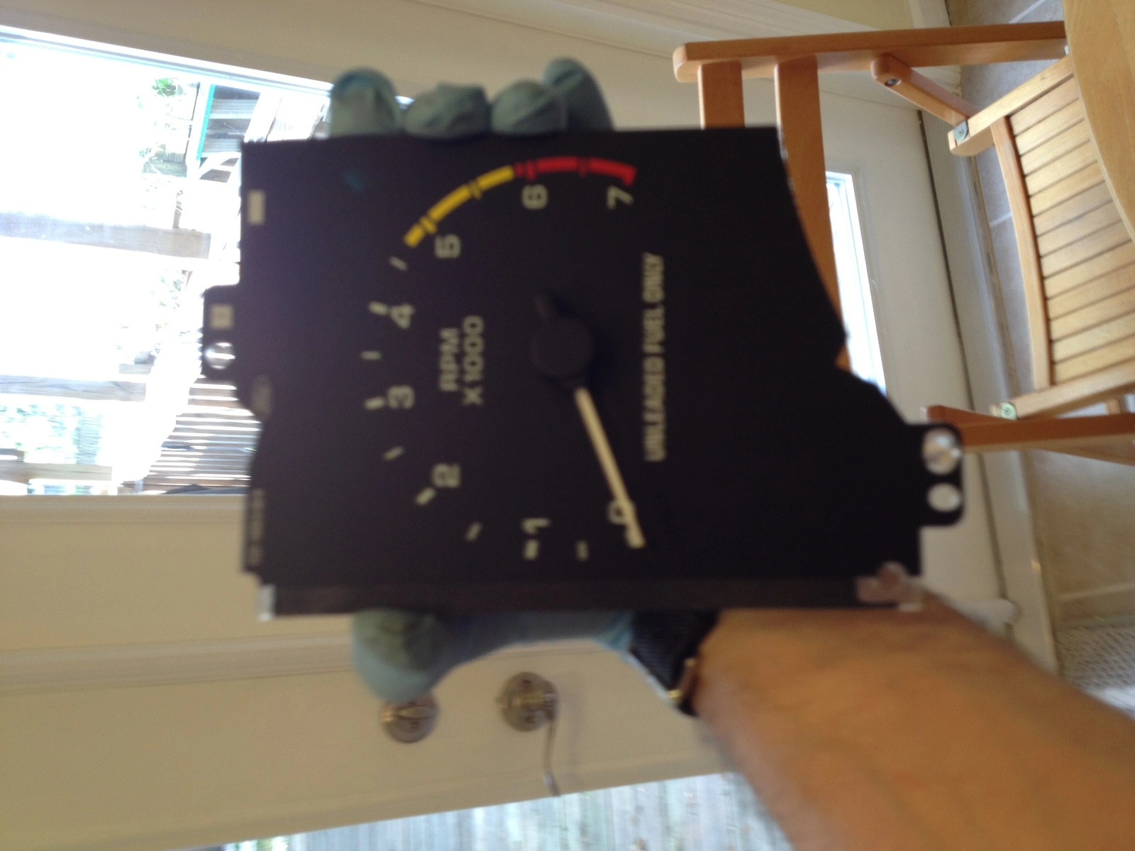

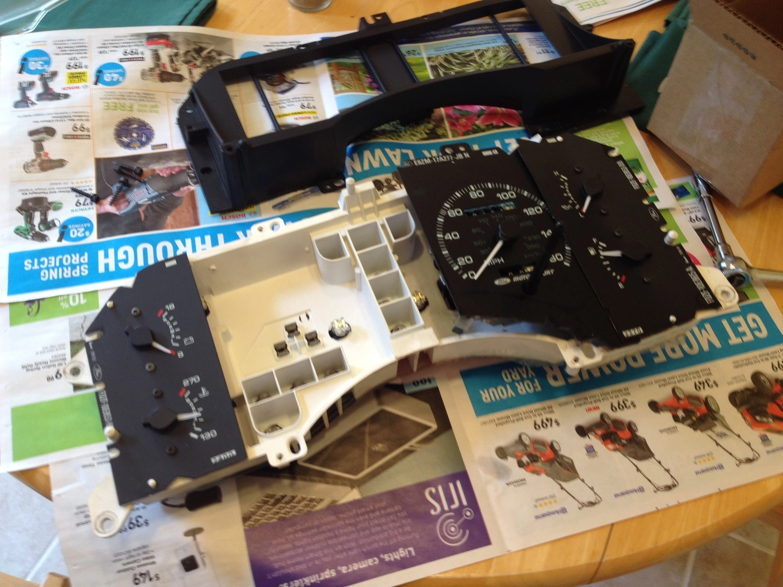

Well, I couldn't stand it any longer and decided to deal with it after work today.
I did the resistance tests as recommended by jrichker. Everything checked out good.
Next I checked all the connections on the back of the cluster. Most looked pretty good but there were a few "iffy" ones. I just cleaned everything and super glued down the film that was starting to peel in places. Then I swapped out the tachometer with the NOS I got off of Ebay and put everything back in the car.
I took it for a long ride and let it idle in the driveway for awhile and so far so good. Knock on wood. I'll have to wait and see because I though I had fixed it last time by replacing the Dizzy. I guess a positive out of the situation is I tuned up the entire ignition system and did a MAF upgrade.
The car is running better than it ever has. :nice:
