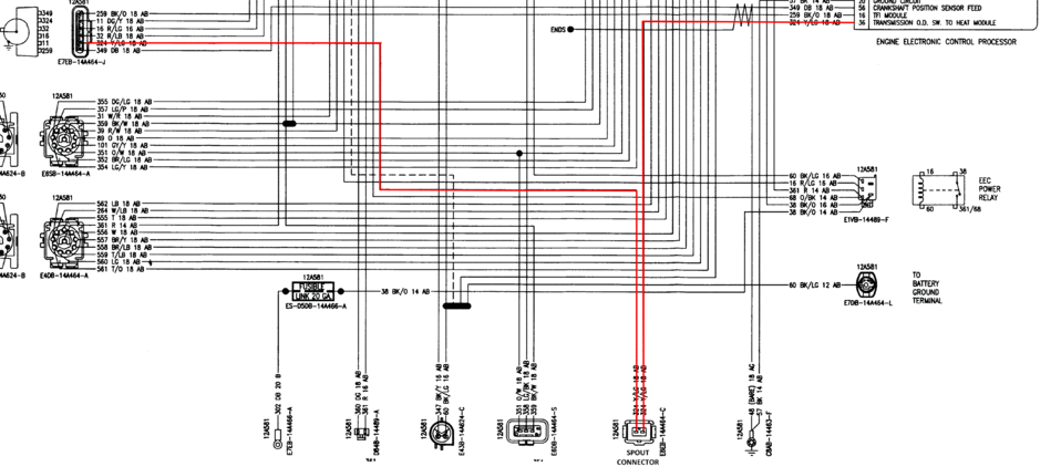

jrichker,
I have looked at the diagrams/instructions and tried to figure why I have no ground circuit from the SPOUT to the car with the TFI and ECU disconnected. All of the body grounds are intact and clean inside the car and under the hood. Truth be told I don't know what I'm looking for or how to diagnose the issue. Yeah, there's no other way to say it but I'm not an automotive electrician.

Can you tell me where in the vehicle or wire loom that the SPOUT wiring picks up 100k or more ohms of resistance to ground. I still have zero resistance between the TFI connector to ground and the ECU pin #36 to ground.
I am trying to zero in on where the issue is but I'm not getting anywhere fast.

The SPOUT wiring connects only to the TFI module and pin 36 on the computer. If you have an aftermarket tach or other instrument, it may have a stray connection to the SPOUT wiring
On the drawing below, the red line shows the SPOUT wiring and what it connects to on the factory stock car.
