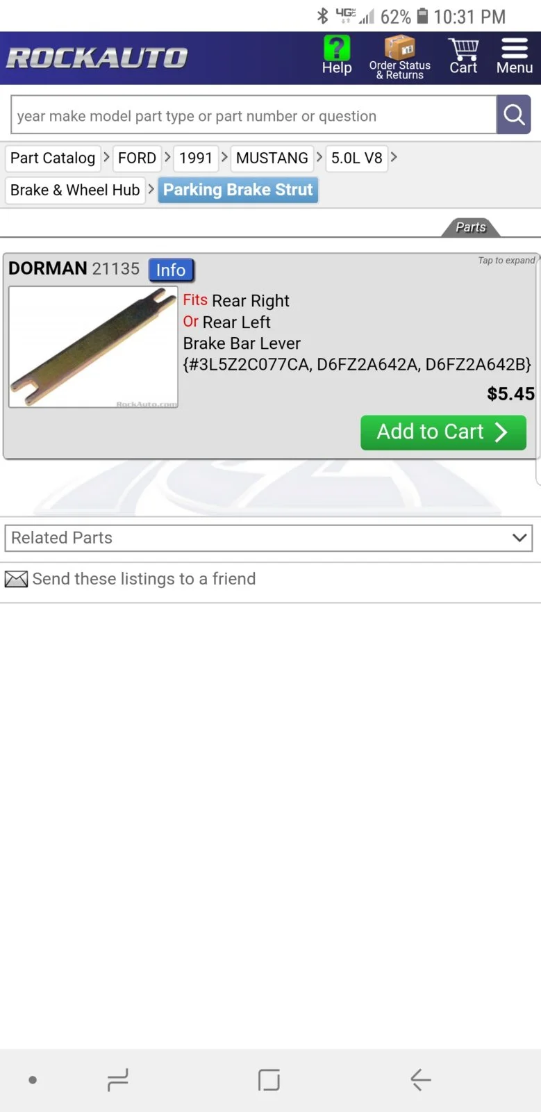

Hey guys and gals, new to this forum , I have definitely used some discussions I have searched to get good information on a mustang I am putting back together. Now I am in a bit of a pickle, I cant seem to find a replacement emergency brake lever , , and shoe strut bar that goes on your rear brakes, I can get every other part and spring but having trouble finding these, any help would be appreciated
Found the parking brake strut....the parking brake arm may need to be sourced from a local junk yard. Ford rangers and with 10in drums have the same components...along with the aerostar van and a couple other ford vehicles with 10in rear drum brakes. They are 5 lug but the internals are the same.
