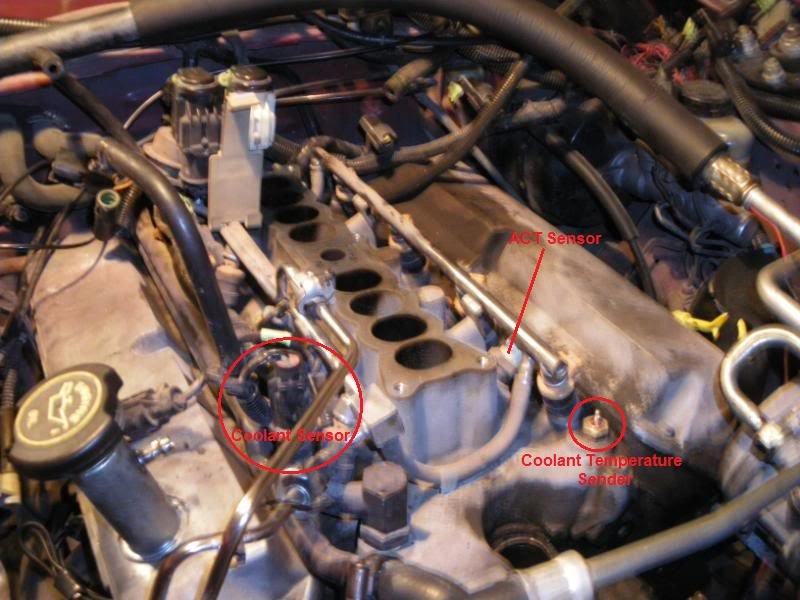

Temp guage sender is located on the driver's side front corner of the lower intake manifold. Simple single-wire slip on connection on top. The sender is pretty cheap, so i'd probably start by replacing it.
Bottom left in this picture
Also, you can test the gauge and related wiring by this method. Unplug the wire from the temp sender. Ground it to the block. Turn the key to the run position and the gauge needle should peg all the way full hot.
