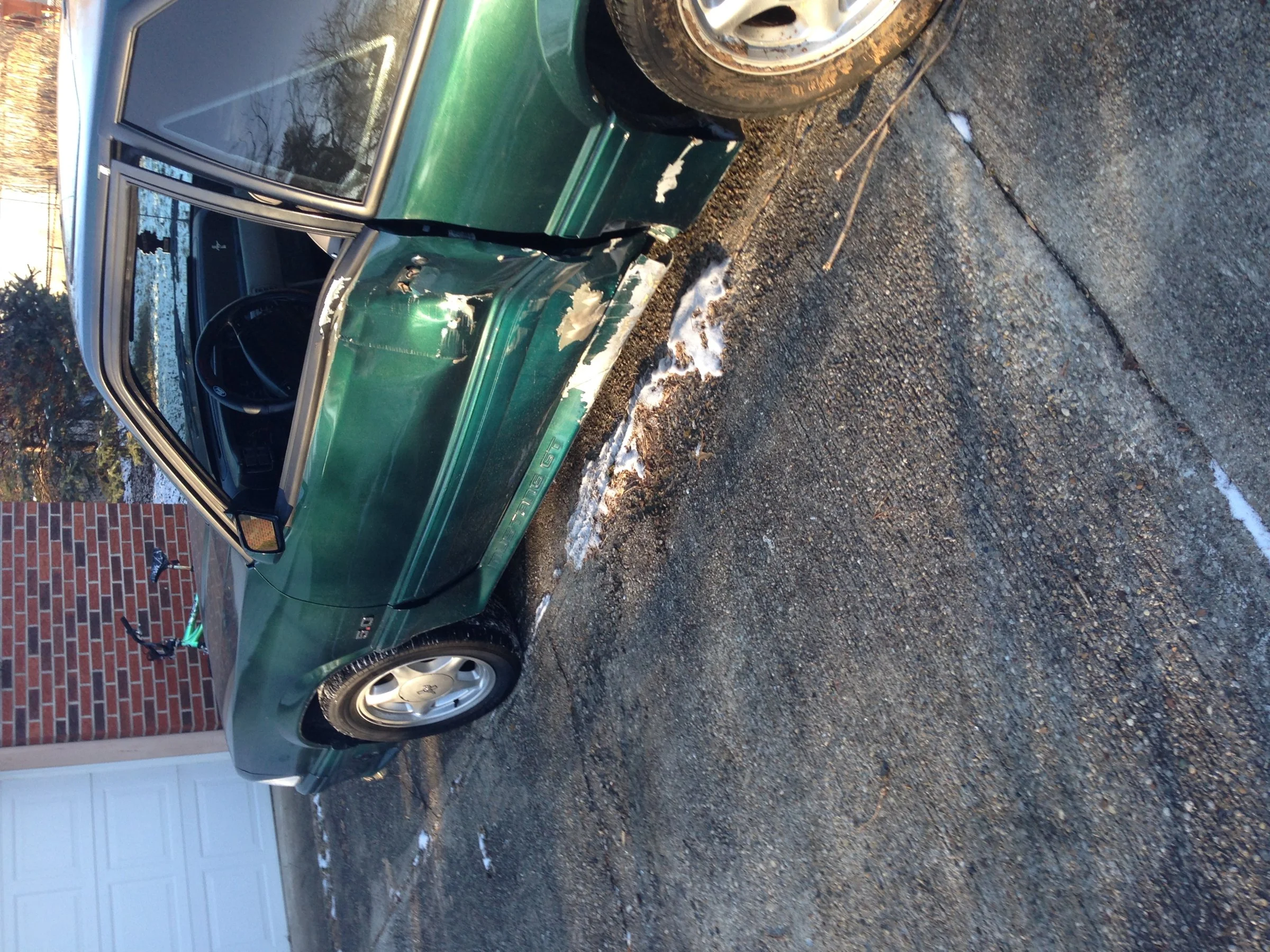

Well, I'd like to say I'm very much new here...and something rather crappy has happened earlier today which I'm still sick from...and feel incredibly dumb for. Anyway this is the damage.
I haven't had a quote for it yet as the body shops in my area are closed and will not open til Monday morning so I figured I'd get an idea. My question is how much would it be to replace it? Door won't open at all and window is busted out. I'm guessing around 3k?

Man that sucks, those doors are all over the place, at least here in Fl. Where you at? If you look for your own door make sure you check the bottom and pull the door panel off and check for rust inside. If you have a power door (most do) get a power door, don't be convinced you can change a non power one over. Good luck and welcome aboard.

What do you mean by 'hoping it's not what I think it is'.
What do you think it is? 2.5 k for what?
It's kind of hard to tell about interior damage.
Does the door still open? Did the 1/4 jamb get tweaked when the door pulled on the striker?
Let's get a guy from your area to chime in, he may be able to help you find a replacement door. @RaggedGT
There's no way that it will cost anything like what your thinking. It can be even cheaper if you get a door to take to the shop you choose. With that green, it would be good to blend the paint on the 1/4 and front fender.

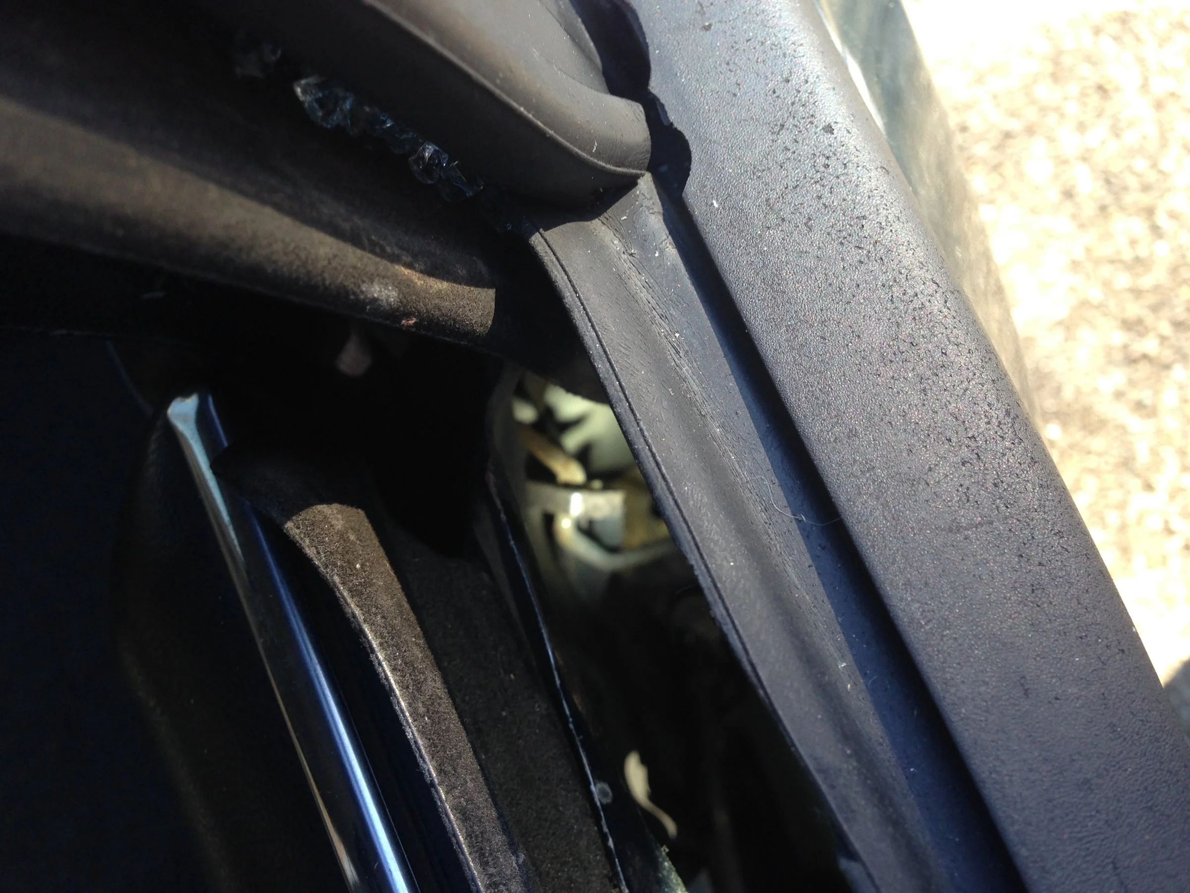

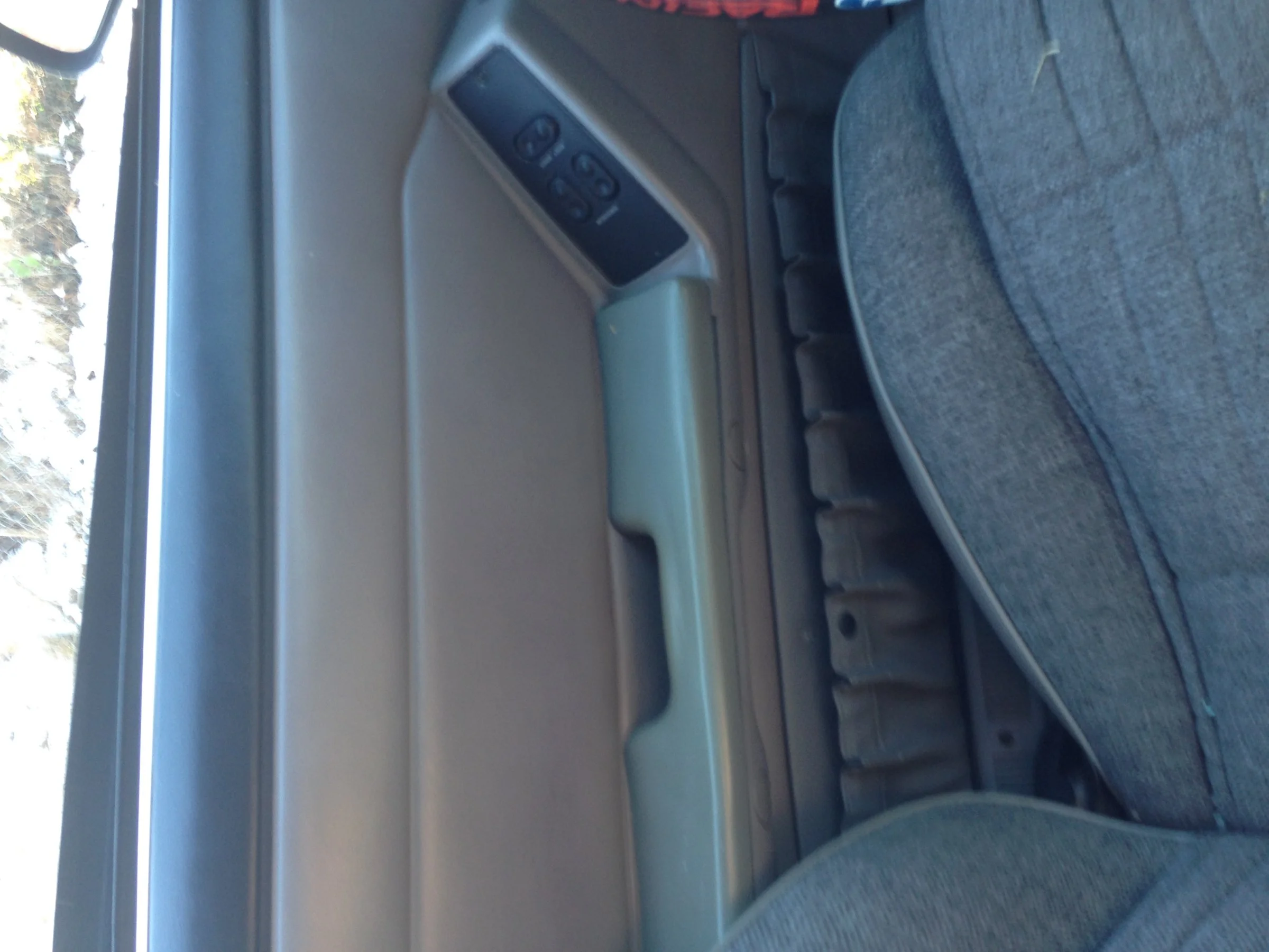

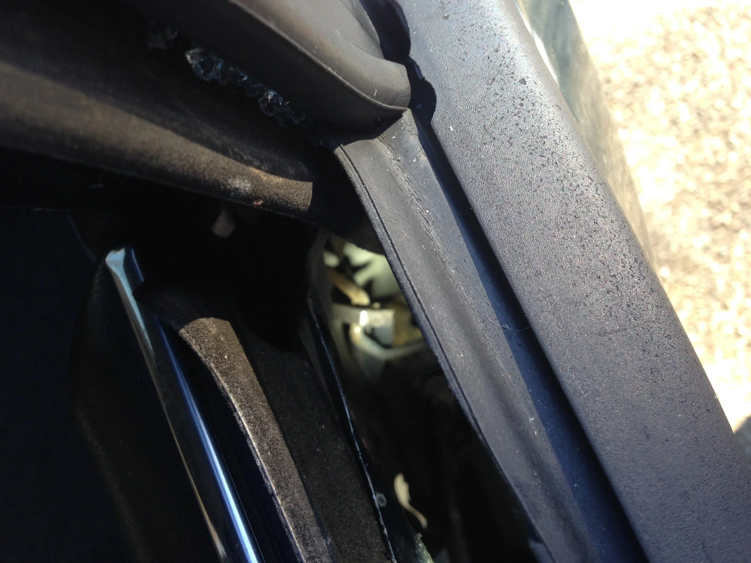

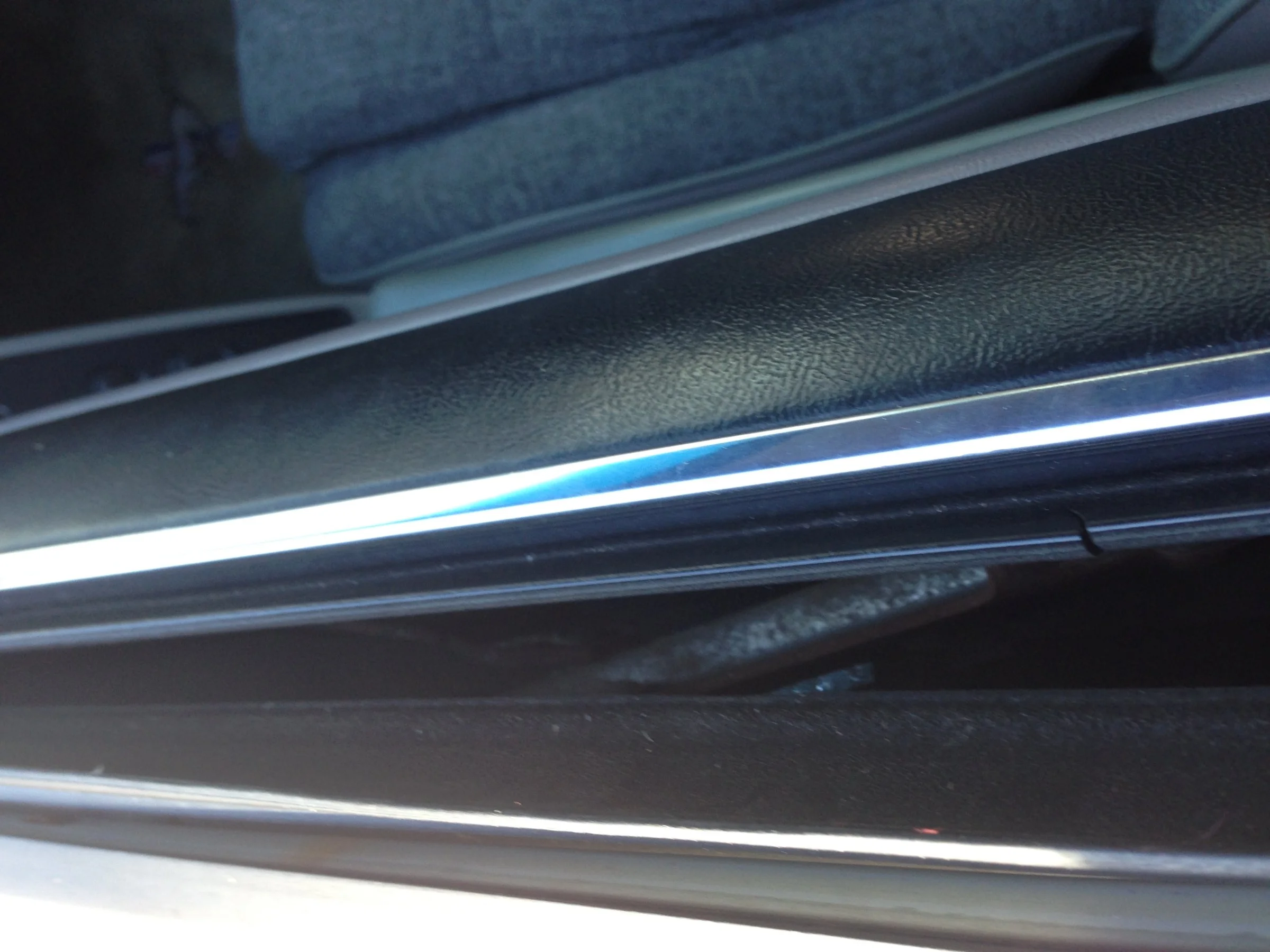

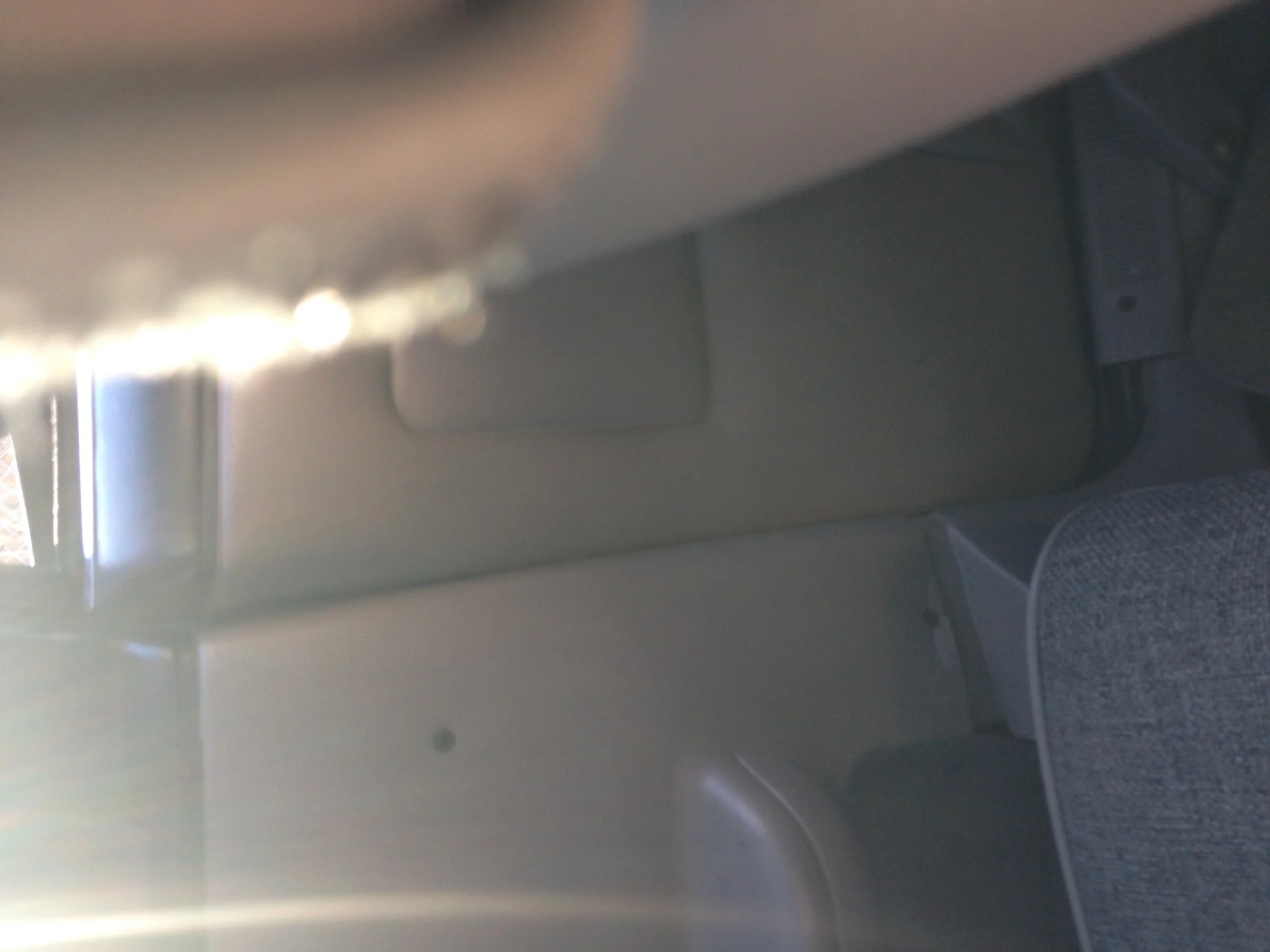

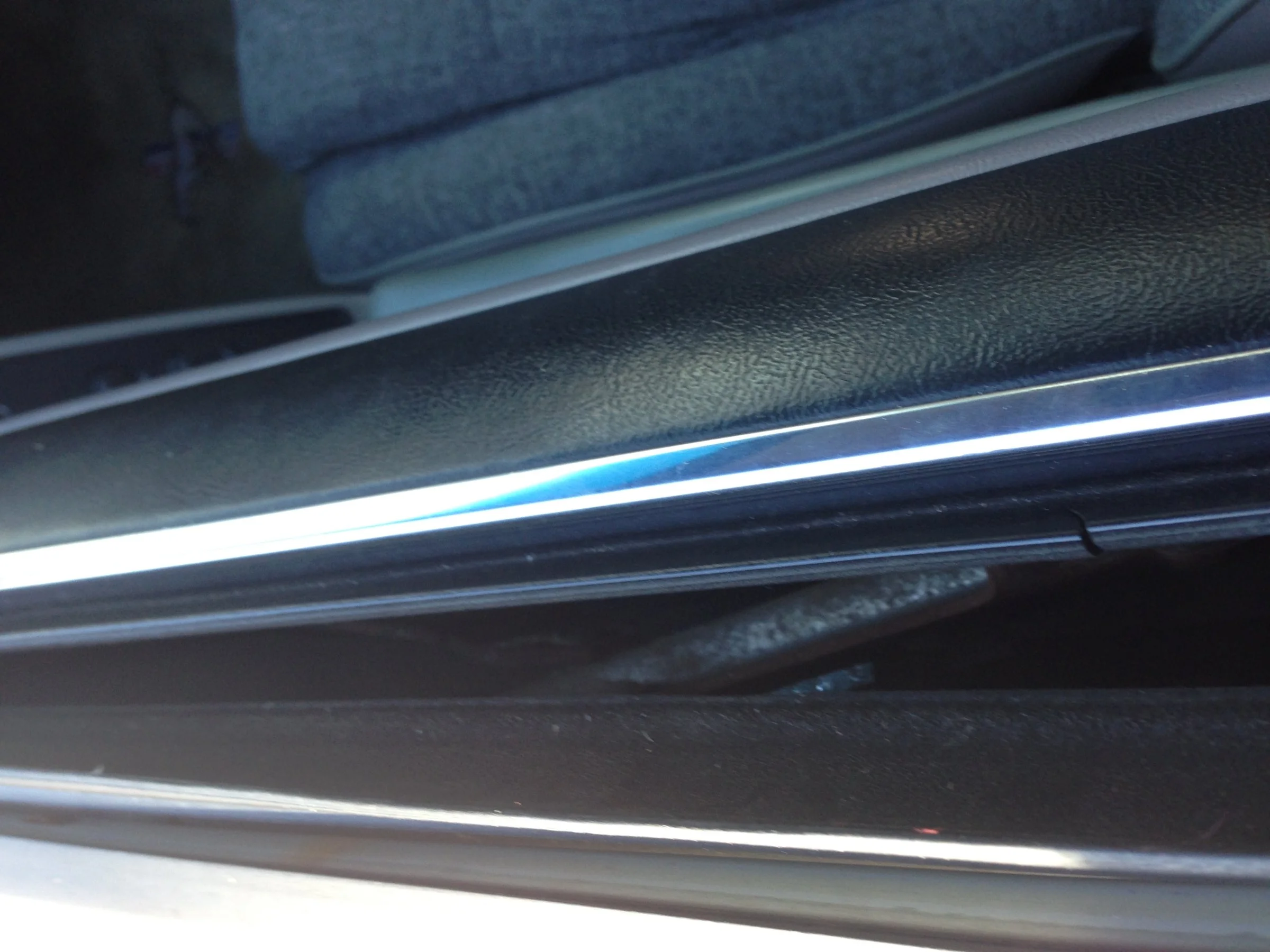

Thank you all for your responses. I did take some more pics and I did try to get the door open from the outside, inside, and within the door. I could not get it to budge not one bit. Here's what I got.

The door is junk so get jig saw and cut an opening level with the striker, big hole, take a hammer and hit the door latch straight towards the door jam, you may have to use a pipe or rod against the latch and hit it with a hammer, you should be able to relieve the pressure on the striker.
Reactions: Davedacarpainter
Yep, pretty much what @karthief says.
You'll want to get it open to see what the rest of the damage might be. You might be lucky and not have any 1/4 jamb damage. If there isn't any, find a replacement door and put it on there till you can afford paint.

UPDATE: so I went and got it looked at, and they said the rocker is bent in several inches and quoted me around 3k like I originally expected but I'm gonna scavenge for parts and do what I can to lower it down.
