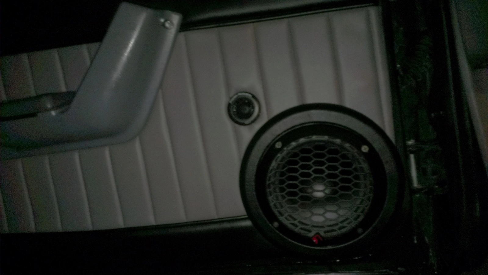

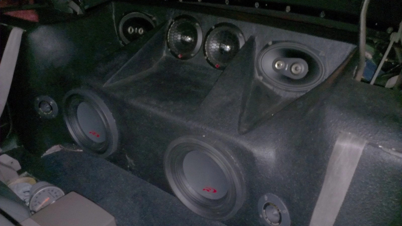

Sorry for the delay. But, here are just a couple of photos. This is by no means finished. I still have trim panels to make and install, install the 2nd amp, etc. It's just slow going at the moment, things keep getting in the way.
Those are 8" Blues Iso-kits. There are actually 4 subs, 2 each coupled together. The box is .57 cu. ft. per side, tuned to 25hz. No, sorry, I didn't get that question. But, at the moment I'm running the stock alternator. Yeah, I know, it stinks. I'm going to upgrade to a 200a, but just haven't got that far yet. It's definitely on the radar and I should have one installed by the time I get all this finished.

Ah, I'm starting to love the 8's, I have a MA Audio 8 that does pretty good. The magnet is HUGE for an 8. Dang 25hz is mad low. Do you happen to know the resonant freq. of these foxes? Right now I'm running a 140A alt and it hangs with my system I currently have. It's just a little Rockford Fosgate system though. Dang, well I just read on the iso stuff. It's pretty neat how they're setup. Nice for less area. :nice:

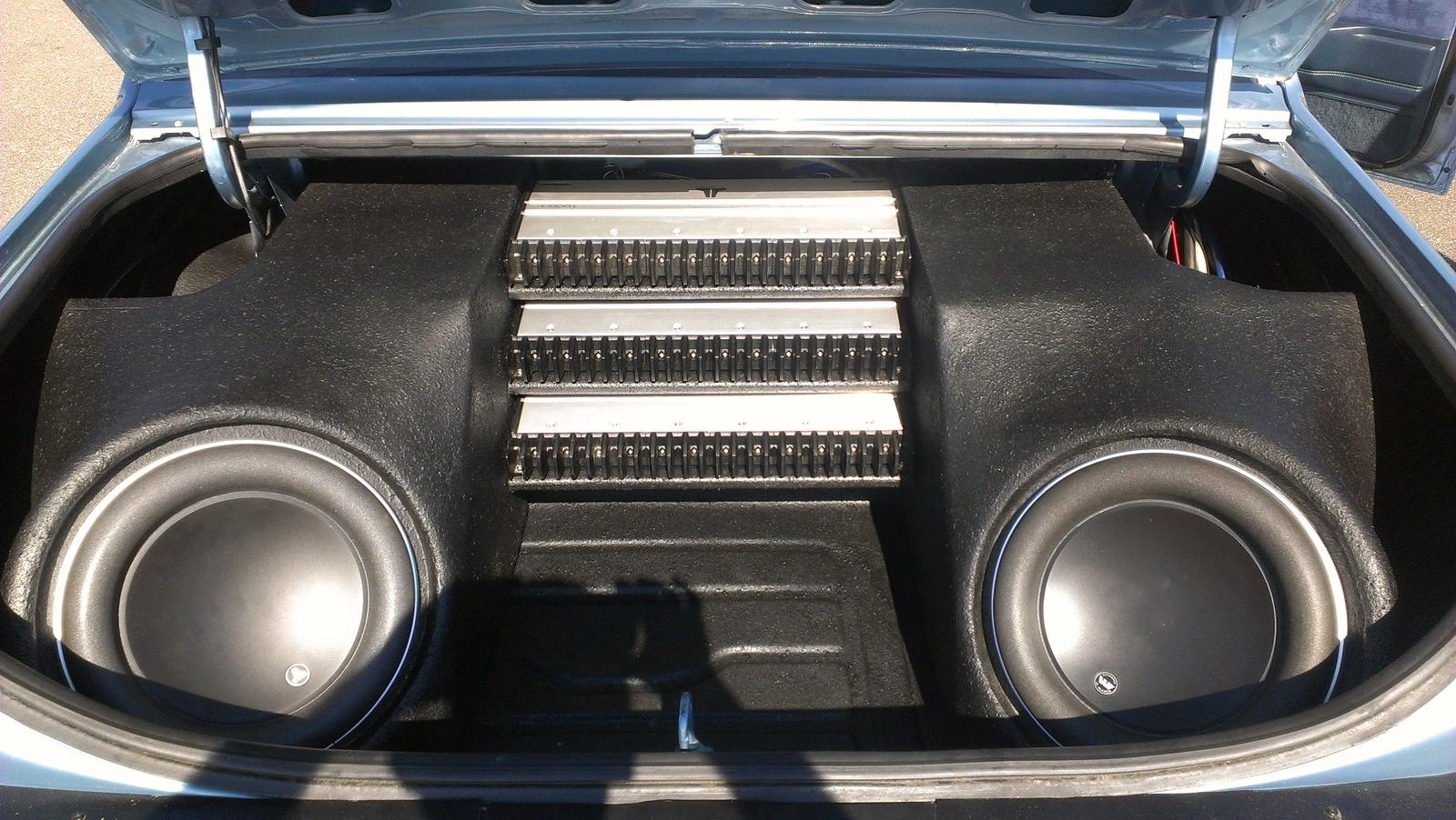

The sn95 alt is definitely a good upgrade. FYI 2300 true watts needs about a 190A alternator. What setup you running bud, just curious. Batteries, amp(s), sub(s), wiring, etc? Any pics? :nice:
mb quart
Discus 1500.1 class D
Onyx oa 800.4 class SQ
reference 6.5 component in doors
reference 6x9 in rear box
power acustic tweets in dash
boss audio 6.5 loud speakers in rear box (i know got em cheap but they sound really clean)
jvc arsenal 10" dvc 4ohm
2 batteries deep cycle in trunk
2/0 power and ground IMAG0139.webp IMAG0138.webp IMAG0243_BURST002.webp
