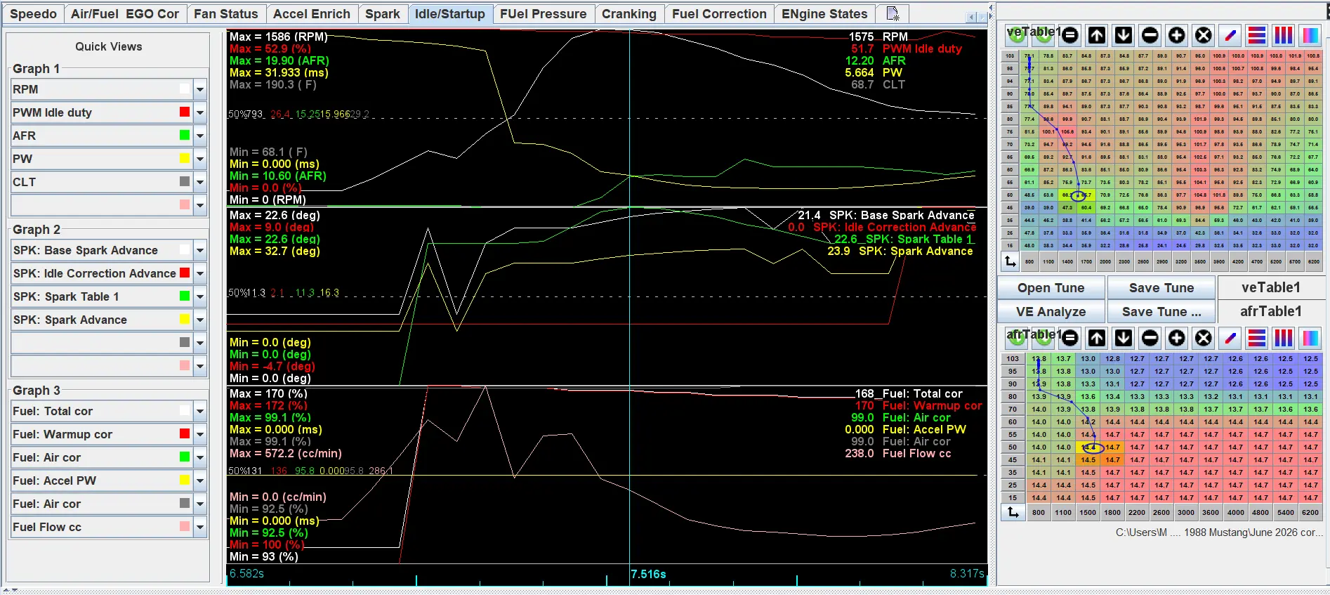

I have attached 2 logs, one just setting at idle and the second is setting at idle and dying.
Note, its not a option to show in the logs, but the injector pulse would sky rocket to 25 when lightly tapping the throttle.
Thanks

There's probably still a number of tweaks that need to be made. Your warmup enrichment prob needs to be tuned. If you go over to the VE analyze tab, there is a tab for warmup enrichment tuning. Enable that and let it run one full warmup cycle and make some adjustments. Have it run all the way to 180 degrees or so.
If it's not cranking once warm, you will need to adjust your cranking pulse at that specific temperature. Try adding more fuel at that temp and see if it helps or hurts. Try taking fuel out.
You also have your afterstart enrichment to tune as well.
Dying when you touch the gas might be the VE cells where your MAP goes might not be tuned correctly. You might have to open up your VE table and have that opened up along with seeing your AFR. Give it some gas and see what cell it goes to and what the AFR is. You might see it's way too rich or lean and can make the adjustments there.
There's a good video you can watch that goes over a lot of this. It's na hour long but you can skip through a lot. But it goes over tuning for good idle and warmpup enrich and other key things.

I think the challenge i'm having is that microsquirt datalogs so few values that it's not what i'm used to seeing with my MS3. I'm simply not experienced enough to bang out a functional tune with so little input.
I still see you running very rich in those logs. AFR 10-12. DO you smell pig rich at idle?

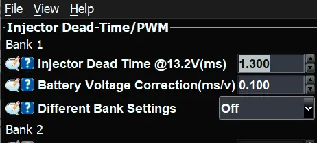

Another question worth digging into. Your injector dead-time number? Where did you get this info? Was this just part of the original base tune you got?
1.3 is a pretty high value. This is essentially telling the ECU it takes 1.3ms for the injector to open and fuel to start flowing. As a result, the ECU is holding the injectors open longer. For comparison, i'm at 0.9 here.
What injectors do you have so we can see if you have the right value here. This might be part of the problem. You might have to drop this 1.3 to 0.9

I think you are hardware limited. I looked at the logging profiles and you have everything turned on. It;s just limited by what the microsquirt can output.
For example, this is one screen that I can see on my MS3 setup. (this was a cold start) I have many other screens based on what i'm trying to do. Also to the right, i have the tune loaded and can see my VE/AFR table so i can see what the engine does at a snapshot in time.
I'm having trouble seeing this on your datalogs. I've just never dealt with microsquirt so not sure if that's just how it is.

Which ones and how old? The older EV1 style injectors like the 93 Cobra? Or newer USCAR-car connector style injectors.
How many years old are they and how many miles?
I think i'm going to have you change that number down. Just not sure what yet. That should shorten your pulsewidths at idle and give you better fuel control.
I think I want to tell you set it to 0.9 but i'm not 100% sure yet.
They are brand new, just purchased them. less than 100 miles on them. I changed it to .7 and it seemed to help quite a bit.

SO they are the new Ford Racing LU24A's?
FORD PERFORMANCE 24 LB/HR FUEL INJECTOR SET
FORD PERFORMANCE 24 LB/HR FUEL INJECTOR SET|Ford Racing Parts
performanceparts.ford.com
If so, here's the dead time curve at 39psi
SO based on Microsquirt wanting the value at 13.2 volts, that works out to 0.97 assuming your static fuel pressure is set to 39psi. If not there are correction factors we can apply
There's a half-assed way to check. Once you are fully warmed up at idle, take your idle VE cells and just add 10% fuel to them. AFR should go 10% richer.
If the AFR doesn't change much or at all, your dead time value is too high. If it changes waaay too much. It's too low.

After changing that, I cant idle under 1300
Yes those are it for sure
