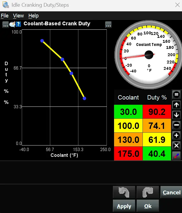

So i'll have to let you sort through the mechanical issues there as I can't help with that unfortunately.
But regarding the hot start issue. Here's where you can control the IAC opening percentage during crank.
So right around 70-80 degrees, it looks like you are at 80% duty cycle. But once warmed up at 175 degrees, you are only 40% duty cycle. You can try bumping that to 50-55% and see if it helps with hot restart.
If at any temp you get a giant flare rev on start to 1500+ RPM. you'll want to lower these numbers and smooth it all out.

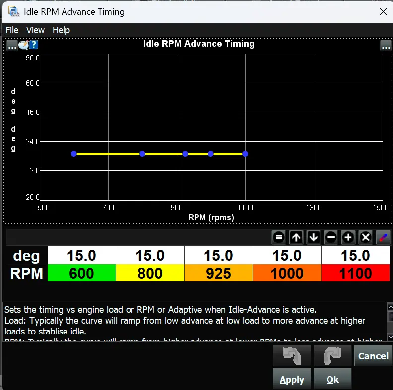

And then here is your idle advance. As engine load increases, this will change timing to increase torque at idle. SHould help with stalling once fan comes on. Essentially if you have no torque at idle, it's timing related.
Yours is 15 degrees across the board. Essentially no advance.
Way this works is when the engine is idling, there's a specific idle state that's triggered.

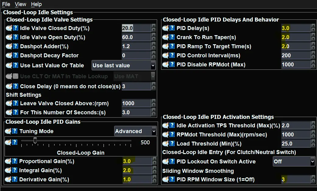

SO i made some changes to both the above menus. SOmething to try but you'll need to be in front of it and make some tweaks.
Idle cranking/duty steps : Made some changes for more air at hot start
Idle RPM Advance Timing: Made a slight curve. 20 degrees as RPM gets down to 750, 15 degrees at 1100.
Closed Loop idle settings: Changes below
  • Test.msq
Seriously thank you for the help, i spent 14 hours today working on it to no prevail. I'm done, just gonna post it for sale cut my losses and rock the stock ecu. It's just not worth the time for me. Just **** my starter because it didn't want to start.
I appreciate all the help, but I'm just done. Guess I'm not built for it I will compensate you DM me
