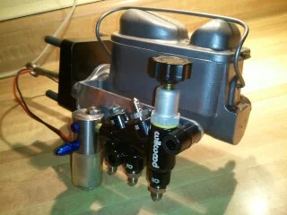

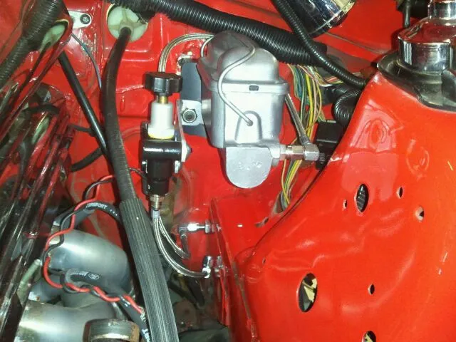

Well this all started with the 93 cobra rear disks. then of course brake pressure was poop and i started reading all the options. I gathered up a v6 booster/mc. That wasnt the ticket for me. Said screw it and changed from my street car mechanic hat to the race car mechanic hat and decided to go manual with a nice prop valve.
i chose the standard issue dual chamber cast mc and adapter from UPR. Very simple. Then i chose the new Wilwood PV/distribution unit. So nice! I did some simple rerouting on the pv to incorperate the hurst line lock. Very clean. I made a bracket to attach the whole mess to the mc. I'm not a huge fan of bending lines and such. Even though its proving to be kind of expensive, I'm running all ss braided lines...everywhere. Coming from circle track racing its second nature to use AN fittings. I converted the mc, pv and all calipers to -3an. Again a slight pia figuring out line legnths but worth it to me. You can sorta see in the one pic that im using some nice stainless -3an "thru the frame" fittings to get to the wheel well. Just trying to keep it clean and tight as possible. RF line will run thru the cowl.
Yes manual brakes take some getting used to. With some fine tuning of the pv and pedal position it should be fairly decent. Cant express how happy i am to have that dang booster out of there!
I will keep you up to date with pics as i work on it. I dont get to work on it as much as i would like. Common problem for most im sure.
Feel free to ask more questions or better yet, suggestions :)
btw...all ss lines are custom ordered from Fragola. they will make whatever you want.
