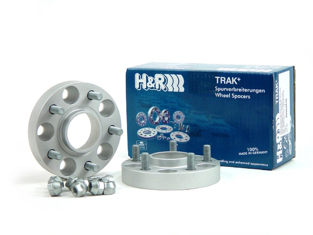

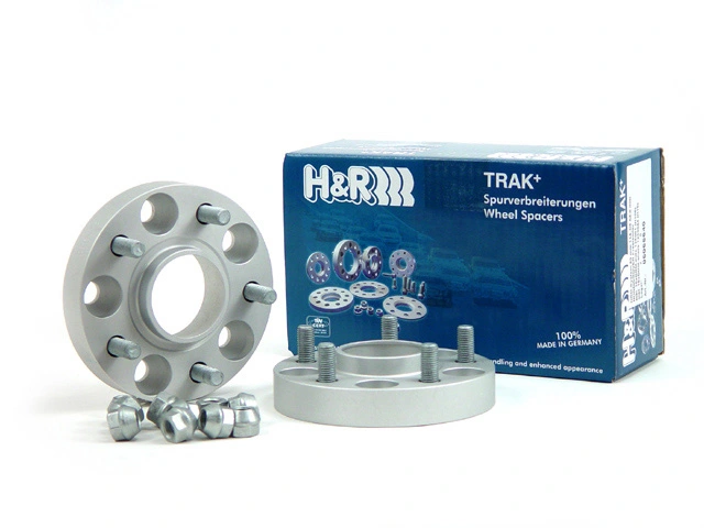

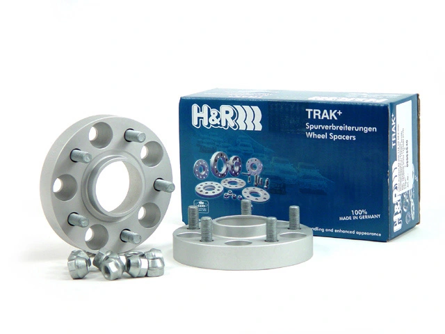

You can purchase 1993 cobra front rotors from auto parts store. They are a direct swap for your current rotors. It's about $50/rotor
Out back, if you so choose, a 3/4" spacer would be all that's needed.
If they are real Ford 1993 cobra wheels, they will hold their value very well compared to aftermarket cobra wheels
Reactions: Red
VERY good to know! I hit up the local shop tomorrow. Thanks!
In one of the threads posted above someone mentions changing the wheel studs to work with the spacer. I would think that the engagement on the threads without the longer studs would be problematic. Any idea?
I'm not a wheel spacer fan myself. But if i were to run them, i would upgrade the lugs and run bolt on spacers vs pass-thru spacers
Downside is cost. These are expensive. Pass through spacers are inherently weaker because they use the same, but longer studs and move the largest area of stress further from the hub creating a greater chance of snapping a wheel lug off.
Some guys have no issues with spacers though.
