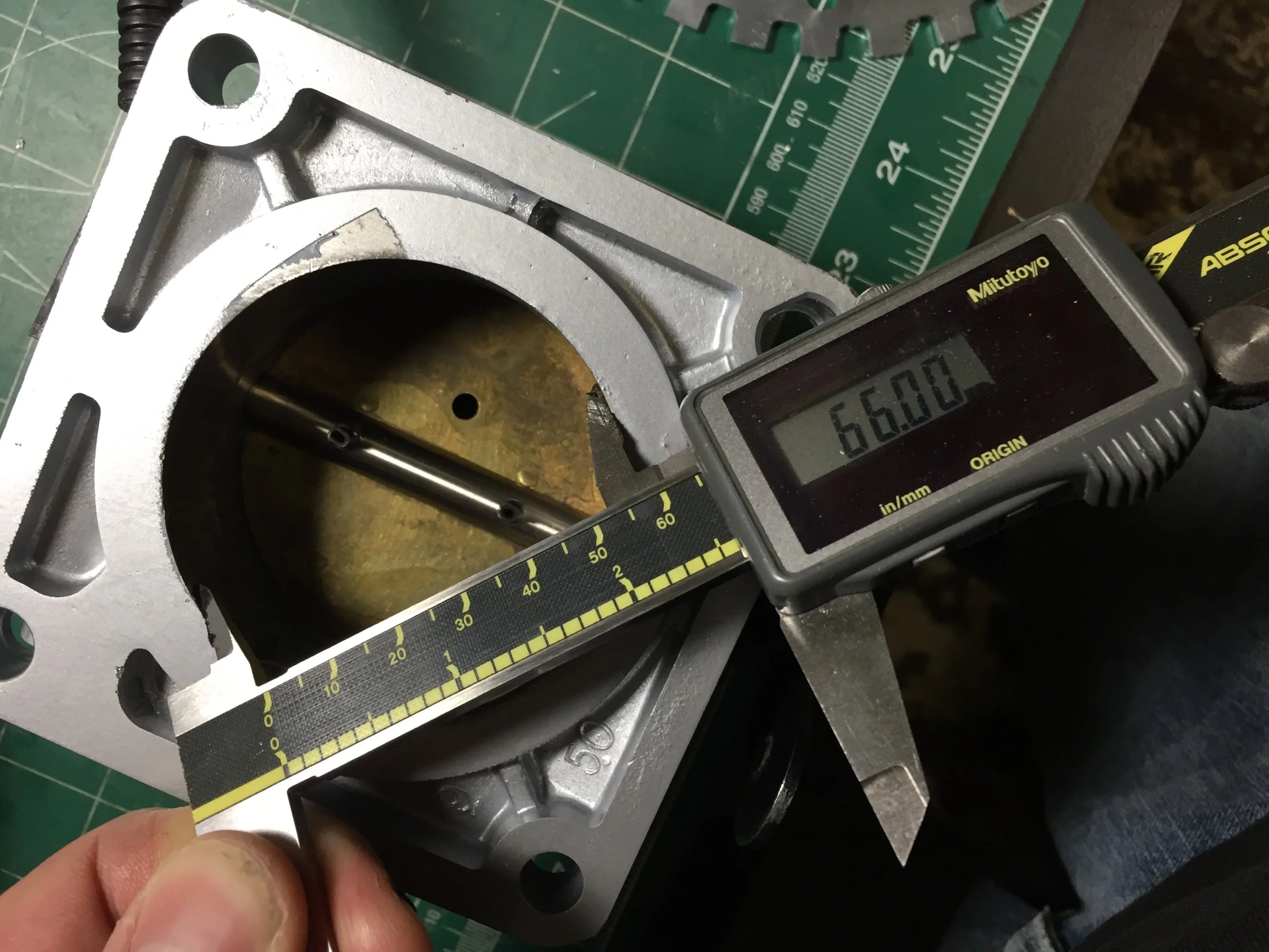

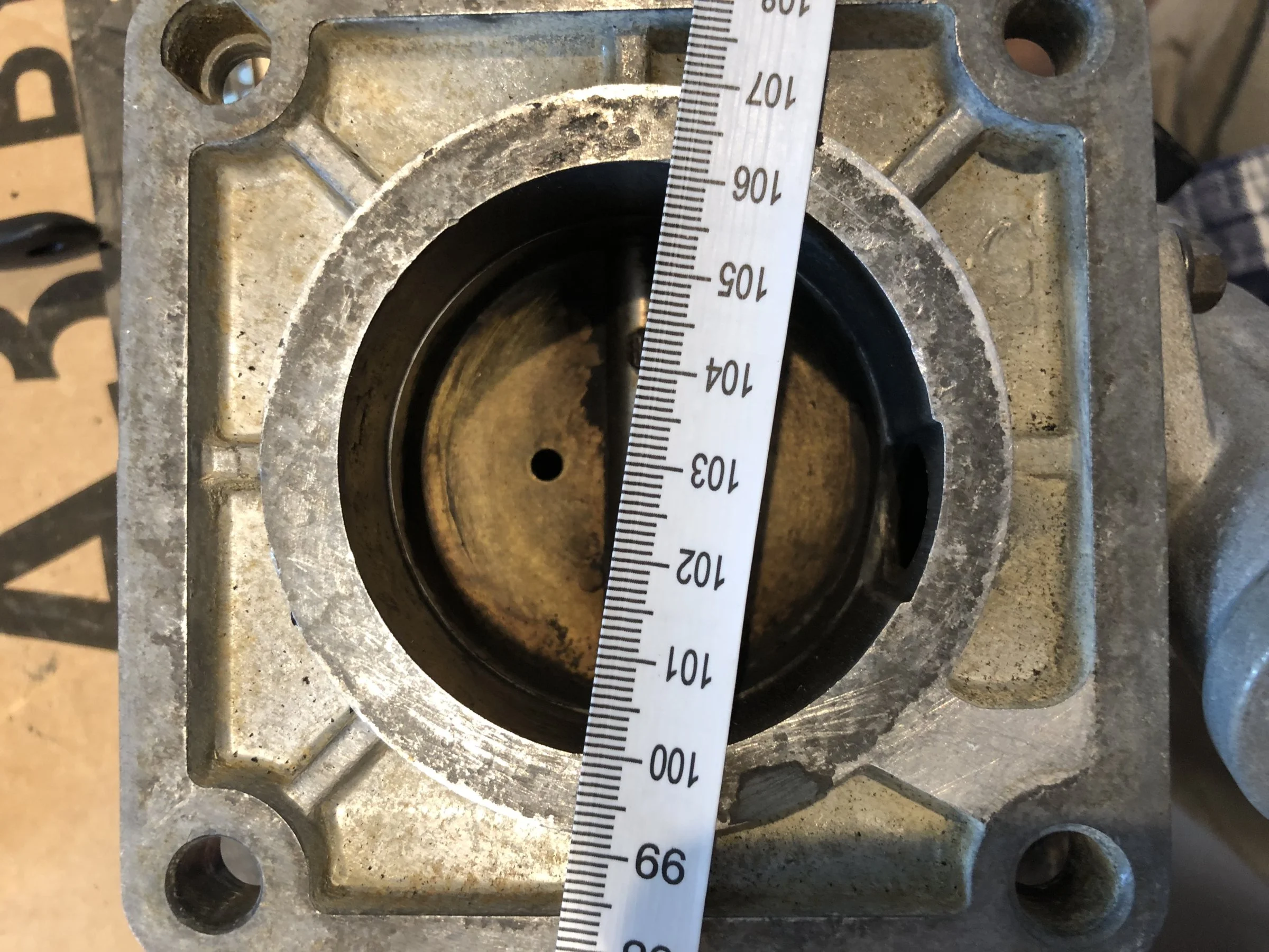

I just got a 93 cobra intake manifold (up and low) for my 90 lx vert. I wanted to upgrade the TB while I was doing the swap so I picked up a cheap used “93 cobra 65mm TB”. When I measure the opening that meets up with the intake it looks like 62mm. Is that right or did I get scammed? The price almost seemed too good to be true so maybe it was. Is there any other way to tell if it was actually off of a 93 cobra? Thanks.
Just with the a ruler and tape. I don’t have anything more accurate. Here’s a picture showing where I took the measurement. I made sure that it was the widest part of the opening except for the notch where the IAC attaches.

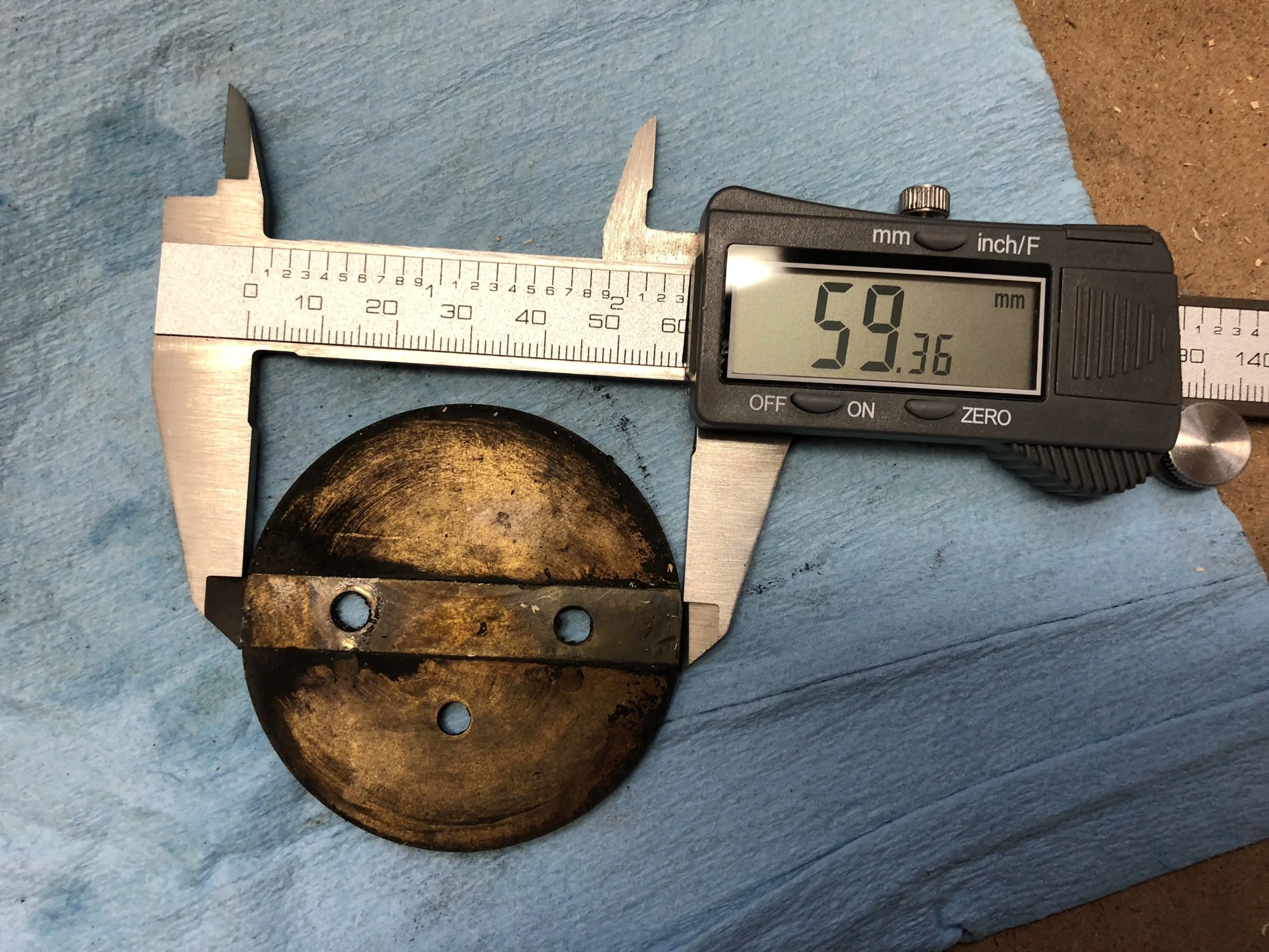

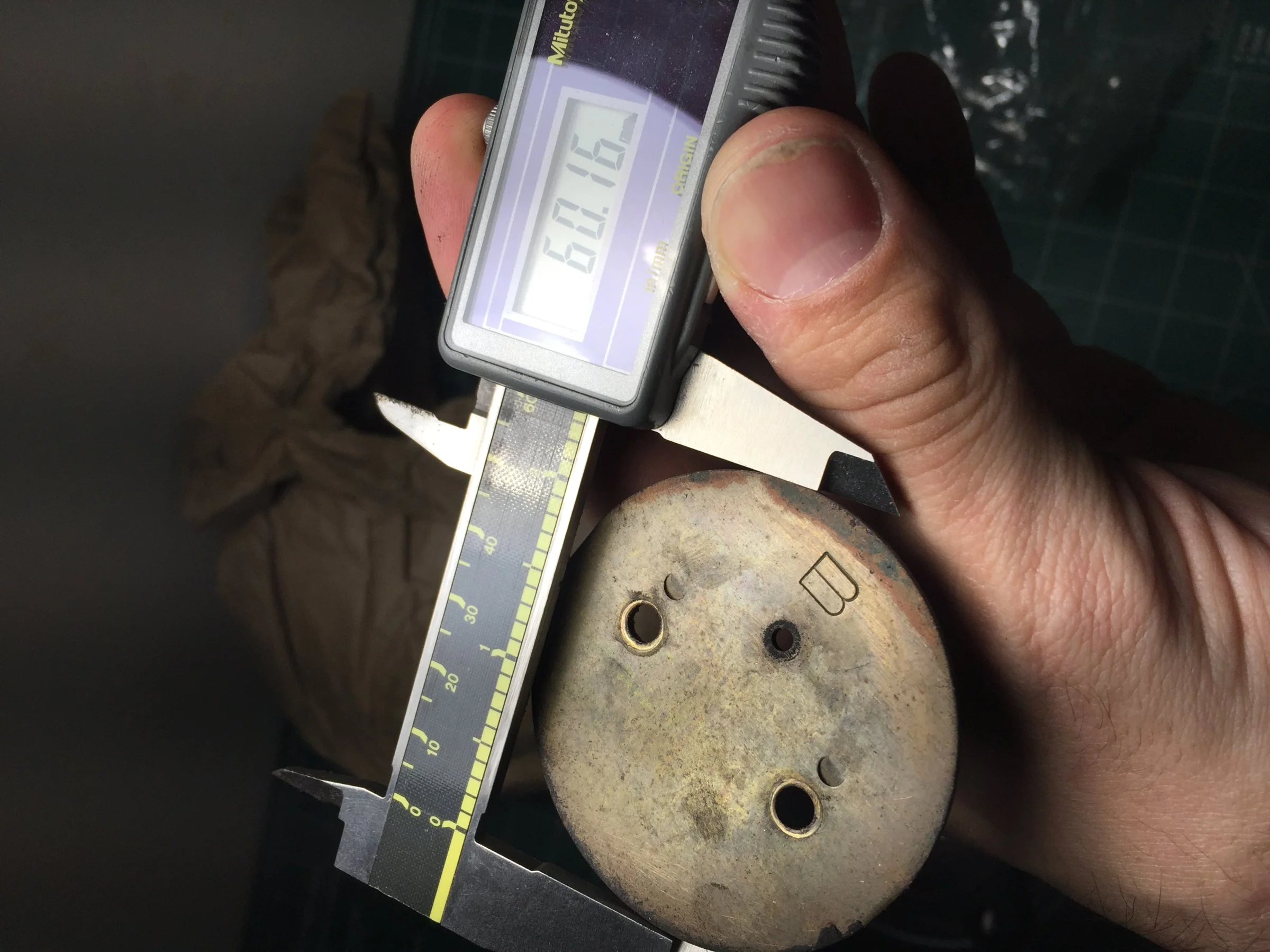

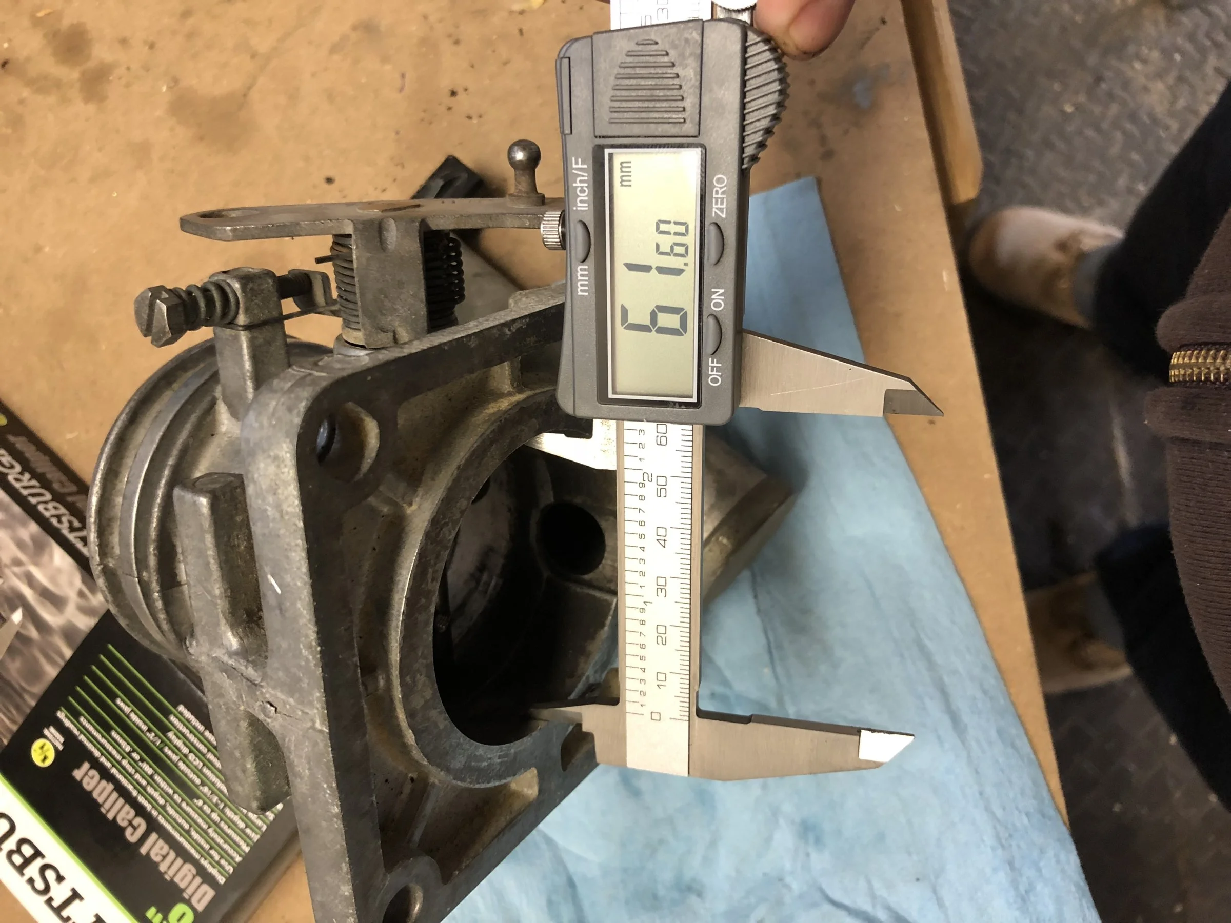

As recommended I picked up a cheap caliper and took some more accurate measurements. The disc is only 60mm so it looks like I got a bummed deal. Thanks for the help.
