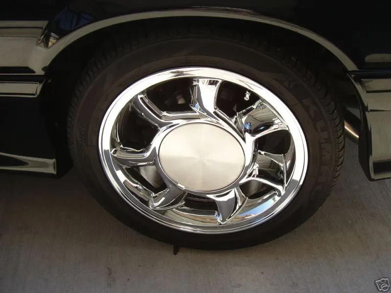

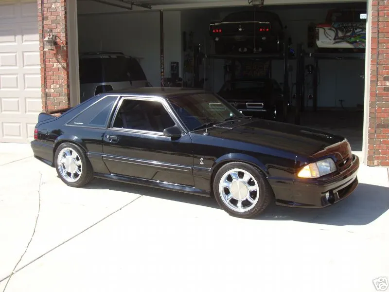

I'm new here but going through the same problem. I just picked up a 93 Cobra with chrome replica wheels. The car also has a Eibach 2" lowering kit. I had to send my wife to pick it up(it's really hers anyway)so I didn't get to inspect. I had a shop do an inspection before I paid just to give me comfort in the purchase. Well when she got home I saw that the rear driver's side tire was being ate up by the inner fender. Luckily I was given the OEM wheels and had them installed tonite, problem solved. I think the OEM wheels look better than the chrome anyway. BTW, it has GT rotors installed on the front but if your lowered they will still rub. The OEM width is 7.5".

I paid $676 for the replica wheels and had them on the car for about 750 miles so they are still almost new. They are 8.5" wide compared to our stock width of 7.5". Where are you located? I would like to get rid of them and shipping should not be a problem( I have a UPS acct)so let me know. Make me a reasonable offer or trade. After talking to a few reputable speed shops, I think as long as you are at stock spring height, they will clear IF you use GT front rotors and the narrowest tire possible on an 8.5"wheel. I talked to the previous owner today and he said he had several offers for the OEM wheels but declined so sounds like they are very hard to find at any price. This could work out well for me because I could use the $$ to pay for a new throwout bearing that decided to take a crap yesterday.I wonder if the Vortech SC has anything to do with that?? I could use any advice/help on maintaining a supercharged 93 Cobra?? Any one??
