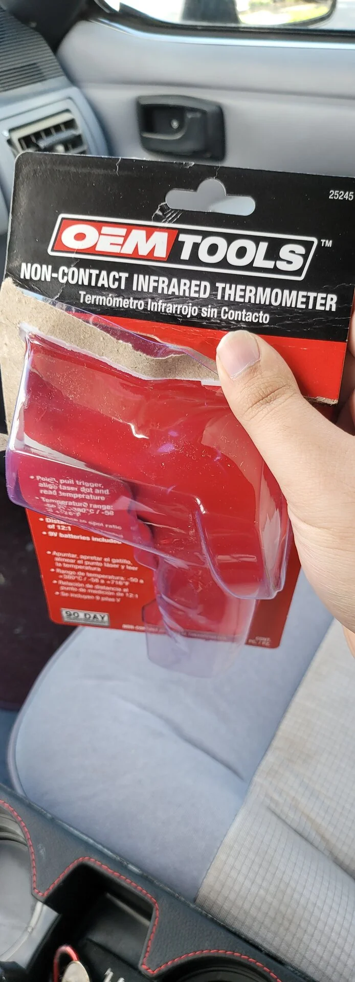

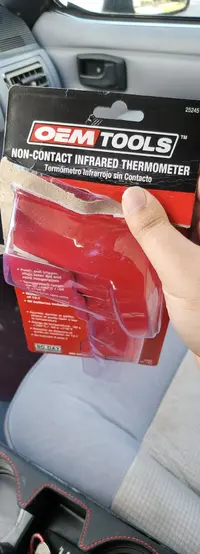

I bought this from autozone it clearly works because it does change temp but when I point it at the radiator or the hoses it's only says like 80 degrees but when I pointed it at the exhaust manifold it read 94 degrees it was like a 25 minute drive to get where I am was that not long enough for it to warm up
