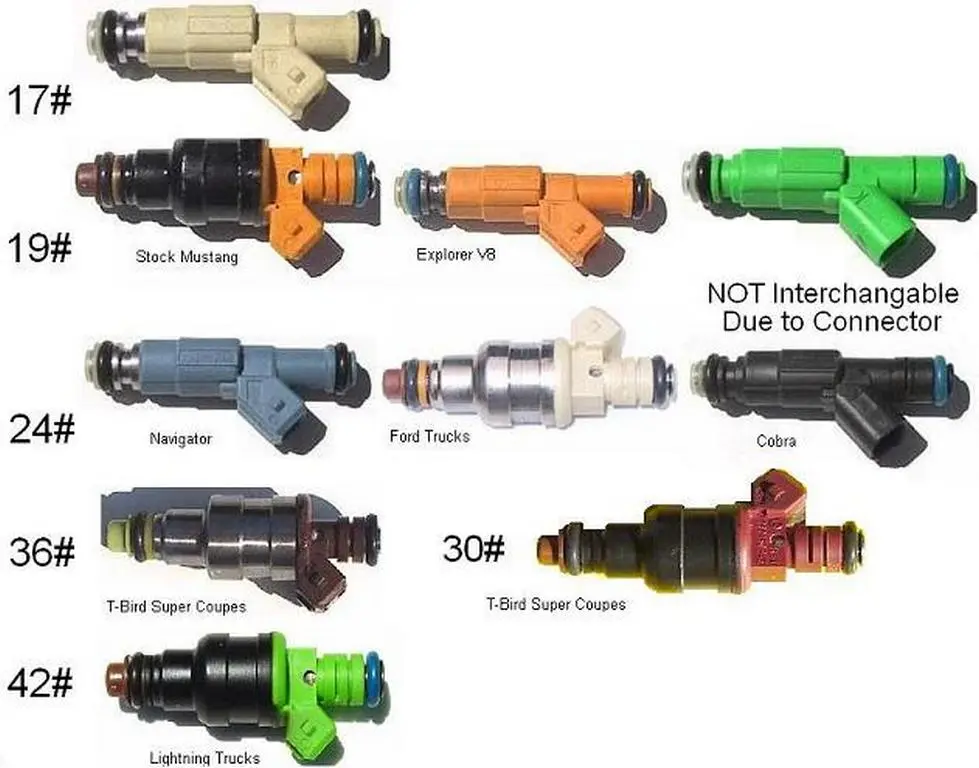

Ford Racing also used Bosch injectors, the 30's (which I still have) are red. A picture might help. This is just a sample.
If using the '93 MAF, it is not a match & will not function correctly. The factory MAF is matched to 19lb injectors.
Unplugging the MAF throws the ECU into "limp home mode"
With the rebuild, you have better combustion & air flow & the ECU is no longer able to compensate for the MAF/injector mismatch.
You could throw some used 19lb injectors in there & it should run like a champ. 19's are good for 300hp

All Fords of the era used Bosch injectors, don't assume these are 30's.
