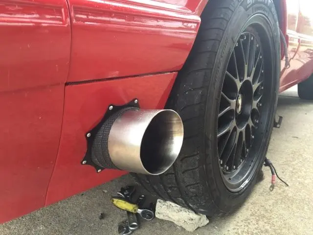

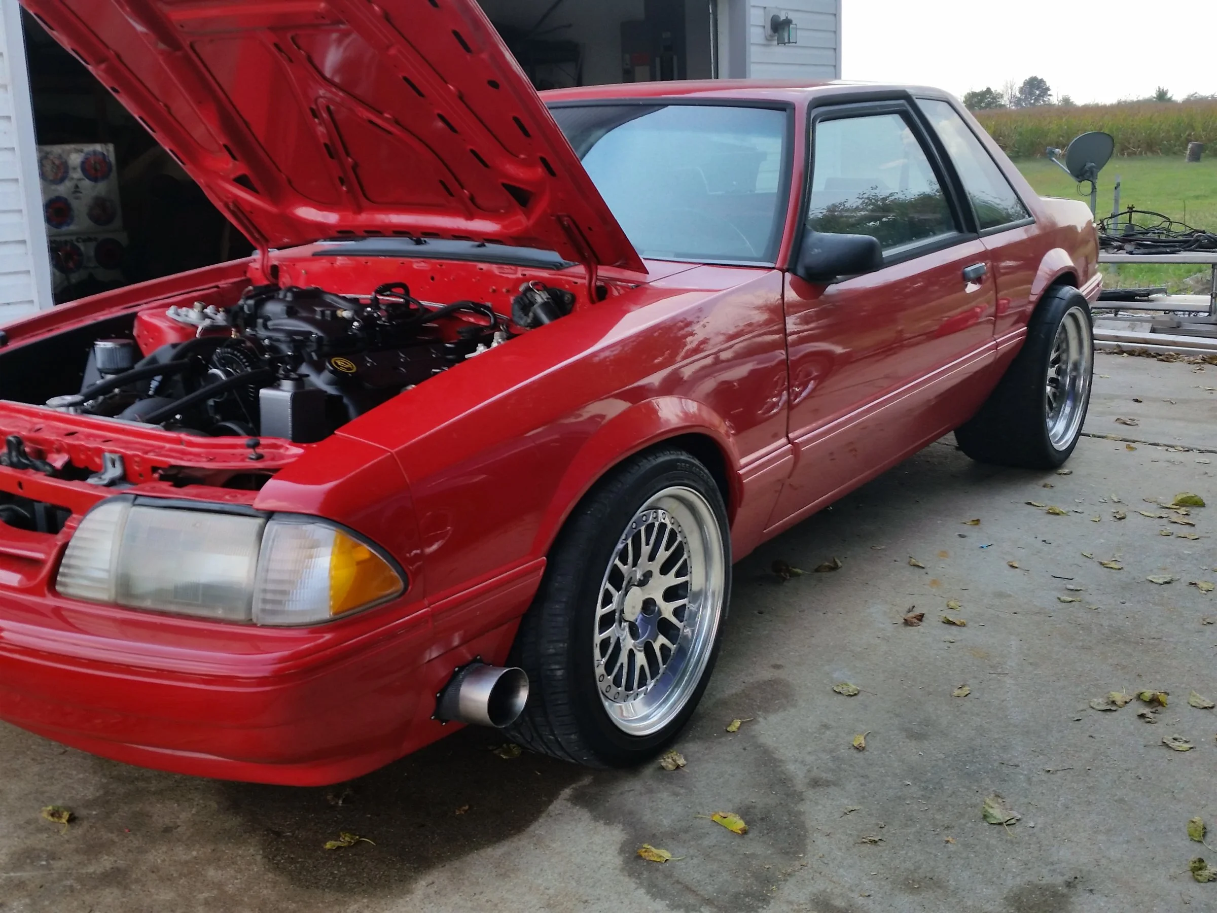

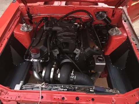

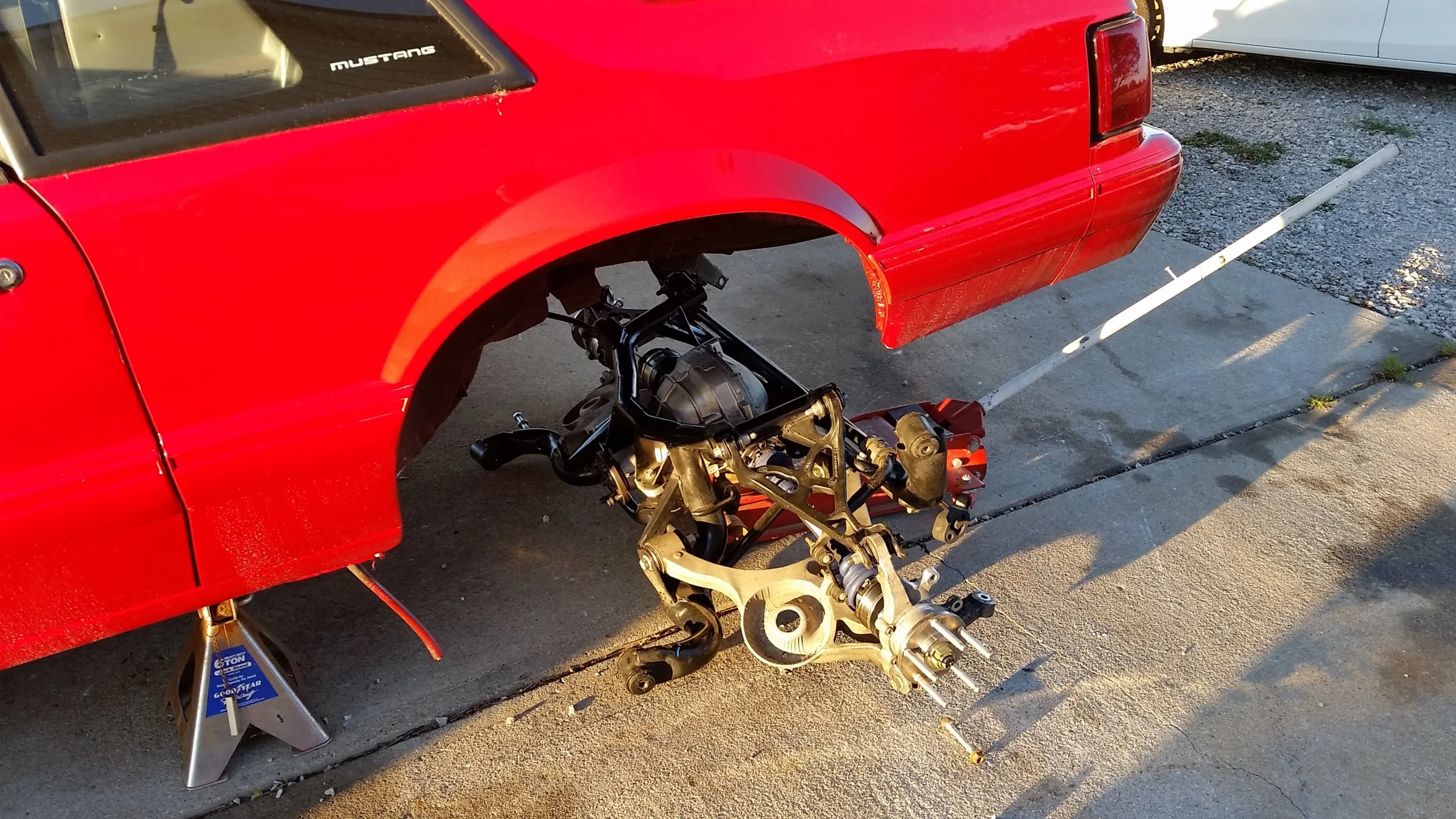

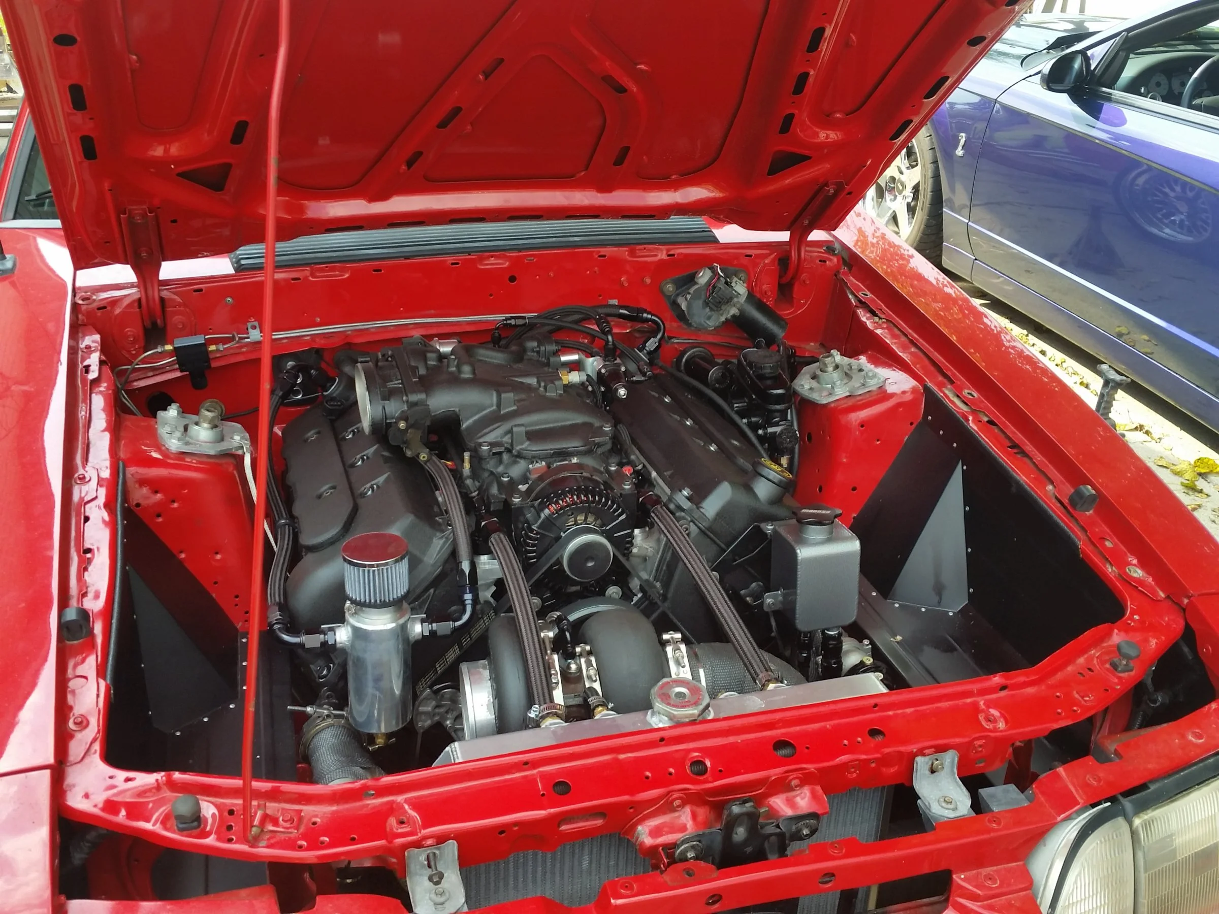

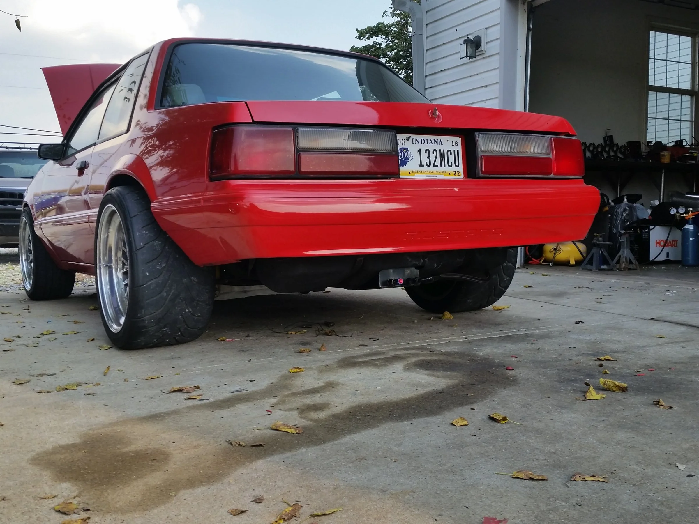

Well, I haven't been on here in years but I figured I would post up my build thread finally.

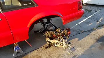

It was a 93 4 banger auto car from factory. Bought the car 10 years ago off the original owner with 21k miles, has been sitting as a roller for about 3 years. Car is 90% done, should be running in a week or so.
Details:
Built 10.1-1 04 mach engine/drivetrain
Built 3650
04 cobra irs, (dss pro level axles, billet hubs, Auburn locker, ftbr bushing kit, etc.)
Custom turbo kit w/ 4" fender downpipe, gt42r garrett, non intercooled.
E85
Full fuel system
Holley efi
Whole bunch of crap.

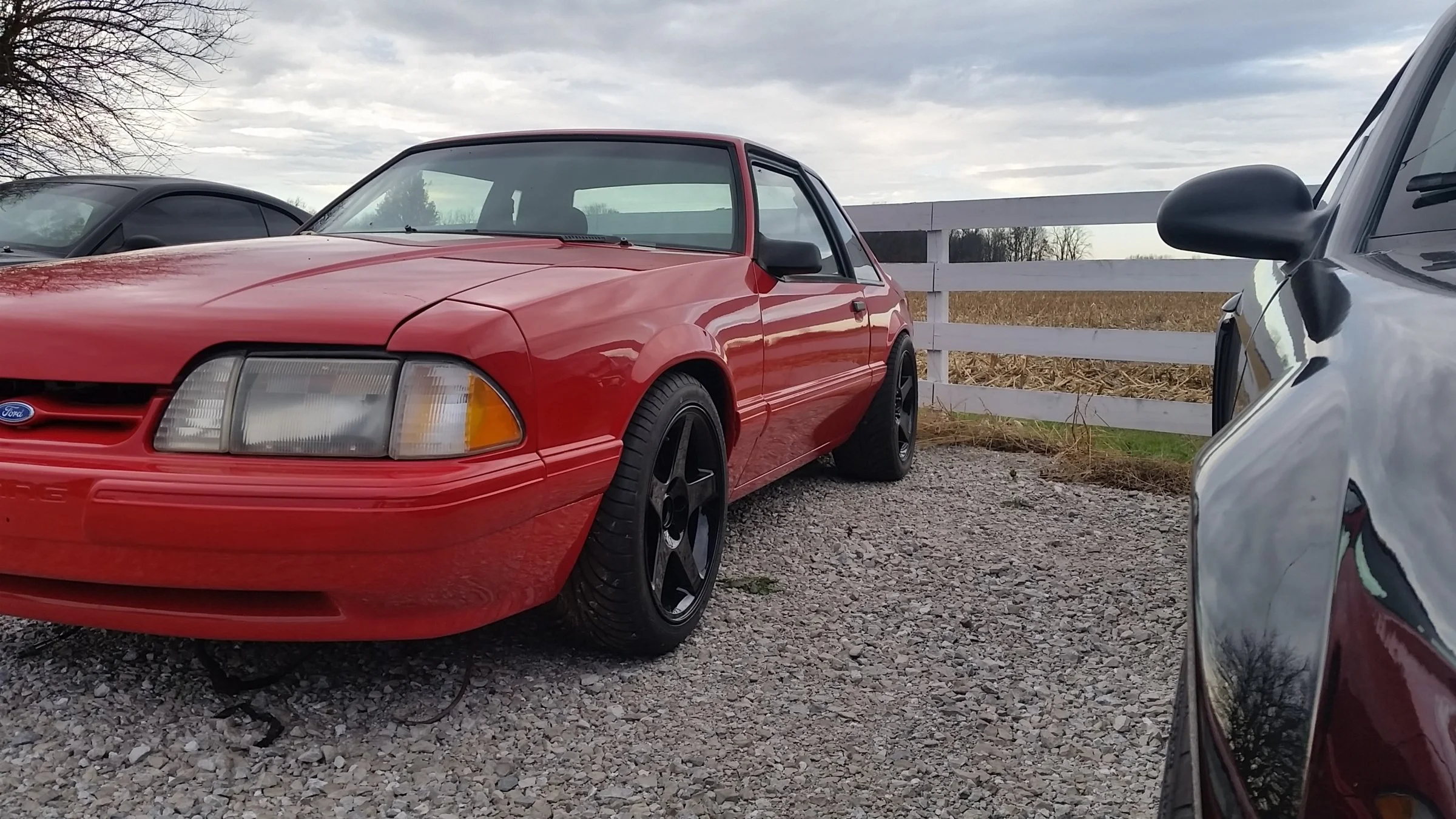

I need to get some better pics lol. It has the black xxr pos wheels on it now. Prolly will get black ccw classics in the winter.
