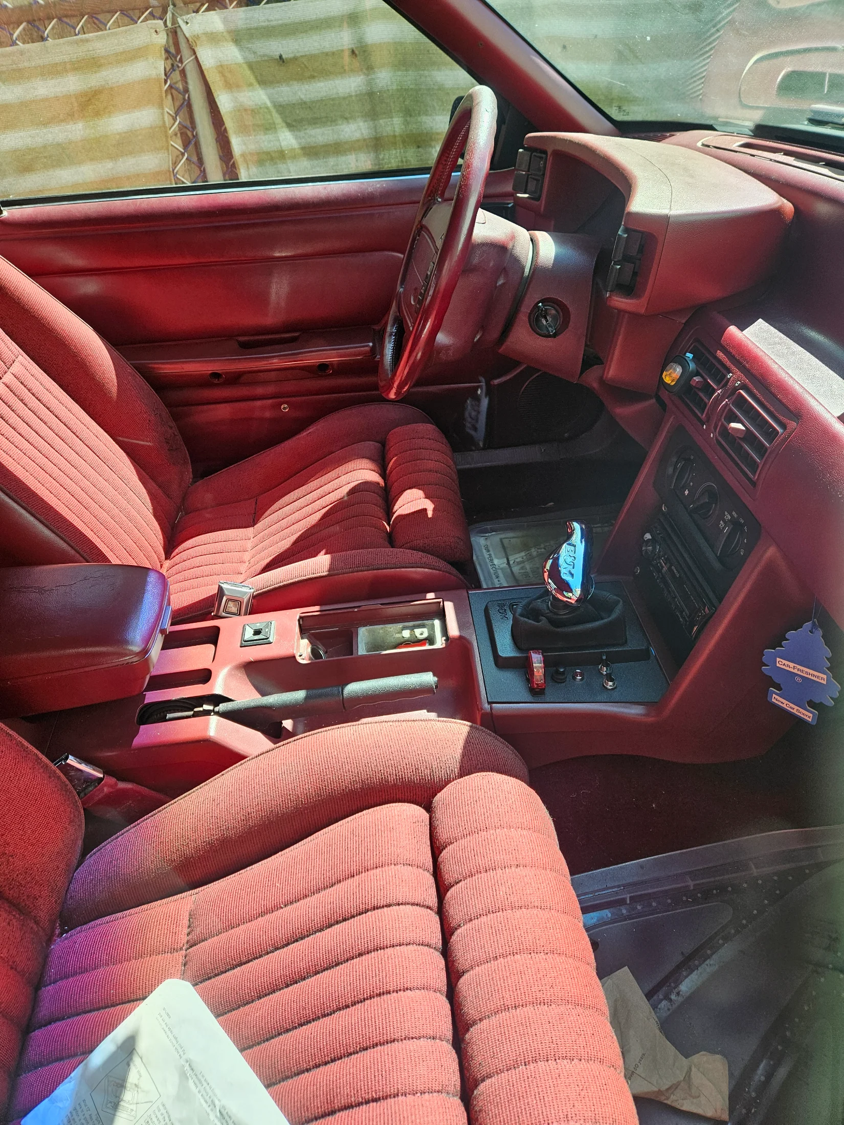

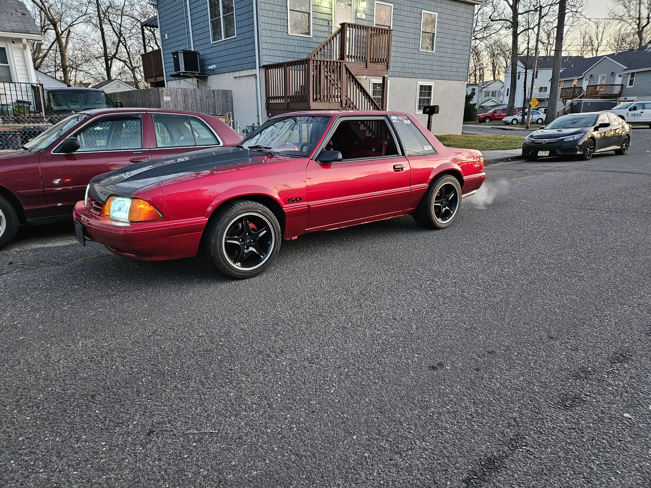

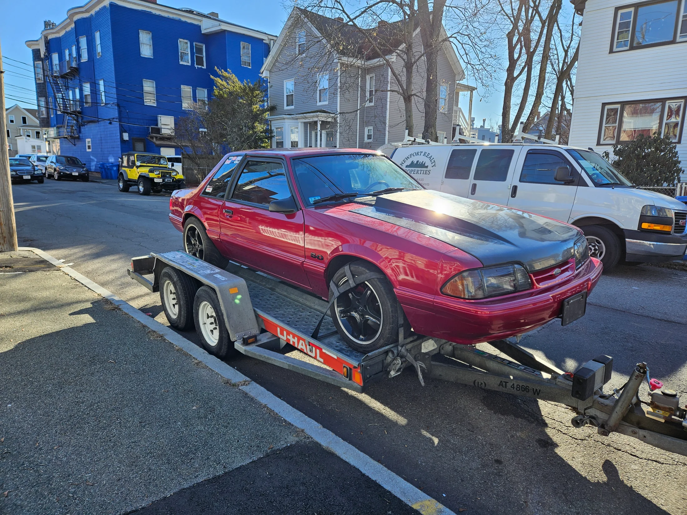

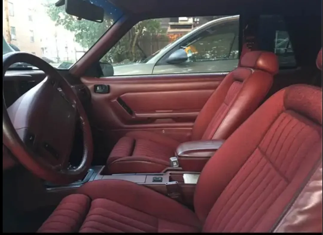

Just bought my 93 Notchback and I'm eager to learn all the ins n' outs of the platform. Ever since I was a kid I've never been a big fan of the foxbodies--except for the Notchbacks. They've always had that "Look" to me. I've always been a fan of the "Sleeper" mode.
I'm from NJ and looking to do a few tasteful and personal mods to it. I've already bought a tilt column to replace the airbag and column in it. Not sure of the exact color, but it's a red on red with a 347 stroker, monster AOD with 3.73's. Picked it up and few months ago from the former owner in Massachusetts. Except for a few hiccups, I'm pleased with my purchase.
