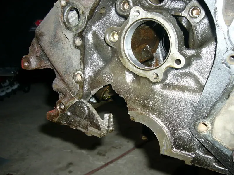

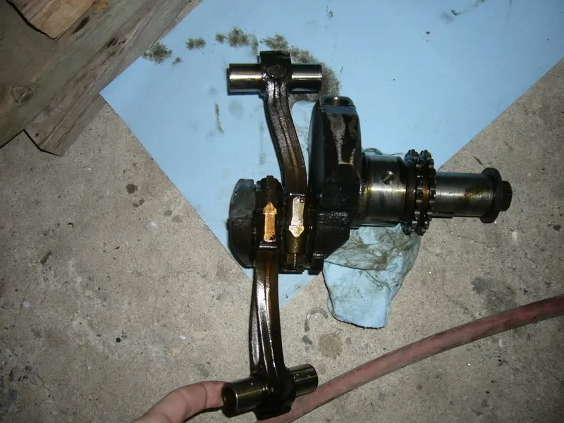

Could very well be the balancer, although the way you said it got worse when you hit a bump leads me to think torn motor mounts. See picture for my expierence with a bad balancer that seperated at high speed!
