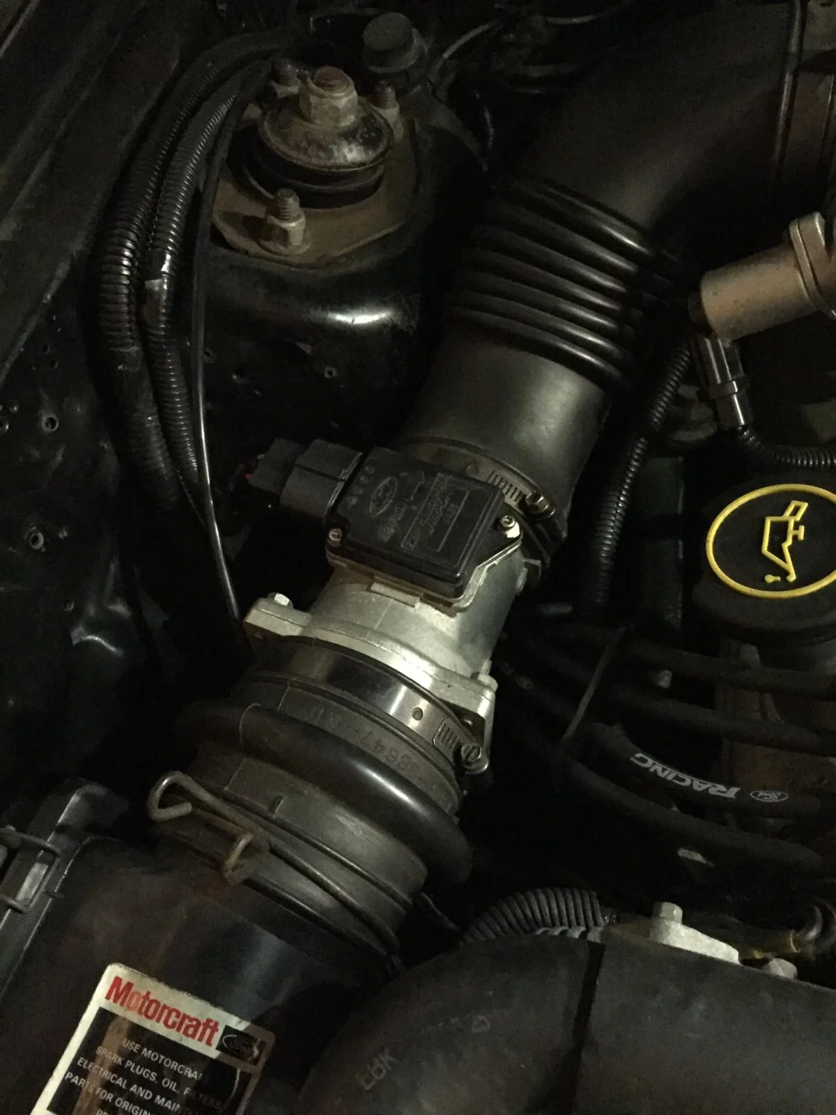

considering you already have thw MAF, I wouldn't buy another either given the cheaper costs of an adapter. I'm using stock airbox and inlet tubes. I'll get some measurements in a bit
I'm going to measure the hose when i get home also... Your using the stock Air box also right?

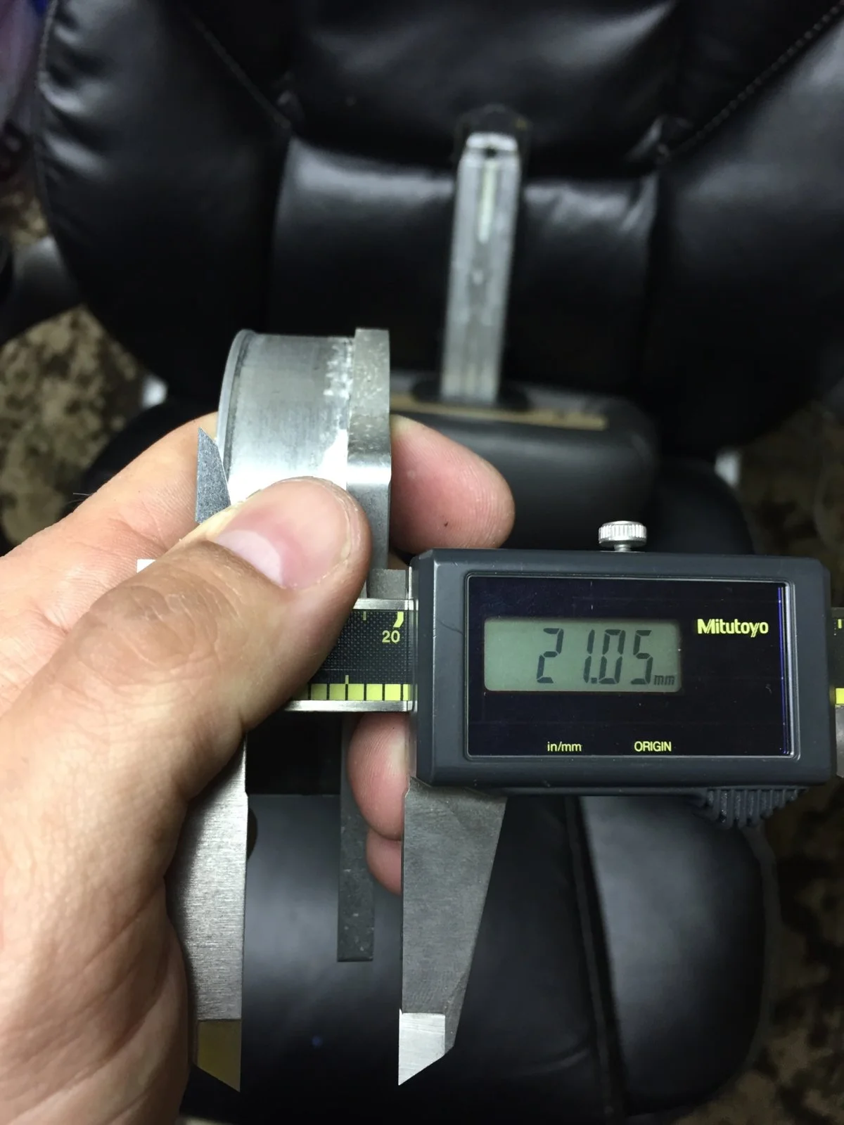

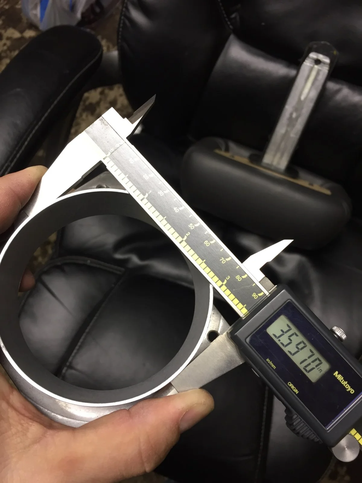

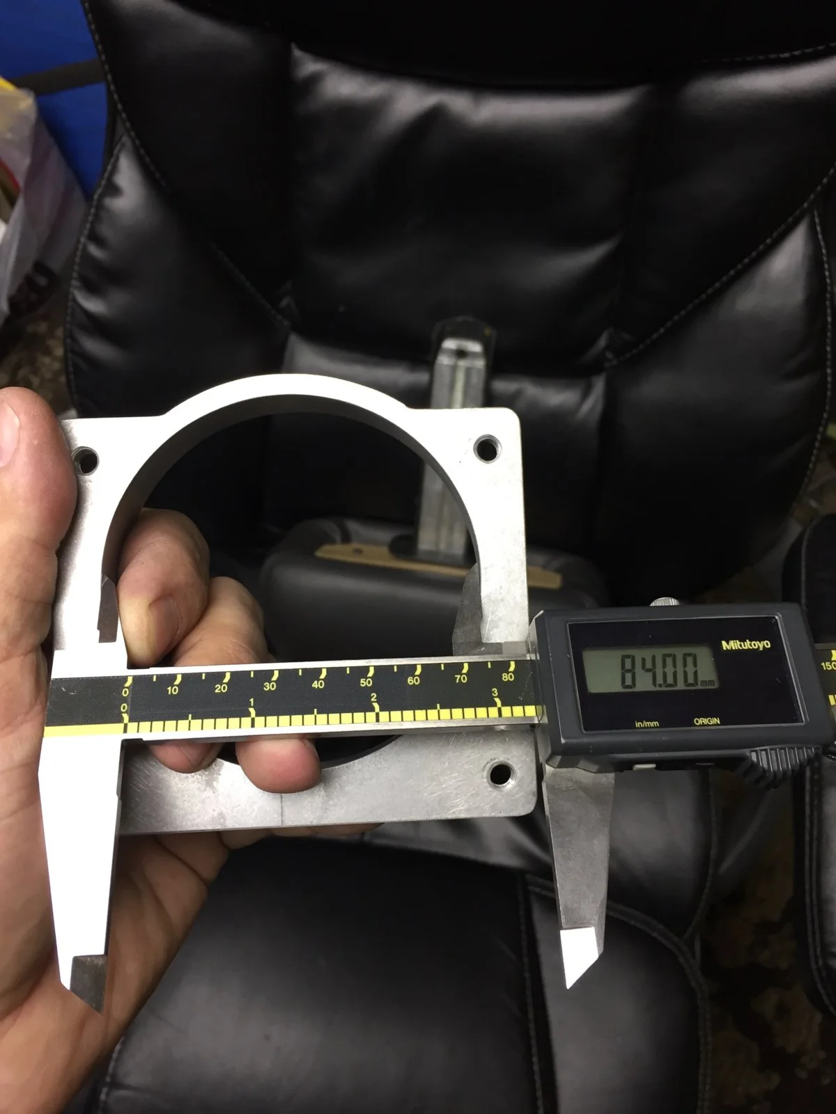

OD is roughly 3.5"
ID where it meets the Ford MAF is 84mm. There's a taper
And the extension is roughly 21mm
Works with stock airbox

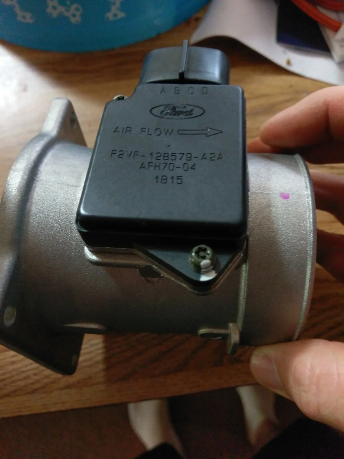

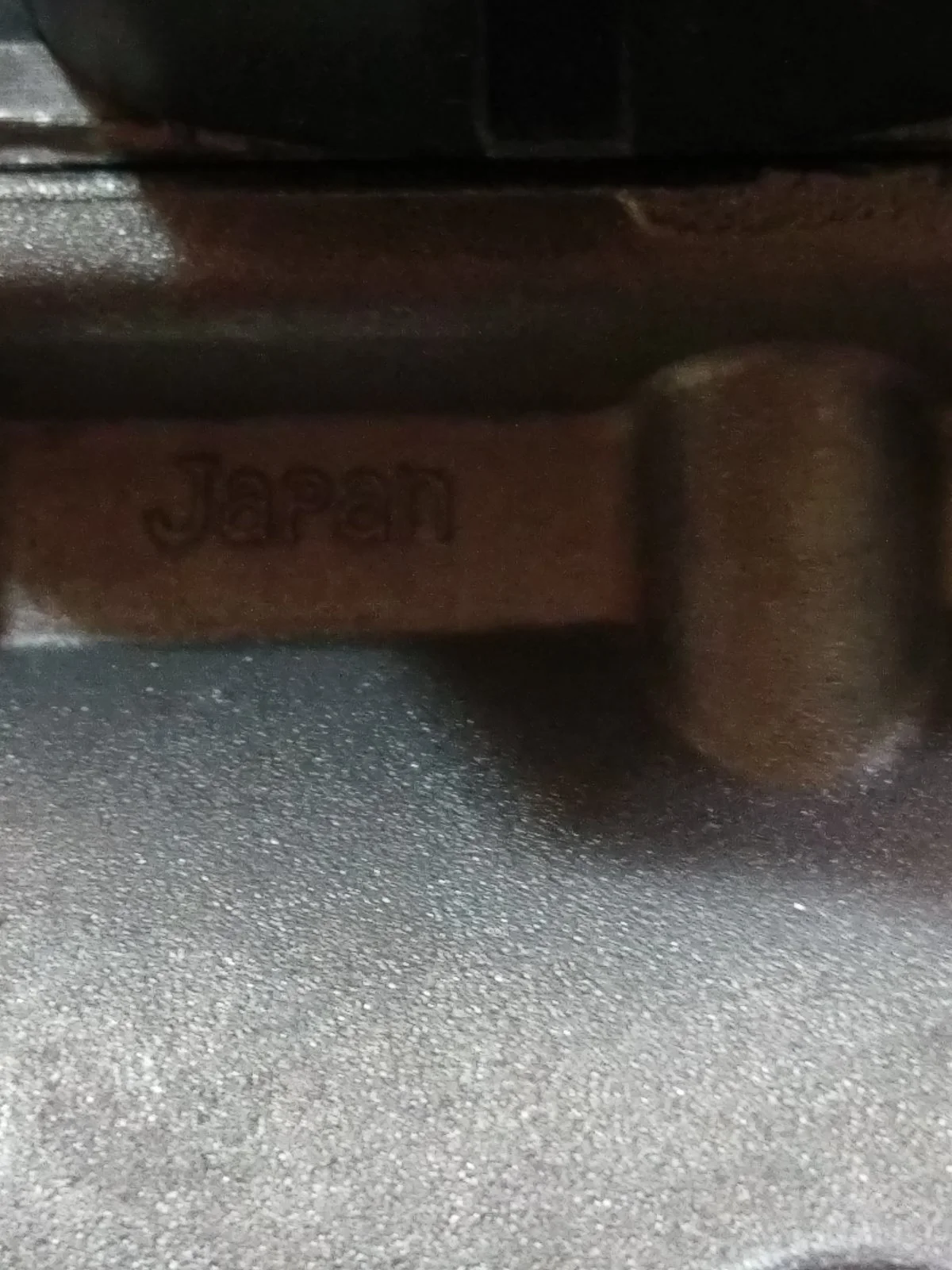

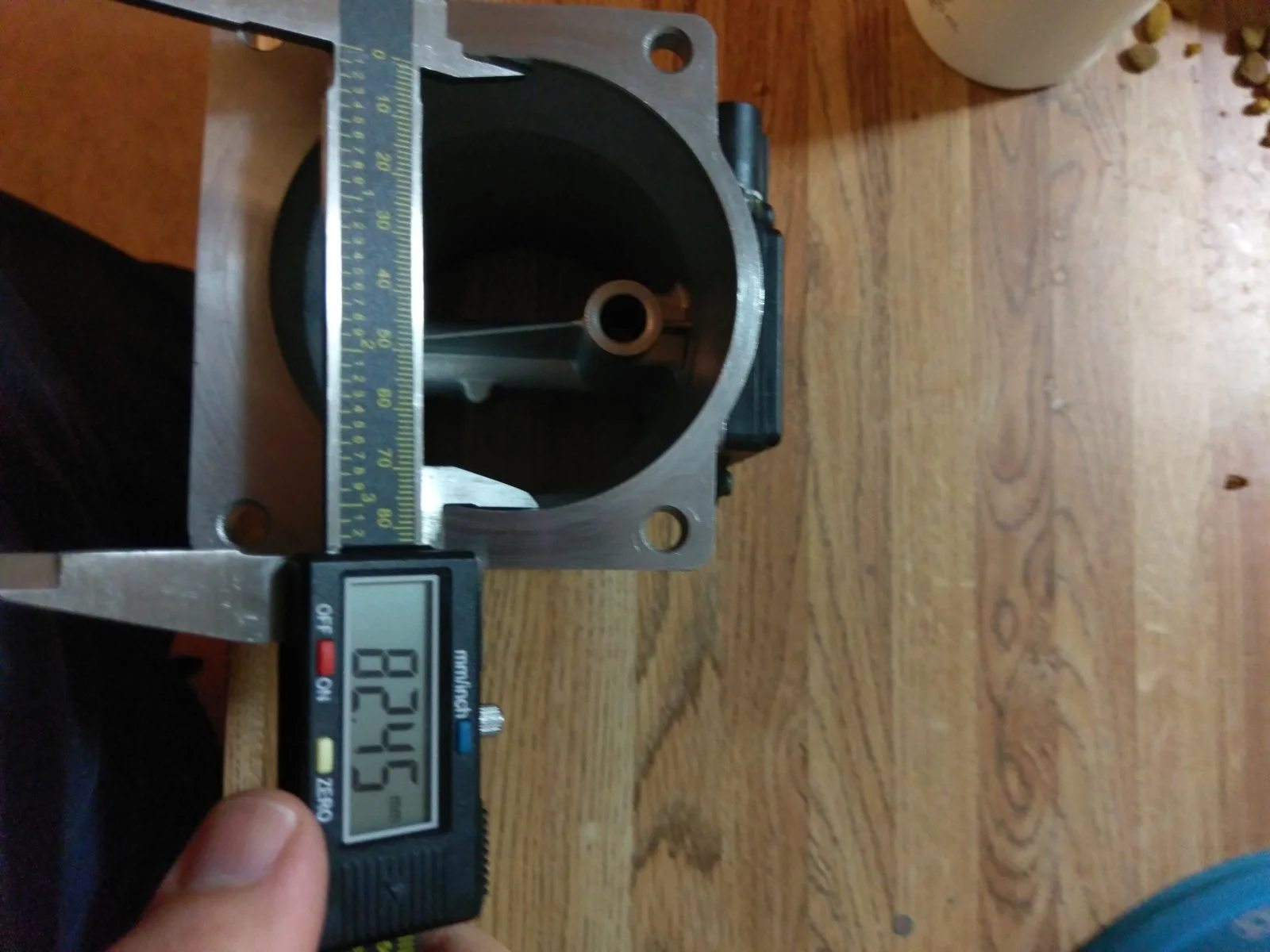

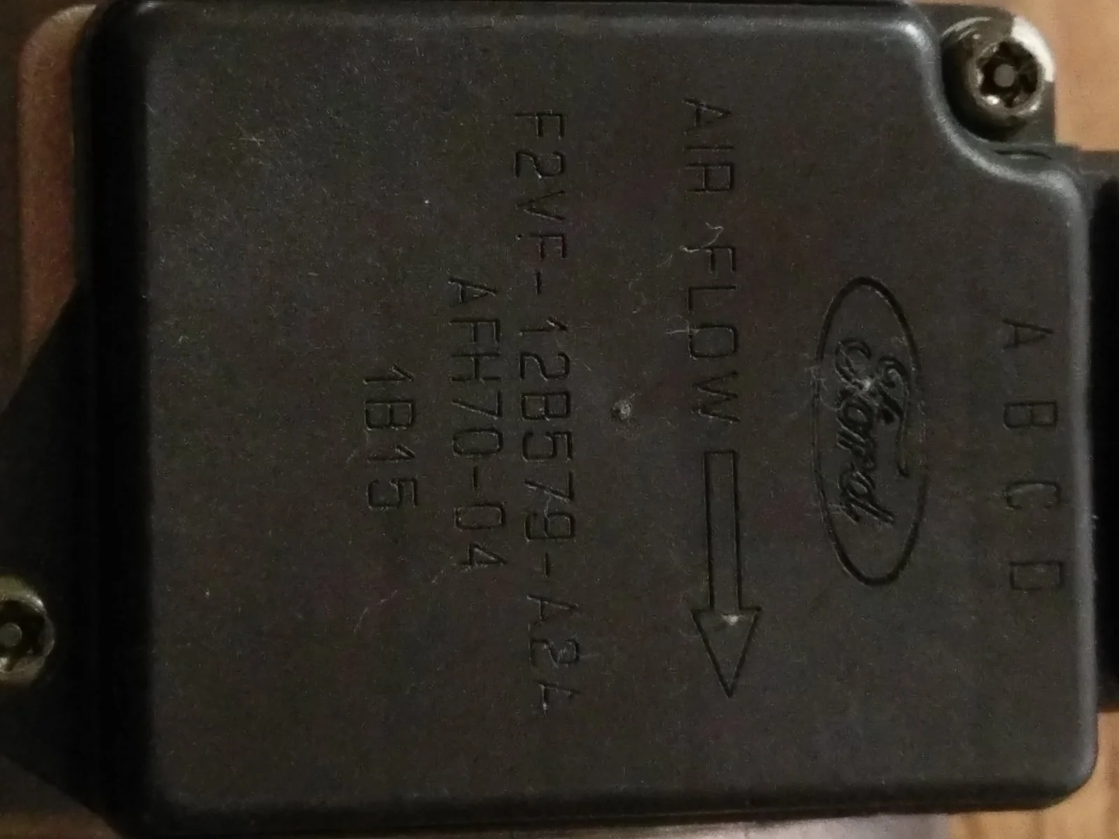

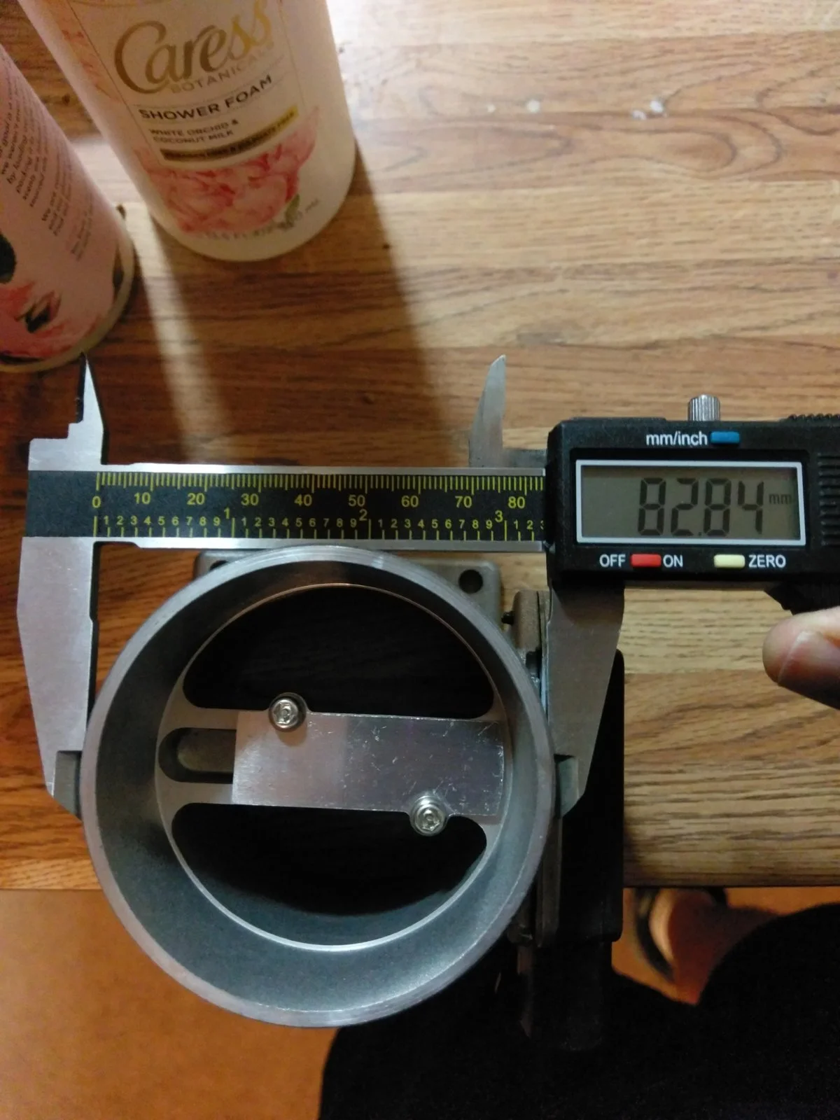

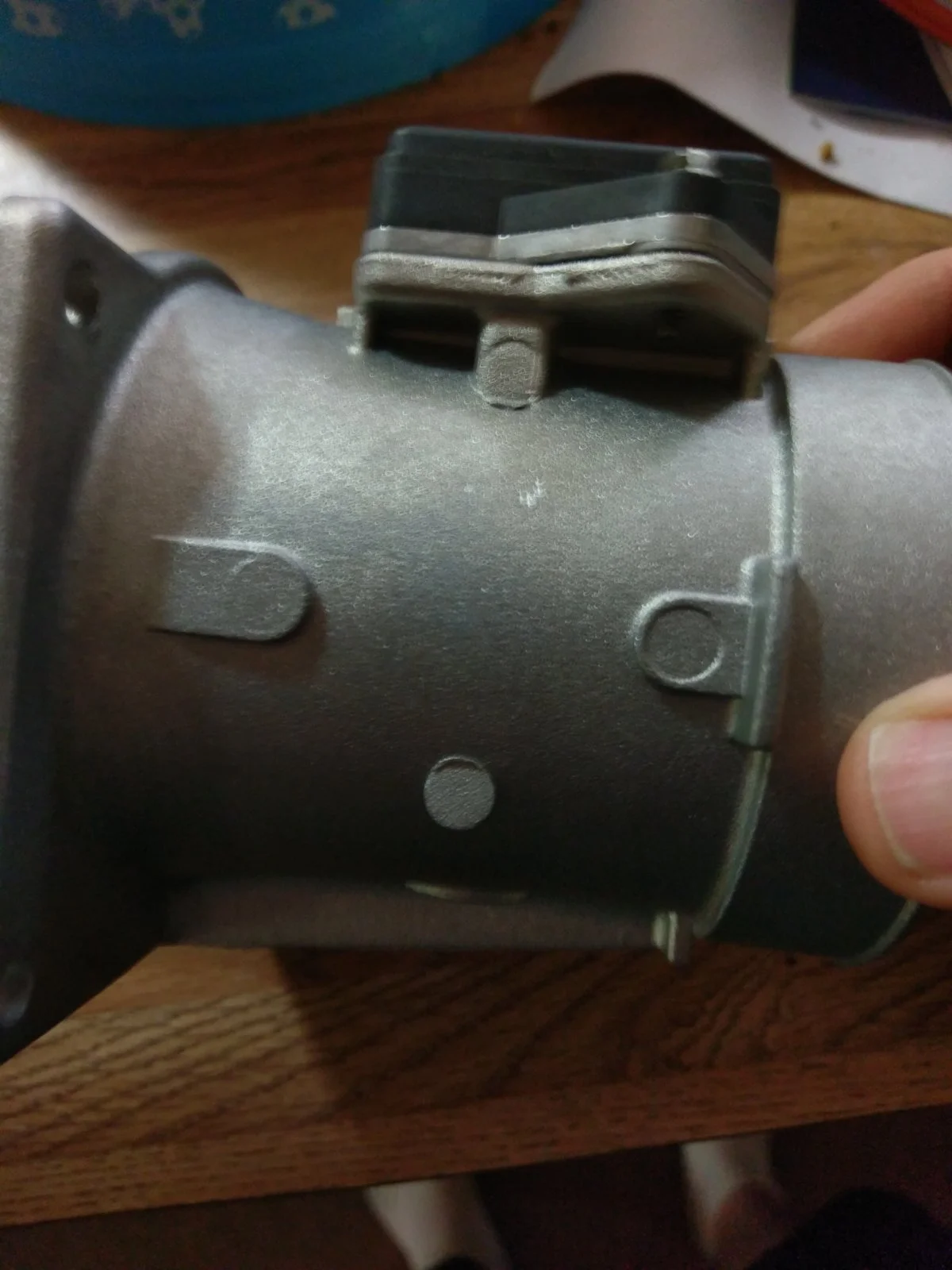

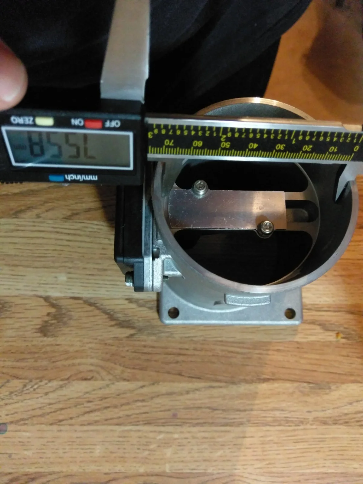

Ok, so my new 94-95 MAF came yesterday... was kinda surprised the box didn't say Ford on it though... So now like I always do, 2nd quess things... so I want to make sure this is right... I know it supposed to be 70mm but when I messured the opening I'm getting more then that... (granted it looks like it tapers in smaller, but of course the calibers can't reach that) also, I real quickly tried to test fit the intake hose (the one that goes between the TB and MAF) and the hose is going to be a really tight fit, going to need some lube I think to get it on ;-) ... So wanted to make sure this is right.. .also the MAF housing has Japan on it (well at least it's not china).... So is this thing correct? got 75mm on the end the TB hose goes on, and 82+mm on the end that goes to the air box..
