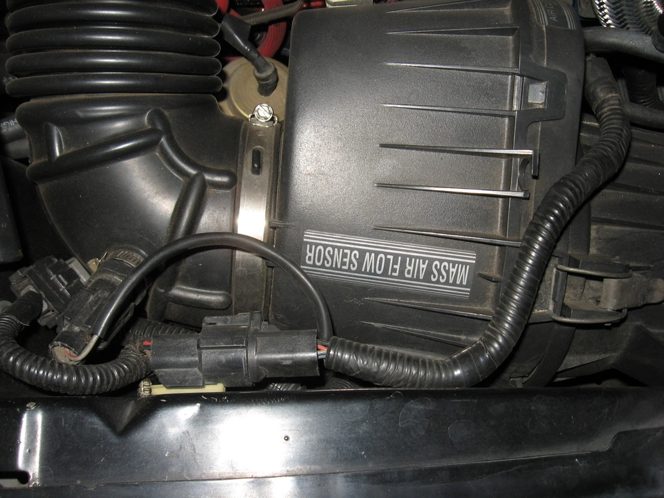

Here's a photo of my mass air setup. It's the same for all 94-95 Mustangs irregardless of the engine. The pigtail I think you mean is in the lower-left; that branches out to the IAC and the MAF. The MAF is an oval 4-pin connector on our cars.
I have that pigtail, however for some oddball my isn't the 4 pin oval. I'll try to upload a picture to help explain.
Found the problem, I peeled back the black insulation off the wires and found the perivous owner of the car had spliced in that 5 pin rectangle. Probably to run some aftermarket mass air. Thanks for all the inputs:hail2:

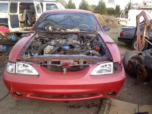

Umm one more question, what would be best to run. The car came with a computer in it, but there seems to be a chip on the computer with no labels on the computer housing. I have both A9L/or A3M and a stock F1ZF-12B579-AA mass air for a fox (have a bunch of foxes), or should I take a chance on the computer with the F2VF-12B579-A2A.
Also, do think i should create a build thread?
From the looks of that pic, I'd say start a new thread.
I would suggest sticking with the stock computer unless you are willing to fit the car up with a whole new harness. The A9L computer takes to mods much better than the 94-95 computers, so that's something to consider.
