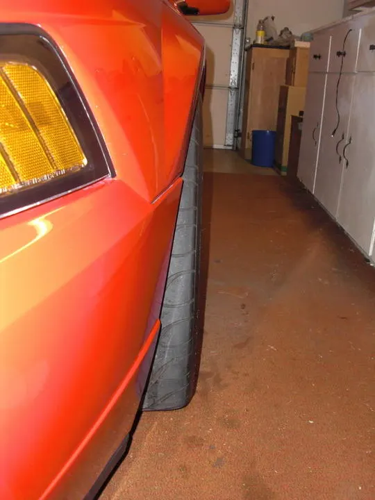

As some of you know, I installed my MM k member kit last week & it made my front wheels stick out around 1/4" outside the fender. It doesnt say anything in the MM instructions, but there K member kit widens the track width by 1/4" per side, but thats another story. So what I did to remedy this problem is I purchased a set of 94/95 spindles since they are 8mm narrower than the 96-04 spindles. I have been researching everywhere & havent came up with any info on someone doing this swap on a newer car, but it is a popular swap for Foxes doing a 5 lug swap.

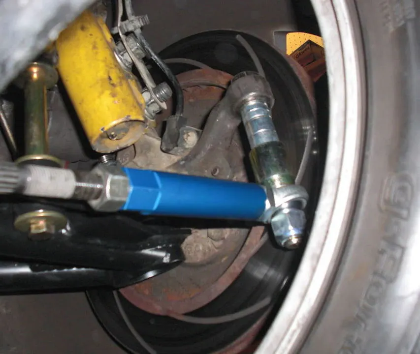

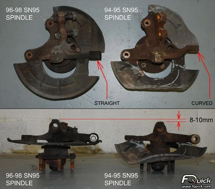

Here is a pic that shows the difference. See how the steering knuckle on the 94/95 spindles curves upward instead of straight like the later models....

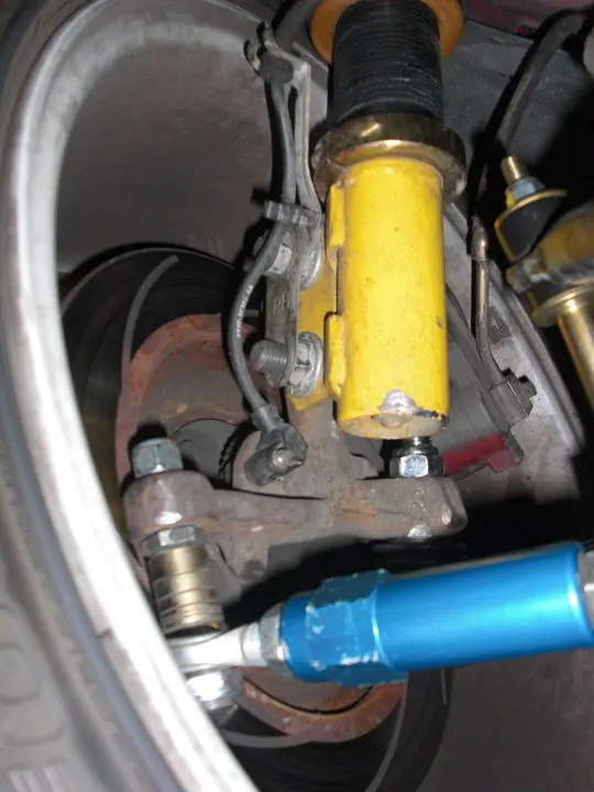

Here is the kit that is currently on the car....I dont think the tapered stud on this kit is going to be long enough to allow enough adjustment to make the tie rods parellel due to the upward curve of the steering knuckle on the 94/95 spindles?

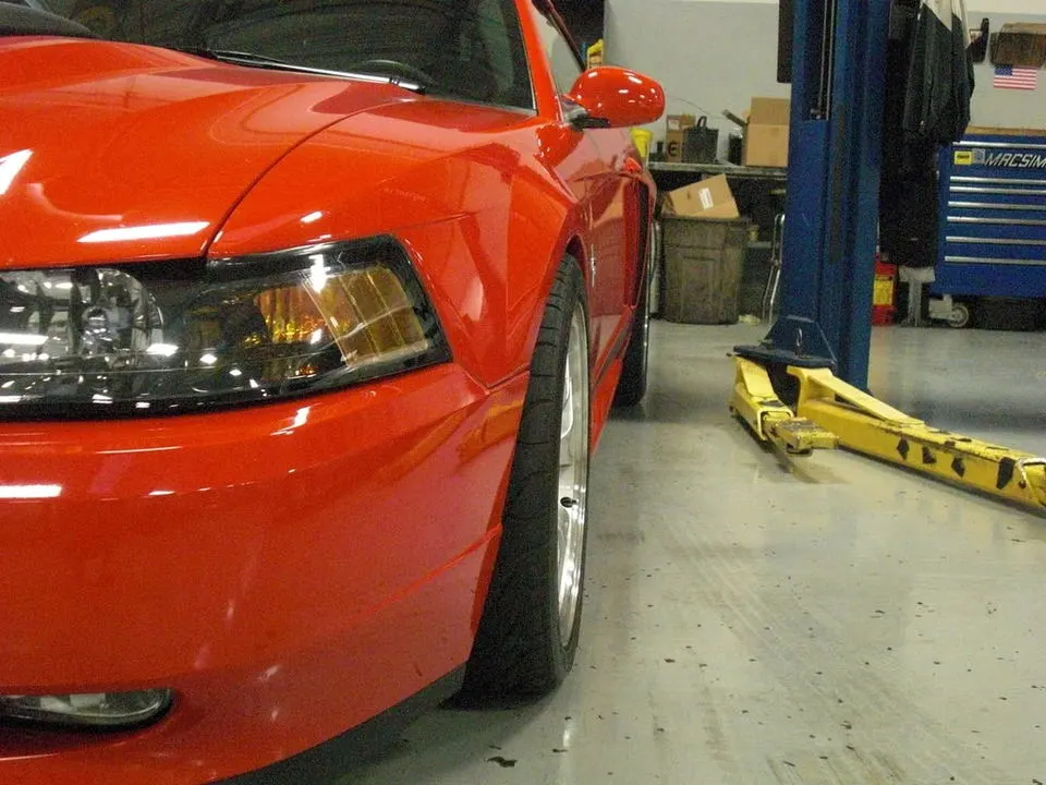

Here is a pic of my issue with the wheels sticking out...Not only does it look stupid, but its also causing my tires to rub. Yes I know my car is very low, but my tires never rubbed before.....It annoys the hell out of me...

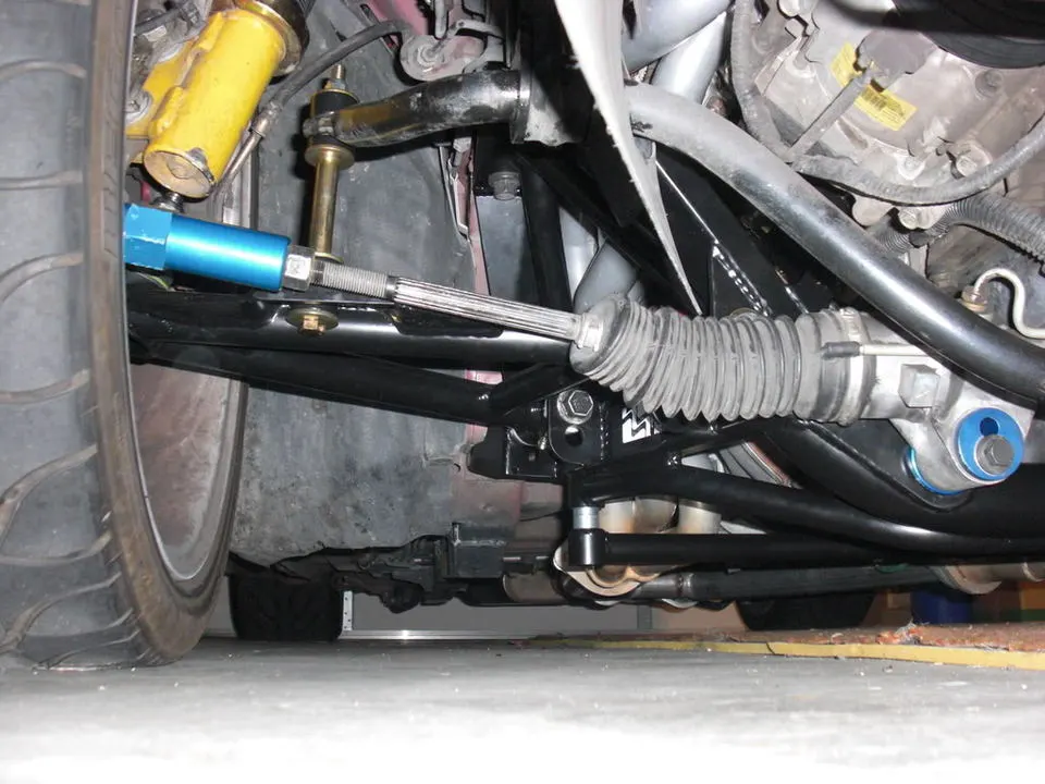

Here is the new suspension setup!!!:D

looks like the 94-95 spindles don't have the ABS ring...
where exactly is the difference measured? Is it possible that the hub may be the difference? If so, what about putting 94-95 hubs on it instead to keep your ABS?
OR
Can the ABS ring be moved over to the 94-95 spindle?
the earlier spindels should actually work better on a lowered car b/c they move the tie rod down a little.
I think they actually move the tie rod up?

It's only 8mm though...is that gonna be enough??
I hope so. apparently thats the same amount the track was widened??

The ones I have do have the ABS ring. I believe some of the low end 94-95 models didnt have ABS...Im not sure exactly where the difference is, i just know they are narrower by 8mm....

The ABS ring is part of the hub, and the hubs are interchangable. So he could just put his ABS hubs on the older spindles
The difference in width is due to the spindle
The thing that I am unsure about is if I will be able to get buy with my current bumpsteer kit once I install the 95 spindles since the knuckle curves upwards almost an inch. I have never actually measured my car for bumpsteer, I just focused on getting the tie rod as parralel to the control arm as possible. MM highly recommends using the bolt through style bumpsteer that I posted above, but these require drilling out the spindle on a drill press to 5/8". We dont have a press & all the machine shops are closed on weekends & I need these done by tomorrow morning if Im gonna drill em out.
Here is my current configuration...

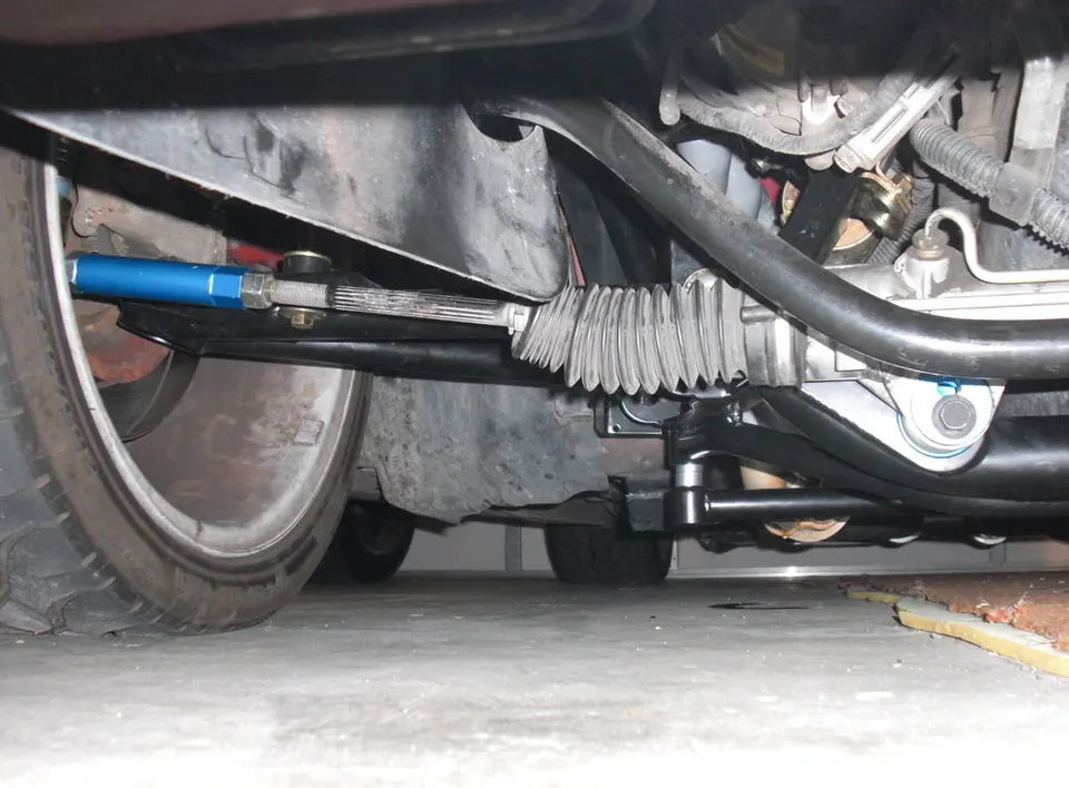

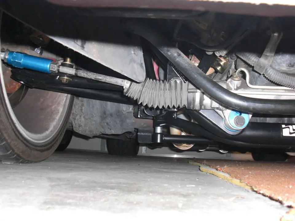

Heres the difference with the new bumpsteer kit & the 94/95 spindles....
Before
after
Before....96-04 Spindles & steeda tapered bumpsteer kit.
After.....94-95 spindles & maximum motorsports bolt through spindle 5/8" bumpsteer kit
Before
After
