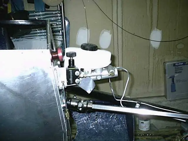

I have a photo of the M/C I have installed in the kit car-the gray duct tape is covering the opening but it is almost 3/4" dia port with a small hole inside. The brakes will not work to well if I cannot find something to plug that port.
If you have a digital camera perhaps a photo or two of your master cylinder would be worth a thousand words to me-at least I could show the Ford parts guys-might help!!.

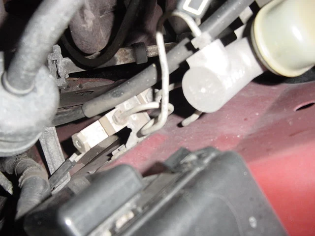

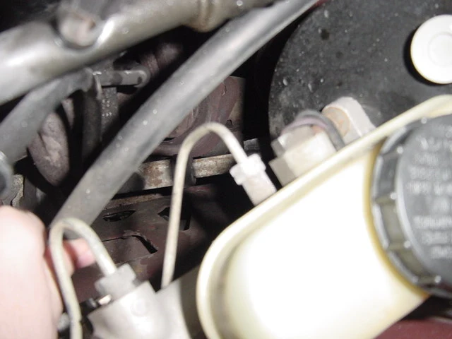

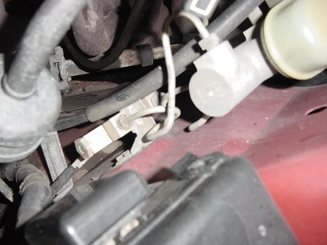

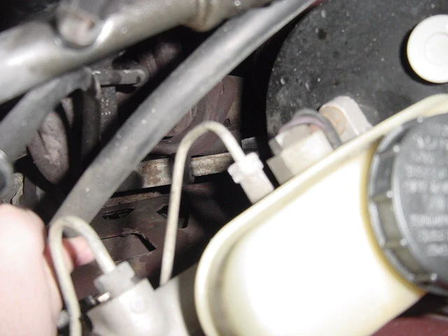

The hole is for another brake line coming out of the master cylinder, both lines go to this thing which I cant quite figure out what it is at the moment.

What is the thing with the two wires in the top photo?
Thanks for the photos- both my lines come out the other side- towards the fenders- however what is the item with the two wires coming out of it and bending under the M/R Resevior?? I think that is the item I need- any part # on that puppy??

Sorry goofed up!!
The rear brake line comes out the front inboard port and the front two lines come out the fender side of the M/C. What I want to know is what is the thing in the top photo with a black and purple wire coming out of it and is there a connector supported by the bottom of the plastic resevour?? Also any part number on the item in question??
Thanks again- much help!!
FlaRalph
That is just the low fluid sensor. When the brake fluid gets low, it triggers the light in the dash.
There should be two brake lines coming out of the MC and as far as i know they both come out on the side facing the engine.
