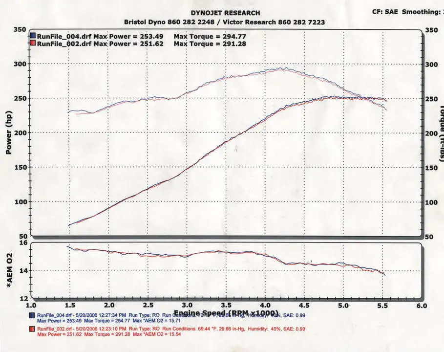

Would you like to see a dyno plot of a stock 94 Cobra? One in which the fueling problem is blatantly obvious?
90lxwhite said:
If I had a car that didn't have any driveability issues and was basically stock like the Cobra in question I'd opt for no tune at all until I did something worth while like a head swap.
Stock 94 Cobra: Shorties, O/R X-pipe, Mac dumps, UDP's, and an Ebay CAI. 253rwhp befor tuning. 276hp after tuning. The stock programming sucks.

Before tuning. Look at that AFR through out the pull. Factory 24# injectors, a CLEAN stock MAF, stock fuel pressure (gauge verified), and a walbro 255lph fuel pump.
Dang that's lean. Though I'm amazed it still made pretty decent power. Was it pinging the whole way?
