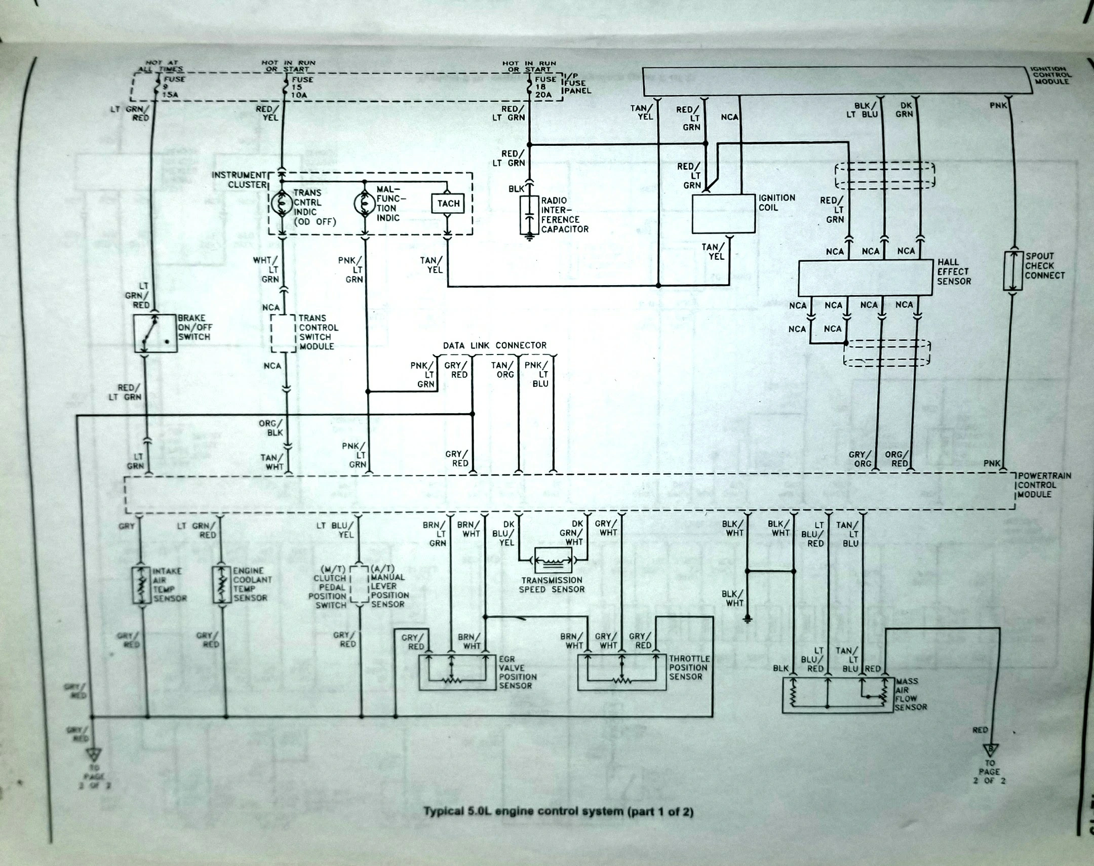

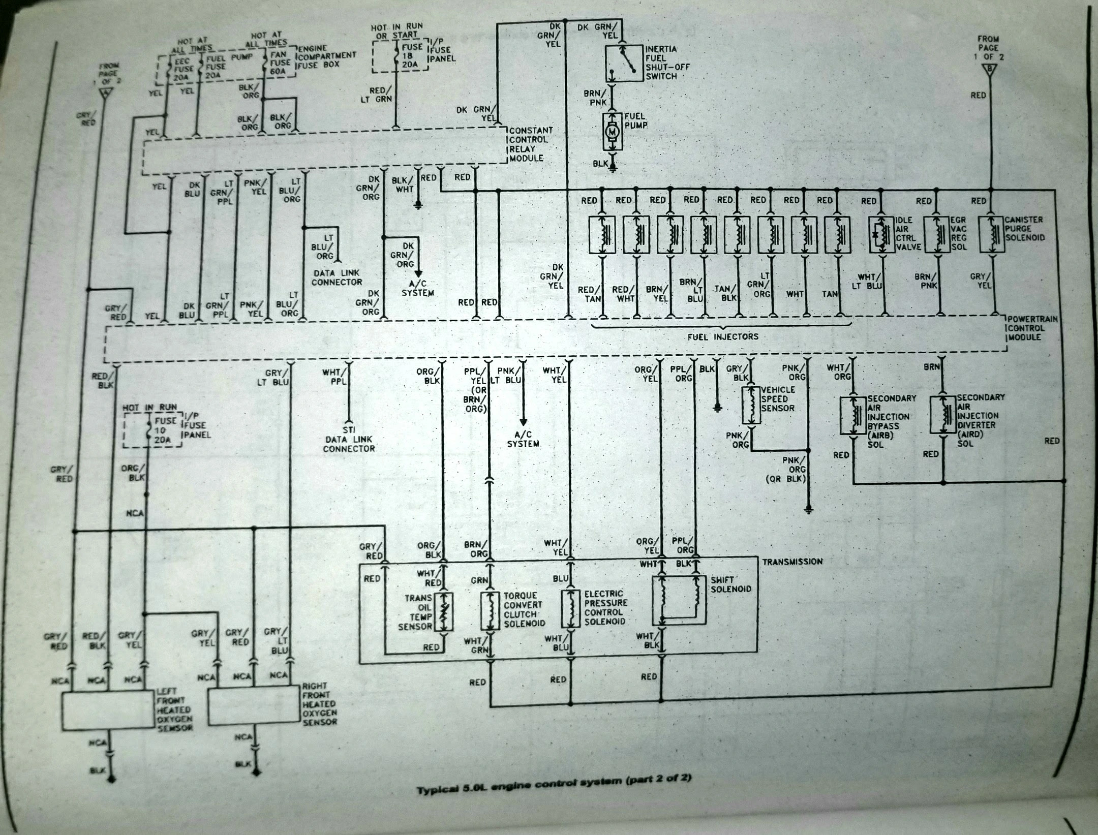

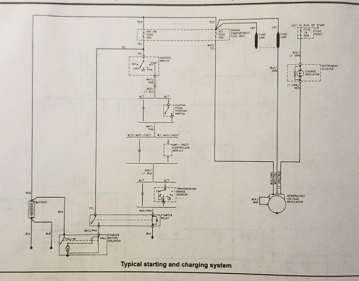

In the meantime, I'll try to make heads or tales out of these diagrams from the haynes manual

The ignition switch attached to the steering column doesn't start the car when pushed into position. I actually found the right diagram in the haynes manual and will keep posting until prob is resolved, patiently to save money and do it myself, learn...yadaya lol

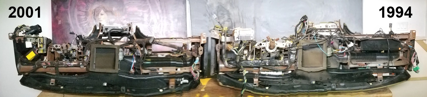

The entire dash is plastic (ABS, insulation, vinyle) and I took the entire black and tan dash out of a my 94 convertible. I then took out an entire black dash out of a 2001 mustang and and swapped the dash plastic from one dash to another in order to have an original black dash vs painting my tan dash black. There are a number of screws that hold the plastic to the frame (note: the model numbers for both dashes are the same, seamless swap) here's a picture slightly distorted bc panorama camera view.
The point is, after the swap and all connectors are in place, BRAND NEW battery...no juice to the ignition switch, and i'm working to solve the issue. Thanks so much for helping
Thats a big job, not hard but a big one, likely you just missed a connection someplace, I'd start at the ignition switch checking for power and go from there, you'll do the :doh: thing and then the :banana: thing when you find a ground wire off or a connection not plugged in and it fires right up.

SUCCESS! Today checked fuses and relays with a ohmeter and lots of youtube videos, and found everything in the engine bay was fine but the dash had zero power. Turns out the large harness connector at the driver's wheel well was loose!
