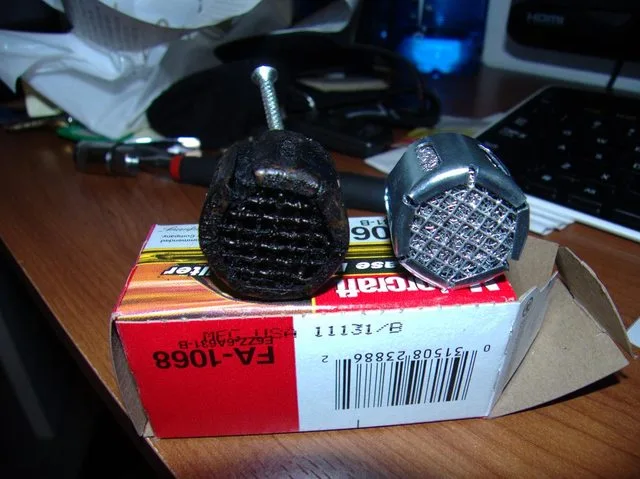

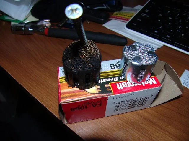

Went out and bought the new pcv valve filter and pcv valve. The old filter was really jammed in the intake, so I took a 2" screw and screwed it into the filter and took some pliers and yanked like hell.
My first attempt only removed the screen on the filter, then i screwed it in further and finally with tons of yanking it popped out.
Man is it caked with oil. Regardless if this fixes my pinging problem or not, this needed to be replaced.
Thank you WhiteCobra95 for bringing it to my attention.

And to the OP, yes that screen was nasty, needed to be replaced for sure! I have found that sometimes problems with these cars aren't due to one problem but a combination of little things here and there. If you can't figure it out right away then it's ok to replace things that ought to be replaced anyway.

Also, just reinstalled the new filter and valve and took it for a short drive. Pinging is still there, but it might have improved slightly.
Maybe it will take time to adjust, maybe it is still consuming oil somehow, or maybe it is something else, not sure. Still a good replacement to do.
