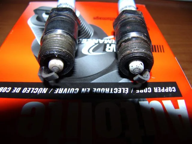

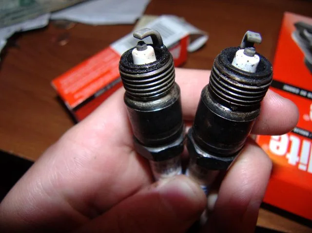

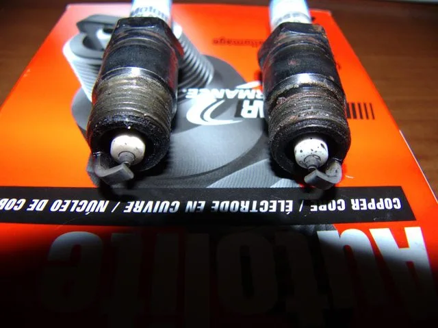

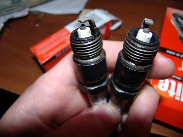

Would it help if I posted picture(s) of my spark plugs that have been in my "pinging" engine for a couple thousand miles?
Here are some pics of my spark plugs that were in the engine for a couple thousand miles while I heard the "pinging"
Do they show signs of detonation? All the spark plugs look similar to these.
The oil fouling is probably due to the clogged PCV system that I recently fixed.

My first thought was a spun balancer... then I read he checked it. If you can get a video it would be great. I've had a shudder due to 02s going bad.... as well as pinging. As you stated going wot will force open loop and ignore the 02 sensors. You can also force open loop and check how fast your 02s are switching with a tuner.
Your plugs look a Tad bit lean to me.

A few posts up I posted pictures so you can see my spark plugs that I had in there for a couple thousand miles before the PCV replacement.
