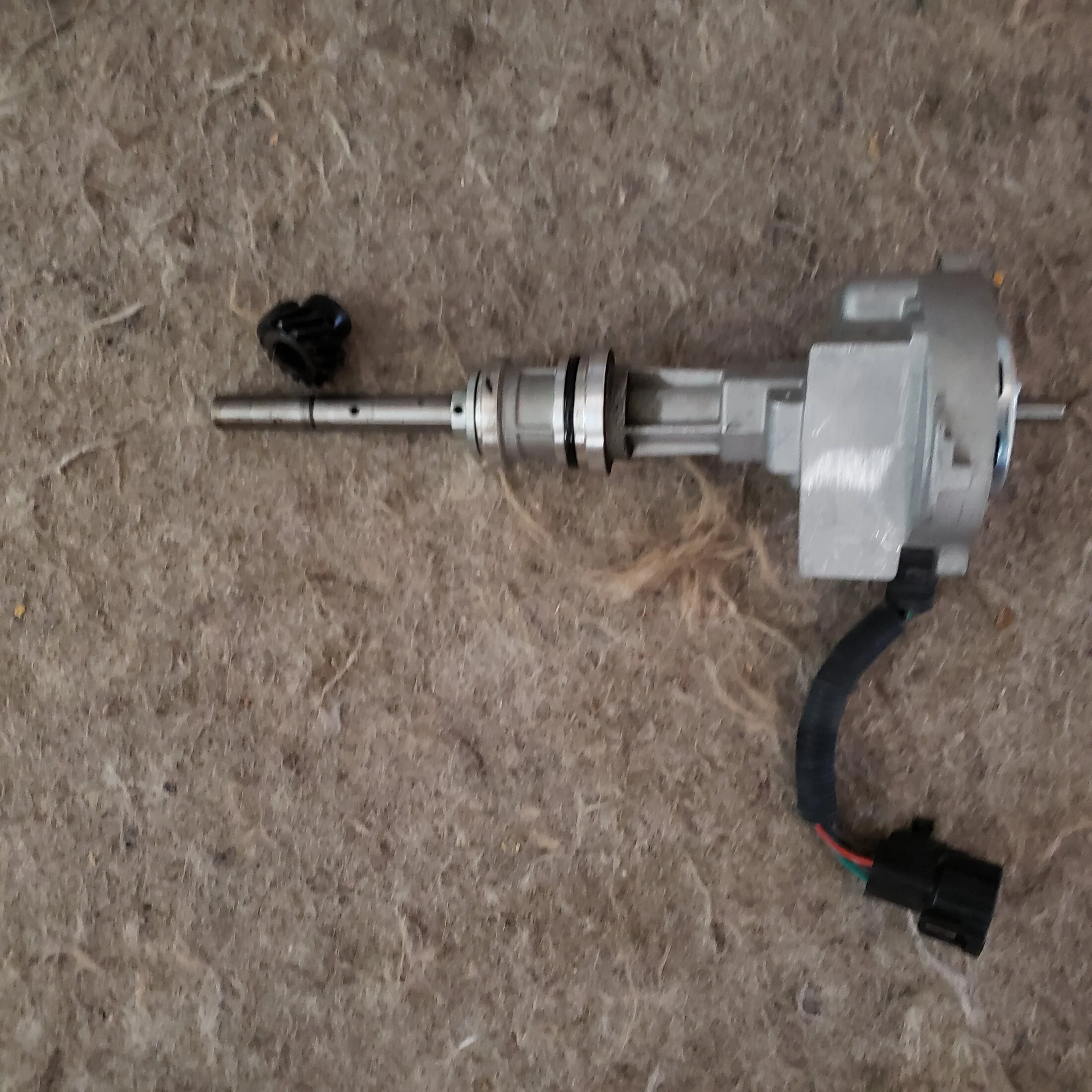

A guys F150 last week suffered roll pin failure and lost PIP signal (died and would not start)
Pulled the distributor out to replace the stator, found the gear laying in the engine
Had no blinking light on the negative side of the coil

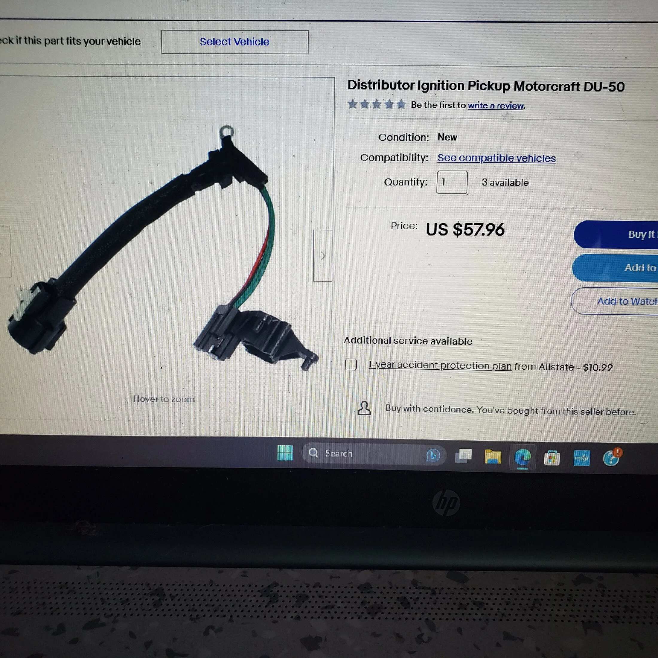

  • #692
China distributor, I put a new stator in his old Ford distributor Motorcraft DU 50
Getting harder to find, but around
If yours is not a remote mount TFI you need DU 30 C

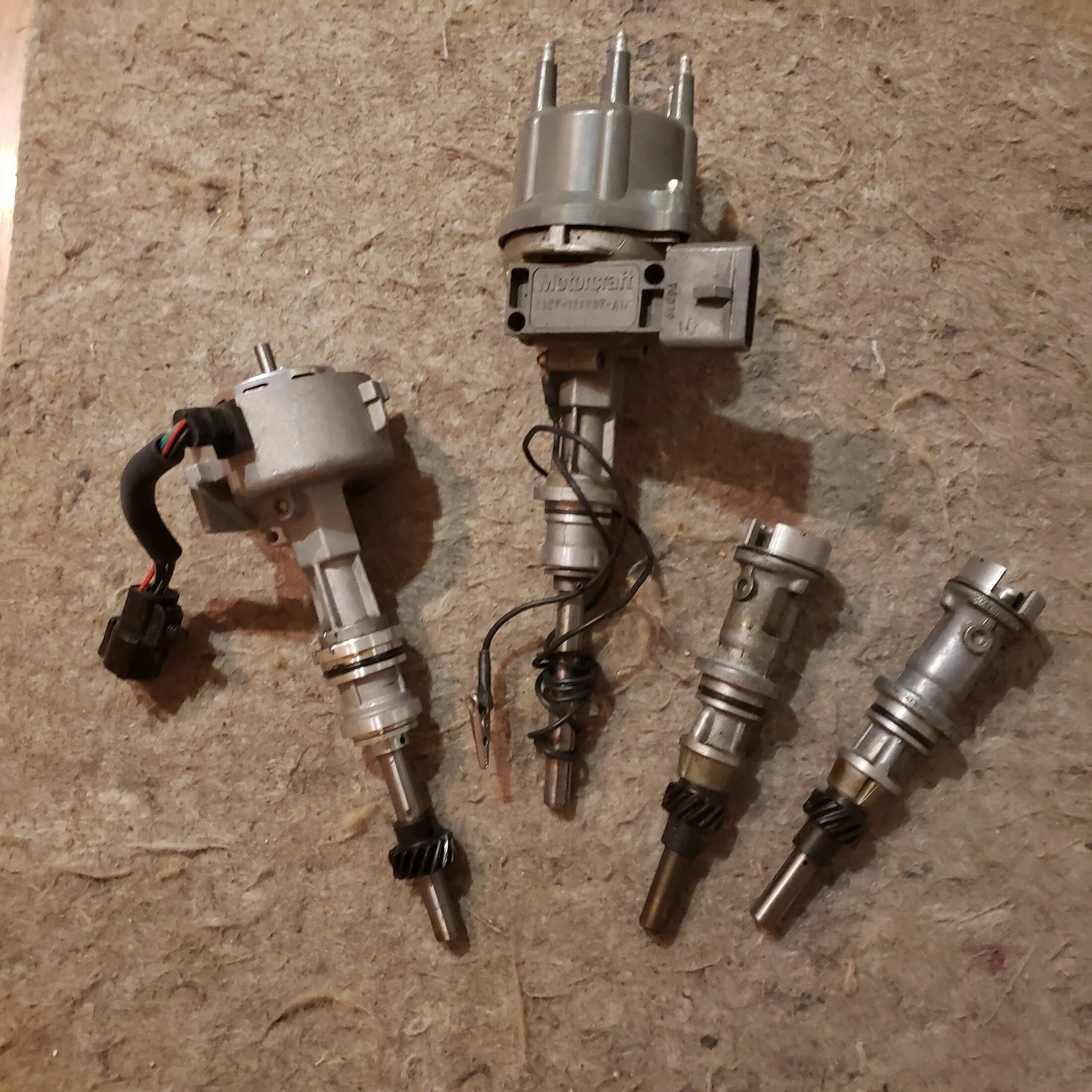

Like this / these

Plug one of those in and the testing gets easier
The 2 short ones are synchronizers off the newer stuff
Until the du 30C's and DU50's are all gone, I see no reason to run aftermarket
I bought 1 of each off ebay last month
