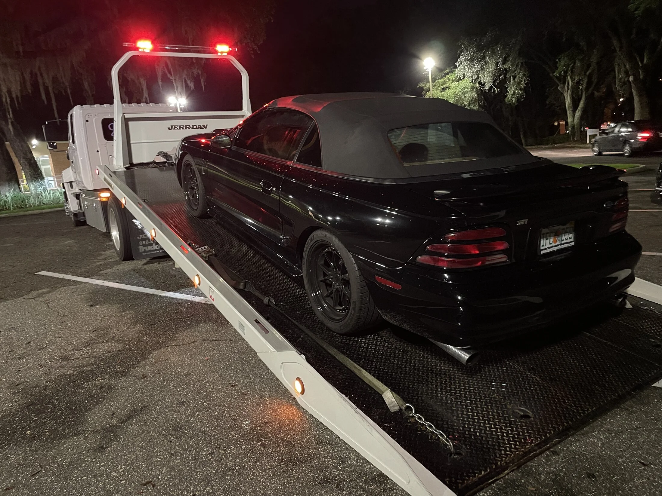

First thing Lamotta wanted to know was if I had the stock distributor which was unfortunately destroyed as it was stuck in the block as you guys might remember. Took channel locks, Kroil, and a few hours to get it out
Reactions: General karthief
Got an update from Lamotta:
The car is running now but very poorly. What they found was a break in the wiring harness in the passenger wheel well. It could have been nicked when I cut the hole for the power pipe, or more likely, I think the wheel might've been rubbing the harness/powerpipe at full compression or lock and over time, it broke the wire harness which would explain the slow degradation in the car until it completely would not start. It was very tight in there with the wider wheels up front and power pipe. They are now working on why the car is not running well. Could it be the Moates QH dropped the tune file with sitting so long with the battery disconnected?
