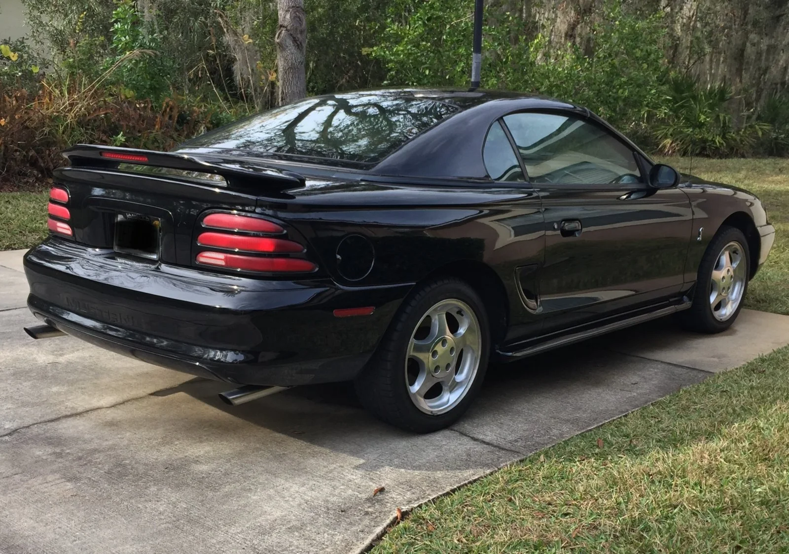

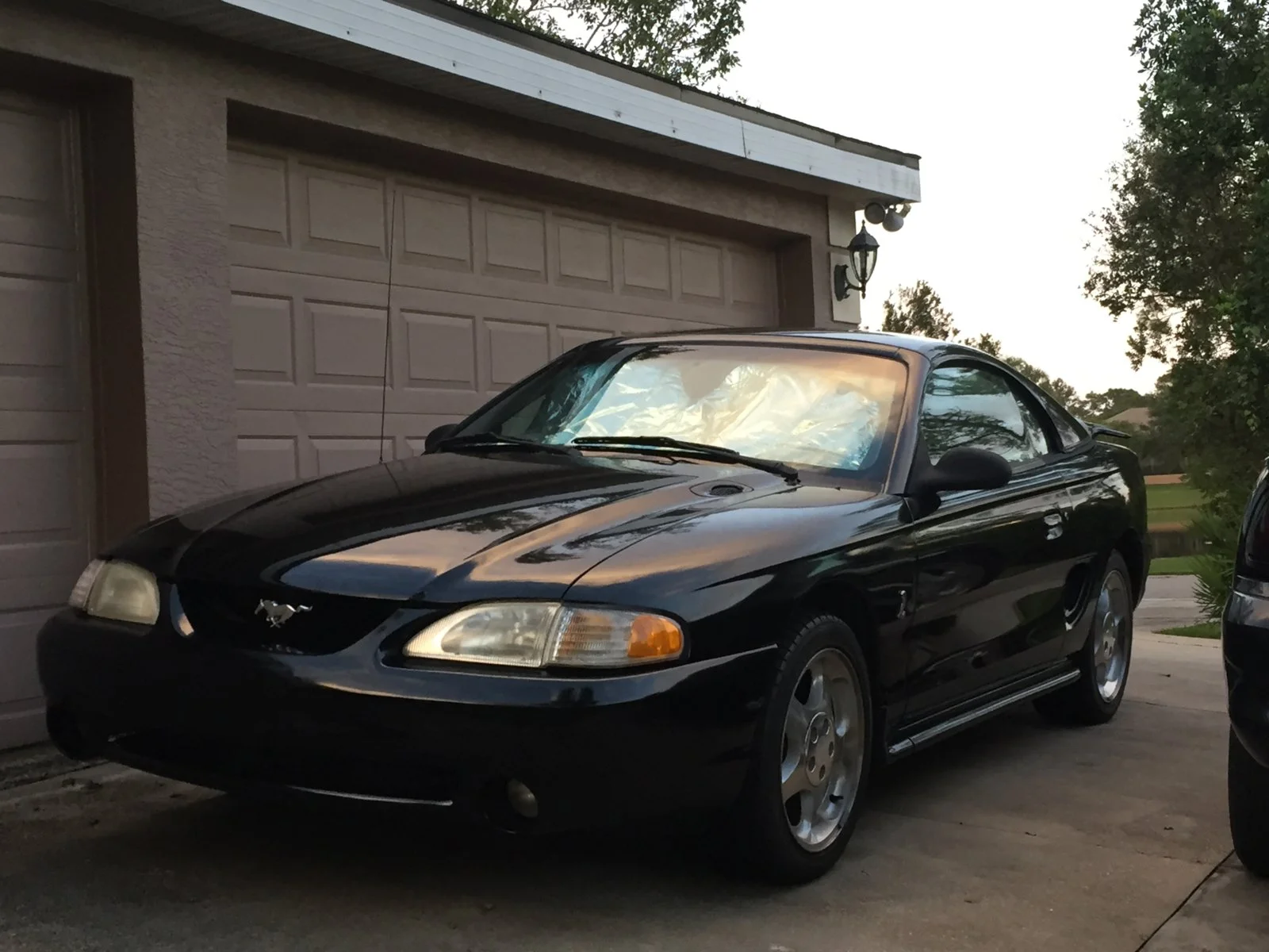

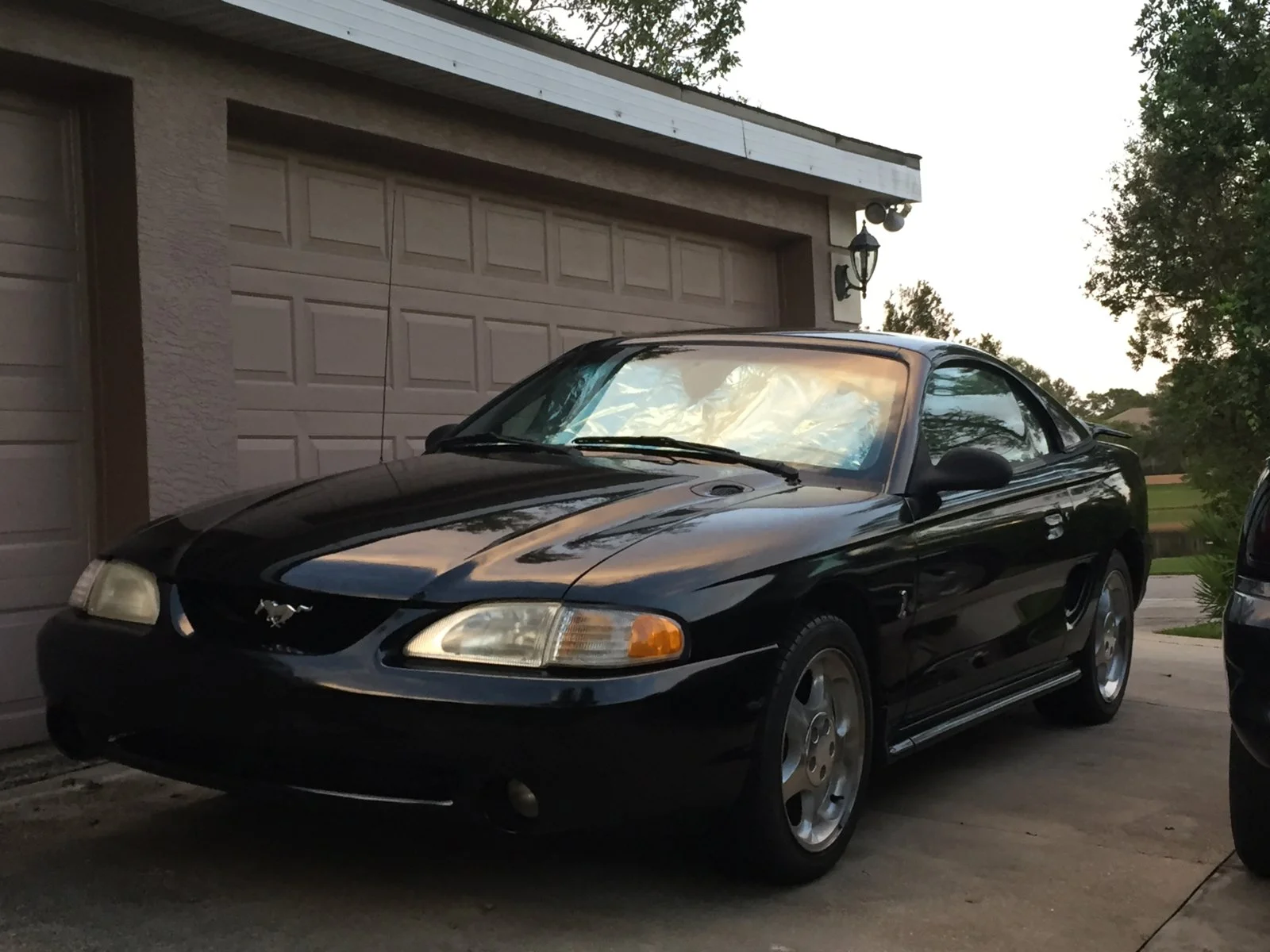

Here it is, I decided to start one official thread to keep everything together on my build. So to begin as of today I am a 15 year old attending high school and I was graciously gifted my 1995 Hardtop Convertible Cobra as my first car. My inspiration for this was my fathers 94 Cobra as I fell in love with that growing up. So we purchased the car around September 2017 here’s a pic after it came home and got a bath...
This is #475 of 499 of the limited production hardtop convertible cobras

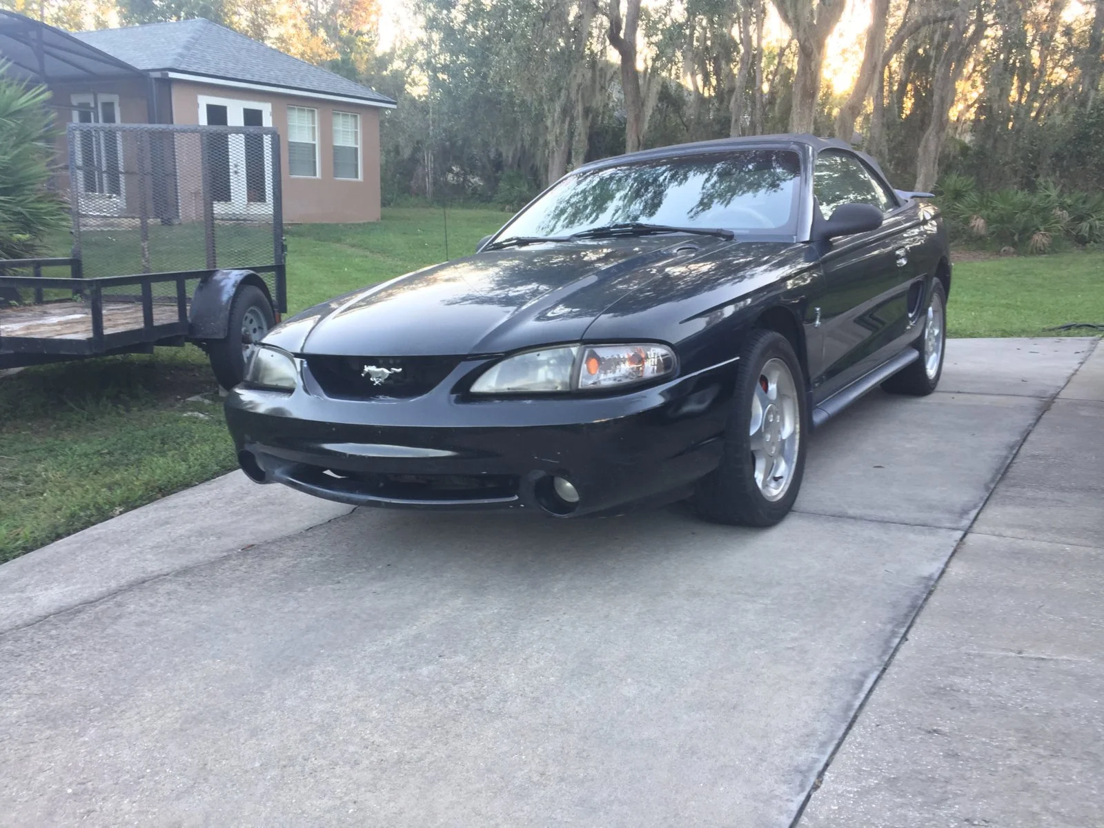

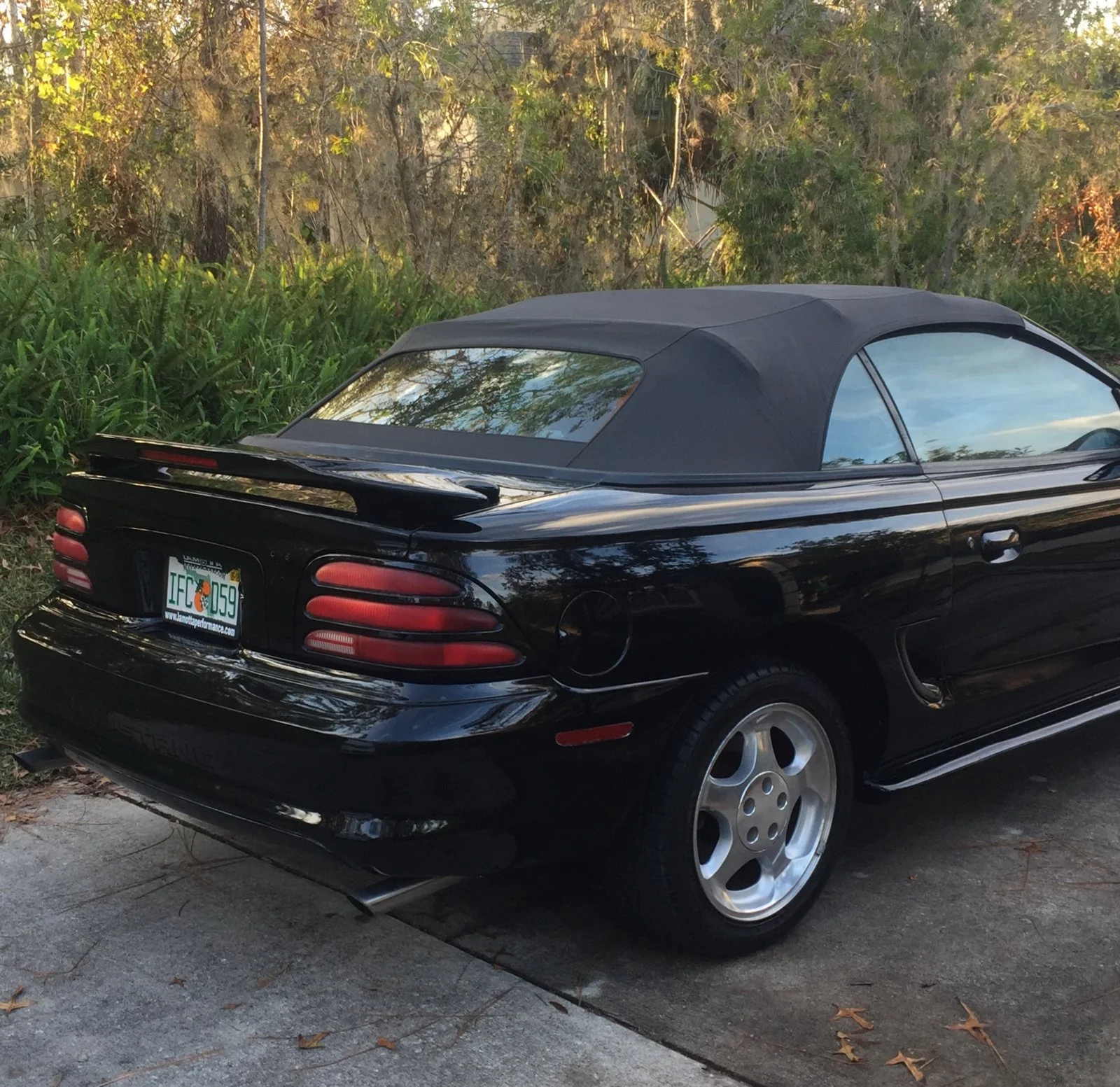

Upon purchase it had a few problems, U joints were shot, motor mount needed replacing on one side, ac blew through defroster, and it just didn’t run quite right, little hesitations but nothing major. Now rewind to April I had a 95 cobra which was technically my first car until we found this and had to get it. Here’s a picture of that one which now resides with @General karthief

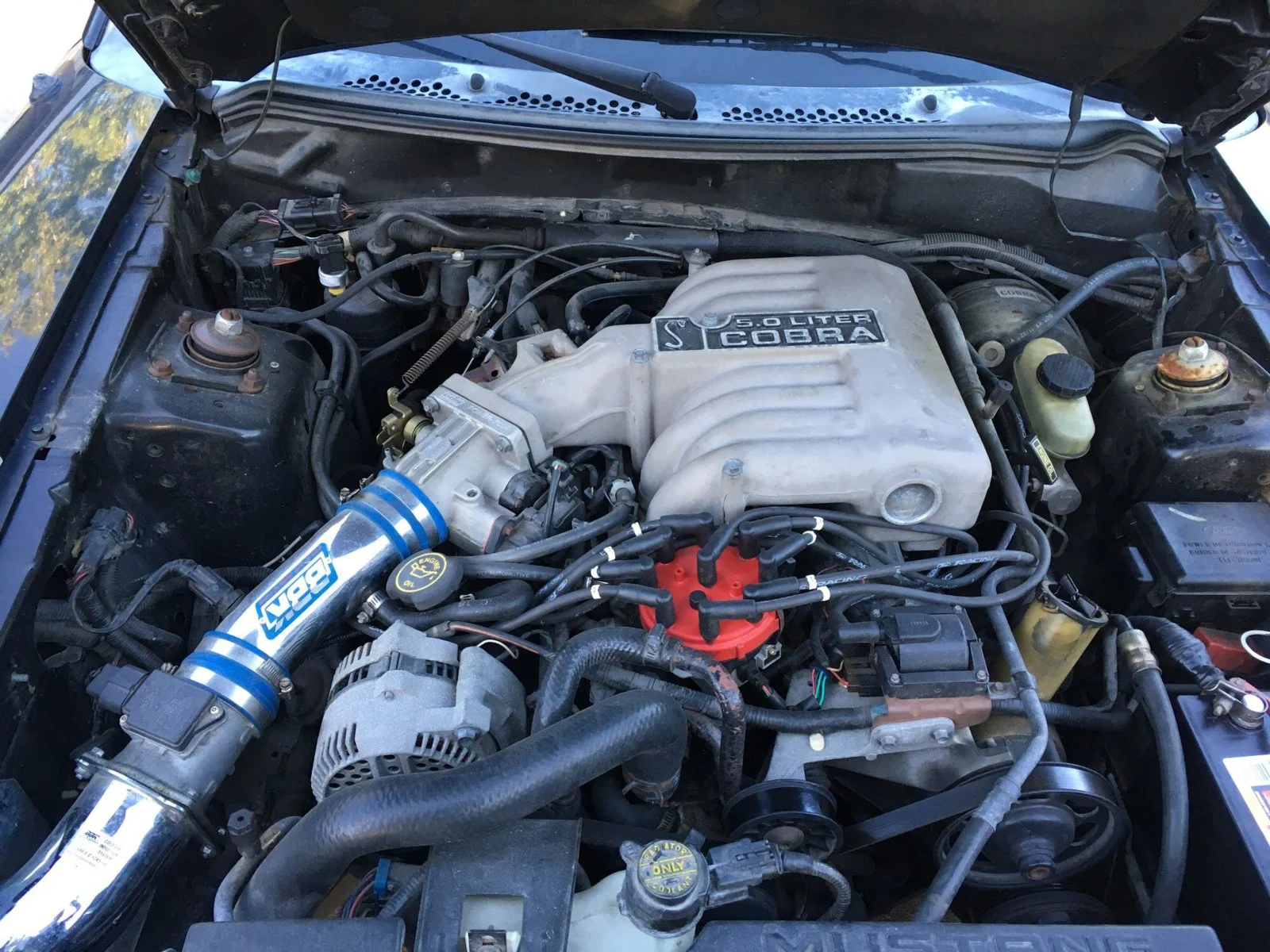

Essentially it was a mechanically sound car, FBO that just was beat up by it’s previous owner so what we did is swap over all the bolt ons to the hardtop reverting the vert to stock before sale. Parts we swapped included the following. It had headers but we left that for ease of installation
- BBK 70mm TB
-BBK CAI
- FRPP Aluminum Driveshaft
- BBK catted x pipe
- SLP LM2
-Hurst Shifter

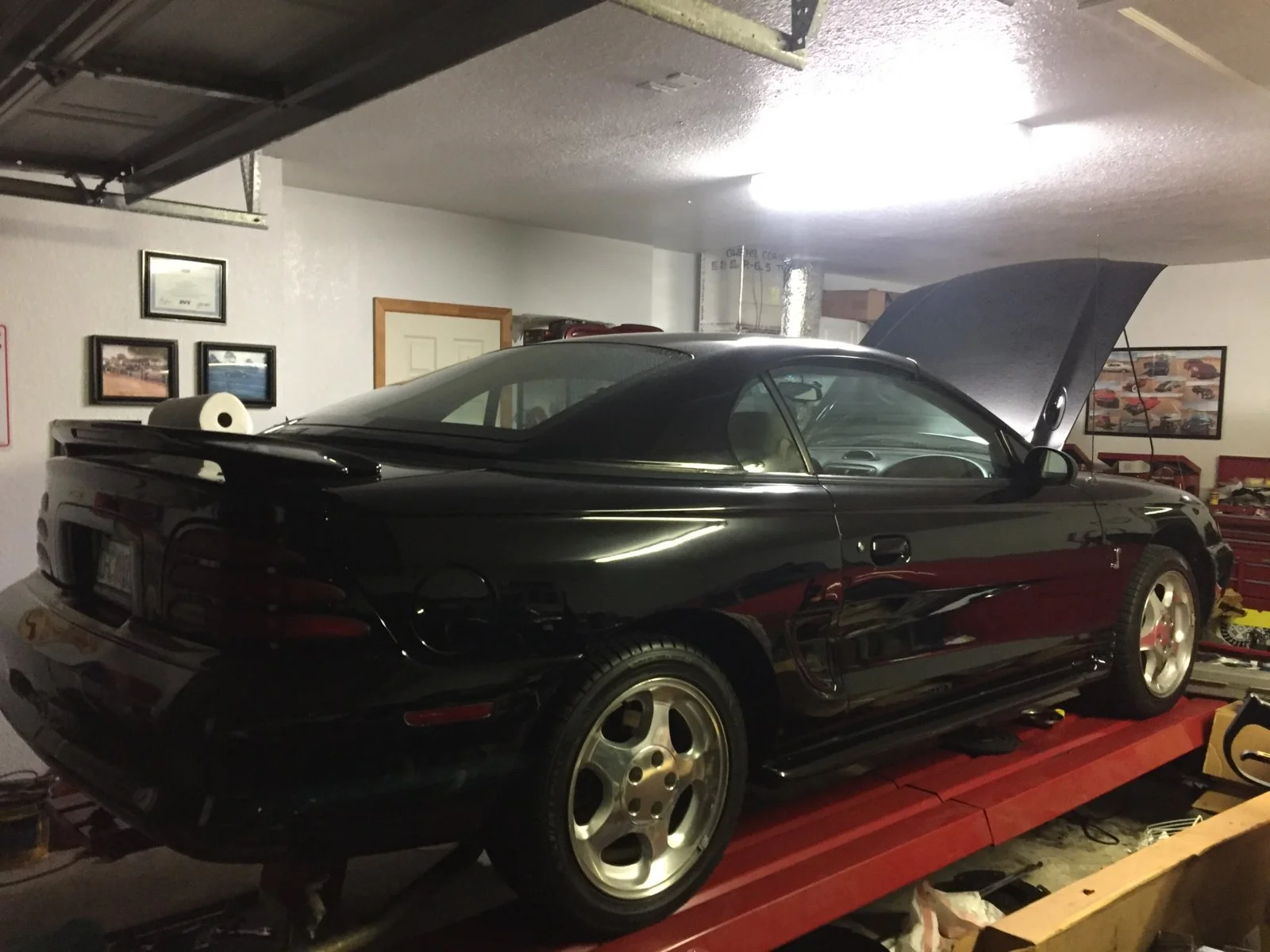

At this time we also knocked out a brand new king cobra clutch and flywheel, did trans mount too. Here’s that process
AE06D967-E525-48E6-B771-741DD4BCA60A.webp F17C7C3A-CA66-438E-84F2-9703CEBBB334.webp

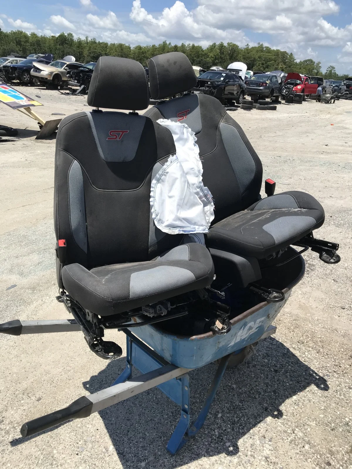

As of now that’s the last thing that we’ve done to it, only thing left we have to get done before I take it to school is tint, get those st seats in, lowering springs, motor mounts, and hook up the air tube back to the cats.

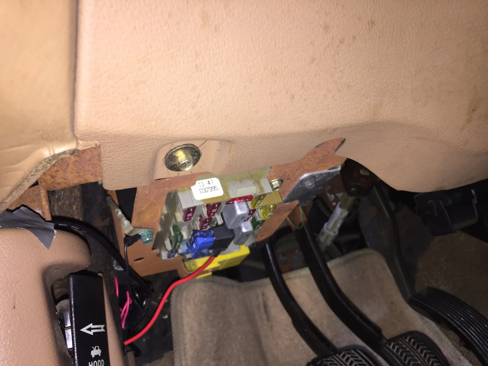

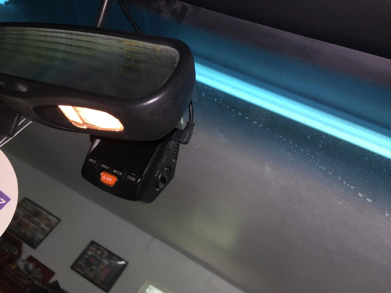

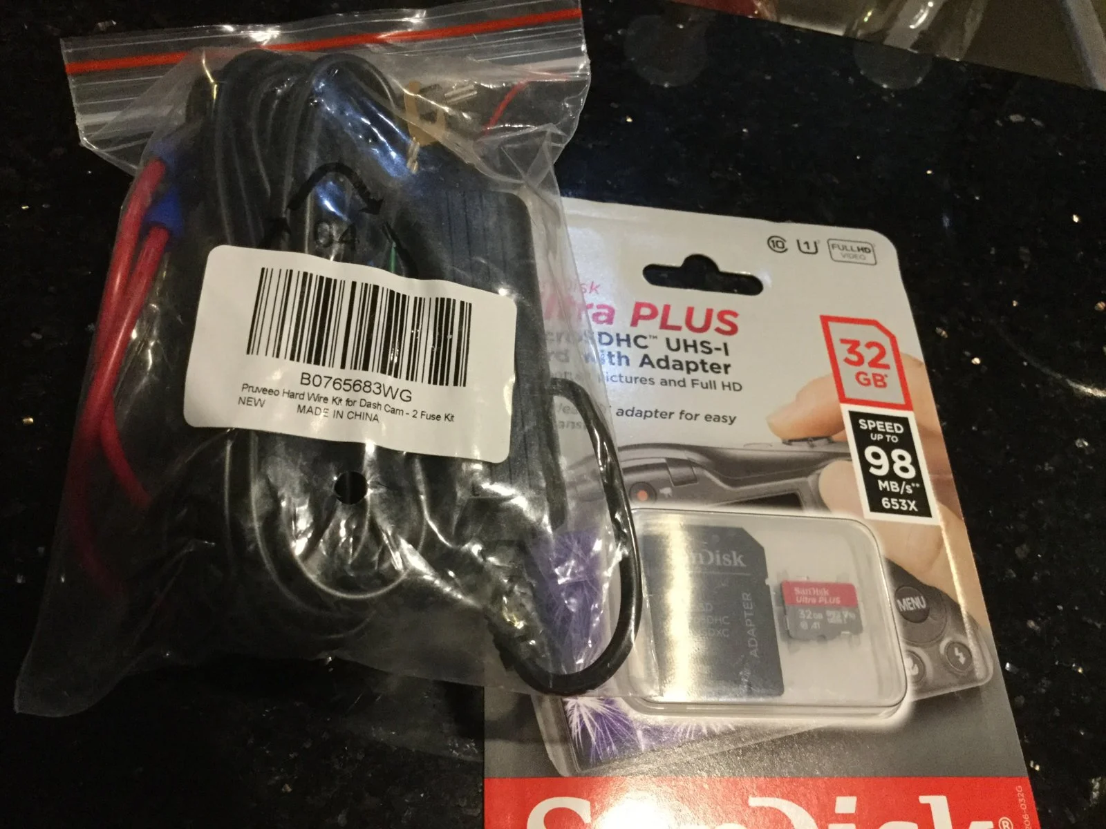

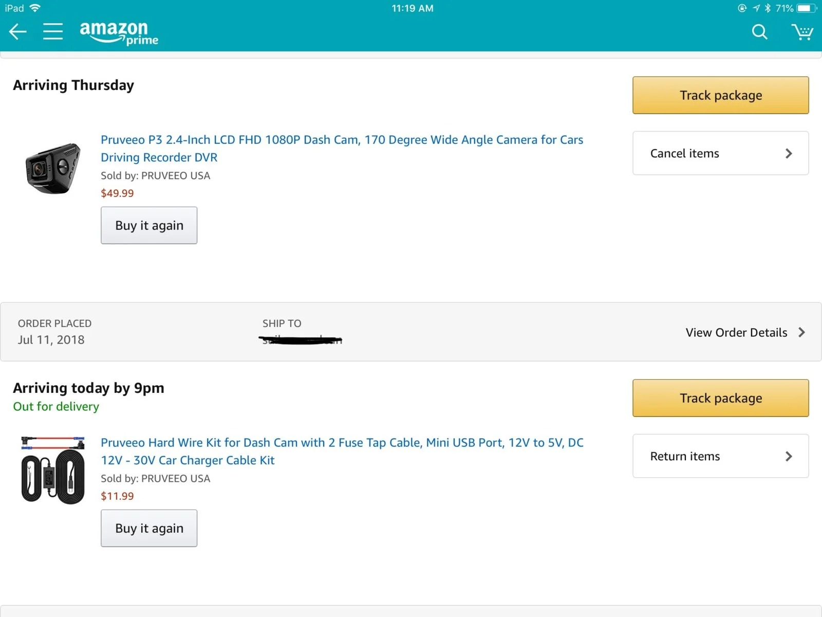

Ordered up a dash cam that seems to yield good results, I’ll be hardwiring it into fuse #11 which is radio so it automatically,let has power when the car is on. Seems like an easy job I can tackle
Just awaiting the dash cam now, should be in Wednesday
I’ll try and do my best to make a how to since I couldn’t find much on hardwiring into sn95

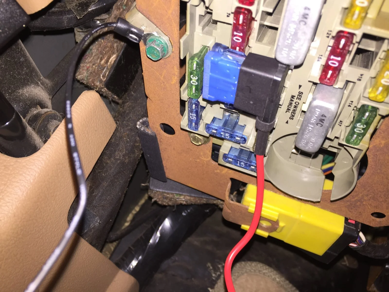

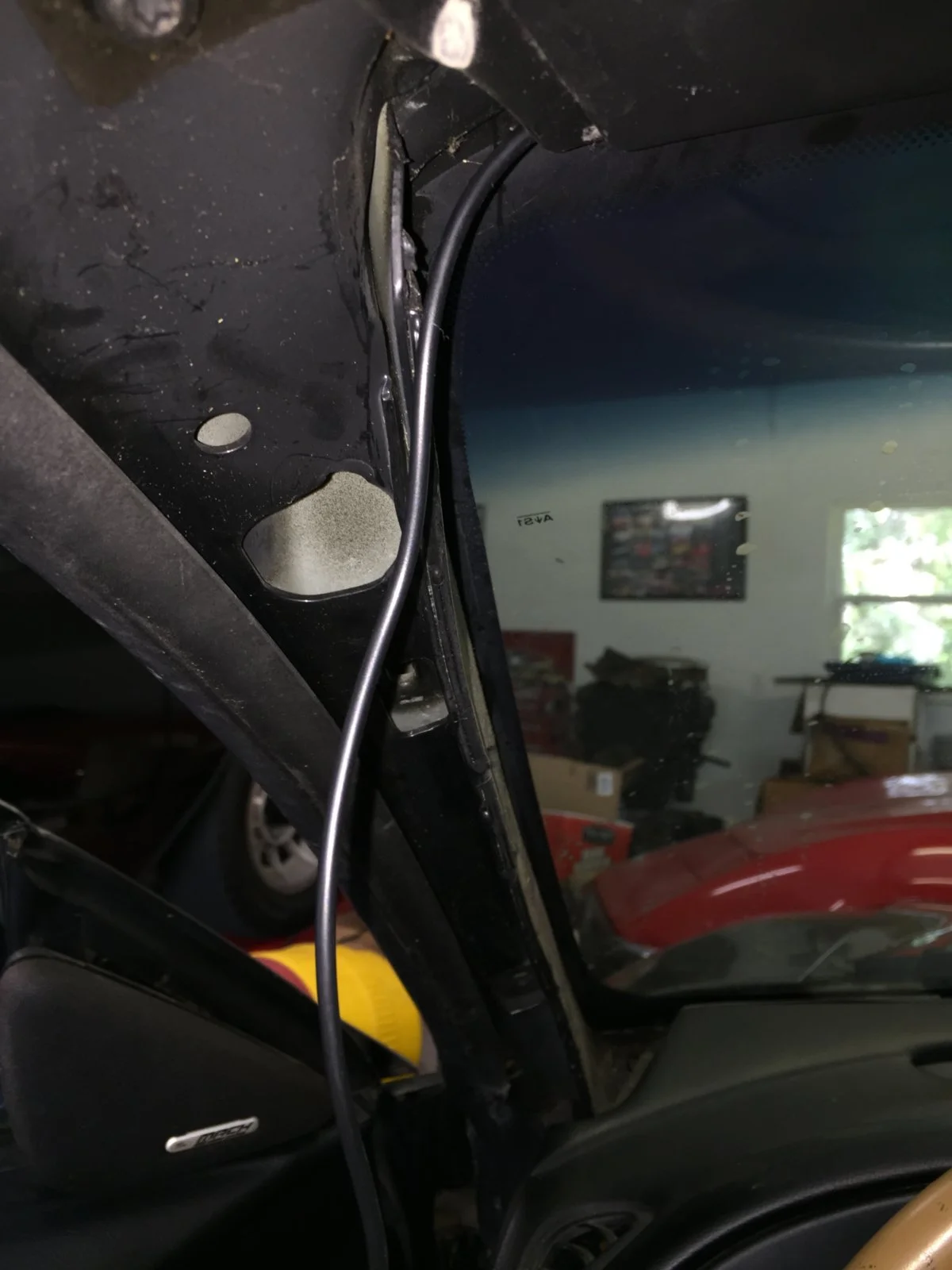

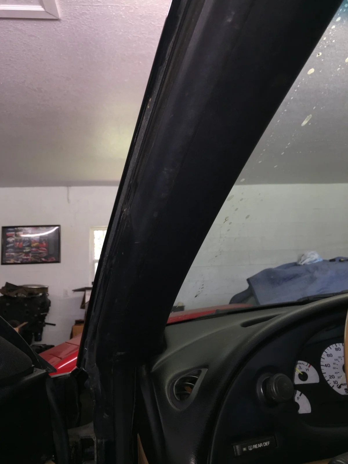

Dash cam is successfully hardwired in, and barely any traces of wire left, here’s a brief overview of what I did
1. Mounted the dash cam behind my rear view mirror and tested video
2. Removed A pillar
3. Route wiring beneath the windshield trim on the vert, and ran it down the a pillar, using tape to secure it against the body
4. Tapped into the radio fuse using a add a fuse and connected the power line
5. Connected my ground under a bolt to the body
6. Test and double check everything works as it should. Camera should only come on when the ignition is turned to the on position and turn off shortly after the ignition is off.
7. Ziptie and tuck the remaining wire out of the way under the dash
8. Reinstall A pillar trim
9. Enjoy your clean install!
Note: In my case the add a fuse reduced clearance to the point where I can’t run the fuse box cover, not a huge deal I think

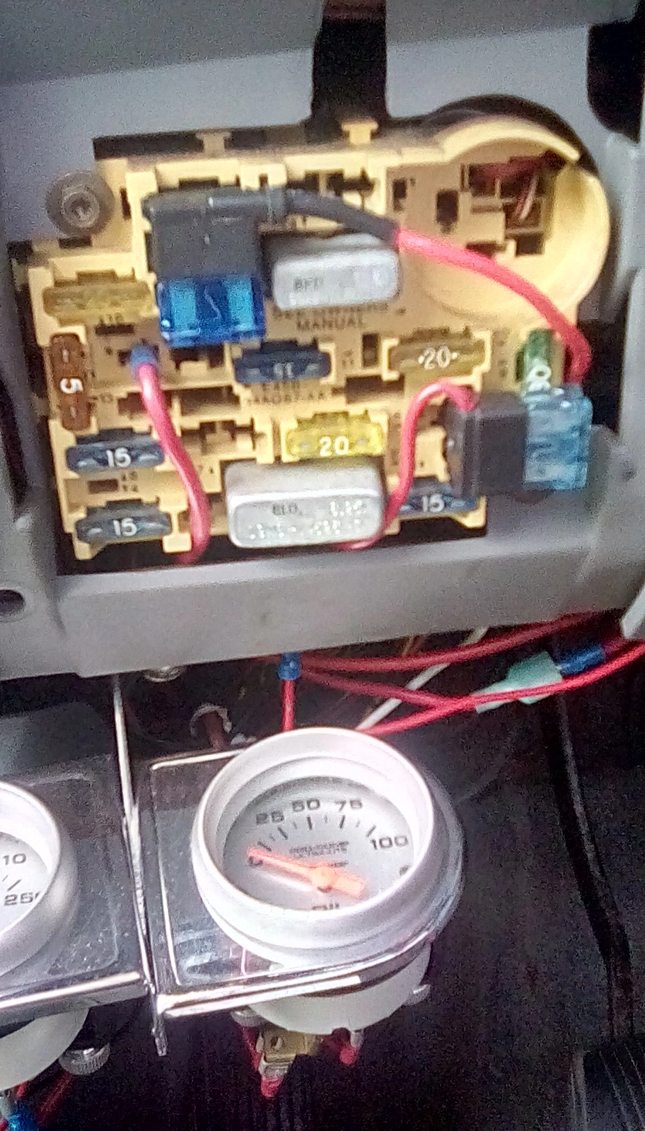

There are a couple places in the fuse box that will accept a female connector, then you could route the wire from behind the fuse box and hide the inline fuse back there and keep the cover, I did this when I added a gauge.
This is the 89 gt fuse box, my cover fits just fine but the sn95 may be more shallow, you will notice the single wire, on the left, you should have a place where you can stick a male blade type wire connector in a place in your fuse box that has key power.
I went out to my cobra and of course my seat will not adjust and made it very difficult to see the fuse box but near as I can tell that ad a fuse is your only option if you want to use the fuse box for power, you could unbolt the box to drop it down to get a better view but I could not see any place to add the wire like I have on the fox.
i had those two ad a fuses in mine for several years, they work just fine, just toss the cover in the glove box for reference and call it done.
