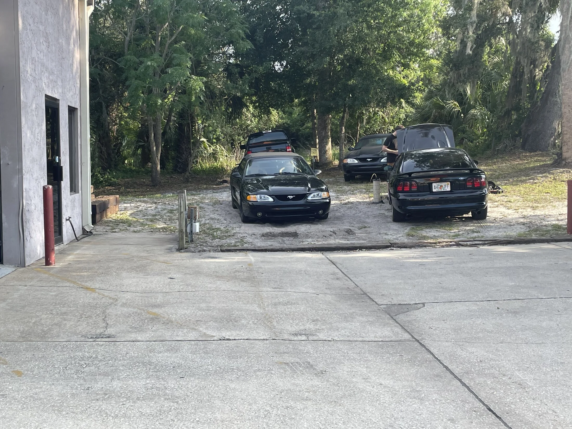

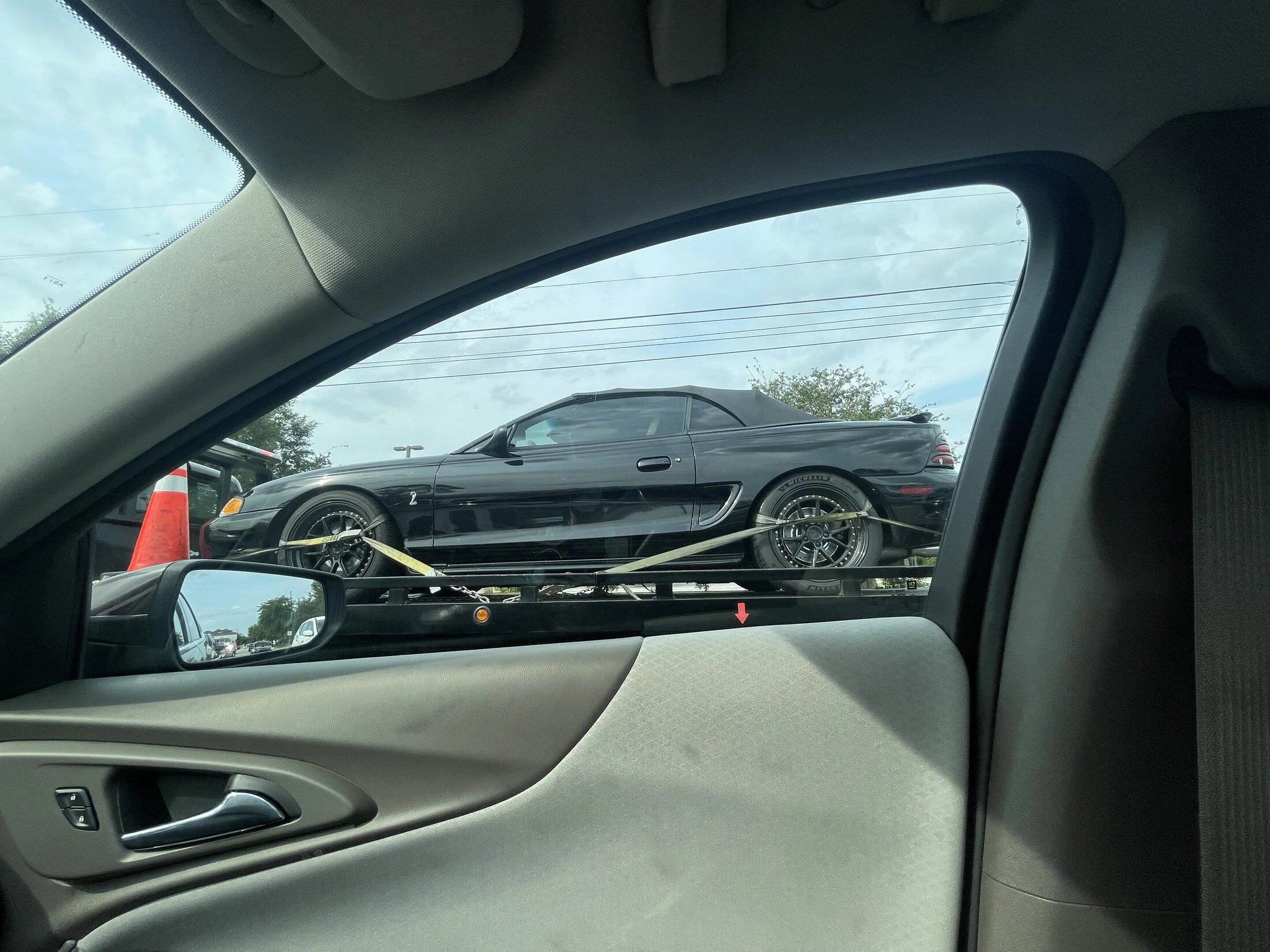

Saw this a little late. Today I dropped the car off at a local mustang shop, Lamotta Performance. Did the tests and replaced the “easy” parts but didn’t get anywhere and don’t have more time to mess with it with classes starting.I dunno what is making me think of it but check the fuel regulator as well. Can you smell fuel when you pull the vac line?
