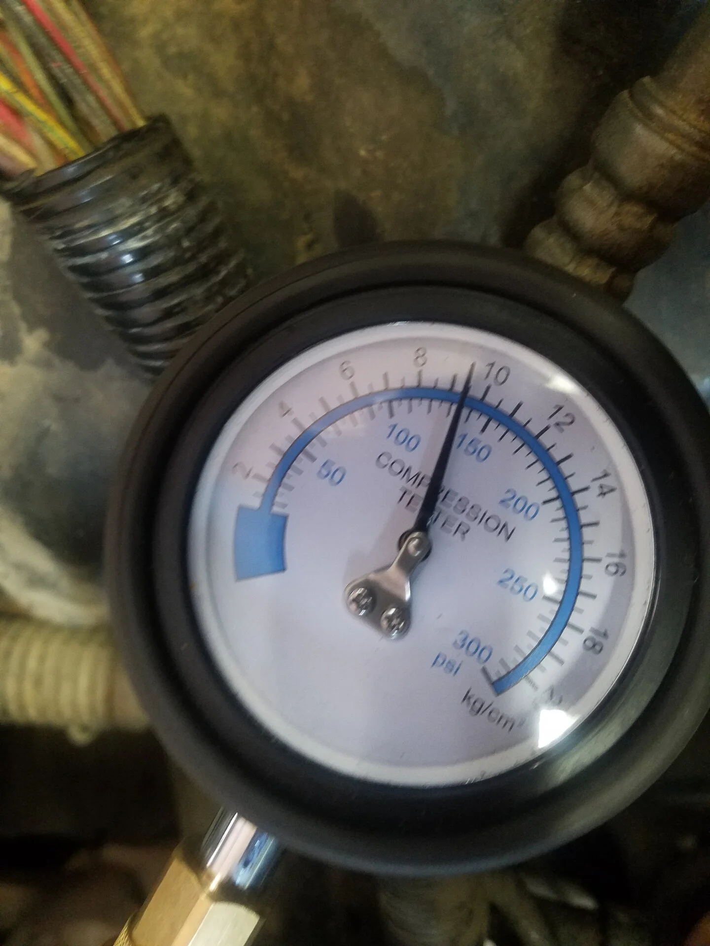

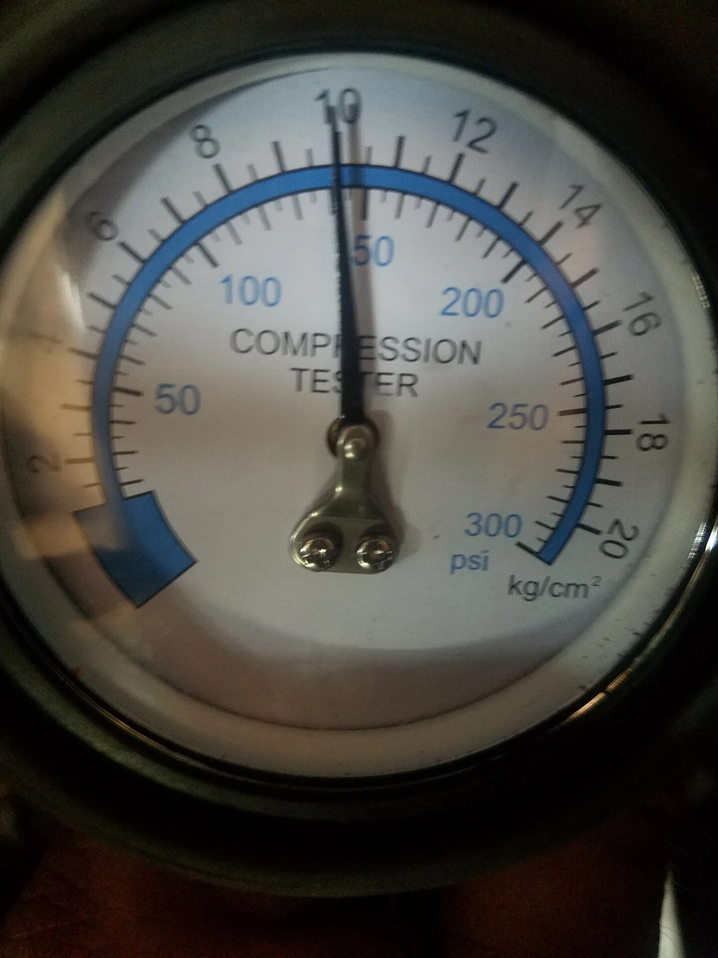

This was compression on 5&4 so cam timing had to be lined up correctly.

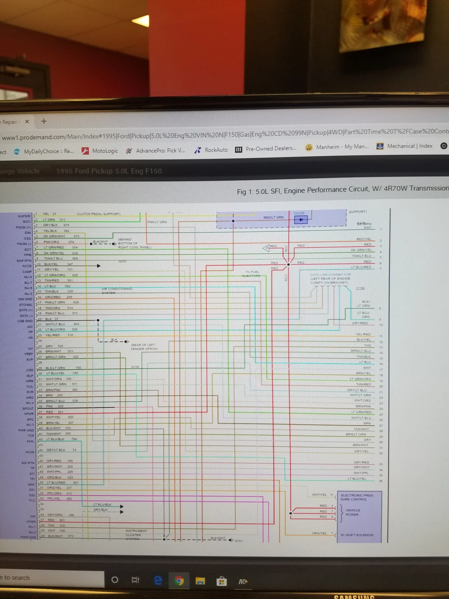

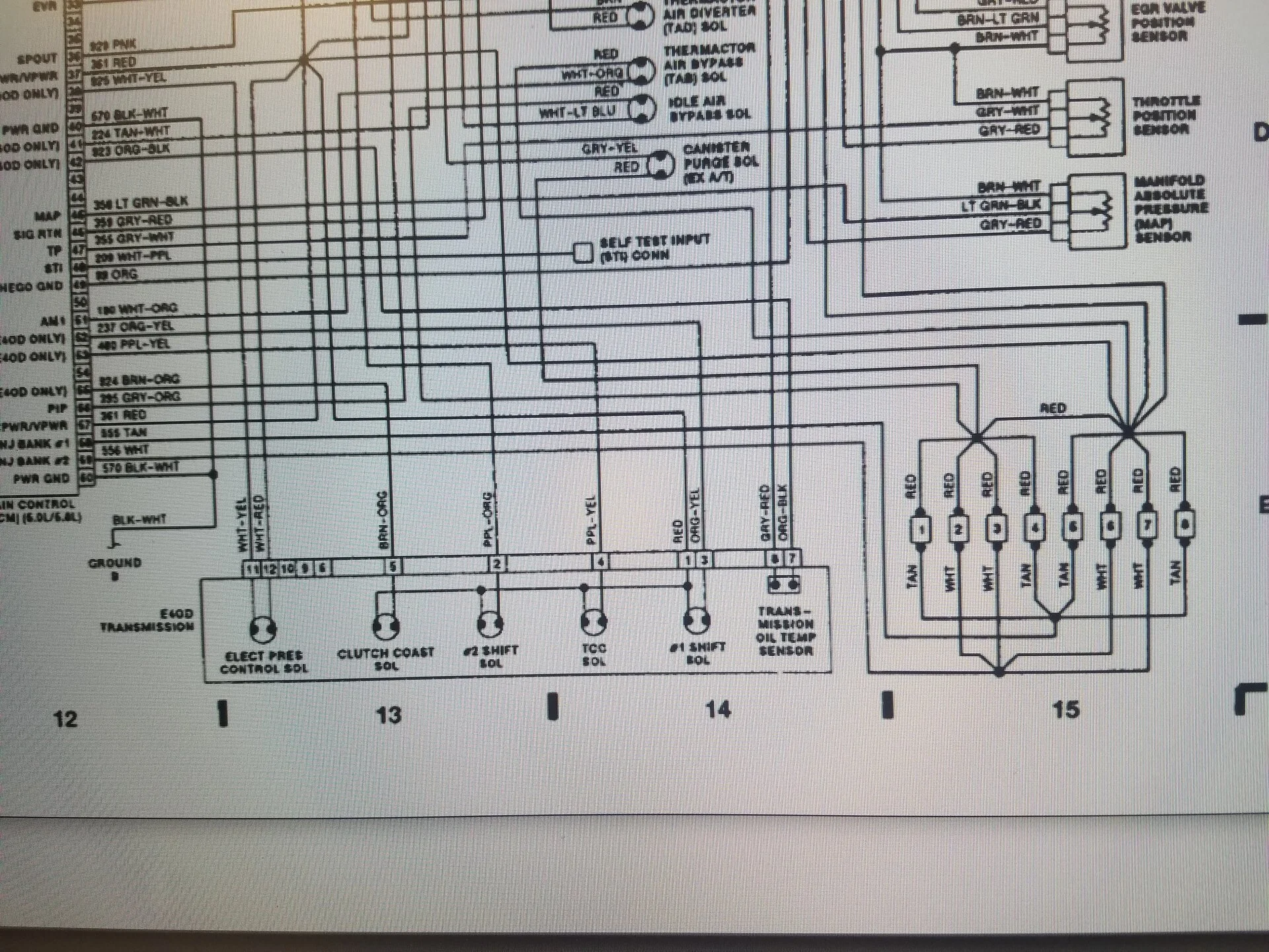

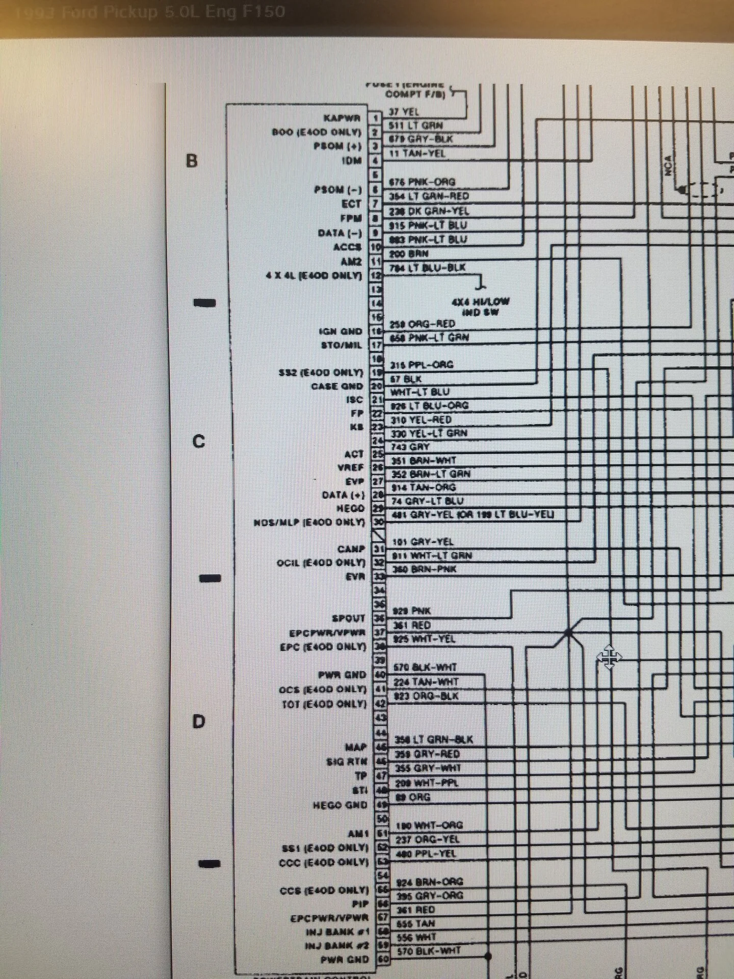

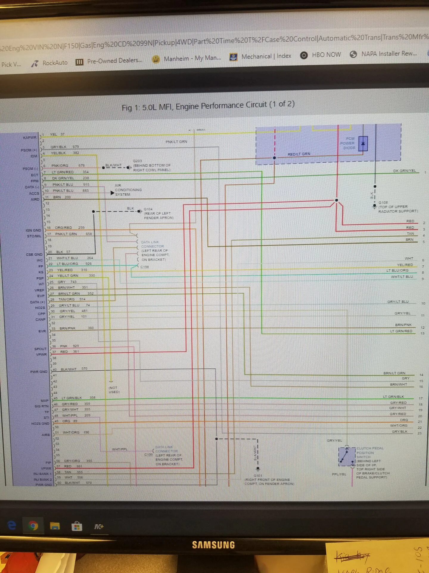

Got some pcm diagrams. Black and white is 93 f150 5.0 it shows injector banks 1&2. With map sensor.
Color ones show a 95 with a map sensor and a clutch switch that also shows injector banks 1&2
Another color one shows the 95 with with a auto trans and maf with sfi.
1-5-4-2-6-3-7-8 is old order. 1-3-7-2-6-5-4-8 is new order so i would just have to swap 5&3 4&7 injector trigger wires if i kept 93 pcm correct?

Ok truck is running with 93 pcm and 95 cam.
93 is map bank fire, 1 02 sensor.
95 automatic f150 5.0 is maf 02 sensors and sequential injectors.
95 f150 mt 5.0 is bank fire and map sensor.
1-5-4-2-6-3-7-8 is old 93 order. 1-3-7-2-6-5-4-8 is new 95 order i just swaped 5&3 4&7 injector trigger wires along with 95 plug wire firing order and kept 93 pcm. No issues with 02 sensor on 93 because their is only 1 sensor before the cat so it controls both banks the same as before. I appriciate all the help and info. Hope this might help some others even tho its a f150 and not a mustang.

No problem. I hope this and the pics of diagrams i put up will be able to help others.
I went to see if i could use the harness that came off the 95 motor i had. Then it hit me when the trigger wire was not tan or white. Idk why i didnt see it or think it before but bank fire injectors only use 2 diff colors for trigger. Sequential is different color trigger wire for each injector. At least on the f series of this era.
